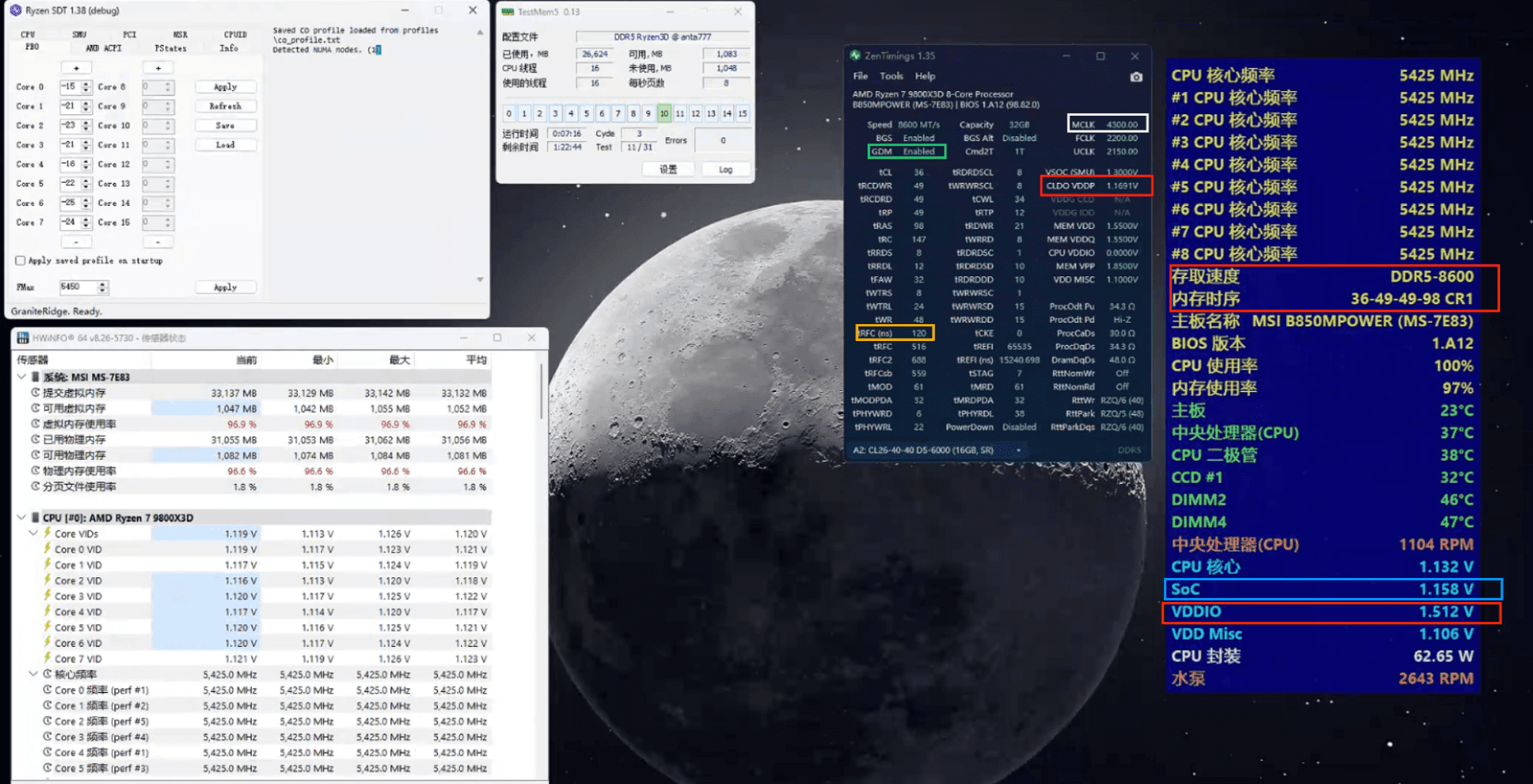

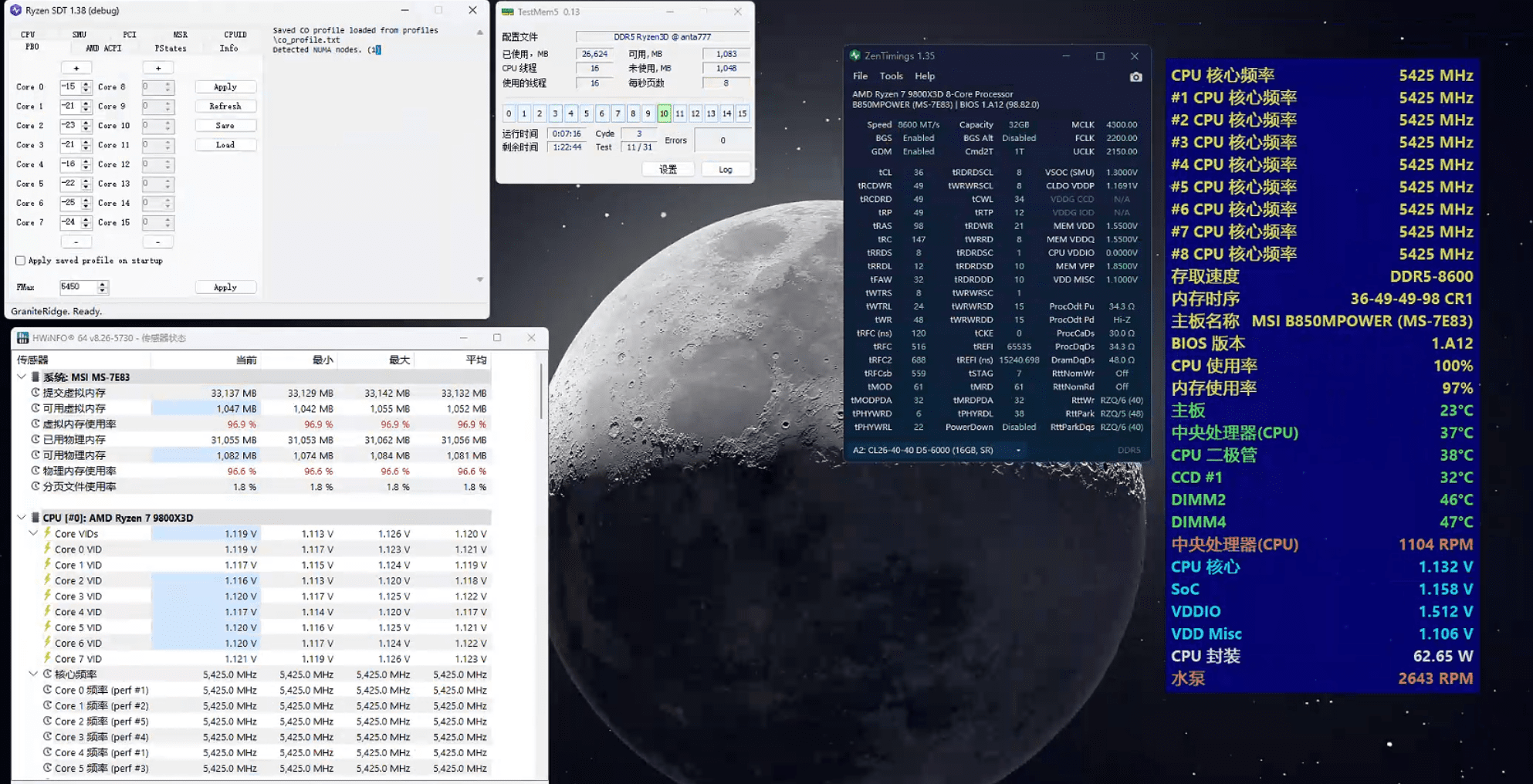

AMD Ultra Memory Easy Voltage Setup Guide
AMD OC Voltage Adjustment Simple Guide:
7800 physique - cldo_vddp voltage SoC voltage is not very important, a maximum of 1.2V is used to give normally, 0.9-1.15V is enough, and the SoC voltage is high will not have much effect
7800-8400 just need to add a little to ensure basic system stability
6000-6600-IMC Constitution - SoC Voltage. It has nothing to do with CLDO-VDDDP voltage, just default. The SOC can only give up to 1.3V and 1.3V can be turned on as many frequencies as possible
CPU VDDIO voltage-memory input and output data help to enhance the signal - and memory frequency is positively correlated, 6000-8400 can be added accordingly, and the U 6000-6600 with good physique is generally in the same frequency range
VDDG voltage: A stream of auto does not need to move, metaphysics has a positive buff for the stable higher FCLK frequency But after testing more than a dozen Zen5s, it was found that the auto that can be stable can also be stable, but it cannot stabilize FCLK
The 2200's increased VDDG is also not stable, so you don't have to waste time adjusting
Summary in one sentence: Frequency split eating vddp vddp vddp also has a physique to restart/get stuck for high power jumps, some u can eat, but the carving generally does not need to be too high, so it is a paradox
The same frequency only eats SOC
vddio memory is related to memory frequency

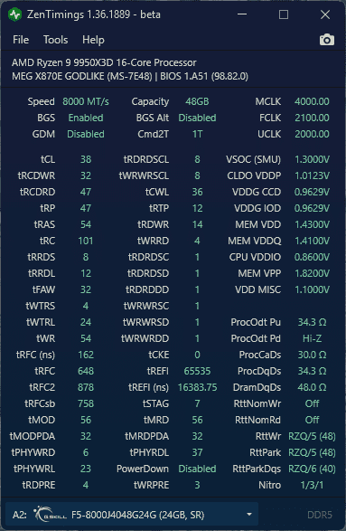

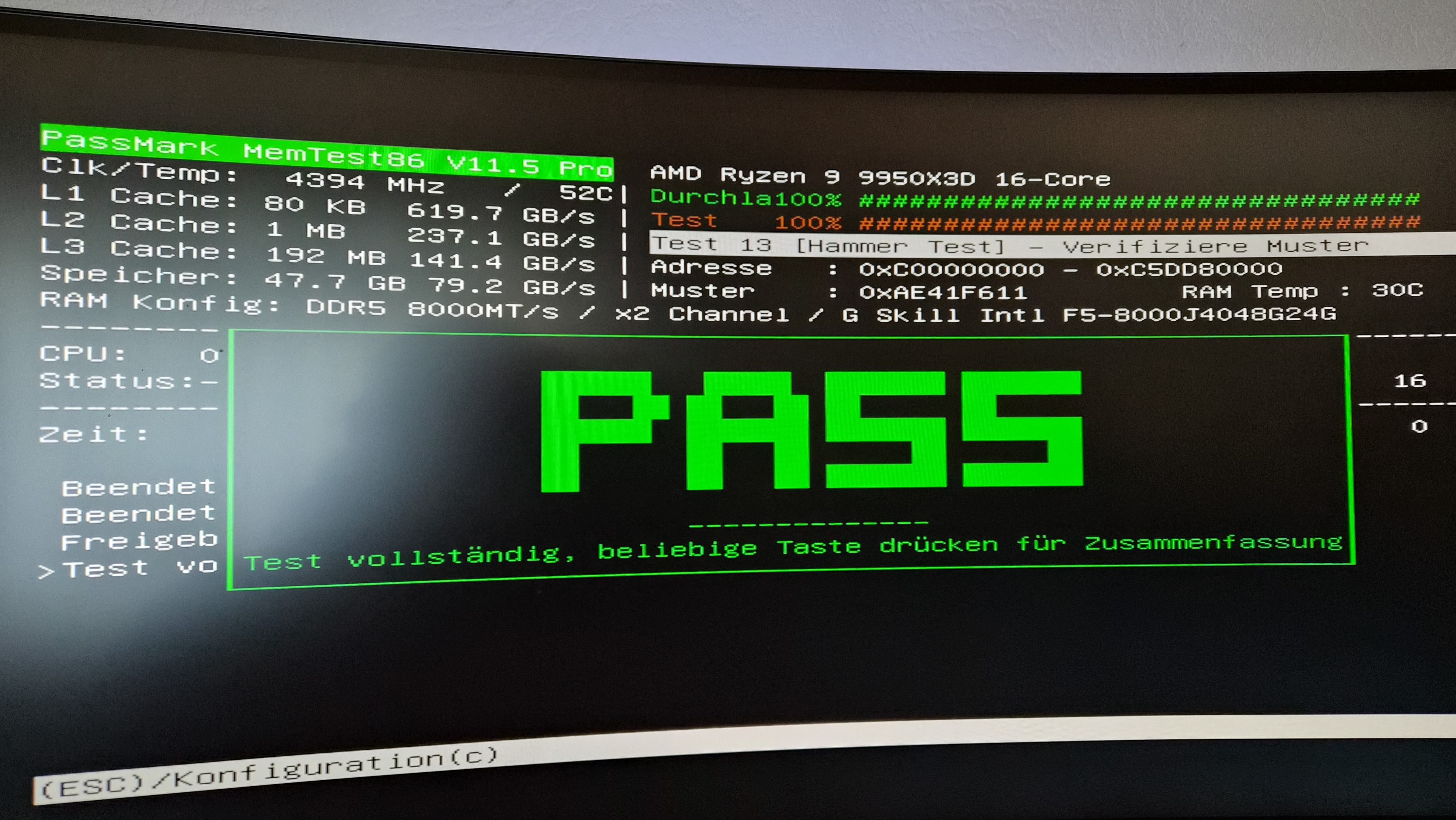

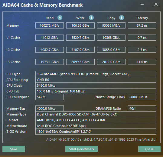

Gibts hier Leute die 8000 und mehr auf einem X670e laufen haben?
Will mir eigentlich kein neues Mainboard kaufen.
Will nur die CPU (9850x3d) tauschen und evtl, mal den Speicher auf 8000+ laufen lassen. Wunschdenken, oder machbar?
Kommt auf das Board an.
Ich habe das ASUS TUF Gaming X670E-Plus
Auf einem ordentlichen X670/B650 Board sind 8000+ überhaupt kein Problem. Ich fahre 8200 auf meinem ASRock B650E Taichi 100% stabil als daily Setting. Es macht auch 8400, aber das ist mir von den Spannungen her betrachtet zu heftig.
Das macht mir Hoffnung, danke.
auf meinem x670e taichi laufen auch 8000+ ohne große Probleme.
@Sir Ozelot
Eine letzte Frage, über 8000 handelt es sich meistens um CUDimms. Hast du solche RAMs?
In englischen Foren schreiben sie das CUDimms nicht auf einem X670e laufen.

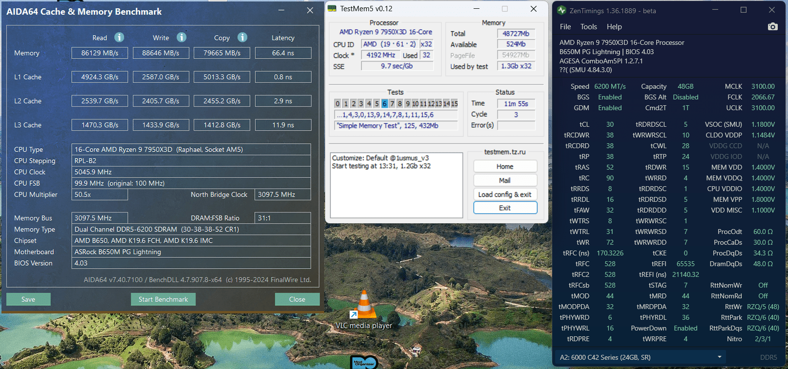

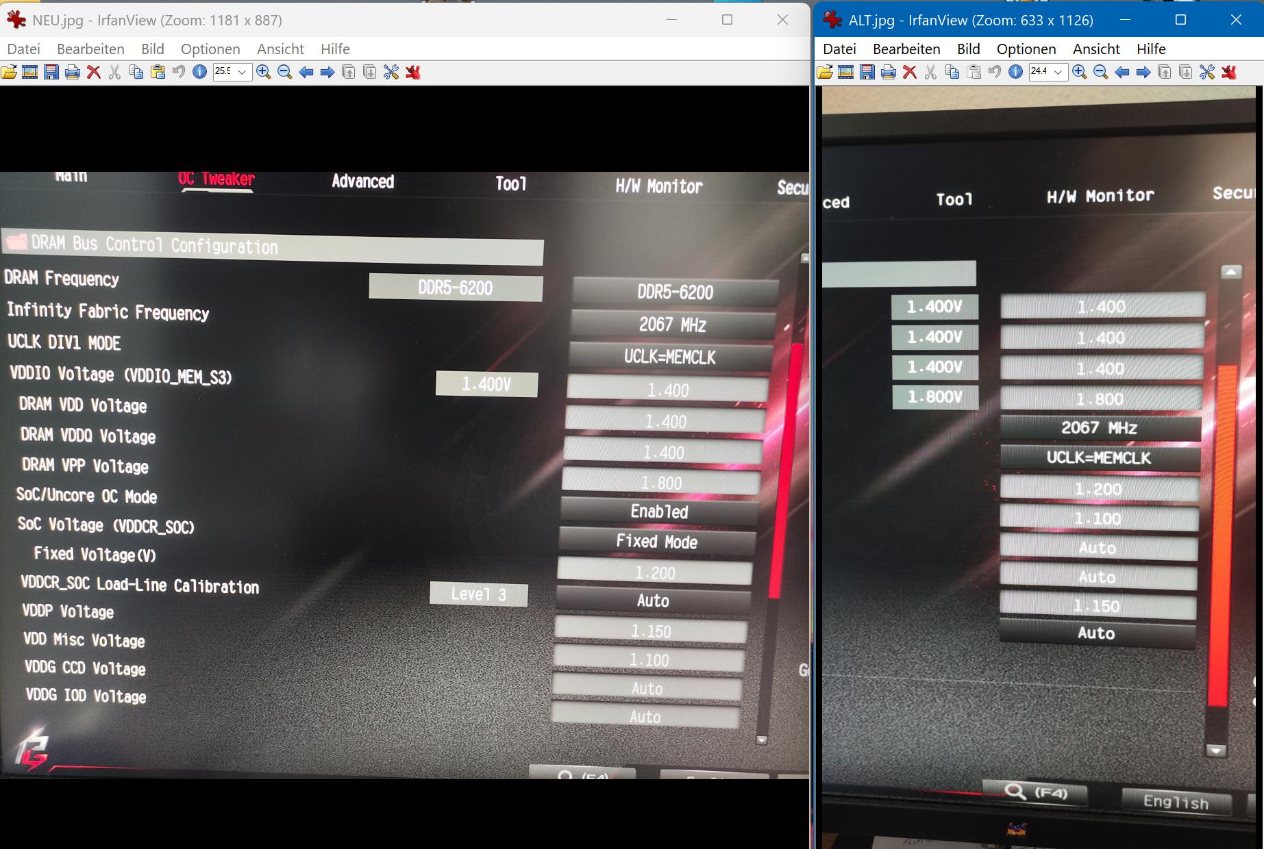

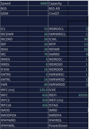

Moin Mädelz,
seit ich bei meinem Asrock B650 Board das Major Update auf 4.03 gemacht habe, erreiche ich meine Settigs nicht mal mehr annähernd.
Dafür habe ich jetzt auf der OC-Seite Einstellungen für Load Line CCalibration usw., welche vorher nicht an dieser Stelle waren.
Wahrscheinlich hängt das alles mit den abrauchenden 9xxxern zusammen.
Egal, ich habe einen 7950X3D und konnte bisher immer 6200 30-38-38 bei 1,4 Volt fahren, was jetzt noch nicht mal mehr annähernd funktioniert, dabei ist es irrelevant, ob ich Level 1, Level 2 oder Level 3 bei LLC einstelle. Noch nicht mal 6000 funktioniert mehr. Das System springt immer wieder zurück auf 4800.
Die kleinen Sprünge von z.B. 3.4 auf 3.5 haben die oben genannten Settings super überstanden.
Hat jemand eine Idee, an welcher Schraube ich drehen muss?
Sonst muss ich wohl zurück auf 3.5 :(
Danke für die Aufmerksamkeit!

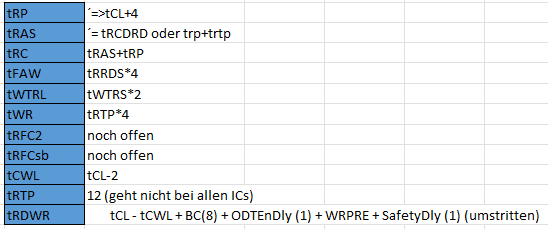

Brave Mädchen stellen erstmal alle tRFCs (1,2 und sb) auf den gleichen wert.
Zudem sind ZenTimings Screenshots sehr hilfreich.
Ich habe leider keine ALTEN Screens mehr als noch alles funktioniert hat
Und neue KÖNNTE ich machen, nutzt nur nix, da die Grundeinstellung nix aussagt.
Wie gesagt, es hat sich mit dem Major-Update so EINIGES geändert und ich dachte, dass hier vielleicht jemand dasselbe Problem hatte und eventuell auch eine Lösung parat.
VERMUTUNGEN kann ich auch selbst anstellen.
Aber ich mache gerne mal ein Backdate und poste dann einen Screenshot, damit man sehen kann, dass es wirklich schon einmal lief.
ICH will einfach nur wissen, warum es das jetzt nicht mehr tut und mitnichten, wie ich zu Werten komme, die ich noch niemals hatte.
BIOS 3.5:
Schon komisch....als ich die 3.50 zurückgespielt hatte, blieben die neue Anordnung der Einstellungen wie sie in 4.03 waren trotzdem bestehen :unsure:
Nun ja, das einzige, was ich jetzt (zusätzlich zu meinen vorigen Einstellungen) verändert habe, war LLC auf "AUTO"
Jedenfalls habe ich nun wieder 4.03 drauf und da auch LLC auf "AUTO" und siehe da, es lüppt.
Nicht schlecht finde ich, für Speicher, welcher nur für 6000@CL42 spezifiziert ist:
Hier die BIOS-Fotos von alt vs. neu, damit man sieht, dass ich mir das mit der neuen Anordnung und den zusätzlichen Einstellungen nicht eingebildet habe.
Bei der alten Version fehlen zwar die Optionen selbst, aber man sieht ja schon an der Anordnung (Voltage, UCLK), dass es völlig anders ist.
So kommen wir des Rätsels Lösung leider nicht näher, würde auf das Training, die Widerstände, VSOC oder VDDP tippen.
Die sollten bei deinen H24M ICs laufen:
Eventuell geht auch noch tRFC 469 / 160ns, muss aber nicht.

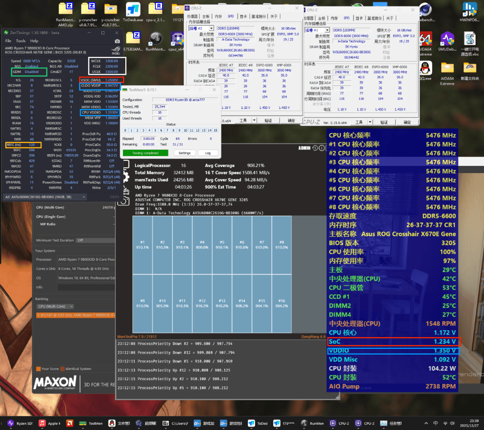

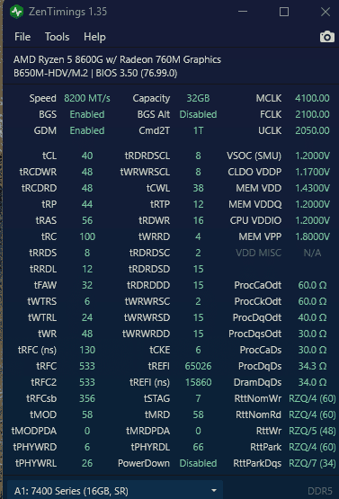

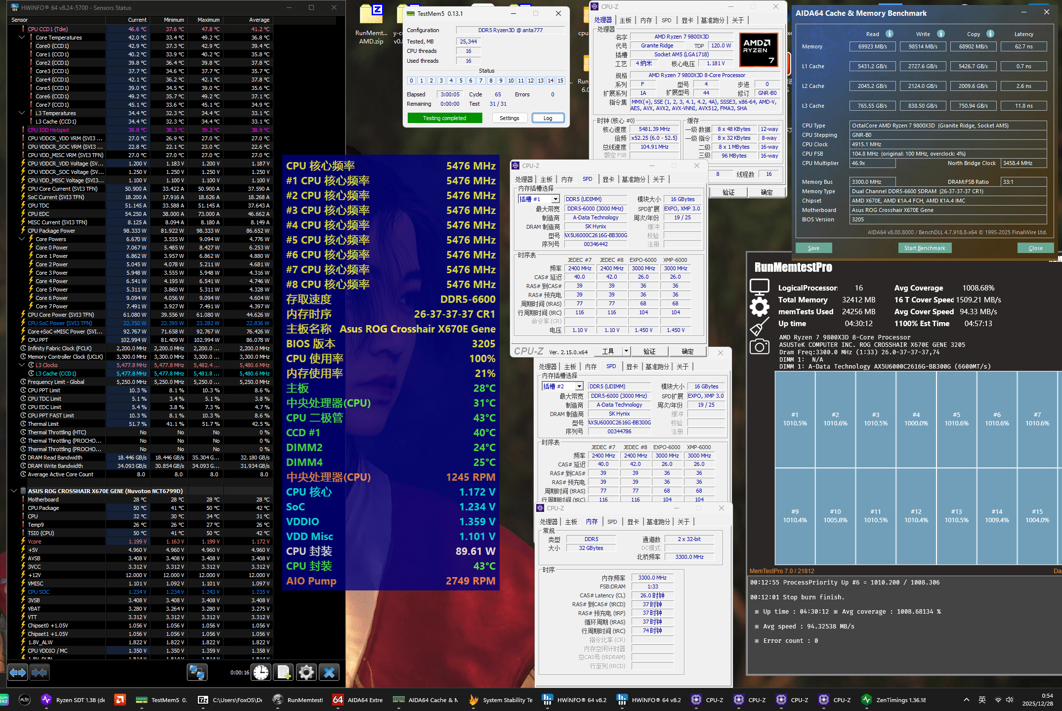

Hello
Sharing my personal OC experience
I hope it can help fellow OC DIMM enthusiasts
Some key voltages for AMD in the same-frequency and divider modes
When we run in the same-frequency mode, and try the current operating frequency with a SOC limit of 1.3V, for example 6400MHz, 6600MHz, or even higher frequencies, if it cannot pass TestMem5 or RunMemtest—and you've ruled out the possibility that your Hynix DIMMs are not capable—this basically confirms that the CPU IMC cannot stably run at the current frequency.
Summary: Synchronous mode only relies on SOC voltage; it does not rely on VDDIO or VDDP voltage.
When testing CPU quality, running your highest frequency at 1.3V SOC, the better the IMC quality, the lower the SOC voltage it requires.
When running in divider mode, using 8000MHz-8800MHz as an example:
At this point, the SOC voltage requirement is very low, basically 1.1V or 1.15V SOC is enough.
However, the higher our MCLK, the higher VDDIO and VDDP voltages are needed to stabilize operation.
When we try to test 8000MHz-8800MHz, using the combination of VDDIO and VDDP voltages to run at your highest frequency, the strength of each CPU IMC controller determines your limit.
If the frequency is unstable, the first step is to increase VDDP voltage. Higher VDDP allows us to run more stably.
If you increase VDDP beyond what your CPU can handle, it will fail to boot. At this point, try increasing your VDDIO voltage. Sometimes a miracle happens and the system can boot and run stably at frequencies that previously could not pass testing.
When you reach the CPU IMC limit, no matter how much you increase VDDIO or VDDP, it will neither pass the test nor boot.

Ensure that the DIMM has no physical bottleneck
6000Hz-6600Hz UCLK 3000-3200
Only SOC voltage is needed
8000Hz-8800Hz MCLK 4000
Only VDDP and VDDIO are needed
The specific voltage values depend on the CPU IMC quality
The lower the voltage required to run at higher frequencies,
the stronger the memory IMC controller

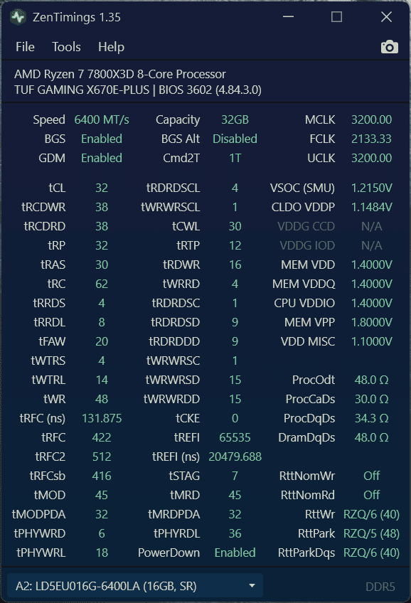

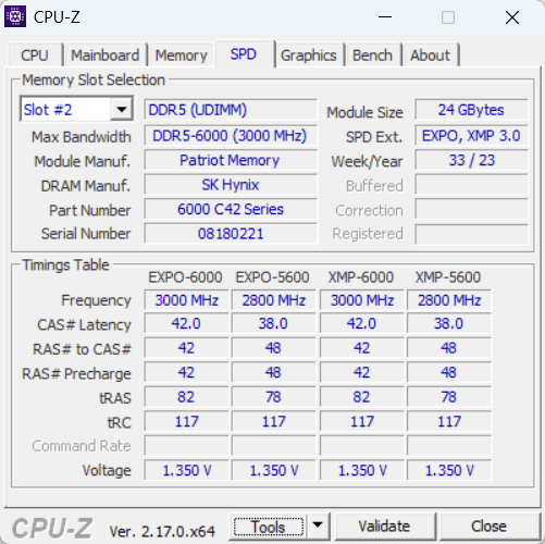

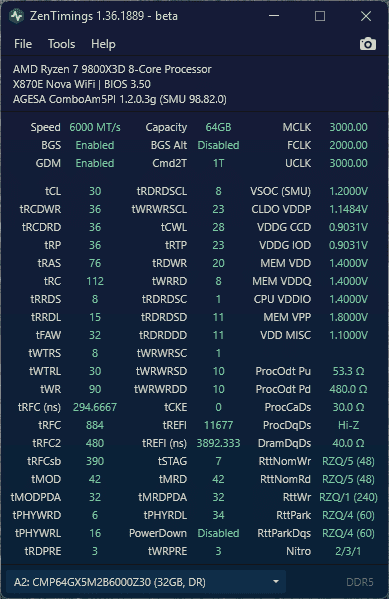

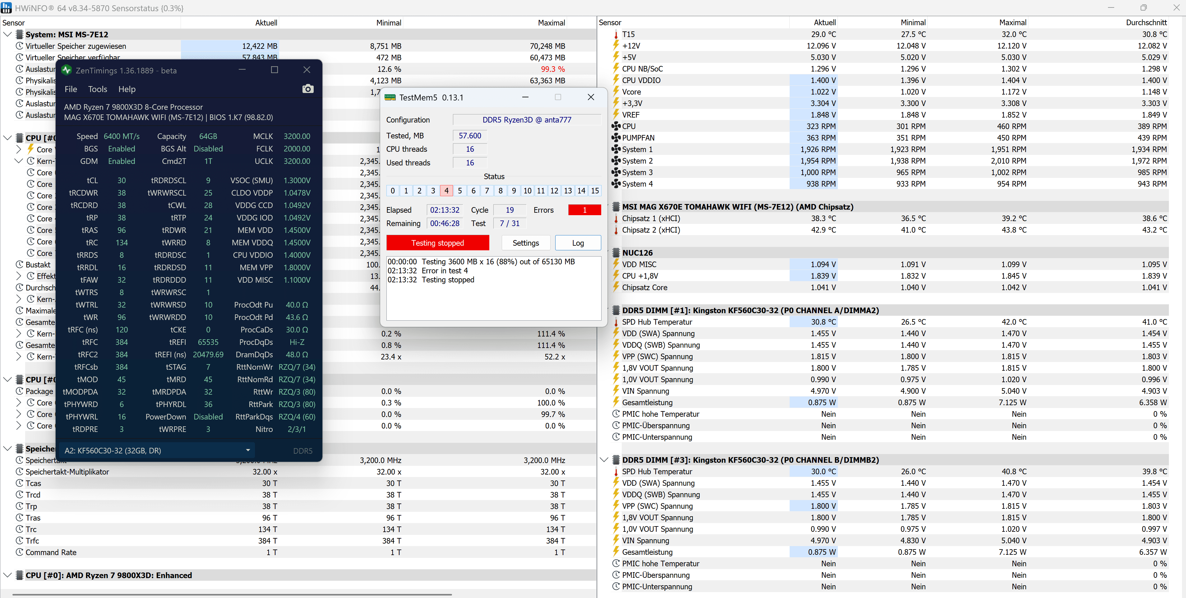

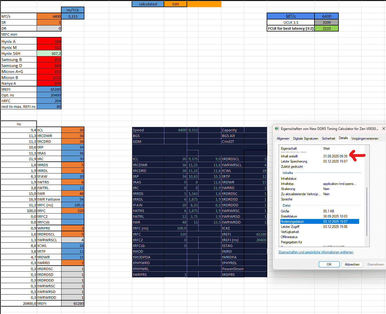

Habe heute den zweiten 6400er-Versuch gestartet, diesmal ohne EXPO-Profil was ich im ersten Test eingeschaltet hatte da ich direkt einen CMOS-reset machen musste nachdem ich probiert hatte die CPU VDDIO geringer als die MEM VDD & MEM VDDQ einzustellen was ich schon weird fand. Mit VDDIO, VDD & VDDQ bei 1,45 V hatte ich nach nur 5 Minuten einen error und habe dann erstmal abgebrochen.
Also habe ich heute nur die Kompatibilitätseinstellung für Hynix mit 32 GB im BIOS mitgenommen ohne EXPO und den Werten im screenshot was leider nach über zwei Stunden auch zu einem error führte. Was ich jetzt aber sehr schräg finde ist dass ich mit denselben Einstellungen wie im screenshot, aber 1,47 V MEM VDD & MEM VDDQ nun direkt einen error nach wenigen Minuten bekomme :fresse:. Keine Ahnung was das ist, da muss ich morgen mal weitertesten.
6400 DR sind halt nicht so easy wie 32 oder 48GB SR.
Ggf VDDP noch erhöhen, aber leider gab ich keine persönlichen Erfahrungen mit DR DDR5. Sorry

Today I started the second 6400 attempt, this time without an EXPO profile, which I had turned on in the first test, because I had to do a CMOS reset directly after I had tried to set the CPU VDDIO lower than the MEM VDD & MEM VDDQ, which I found weird. With VDDIO, VDD & VDDQ at 1.45 V, I had an error after only 5 minutes and then stopped for the time being.
So today I only took the compatibility setting for Hynix with 32 GB in the BIOS without EXPO and the values in the screenshot, which unfortunately led to an error after more than two hours. But what I find very weird now is that with the same settings as in the screenshot, but 1.47 V MEM VDD & MEM VDDQ I now get an error directly after a few minutes. No idea what that is, I'll have to continue testing tomorrow.:fresse:
Control the DIMM temperature well. First, rule out temperature-related errors for the memory chips. Prioritize increasing the DIMM voltage, or first provide enough SOC voltage to ensure IMC stability. My personal suggestion is that before running 6400Hz, try to see if it can boot with 6600 in synchronous mode. If it can boot, it basically confirms that the CPU IMC memory controller is stable enough to run at 6400Hz.
Ist vermutlich nur ein "Hitzeproblem". Setz mal einen Lüfter davor uns lass nochmal laufen.
So, jetzt laufen die 6400 endlich :banana:: 6400CL30.jpg
Danke erstmal an alle für die Tips, es lag aber an etwas ganz anderem:
ich habe im Vergleich zum letzten testrun nur "DDR Nitro Mode" auf "Enable" eingestellt (war vorher auf "Auto" was aber ebenfalls in 2/3/1 resultierte), "DDR5 Robust Training Mode" ebenfalls auf "Enable" und "Nitro Rx Burst Length" und "Nitro Tx Burst Length" habe ich auf "8x" eingestellt und schon lief TM5 durch :).
Interessanterweise hat das auch die Spannungswerte (die ich gar nicht händisch verändert hatte) von CLDO VDDP, VDDG CCD und VDDG IOD von 1,0478V, 1,0492V, 1,0492V auf 0,9472V, 0,9031V, 0,9031V gesenkt (vielleicht ein bug, ich weiß es nicht) was vielleicht auch noch mit reingespielt hat. Ich hatte mit einem anderen kit die CLDO VDDP mal testweise auf 1,15V erhöht was massiv schlechter lief als mit leicht unter 1V.
Und ich habe einen komischen IMC: mit mehr als 1,45V MEM VDD und MEM VDDQ fliegt mir TM5 bei denselben settings wie von heute nach ~15 Minuten um die Ohren. Erhöhe ich die MEM VPP (ohne MEM VDD und MEM VDDQ) von 1,800V auf 1,850V bekomme ich in TM5 nach weniger als 5 Minuten einen error mit den gleichen settings wie von heute. Scheinbar mag mein IMC keine höheren Spannungen was den Speicher selbst betrifft, denselben Effekt bei mehr als 1,45V MEM VDD & MEM VDDQ hatte ich auch schon bei zwei anderen kits: 2*24GB G.SKILL mit M-Dies und 2*32GB Mushkin mit A-Dies (wahrscheinlich, das hatte ich gar nicht geprüft was da an ICs drauf war weil das Mushkin-kit nicht mal mit luschigem EXPO stabil lief und direkt wieder 'rausgeflogen ist) :rolleyes:.
@CoronerX
Deine RTTs hast du auf Auto?
Ja, die hatte ich bei allen Tests auf "Auto".

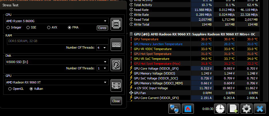

The maximal temperatures of the sticks were 42° C and 40,8° C under full load at the end of the TM5-run. I have two 140mm-fans blowing at 900RPM onto the motherboard and RAM at all times to rule out temperature issues :)./Die maximalen Temperaturen der sticks waren 42° C und 40,8° C am Ende des TM5-runs. Ich habe zwei 140 mm-Lüfter die permanent mit 900 U/min auf das Mainboard und den Arbeitsspeicher blasen um Temperaturprobleme auszuschließen :).
So, jetzt laufen die 6400 endlich :banana:: Anhang anzeigen 1171159
The maximal temperatures of the sticks were 42° C and 40,8° C under full load at the end of the TM5-run. I have two 140mm-fans blowing at 900RPM onto the motherboard and RAM at all times to rule out temperature issues :)./Die maximalen Temperaturen der sticks waren 42° C und 40,8° C am Ende des TM5-runs. Ich habe zwei 140-mm-Lüfter die permanent mit 900 U/min auf das Mainboard und den Arbeitsspeicher blasen um Temperaturprobleme auszuschließen :).
..dasselbe habe ich auch, ich verdächtige da aber MSI.....
