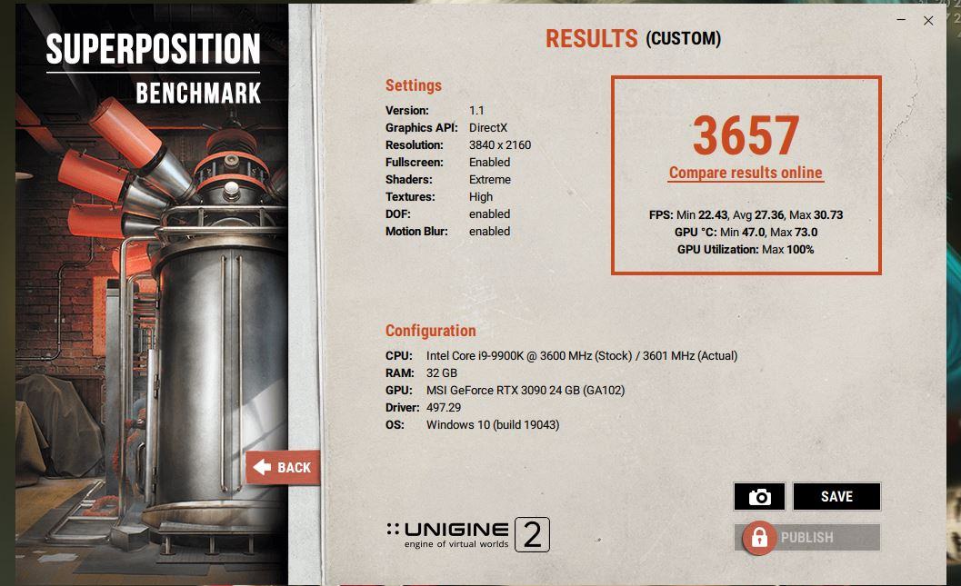

Since i already was on this forum i did a testrun in superpos with somewhat ~ daily 24/7 settings in normal room temp .
(computer inside case :-))
MSI Suprme X 3090 @ EVGA 1000w rebar bios
Custom watercooling with EK waterblock + LM (12 degrees delta between GPU and hotspot temp @ 580w)
~ 2220 / 1432mhz @ 1,087 vgpu max
No other mods than just flashing new bios and watercooling card.
Since i already was on this forum i did a testrun in superpos with ~ daily 24/7 settings in normal room temp .
~ 2220 / 1432mhz @ 1.087 vgpu max
Very awesome score! And lovely Scoreoverview.
Thats how I like it to see!
But to be fair/ honest, you could have gotten 10-15 points more if you hadnt run so much diagnostic software :d.
Very very good for ambient cooling. Put your radiator outside and you will be in the top list.
(until we see -20 degrees this winter.... im ready :))

Thanks, i did get a few more points when not running all these monitoring tools :)
Could get 4066 points when still running normal ambient temps (y)
2220/22704 MHz
And when i lowered the temp a few degrees i even managed to sneak into top 10 on the ranking :d
2235/22752 mhz
Still no mods, only watercooled the card (+ lm)
Think my current limiting factor is vgpu-core
I will maybe do a real cold-air (-20 degrees) run with computer in window if i get bored some day. I live north of the artic circle so i don't need to wait for the right weather / temps: LOL:

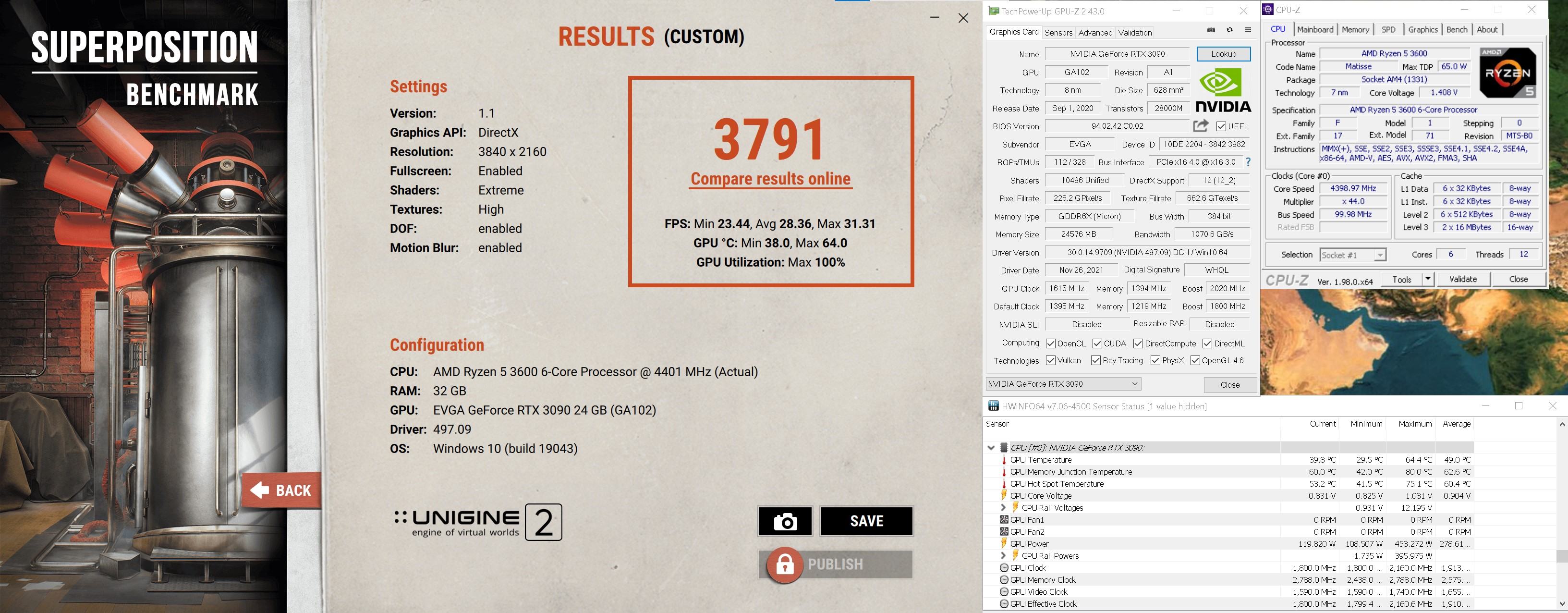

Jahead│3791 │EVGA 3090 FTW3 Ultra Gaming│2020/1394│AiO-Wakü
Da geht auf jedenfall noch mehr. @xtremefunky Platz 49. dürfte das sein! :wink: Und ehrlich gesagt hab ich kein Plan von OC 😅

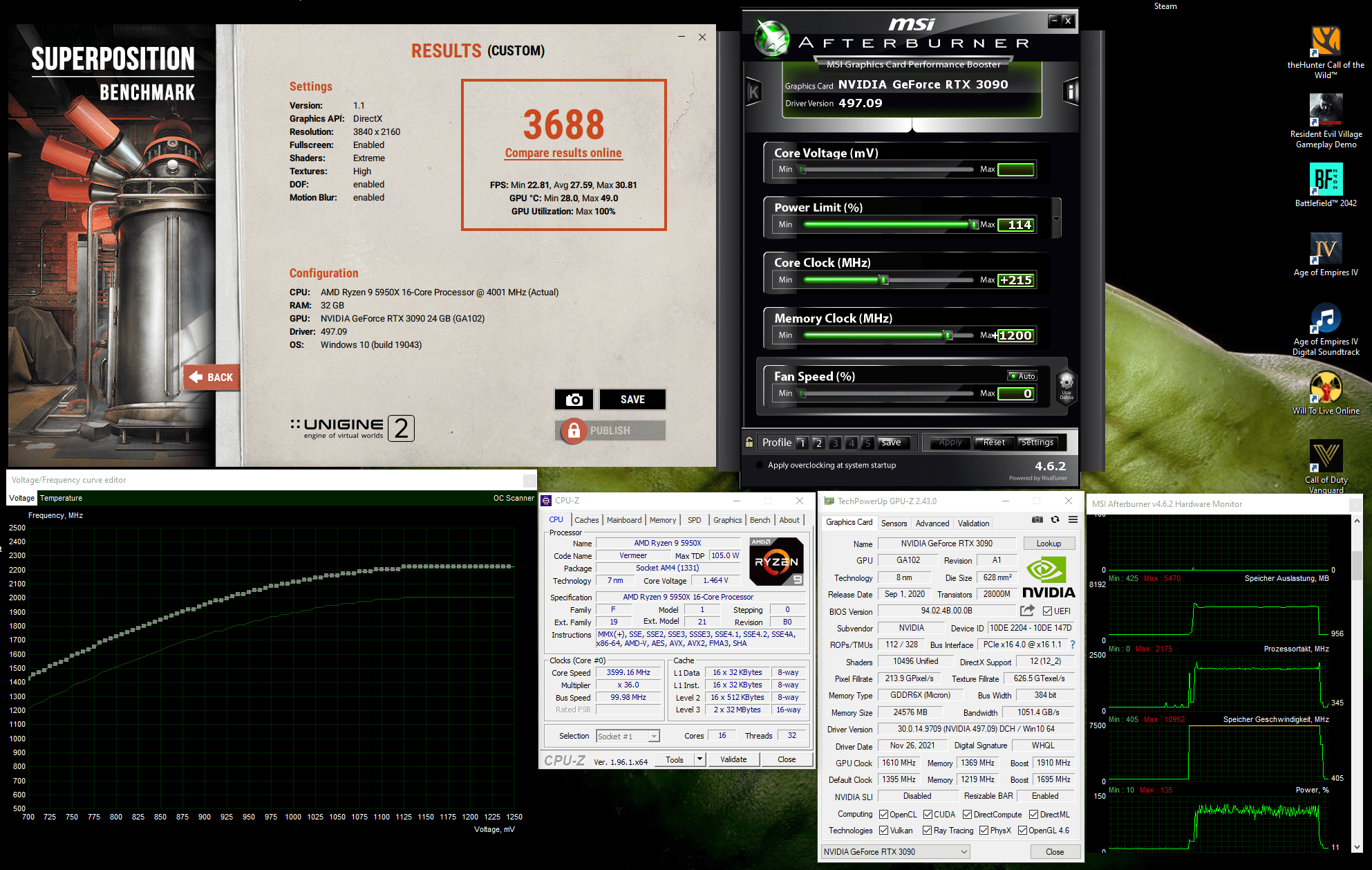

Spultin / 3688 / 3090 FE / max.2175|10952 / Wakü
Hab von OC nicht all so viel Ahnung,bin für Tipps gerne per PN dankbar
Danke für die Einsendung! Sieht doch gar nicht so verkehrt aus. Oberes drittel im Enthusiasten Forum. Was will man mehr :hust:?
Freut mich, dass es immer mehr werden.
Wie oben schon erwähnt, kann man bei dem Benchmark nicht viel falsch machen.
Für Gaming zwecke, würde sich anbieten, die Karte mit der Curve zu bearbeiten.
Achso: Und stark, dass du noch das alte Design vom AB nimmst. Ich liebe es :bigok:

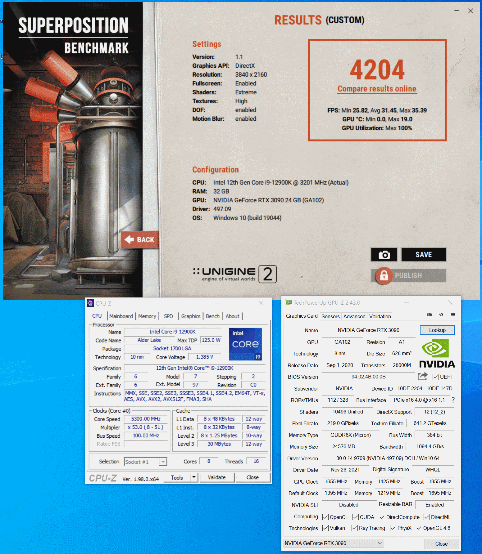

X909 | 4204 | 3090 FE shuntmod | 2325/1.425 Mhz | Wakü mit Vodka (ca. -7°C Air, ca. -4°C Wasser)
Hatte tatsächlich nen Run dabei, der -1°C als Min GPU Temperatur angezeigt hat ;DDD Und die neuen Treiber oder das neue BIOS scheinen etwas anders zu Takten. Es ist empfindlicher aber ich glaub ich hab bei gleichem Slider ein paar Mhz mehr.
Joaaaa aber nur für den Run das System zusauen wollt ich auch nicht. Vodka funktioniert jedenfalls in geringer Dosierung :ROFLMAO: Wasser wird dann demnächst komplett gewechselt. Obs nur der Schnaps war, die dritte Pumpe im System oder meine Geduld, keine Ahnung aber es ist vollbracht:
Ach du scheisse. Er hats echt gemacht und sich einfach an die Spitze gemogelt.
Graaaz zur Pole! Den HOF Eintrag hattest du ja schon :shot:
Glaube den Rekord wirst du noch einige Zeit lang haben. :hust:
Werd in den nächsten Minuten eingetragen :hail:
