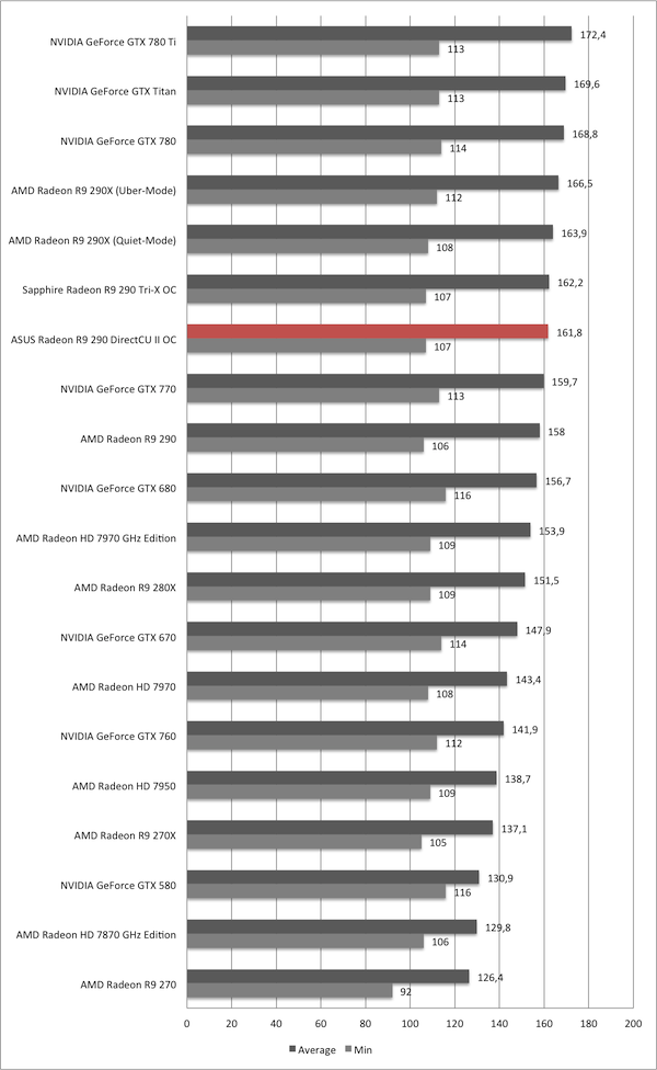

The Elder Scrolls V: Skyrim - 1920x1080 1xAA 1xAF
strom-idle
Bilder pro Sekunde

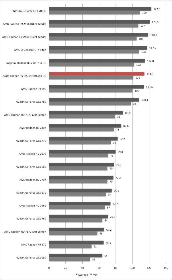

The Elder Scrolls V: Skyrim - 1920x1080 8xAA+FXAA 16xAF
strom-idle
Bilder pro Sekunde

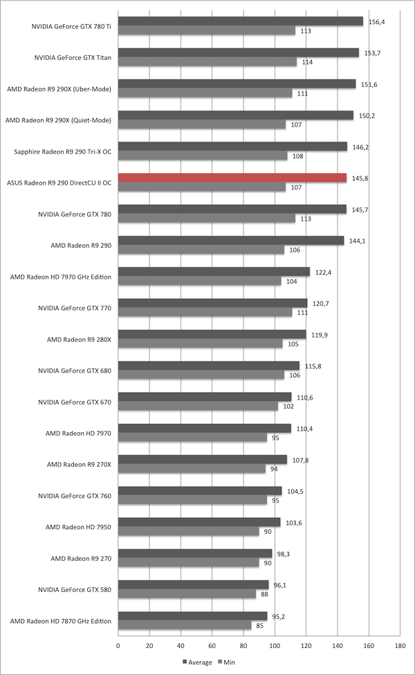

The Elder Scrolls V: Skyrim - 2560x1600 1xAA 1xAF
strom-idle
Bilder pro Sekunde

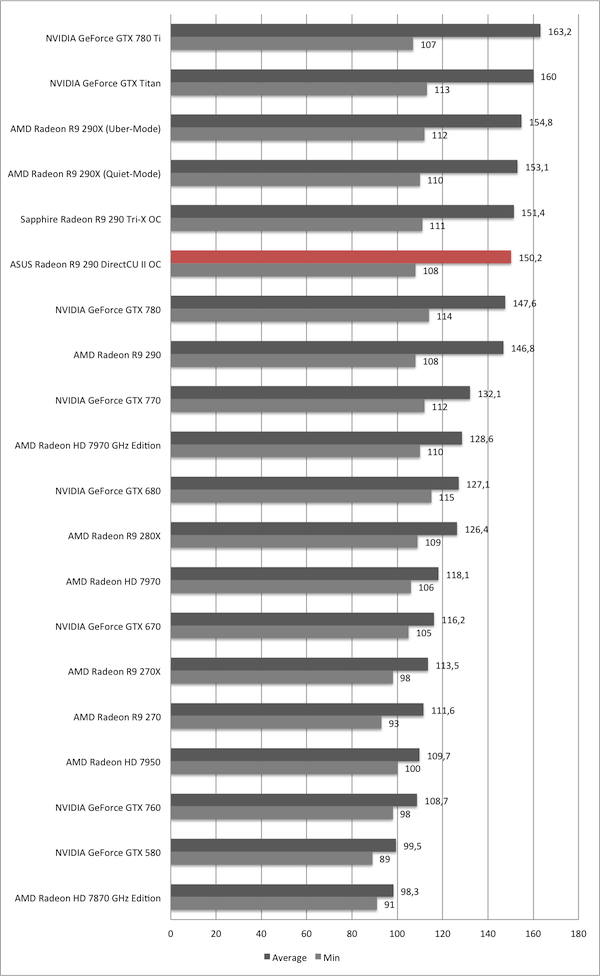

The Elder Scrolls V: Skyrim - 2560x1600 8xAA+FXAA 16xAF
strom-idle
Bilder pro Sekunde
