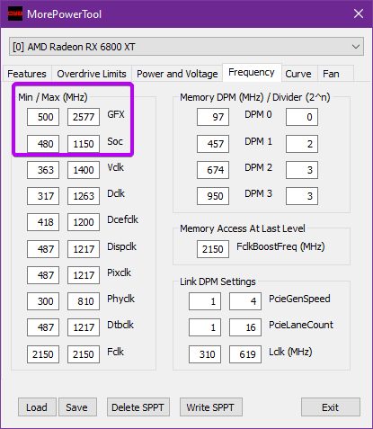

You have a "special" 6800XT bios that would allow higher VRAM, and want a 6900XT user to try combining SPPT with/from it ?
I dont, i have the 6800xt bios that was in my card, it works fine on flck and i can reach 2300mhz sometimes if the card suits it, at low temperatures even 2400mhz, but i uploaded the bios from 6900xt liquid devil, no matter if i adjust the clocks to 6800xt or leave them as they are in this bios, one thing, the card wont flck over 2100mhz, so there is some setting in mpt, that we don't have access to, which makes my card with SPPT file from 6900xt bios not able to run higher flck, this could be helpful for people with 6900xt who have low flck problem, because maybe using 6800xt file for such card and setting clocks like normal 6900xt, will allow them to achieve higher flck

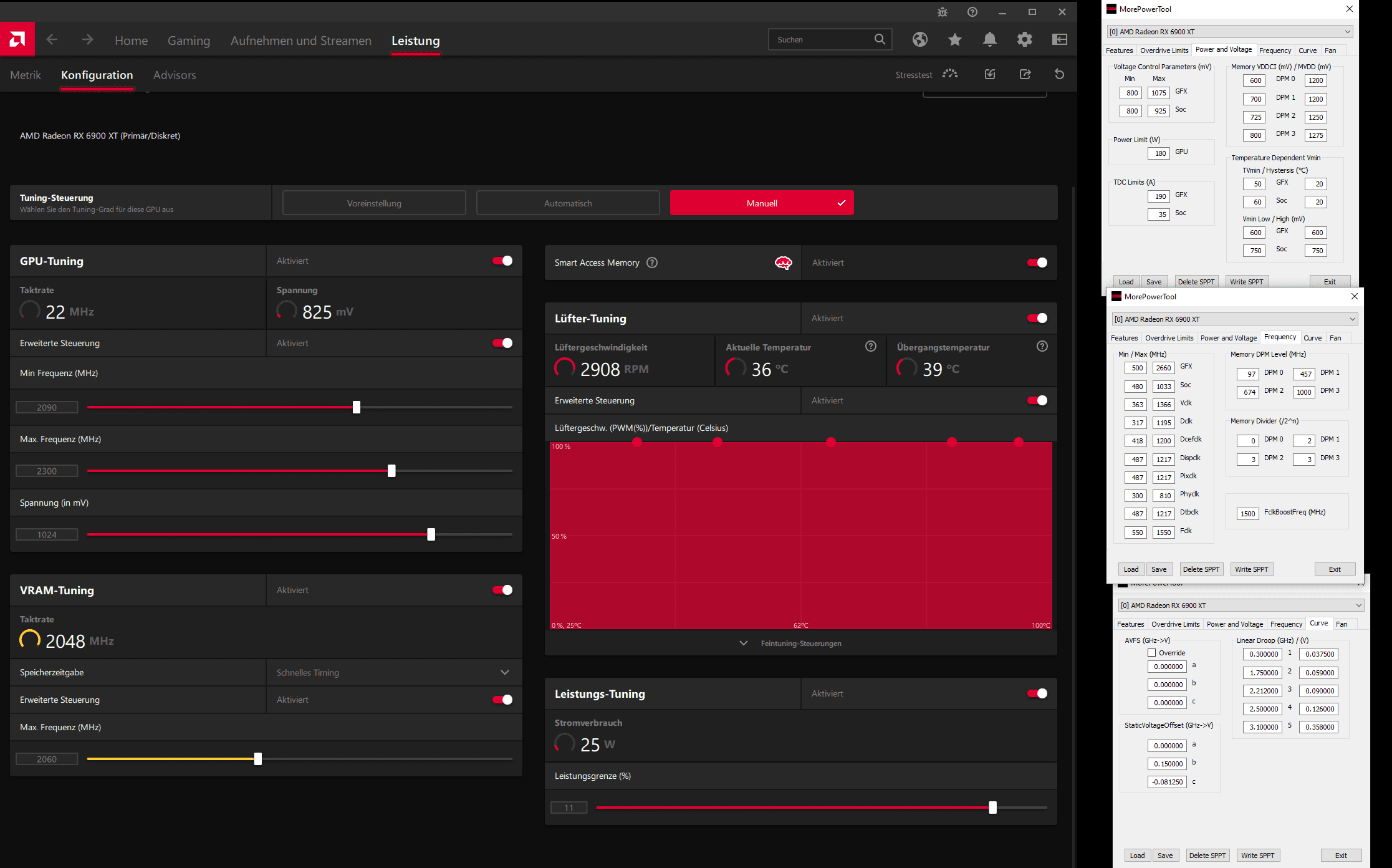

I loaded one of these two BIOS files, set overdrive max gfxclk to 2600, gfx max mv to 1025, gpu W & tdc how you like.
For me the card needs much more power (+269mv evc2):
Without loading the XT bios I hold 2610mhz stable with 1150mv and barely touching 300W and it was faster as well. I need to find a way to get the curve a little less hungry so I can hold high FCLK but still reach max core clock:d
Aah ok, now we're talking the same language
