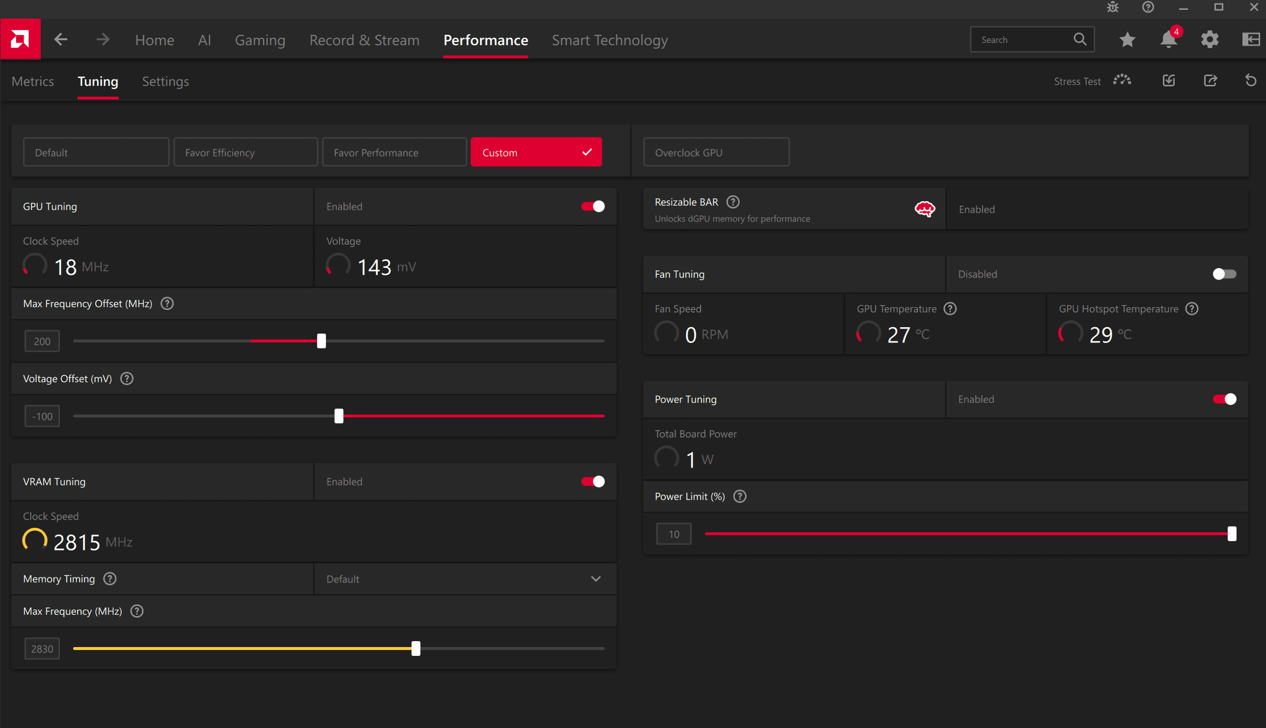

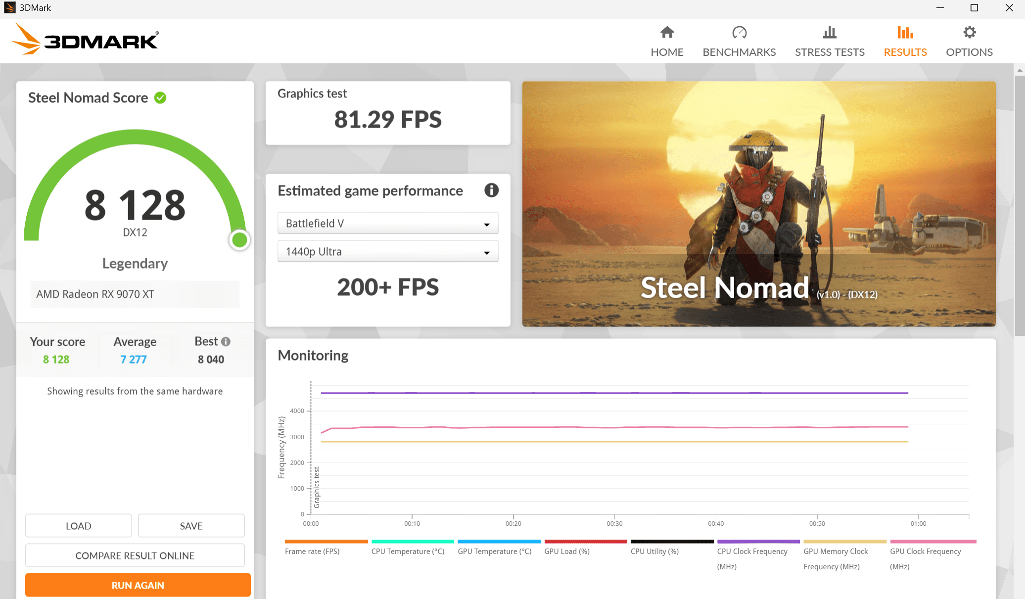

Only SN so far....this is pretty much the limit for me stock card oc....just custom water loop so far...water temp was around 25c its getting warm here.
+300mhz core
--105mv
2830 mem
+10PL
Ok! Nice....will keep that in mind when im at the end....gonna muck around with linux today and hook up the chiller...just to keep temps in check.with the weather/humdity here...quite low atm...i can probably get the water down to like 9/10c,a couple of c above dew point...will stuff around like this for a while then probably move the card to the sub zero chill box set up...
Dont want to pull the card apart again just yet...for evc/shunts...that will be something for the future
Im obviously a little concerned about the 12v 2x6 cable but will try and keep things relatively conservative...knowing my tinkering habbits i should have held off for a 3x 8pin pcie card but not much here on the used market ans i picked this card up at a good price...so eh...what can you do! I did notice that alphacool included a thermal pad for the connector on the back plate! I also have a fan set up pointing straight at the connector...i doubt either of these things are gonna help...if the cable decides to let go its gonna let go!

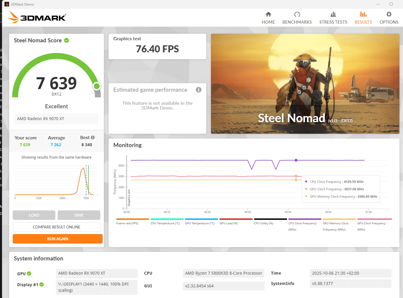

Ging gut +400 mhz vulkan und +300 mhz bei mir mit -135 mv im schön warmen PC-Zimmer. Minimale Verbesserung meines personal best - vielleicht geht mit Balkonmod dann nochmal mehr :)

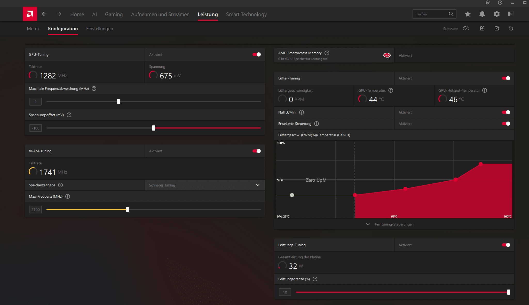

Beispiel aus Reddit:
PowerColor Reaper -500 MHz Frequenzoffset -90 mV Spannungoffset -Schnelle Speichertimings -Max. Speicherfrequenz 2700 MHz -30% Powerlimit
Ergebnisse: 200W maximale Leistungsaufnahme, 2-3% Performanceverlust in Spielen. Extrem leise.

Meine Mercury OC (Samsung) läuft bei -30% PL (238w) mit -80 bis - 110mV. VRAM 2850-2920mhz für Gaming. Die verliert keine 5% an Leistung und ist damit immer noch schneller als zum Beispiel eine 9070XT Swift.

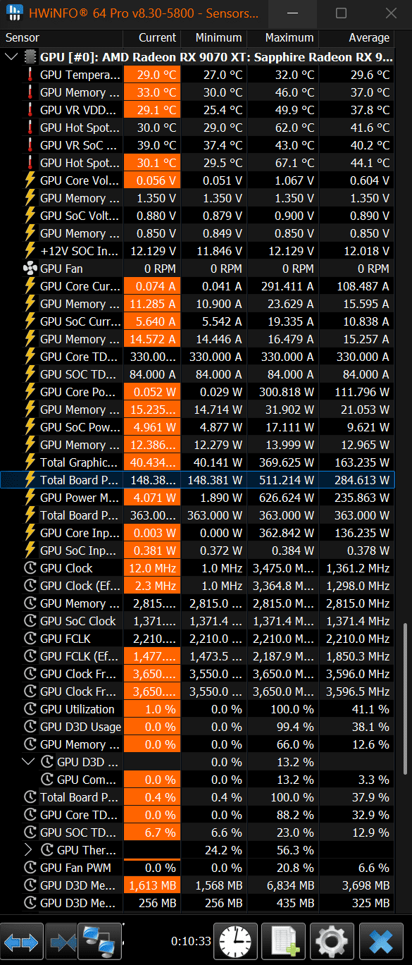

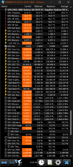

Ok best so far...pretty minor adjustments in linux
448w PL
+25mv gpu core
+50mv vram
+25mv vccdi
1.50 multiplier for TDC
I hit the PL easily...so gonna add a bit more to it.
Behaviour i noticed i had to drop the undervolt slider a bit -95 vs -105 or it would crash.kept core offset at +400(no idea what im doing with this yet!)
increase in hotspot temp from 54c to 61c at 448w..so plus 74w/ 7c...gonna see what i can get out of it on the loop before i try the chiller...then probably sub zero
Loop temp was around 25/26c
Also...why two hotspot temps now?

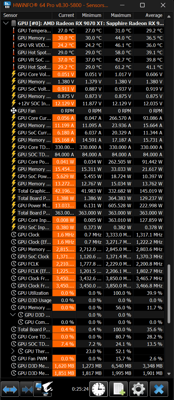

slowly creeping up
500w power limit...which im hitting again...
25mv on core only
Temps still manageable...still the loop..not even the chiller yet....gonna give it more juice but i guess the stupid 12v 2x6 cable is gonna be my limit...675 watts?!

7000 Punkte im Steel Nomad.
Does anyone know what the extra hotspot measurement relates to? Just another sensor position in the die?
