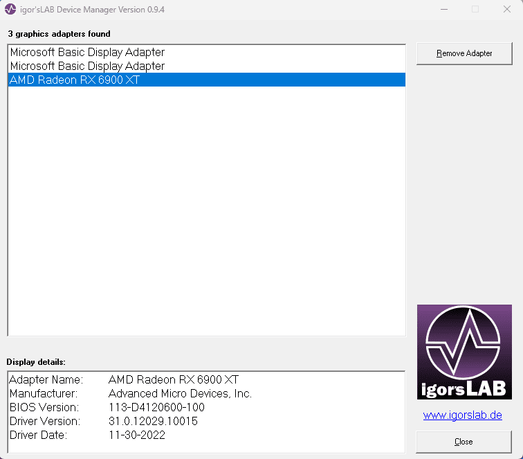

Ok guys got it sorted! I ran as root and I could save the bios..then just reverted back to sudo and did the force flash...so far so good..the rog stix t-16 6900xt seems to have flashed ok...mem min is now 2310...
Ps again sorry for the photo! It is just quicker for me at present!
Ran igors lab device manager and the one 6900xt comes up..gathering because of doing the flash after using DDU? Is it normal that I have 2 basic display adapters...can they just be left? Or do I delete?
Cheers all
Cheers all
Yes it is normal, new BIOS new device.
Not so important, but better delete them for the sake of clarity.

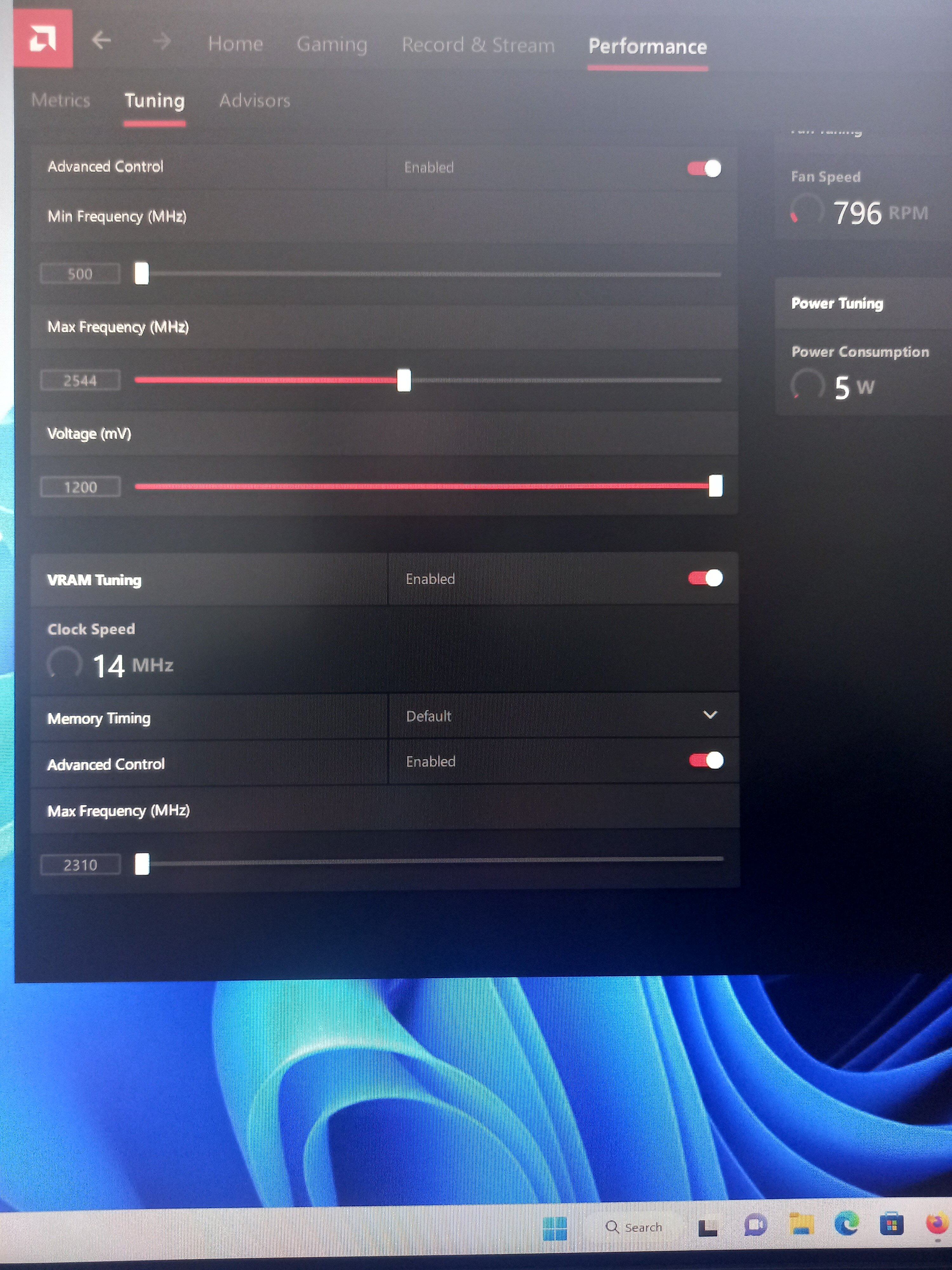

Ok thanks for the reply..I've got a bit of downloading to do now...new installation of Windows...just downloading MPT now...ive got this little rig hooked up to my chiller but am limited now by the factory AIO...waterblock should be here by the end of the week....then it's time to wring its neck! 😆😆
Ok..a couple of quick runs..will just write details for now...only messed with power limit...400w GPU,420 TDC and SOC 55
24083 graphics score...clocks in adrenaline were min 2606
Max 2750
Mem 2310 default timing
Hwinfo...gpu temp 66
Mem Junction 80
Vr vddc 75
Hotspot 91
Vr soc 65.1
Vddio 68
Vddci 62
So straight off the bat this aio won't cut it 😆😆
But a decent score with minimal effort...only adjusted power limit and slider in radeon software..
I tried going up to 450w gpu but got a shutdown lol....I've been there before with my other card...so won't push this one till the waterblock arrives..
P.s has MCT proved to be more stable or anything instead of using adrenaline? Or it's more to do away with the clutter of adrenaline itself?
