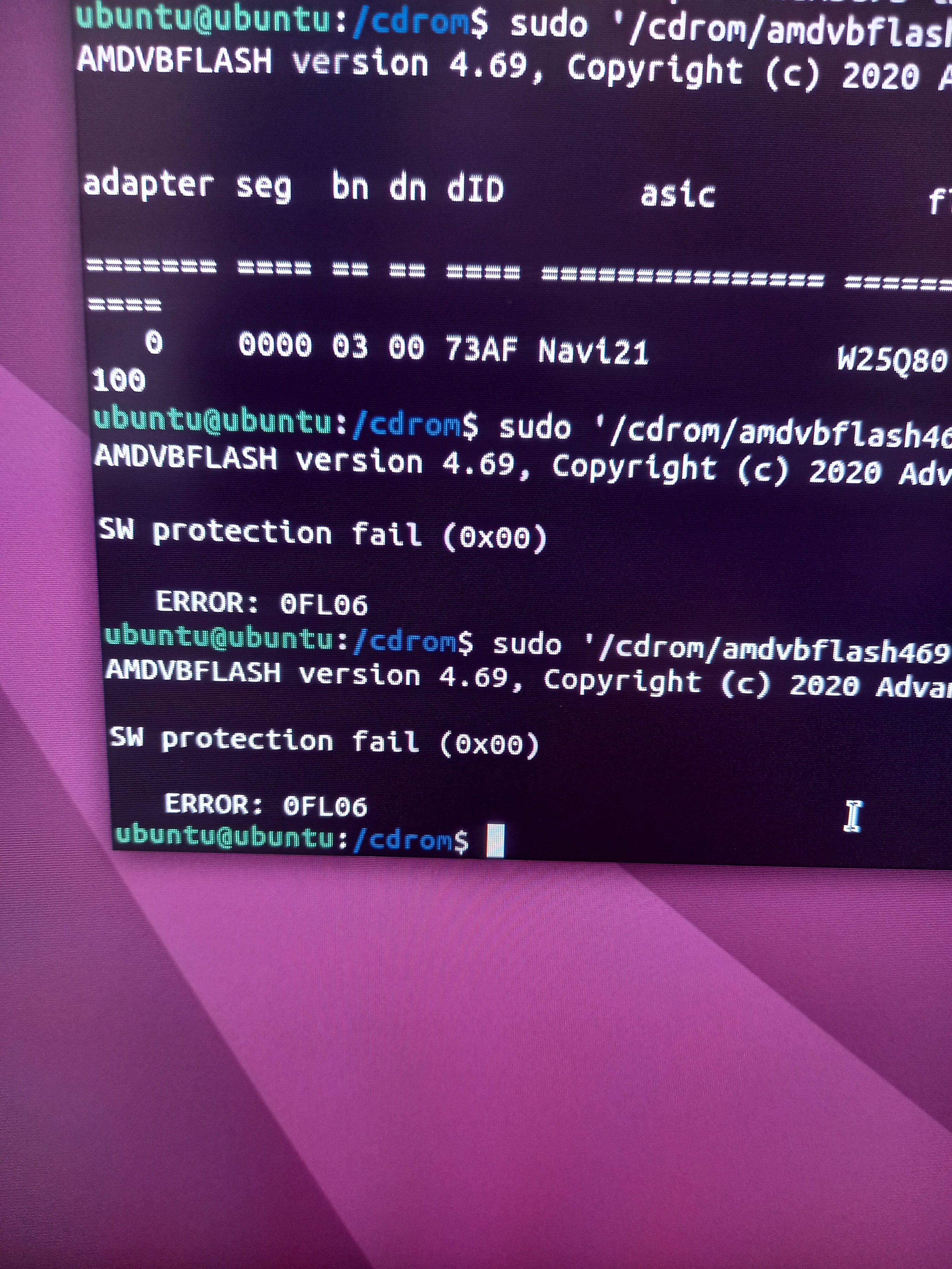

I remember that 0x00 is good..but I don't remember getting that error after..is that normal?
Oh had some old photos when I was doing the last flash and this looks normal...the last time the error message was shown also.Just another question...is it best to flash the bios after drivers have been removed? thanks all

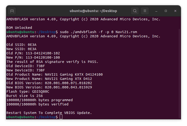

  4. Hier sind Anweisungen zum Flashen:
    in English:
    Nach meiner Erfahrung kannst du
    sudo ./amdvbflash -i
    sudo ./amdvbflash -ai
    weglassen.
Entferne Treiber mit DDU vor dem Bios Flash. Windows erkennt sonst hinterher ggf. zwei Karten, und dann musst du es ohnehin tun.
Muß man nicht unbedingt.
Wenn man öfters hin und her flasht spart man sich die Treiberinstallation.
I checked that guide...I won't have to unlock rom? As the 0x00 means it's unlocked? Or I should use the command anyway? And what is the last command after the flashing command? With V?
Wenn das ROM unlocked ist, genügt eigentlich der "f -p 0"-Befehl.
Ohne Gewähr, auf eigene Gefahr.

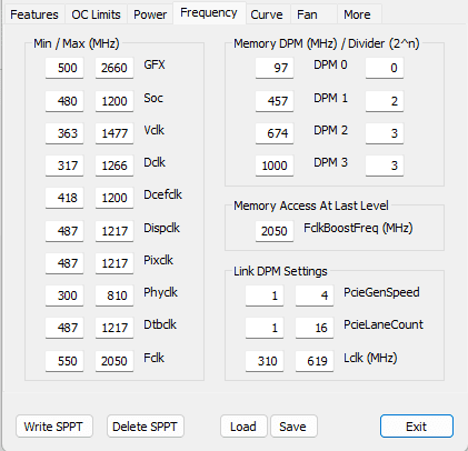

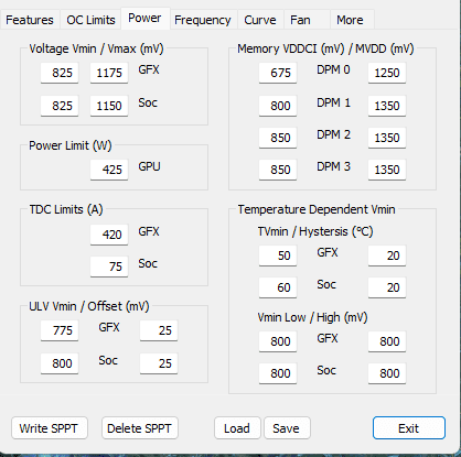

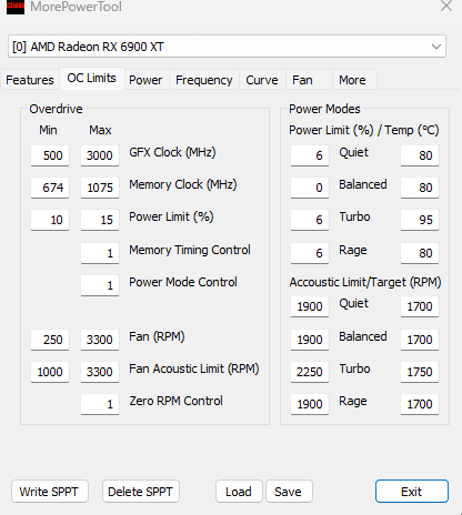

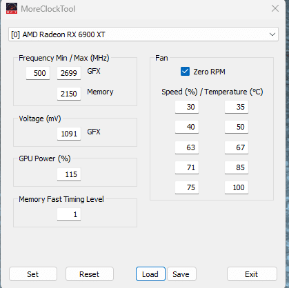

Kleines Update von mir.
Leider war der 24033 TS Score nicht lange stabil genug, hatte einige Freezer bei langer Nutzung.
Hab im MPT nichts hinzugefügt. Lediglich die Voltage erhöht, seitdem ist endlich Ruhe.
Die vorherige Voltage mit 24033 TS Score, lag bei 1066mv.
Die neue, die jetzt Tage lang stabil läuft ist in den angehängten Screenshots ersichtlich.

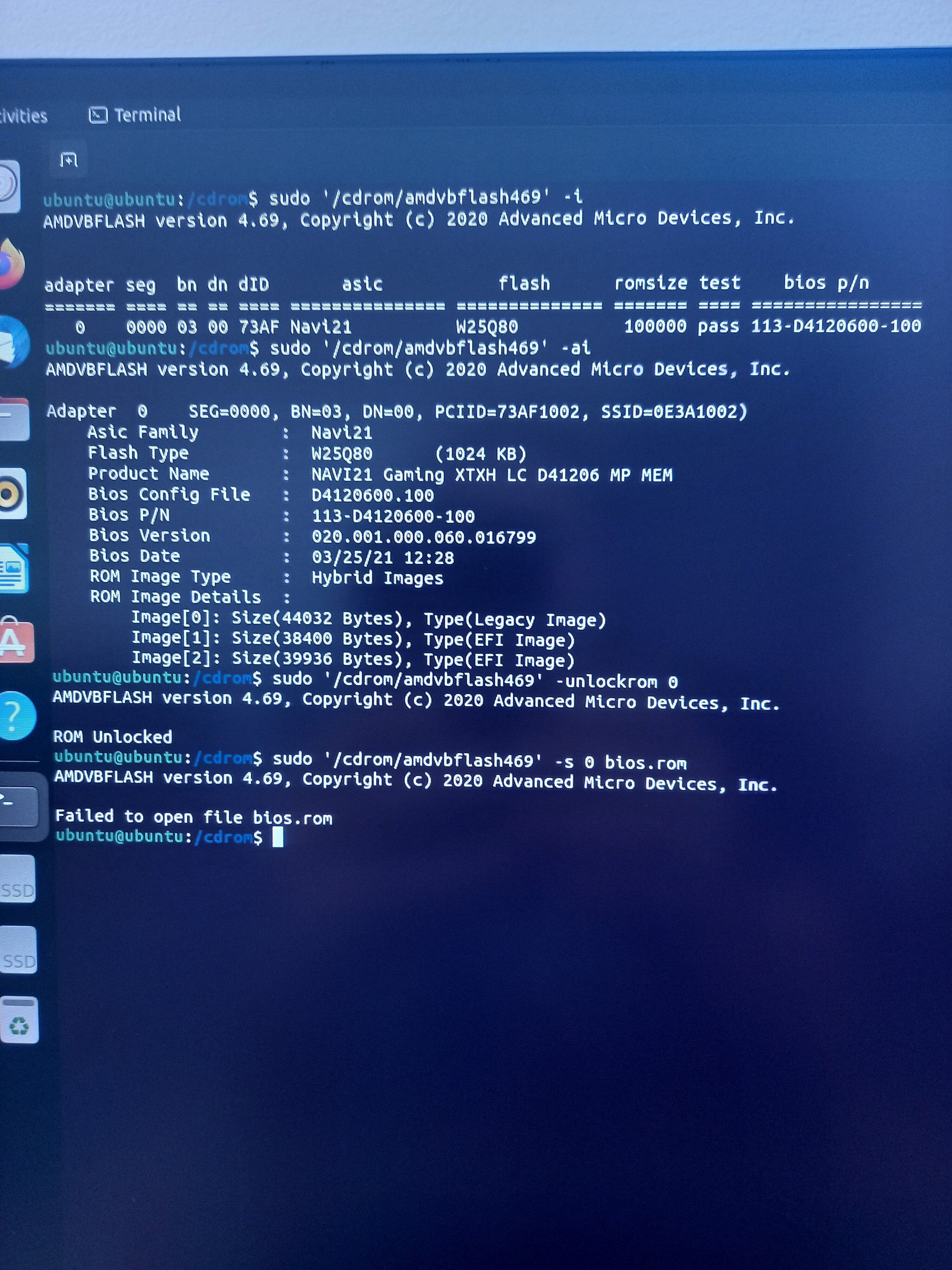

Ok guys I have hit a snag..i can't seem to save the orig bios first?
Sorry for the photo again!...its just quicker for me at this time.
At first I didn't use the unlockrom command as I thought that was the problem when I tried to save it first.Then I used the unlockrom command and tried to save but same story
I mean I could save it in gpuz but just wondering why I can't save it during this process?

If I run the same command again it just locks up then I have to restart the pc

Should i just save the bios another way and go with the flashing? Or because of this problem the flash won't probably work?
