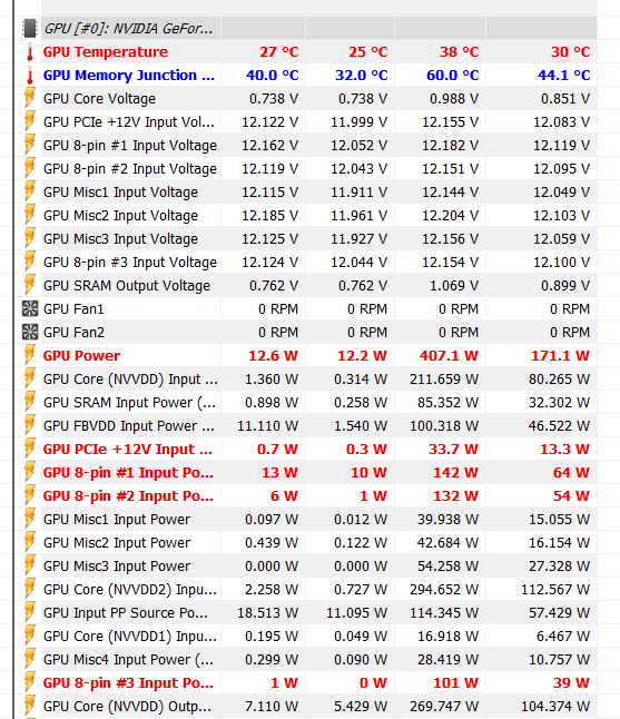

HWiNFO v6.42​
  • Added monitoring of GDDR6X Memory Junction Temperature on NVIDIA RTX 30-series.
A note regarding the new GDDR6X Memory Junction Temperature:
Just like in case of Navi, this is not the external (case) temperature, but internal junction temperature measured inside the silicon.
So don't be scared to see higher values than other common temperatures, it's expected. Also the limits are set respectively higher (throttling starts around 110 C).
