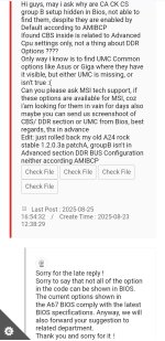

Every platform and every board handles the C26 (especially the H16A) differently and you either like it or you don't. If you 've followed @Induktor over the last few days/weeks, you'll notice that his C26 H16A kit from Gskill doesn't work with his MSI board.
Yeap, 6000C26 Neo's kit supposed to work with all boards, especialy best on boards with DDR BUS groupB mapped in Bios from default, like Asus or Giga where CA CK CS groupB=60 set ODT Up=43,6 can be manually tuned to run 8400GearOFF flawlessly, pretty sure this wonder Neos are not designed exclusively for Asus
Giga
Just but MSI bios code has been running always in different structure, diff. mapped RAM setting, in lack of UMC Common Options visible, DDR Bus Configuration CA CK CS by groups A & B are hidden cant help you on MSI
Obviously we know group B is still there, doesn't matter which Agesa's version, but not for MSI enthusiasts, it looks like a bit lame answer in respond from MSI little tech support, don't we?
But no worries only hope still remains one of new MAX
lineup coming October, MPower earlier already tested :sneaky:

Great, so Here these Neo's should be either my smart move for MPower, cuz MSI mobos are lack of visible groupB in Bios neither one of DDR BUS config sections Thanks
