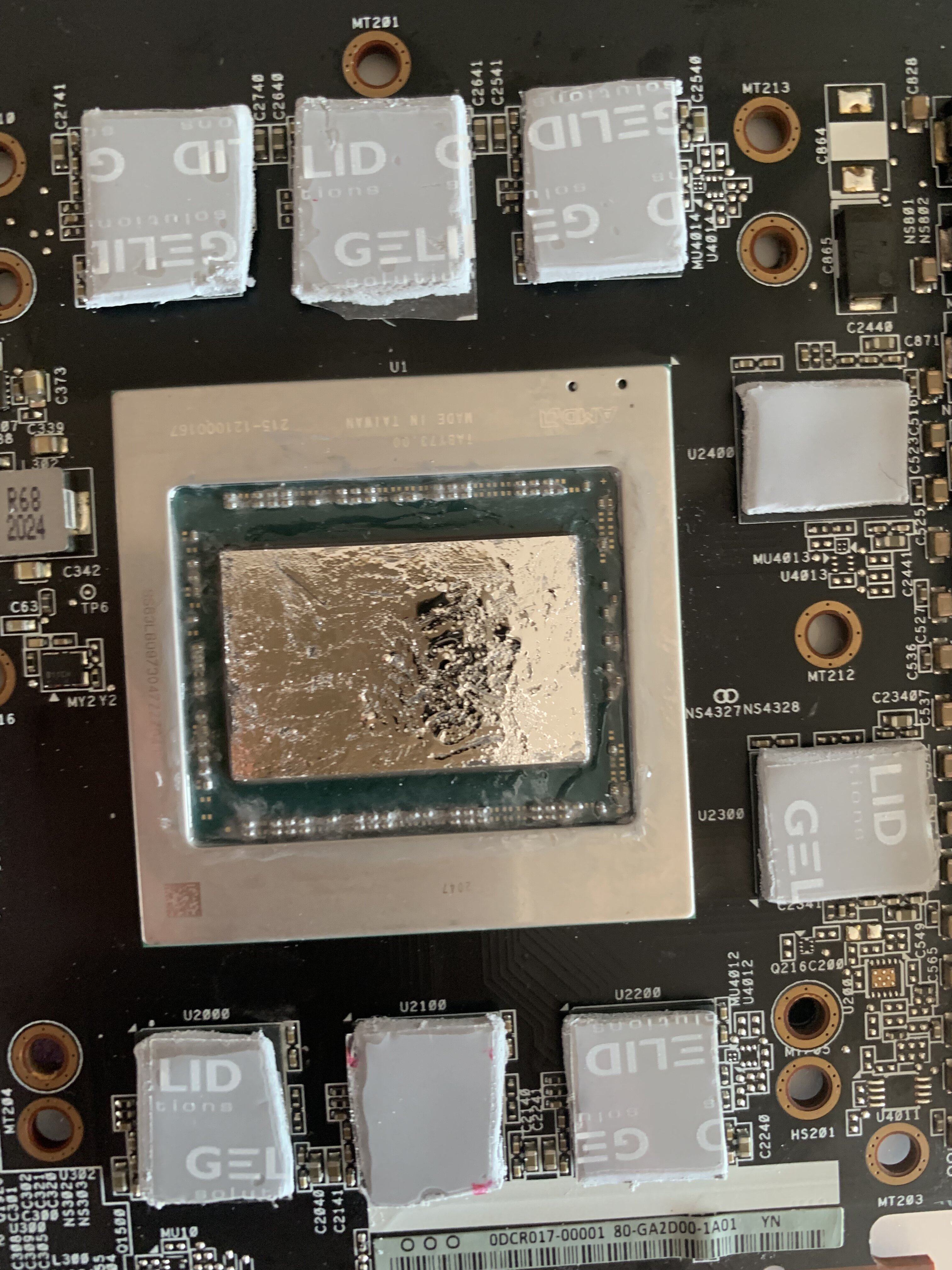

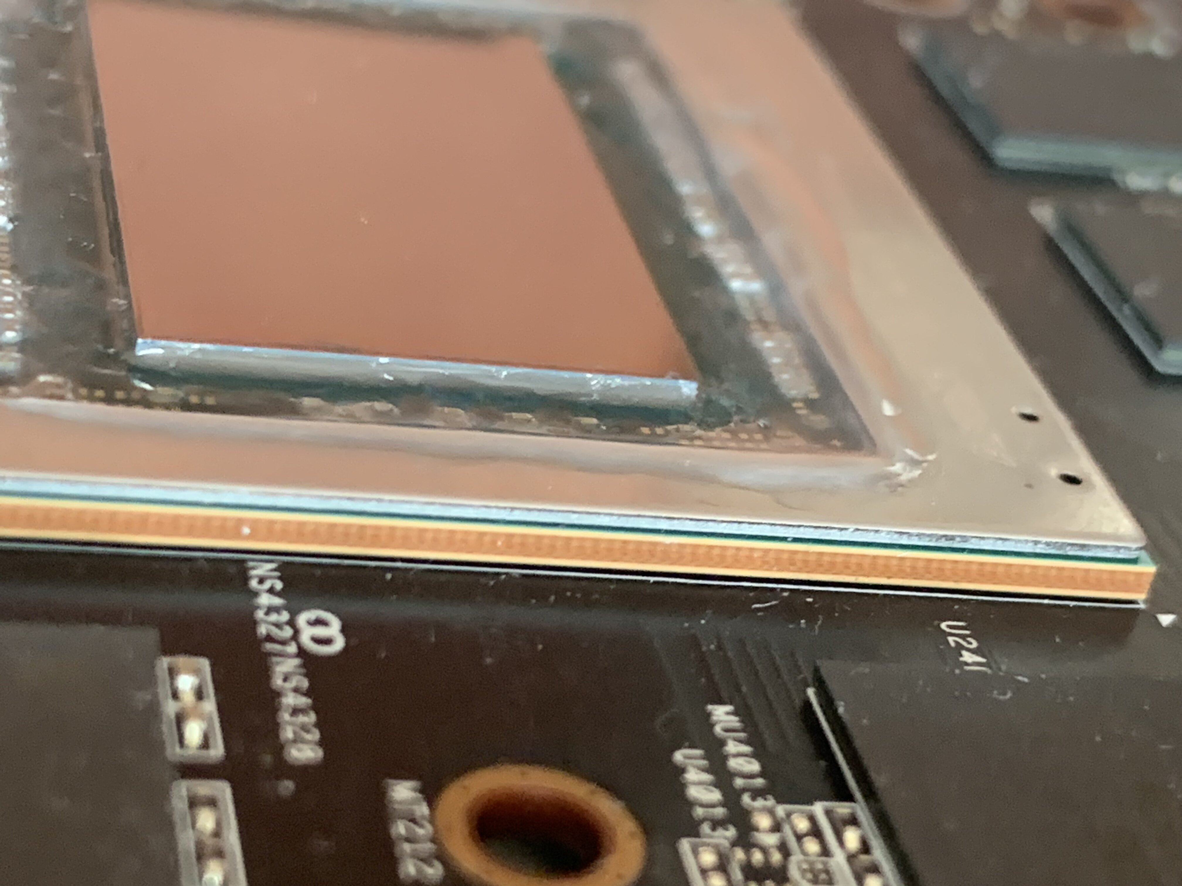

There is nail polish on the edge (side) of the die, will it be a problem?

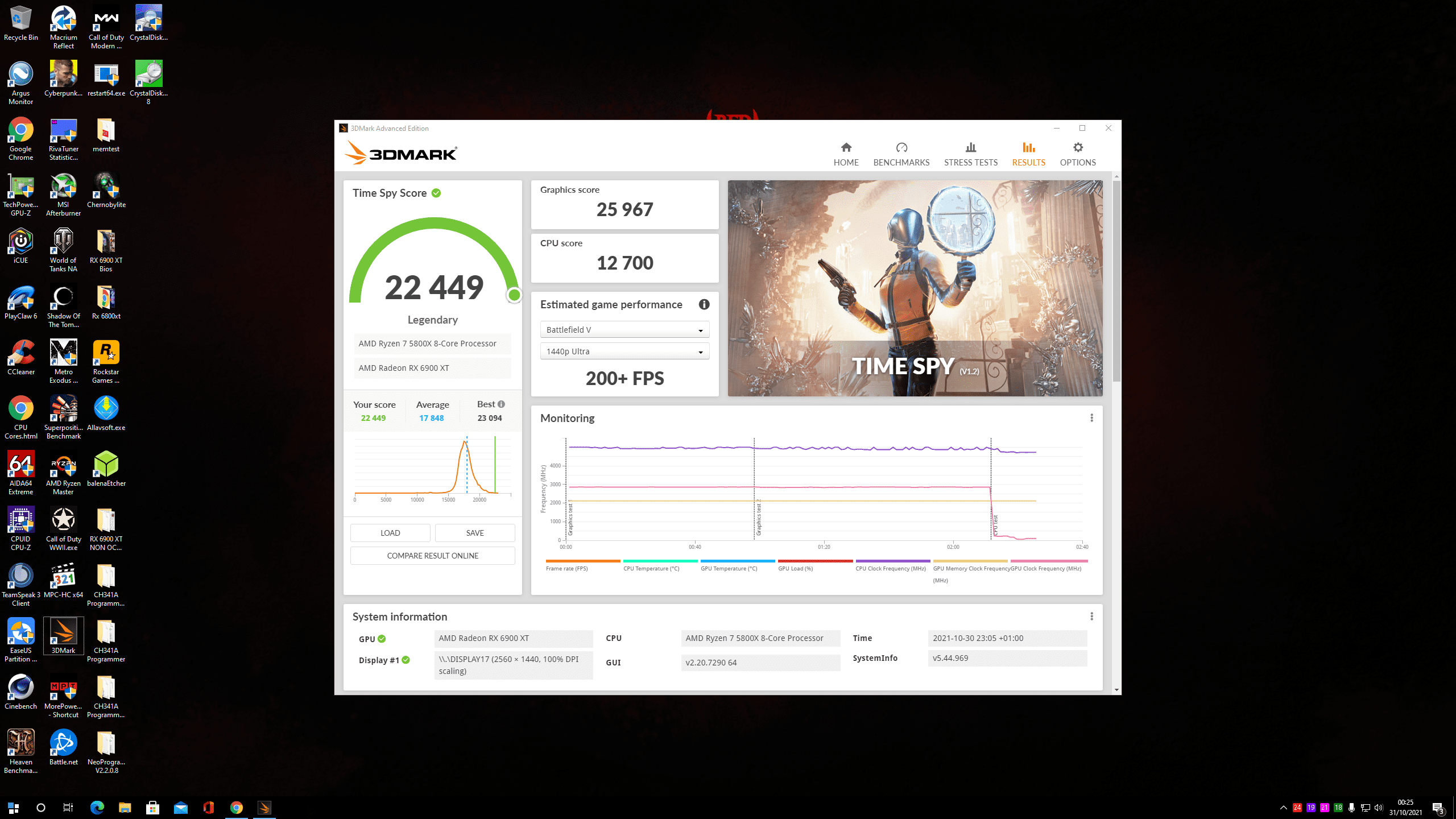

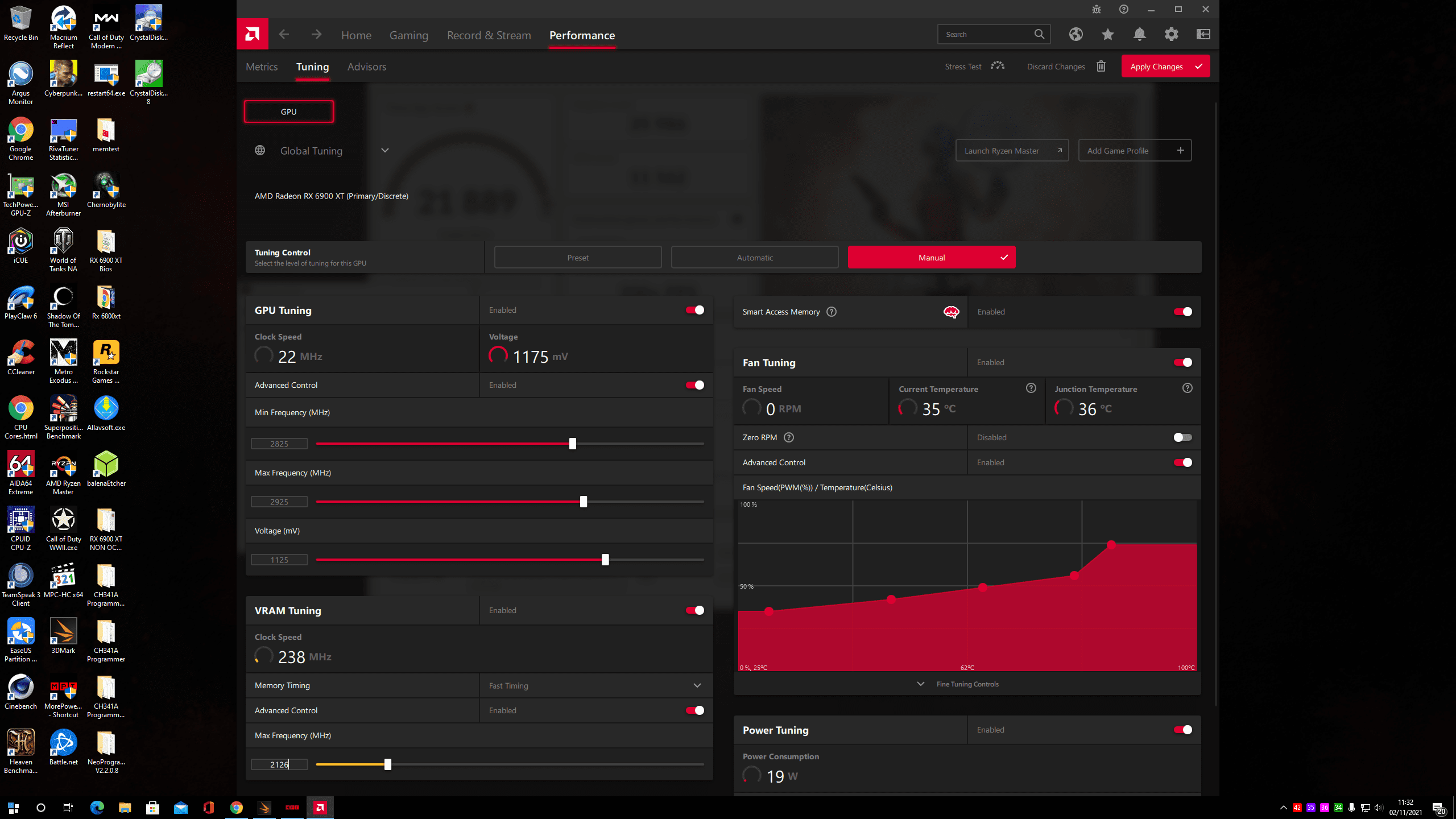

So close and yet so far for a 26k score I'm only 14 points away, maybe I've reached the limit of my card?, My Vram won't go over 2126mhz without losing points and I've tried to put some tension on vram, but it doesn't help much, i can continuously hit i 25900 points without crashing but i just can't hit 26k, i ran this at max 2995mhz when i go higher on the core clock to say 2997mhz the score goes down to 25800, so i'm losing points, maybe i'm clock stretching?, any suggestions to get me to 26k guys?, thanks for any help
No, I don't think that will cause any problems.
as long as it is not on top
So close and yet so far for a 26k score I'm only 14 points away, maybe I've reached the limit of my card ?, my Vram won't go over 2126mhz without losing points and I've tried to put some tension on vram, but it doesn't help much, i can continuously hit i 25900 points without crashing but i just can't hit 26k, i ran this at max 2995mhz when i go higher on the core clock to say 2997mhz the score goes down to 25800 , so i'm losing points, maybe i'm clock stretching ?, any suggestions to get me to 26k guys ?, thanks for any help
have you already turned the FCLK and the SOC clock?
You are benching on your 24/7 OS? Doing it on a "Bench-only" OS could net you the missing points.

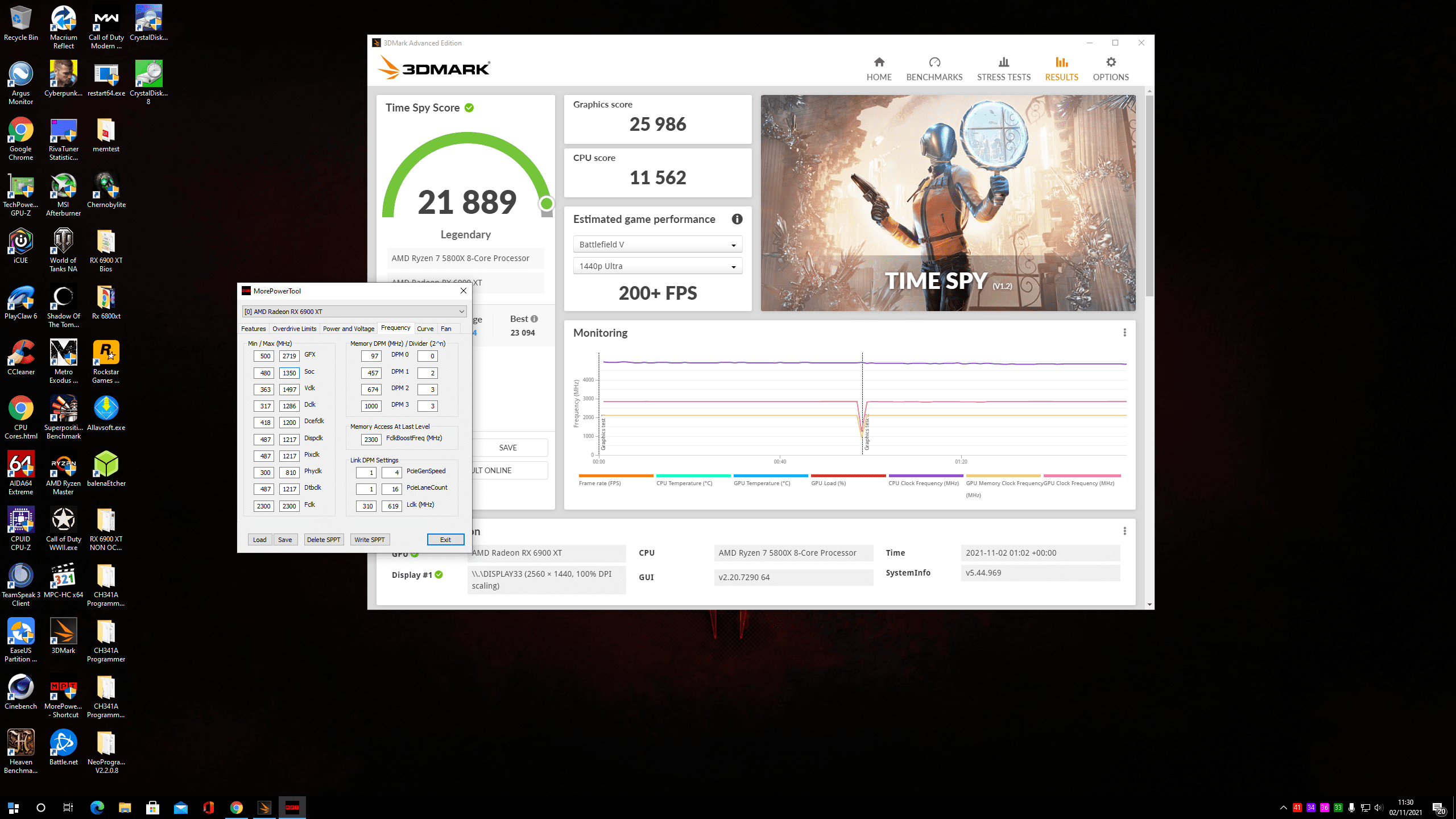

looks good (y)

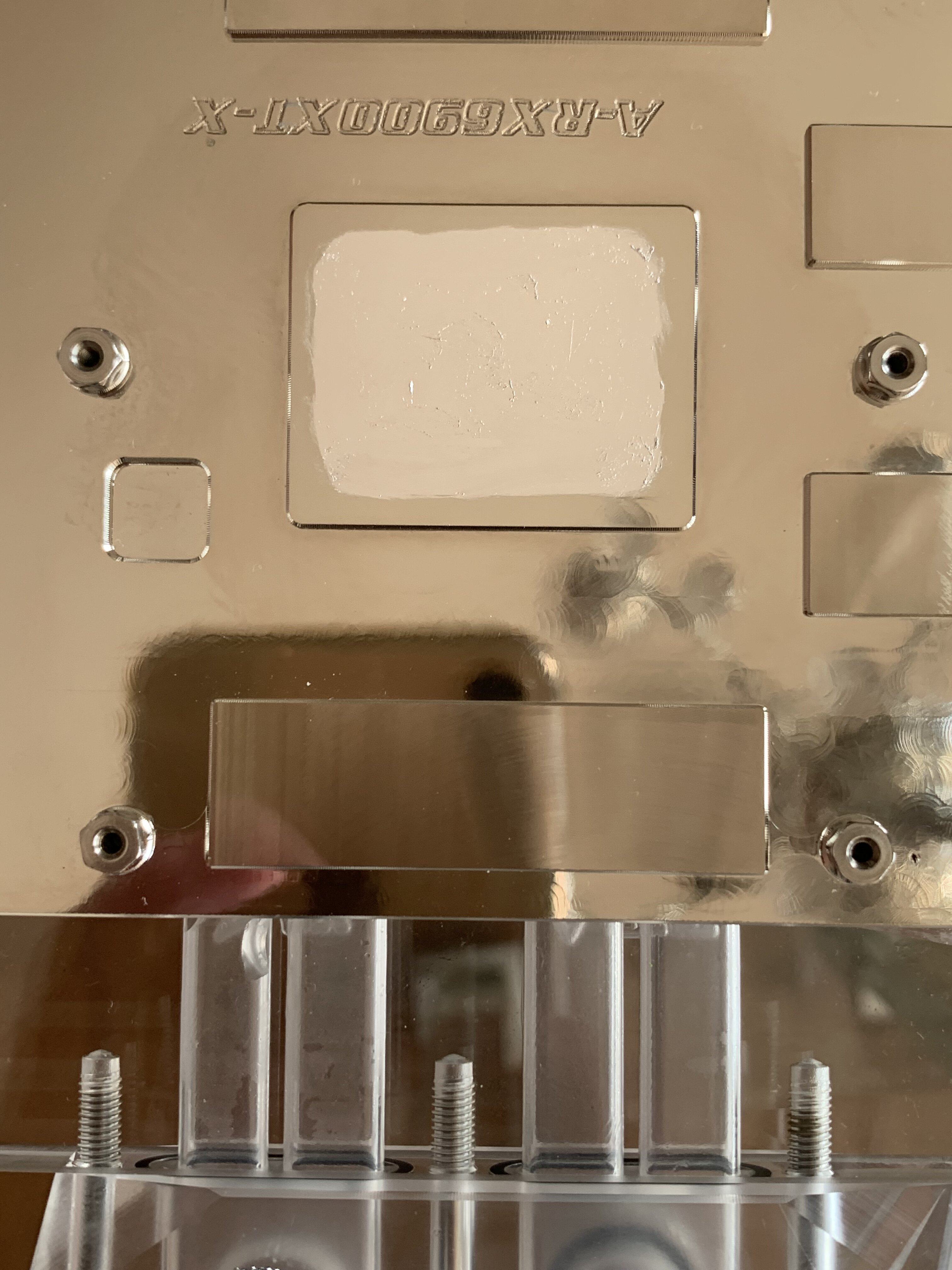

You better cover the whole square and make sure its well spread to the edges and corners of the die.
The die is 100% covered. The reason I didn’t cover 100% of the waterblock is because when I opened up the card and there was thermal paste, I saw that the thermal paste didn’t cover all of the square on the waterblock, the edges were empty. So I left it empty again so that the LM doesn’t touch anywhete unwanted

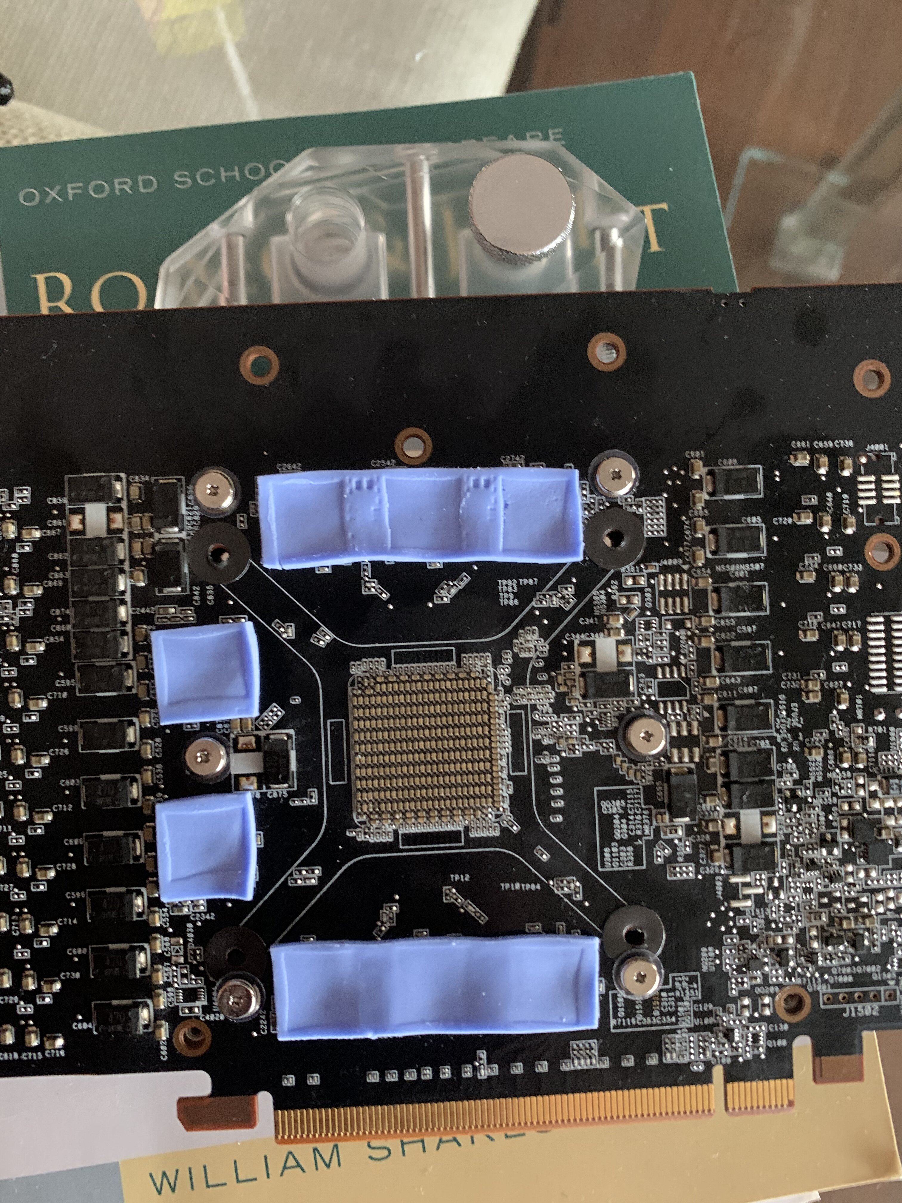

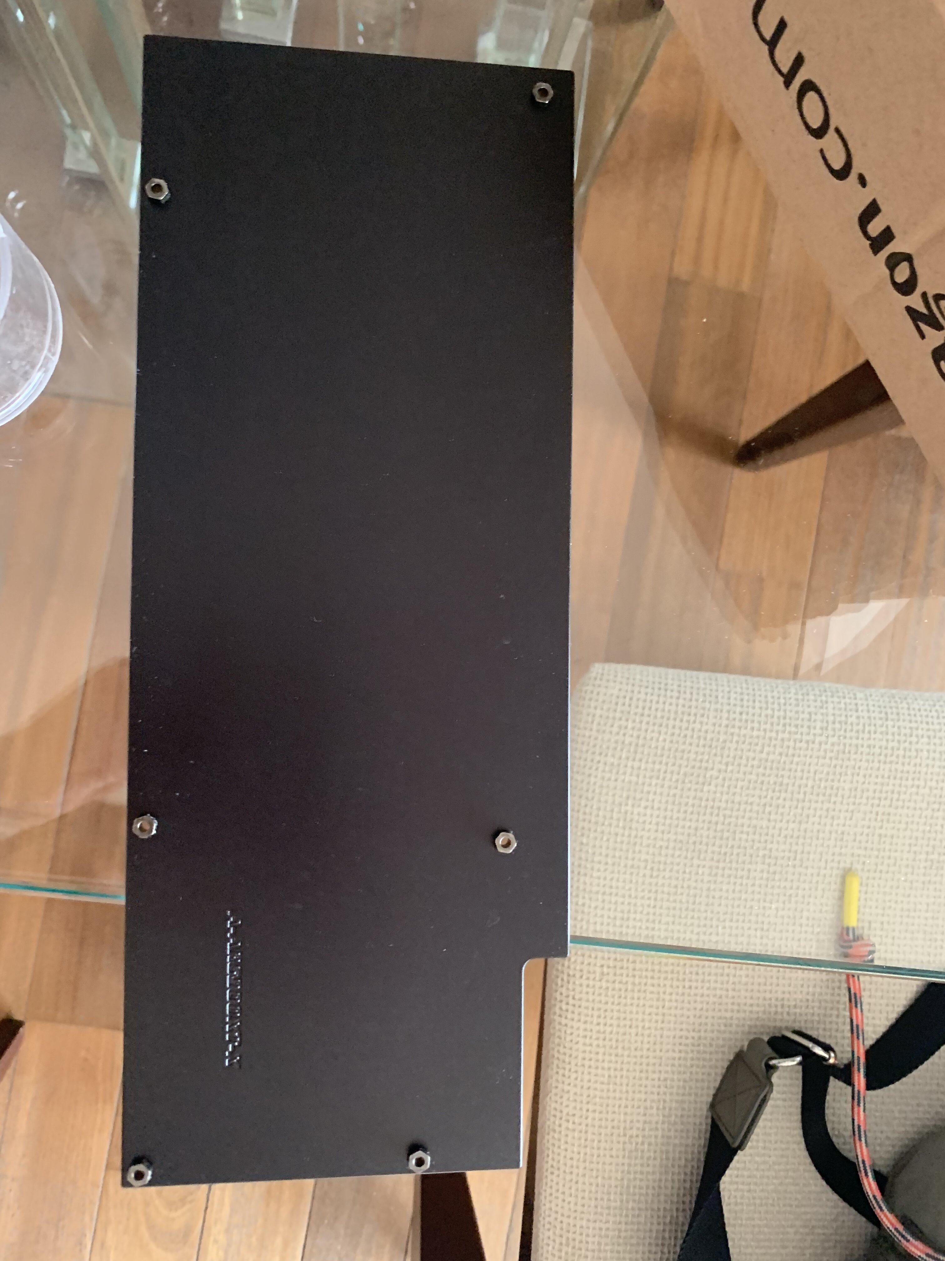

@Holzmann @RedF The backplate doesn’t have any cut outs for thermal pads, can I still put pads on the backplate?
on the backside of the card you better can hit the Vram for example
use the bykski pads ...

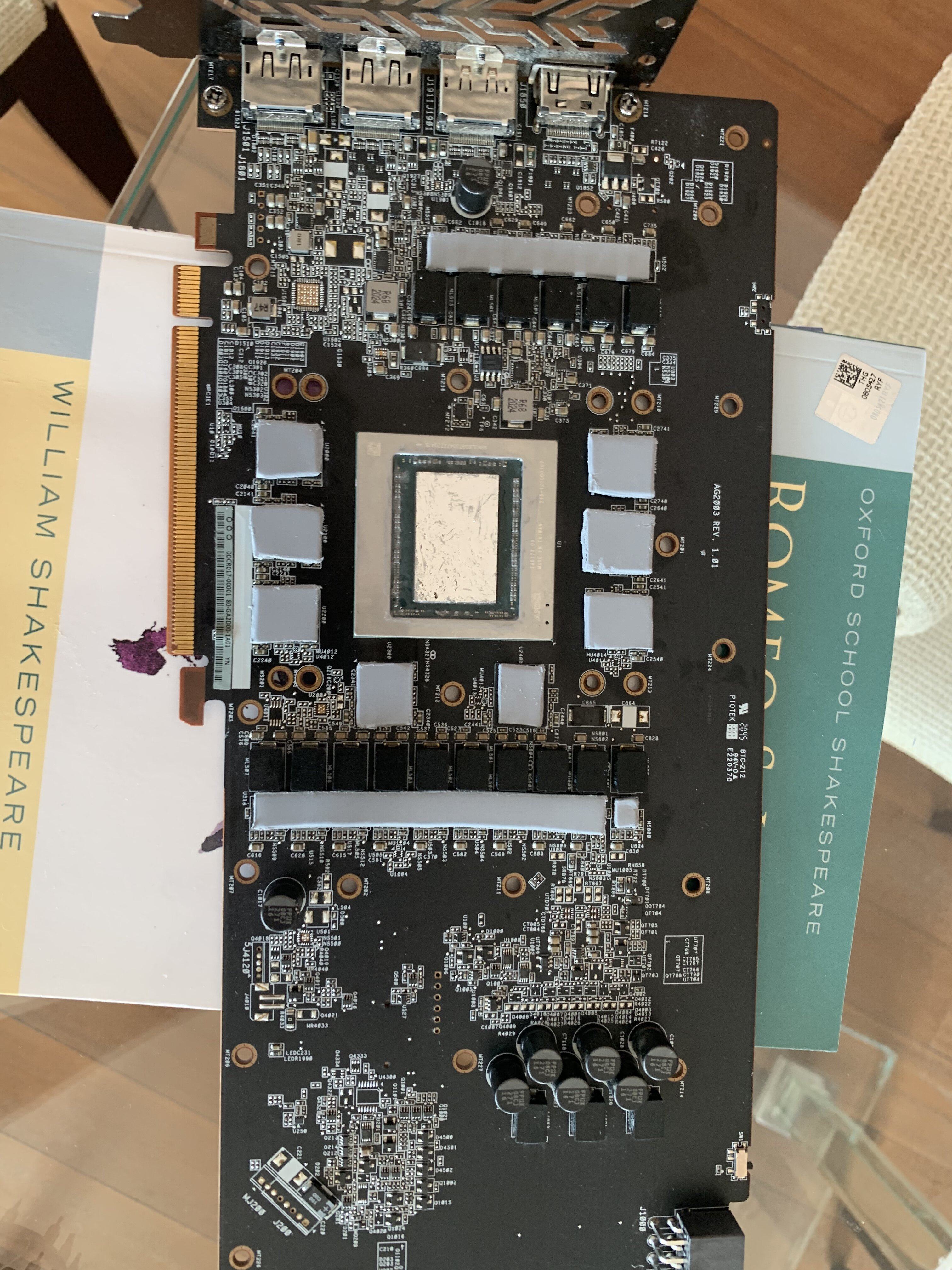

This is correct right? Should I also do the VRM or is it unnecessary
looks good!
