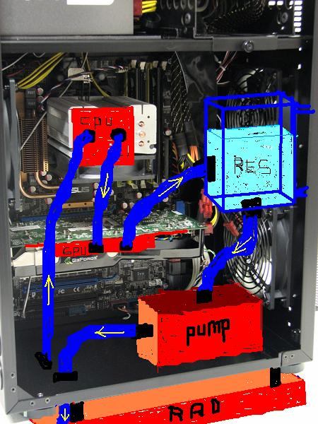

I have some questions about the aquastream XT Pump, i choose to come here after long searching the internet for reviews wich i couldnt find much. Until i came here. I do think you guys have more info and advise because a whole topic is made for the aquastream XT Pump wich is very good!
Any way i'm planning on ordering one of these pumps for sillence and reliability well its like a bmw for pumps:wink:. First i wanted a Swiftech MCP655 pump wich is sillent to but the 25WATT that means more heat output in my case (while the aquastream has 5WATT). Can one of you tell me if the aquastream XT is MORE sillent then the Swiftech MCP655 pump? And a very important question is will the aquastream XT fit in a Lian Li Tyr PCX-500?? see links:
http://www.techpowerup.com/reviews/LianLi/Tyr_PC-X500/3.html
http://i253.photobucket.com/albums/hh42/LeetRyan/S5000130.jpg
http://www.overclock3d.net/gfx/articles/2008/10/13100134965l.jpg
If you guy's could answer these questions i would be very gratefull
A: Is the Aquastream XT more sillent then the Swiftech MCP655?
B: Will the Aquastream XT fit in a Lian Li Tyr PCX-500?
To give you an idea what i mean here is a picture:
Thanks in advance... and my apologies for the english. Hope you guy's can help me.

Welcome to the forums :bigok:
A: The Aquastream is way more silent than the Swiftech MCP 655 (which seems to be a Laing D5).
B: The top port of the pump is the Outlet, not the Inlet :) This could be a problem with your planned setup...
Thanks for the reply,
thanks for the welcome!
Yes your right about the inlet didnt see that coming. I have to adjust making a new setup.
But i'm a little bit worried although its a good pump the aquastream XT but its the size that worries me. I provided some pictures to see if the pump would fit without to much problems in the lian li Tyr x500 case. What do you think will the size of the pump deliver no problems for the case??
Thanks in advance
Welcome, sniper!
The size won´t be the problem, you can use the AS in normal upright position as well as lying on its side as well as hanging (inlet to the top). There are several possibilities, you could play around a little bit ... Do you already have the Swiftech Res?

Cool what you did posting your setups not 1 but 4 of setups, nicely done buy the way, all those different setups! That give's me a little understanding how it wil look in the lian li Tyr x500 case, its almost the same space as the lian li like the idea of pump and res in one picture 3, best pictures of the pump that i could find thanks! As for the Swiftech mcp655 no i do not have that pump. Do you sence more noise without the foam underneath the pump? Or if you want a more sillent opperation is it better to use a foam? Like this:

Hi Sniper! Since you got that few space, why not trying a laing with exchange top like a EK X-top V2 and a poweradjust. This Setup should also be silent and more silent than the swiftech.
Don't get me wrong the XT is a nice pump with lots of options & features, but in terms of space the laing is just unbeatable.
@Sniper
Neither Aquastream, nor Laing DDC or MCP655 are really silent without a piece of foam for absorbing the vibrations... You will have to find a solution to keep the vibrations away from your case.
