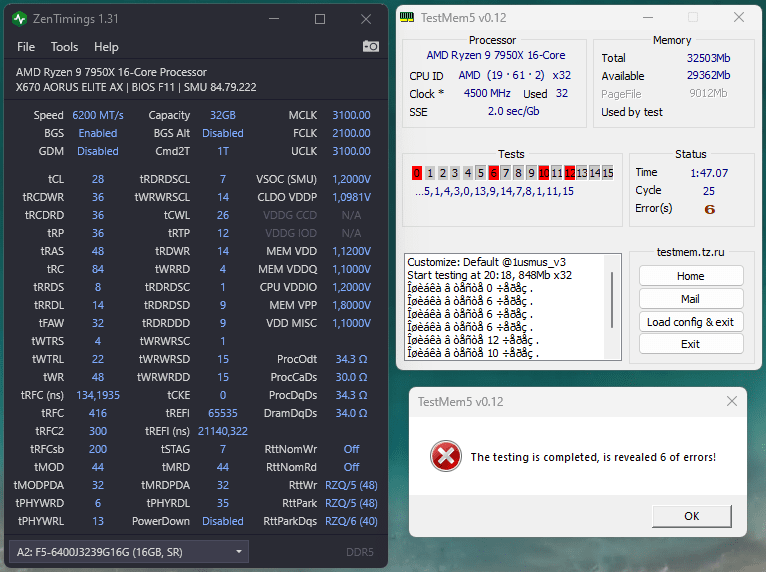

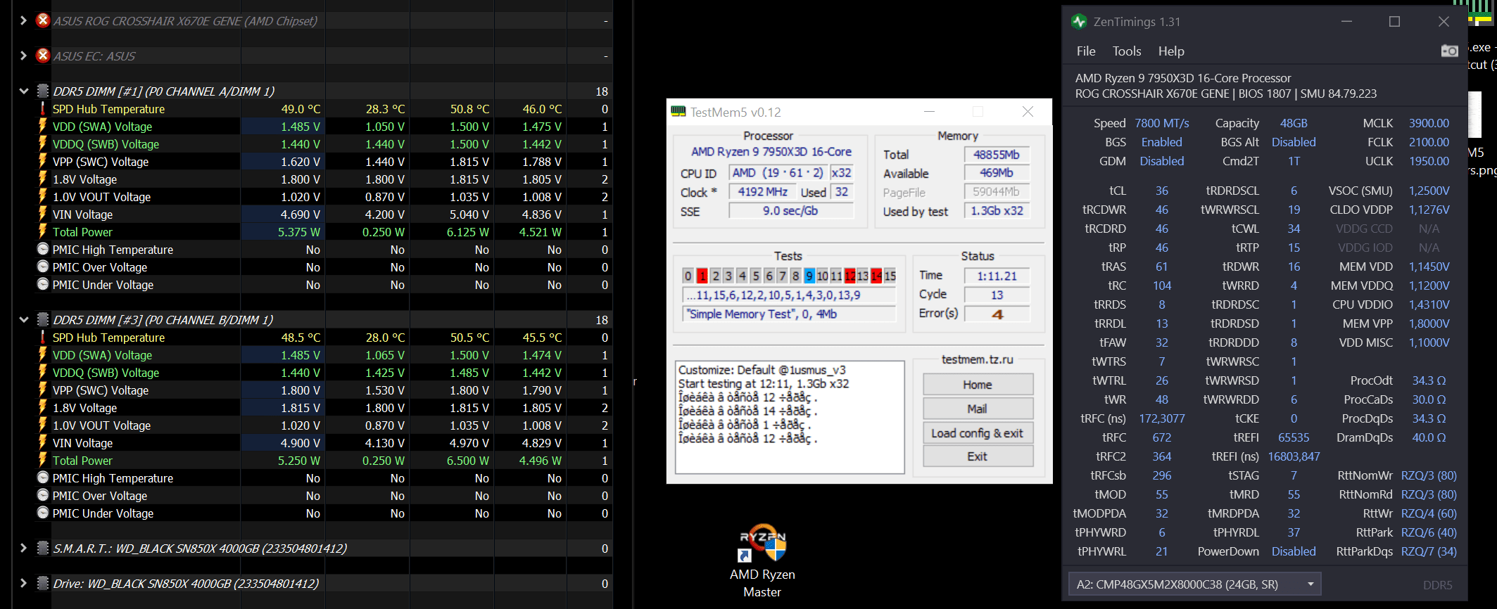

tWTRL ist zuu niedrig.
Außer das Board lässt dich nicht über 22, was eigenartig wäre.
Du nimmst zuu viele Schritte auf einmal.
Die 2ndaries sind absichtlich hoch
Und die Tertiaries ebenso.
#6 CPU side issue
#0 Dropped link to mem (fehlende VDDIO oder side-issue)
#12 kann zu #6 gehören
Es fehlt wohl einfach an Spannung
VDDIO und SOC.
Aber die Timings hast du dennoch zu richten :)
tWTRL doppelt von RRDL
tWRRD auf 17 ~ vorerst.
Solange du GDM nicht stabil "aus" hast
Brauchst du dich nicht auf den Timings zu fokussieren.

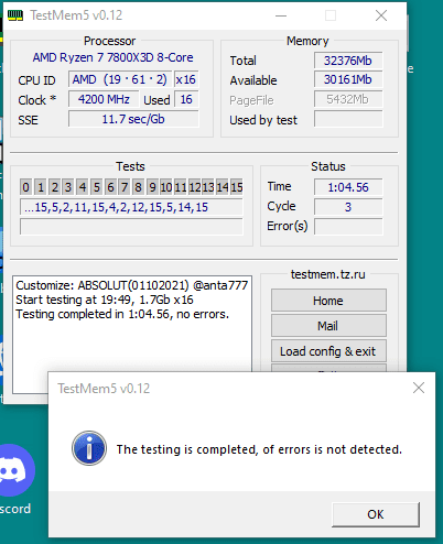

Hello Veii, I'm having issues setting up Tm5. It's been awhile since I used it, I'm not 100% sure how to load, set-up to run test, I'm not able to select the config file when clicking on the bottom right of TM5, it says "load config and exit" the files are gone, or the file is empty. I just get an error box that won't go away.
I was trying to use this version TM5: https://github.com/CoolCmd/3aIIyckaJIkaTestMem5/releases/tag/v2023.12.06.3
Perhaps that version has issues, I'm not sure,.. but I tried loading it and running it three times,.. I get the error box, config file empty.
I found an older version on OCN,.. TestMem5 v0.12: https://mega.nz/file/vLhxBahB#WwJIpN3mQOaq_XsJUboSIcaMg3RlVBWvFnVspgJpcLY
I'm using these instructions:
1/ Extract to a location of you choosing using 7zip or Winrar or similar. No renaming or moving required
2/ Run TM5.exe. All files are now English thanks to @Hequaqua for his idea 👍 and Extreme1@anta777.cfg is the default
3/ To change to a different config file is super easy. On the bottom right of TM5 it says "load config and exit" where you can select the config file required from the location you extracted everything to and it does the rest for you :) The next time you run TM5.exe the new config file will be the default.
Do you have any advice or instructions for me? I think I'm doing something incorrect, causing the issues. User error on my part.
Is TM5 v0.12 from OCN best option, I have Winrar to use for Extracting.
Thanks
@Braegnok
The application needs to run with admin permissions.
UAC will warn you to the amount of cores you own. And on the next pc restart it will just work
CoolCMDs Version is different.
@Braegnok
UAC will warn you about the amount of cores you own. And on the next pc restart it will just work
CoolCMD's version is different.
Thanks very much!
I wasn't running with admin permissions was main issue I guess,.. the CoolCMD version is different. That's good to know.
Going to load Tm5 from your link, and start over. Thanks. 👍
Cpu vddio 1.45 find ich bissel hoch. Geh mal auf 1.25. VDDQ kann 50-100 mv unter VDD.
Trtp kann bis 12 runter dann kannste dadurch tras trc mit der excelformel anpassen. Musst schauen ob es stabil bleibt. Die Stufen findest du in unserer Ram Timing oc excel
Sd timings bei 1 bzw. 0 falls es geht. trdwr kannst du auch mit unserer excel nach unten korrigieren

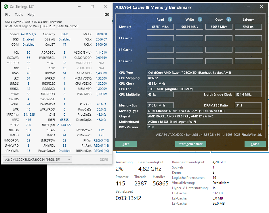

wir haben beide ein ASRock Board und 7200C34 Ram. Ich bin bei 6400/2133 auf die Schnauze gefallen. Vielleicht versuche ich es nochmal mit deinen Werten.
Sind die Spannungen im BIOS so wie ZT sie anzeigt? bei AM5 liest ZT da teilweise blödsinn aus.
Die Wiederstände alle auf AUTO oder hast du auch schon experimentiert?

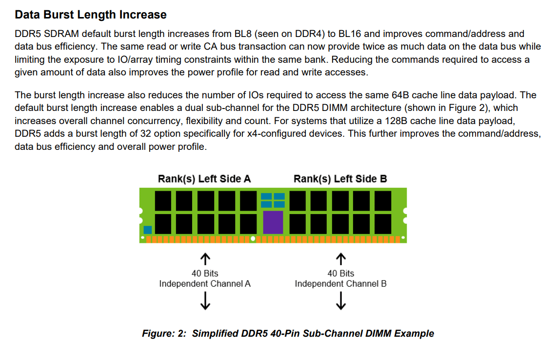

Sind die SD nicht für DR RAM bzw 4 Bänke
Dual Rank RDIMM läuft nicht auf Consumer CPUs.
UDIMM kann nicht 2 actions pro strobe, um den DualRank Titel bekommen.
_SD/DS wäre SameAction-DifferentSide
Kann bloß nicht "SameAction" sein, da UDIMM nur 1 cmd pro strobe kann.
SameDimm ansich.
Ah kurzgefasst, die Rückseite des DIMMs.

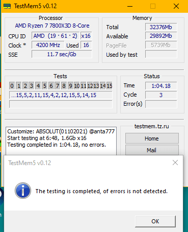

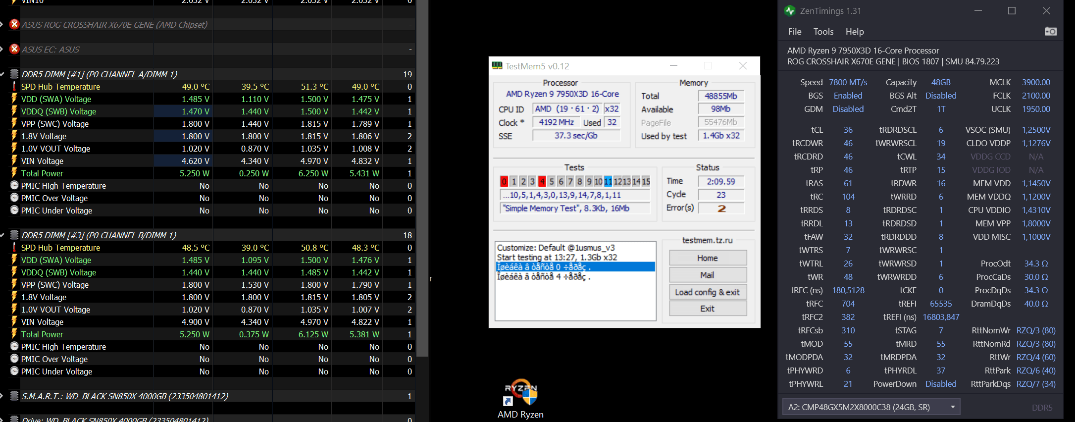

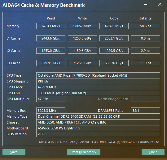

Mal wieder Zeit gehabt TM5 anzuwerfen nach 3 Tagen Cold Boot.:

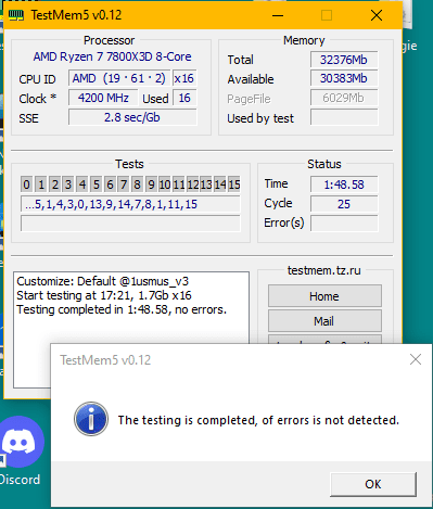

Habe dann die tWRRD 4->6 und tRFC 172ns->180ns ein Step up:
Habe jetzt noch ein Gskill 7600er 32GB A-Die Kit da, denke das werde ich mal reinpacken und schauen ob ich damit 7800 oder 8000 stabiler bekomme.

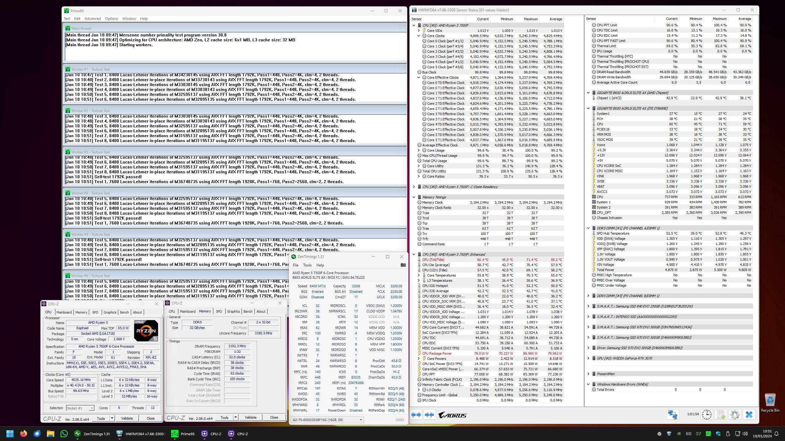

Hier mein Fortschritt:
Wobei ich zukünftig doch bei Anta Absolute bleibe. Geht schneller und ist mMn belastender fürs DDR5 Ram. RAM-Temparatur mit 1usmus 54°, mit Abolute 58°.

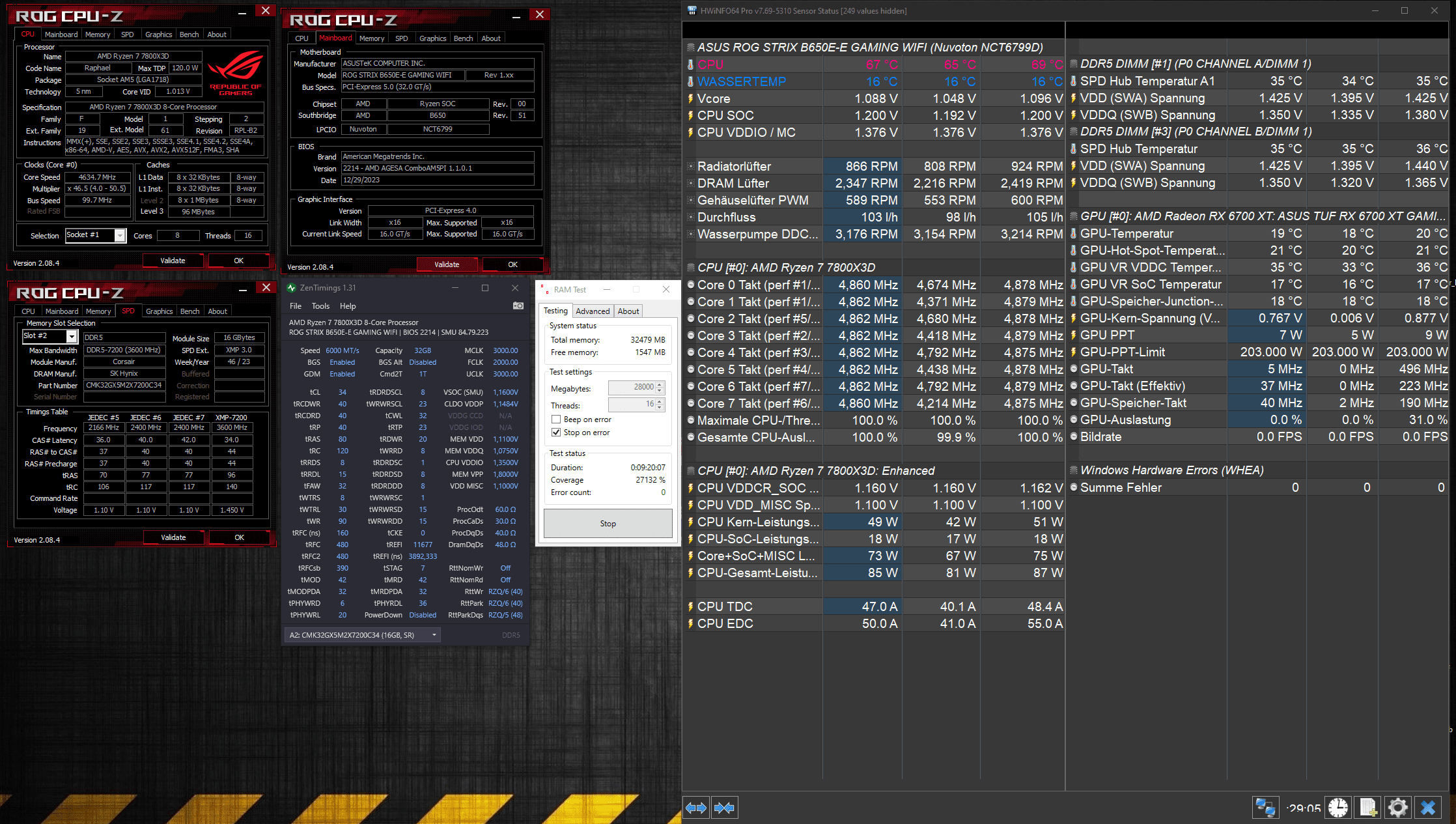

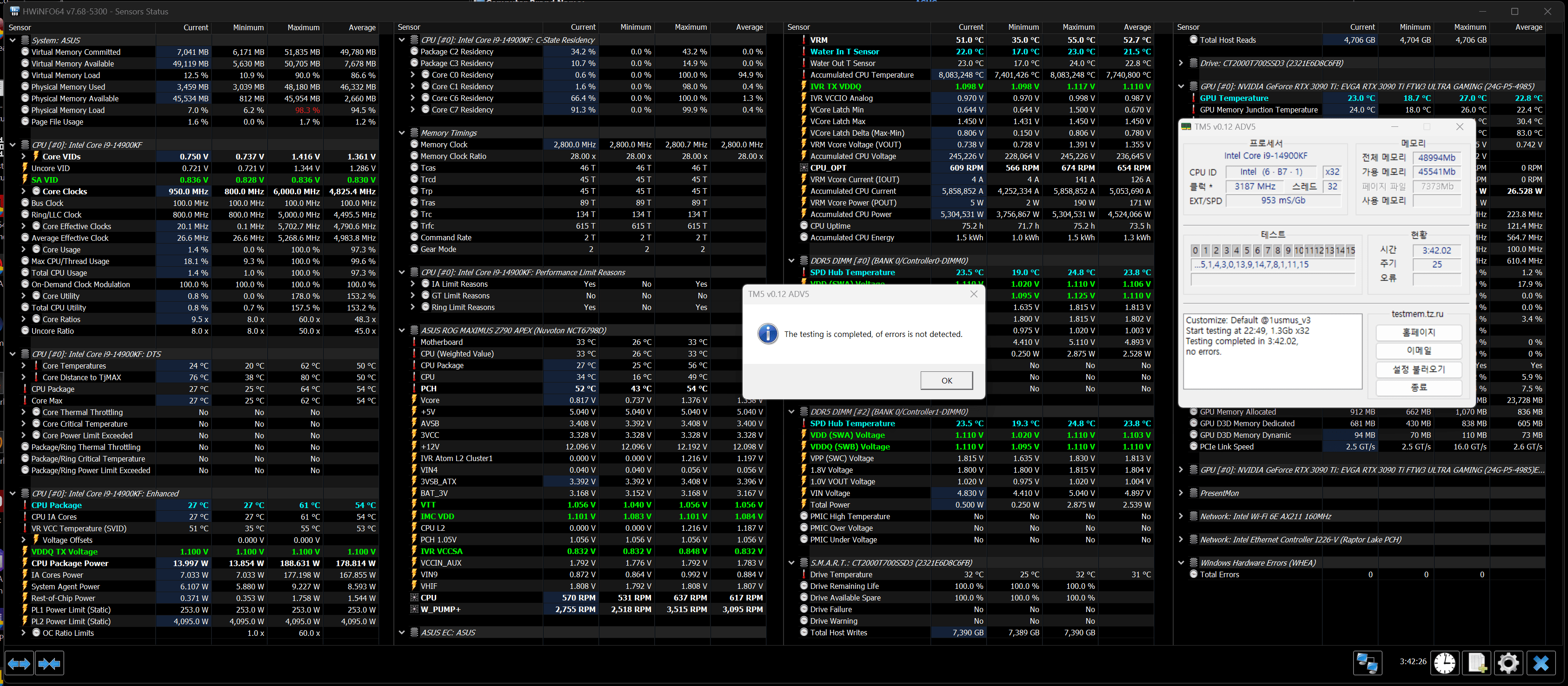

Hallo Leute,
ich hätte da mal eine Verständnisfrage.
Ausgangslage:
Habe wie auf der Bildanlage zu sehen gestern Abend einen Karhu-Test durchlaufen lassen mit 27.000% Abdeckung ohne Fehler. Aufgrund der Empfehlung aus der AM4-OC Zeit von emissary42, sollte man den Rechner neu starten und den Test nochmals wiederholen, was ich heute morgen gemacht hatte. Dabei kam ich aber nicht über 250% hinaus.
Habe nach etwas herumtüfteln folgende Werte geändert:
SOC: 1.135V (vorher: 1,185V)
VDD: 1,430V (vorher: gleicher Wert)
VDDQ: 1,355V (vorher: 1,350V)
VDDIO/MC: 1,360V (vorher: 1,350V)
Nun scheint der Test wieder fehlerfrei durchzulaufen.
Werte von letzter Nacht (27.000%, 0 Fehler)
Fragen:
Ist ein niedriger SOC-Wert als 1.15V hier wirklich so ausschlaggebend?
Oder eher die VDDQ/VDDIO-Werte und sollten diese lieber "gleich" eingestellt werden oder VDDIO besser etwas höher als VDDQ?

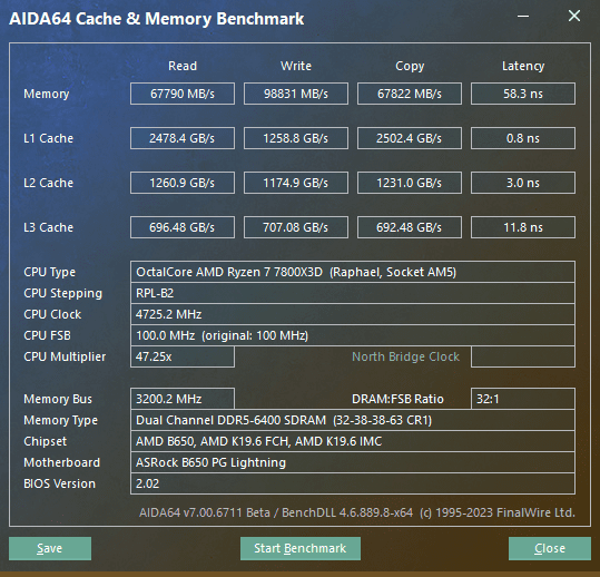

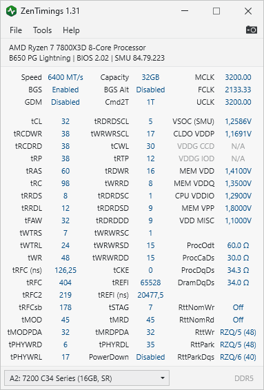

@Sockrattes
anbei ein Screenshot meines aktuellen 24/7 Profil
das System packt dank RTT Anpassungen auch 24h Prime95 large FFT AVX bei ziemlich entspannten 1.36V MEM VDD
ich fahre mit 200mV Differenz zwischen MEM VDD <-> MEM VDDQ ganz gut - mein nächstes Ziel ist 6400MT/s mit FCLK 2133 MHz bei möglichst niedrigen Spannungen
Besten Dank für die Denkanstöße.
Achja, bei mir liest ZenTimings die Spannungswerte von MEM_VDD und MEM-VDDQ nicht korrekt aus. HWInfo zeigt hier die plausibleren Werte an.
Ich werde mal deine Spannungswerte probieren.
Dein "Processor On-Die Termination" ist niedrig. Ich habe hier mit 60 Ohm getestet. Werde ich auch mal in die zahllosen Versuche mit aufnehmen.^^
ProcODT ist mehr oder weniger try&error - ich finde leider trotz intensiver Suche im Netz keine belastbaren Informationen welche "perfekt" sind ^^
habe alle möglichen Kombi's durchprobiert - bin aktuell der Meinung das dies für meinen RAM -> G.Skill 6800CL34 @ 6200CL30 der beste Kompromiss darstellt
btw wenn du RAM OV betreibst kann ZenTimings keine akkuraten Spannungen auslesen - das liegt aber eher an ZenTimings welche die Register nicht richtig auslesen kann wenn du den RAM OV Schalter benützt

Ich habe nochmal alles wie von dir vorgegeben konfiguriert und einen TM5 Test durchlaufen lassen. Einzig den FCLK habe ich wieder auf 2133 Mhz gesetzt. Ergebnis ist gut, also kein Fehler. Mit welchen Schritt mache ich jetzt weiter? Ich möchte nicht wieder zu viel auf einmal machen.
Danke vorab!
Gruß

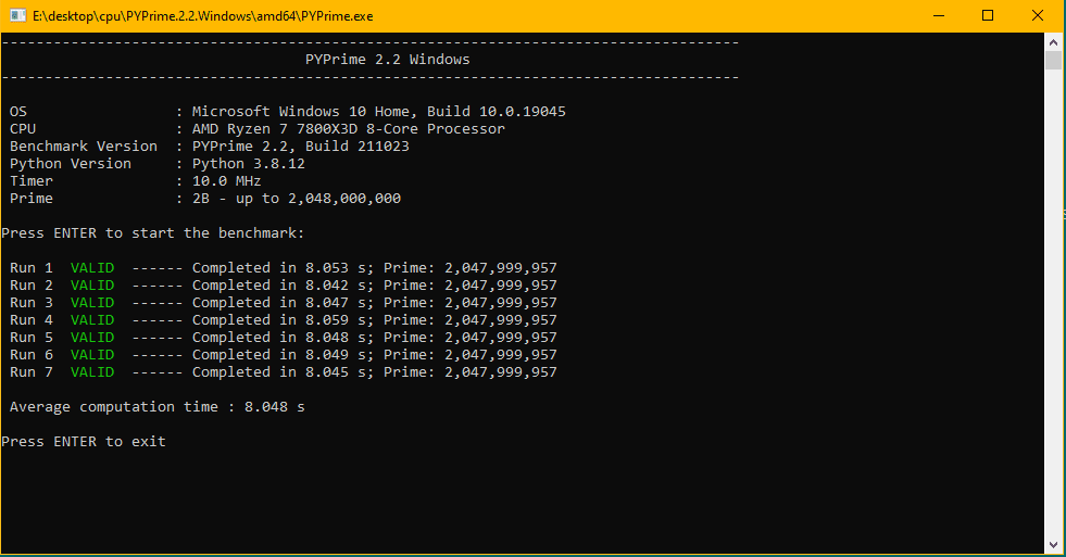

@gimme7 Es geht auch 2167 bei mir :banana:
Schaut für mich schon ganz gut aus. Aber wie schon geschrieben leidet beim Wechsel von 2133 nach 2167 die Latez ein bischen. LinPack leidet auch um 3 GFlops...
Zum Test ging auch ein Boot mit Aida Bench mit 6600/2167 :d

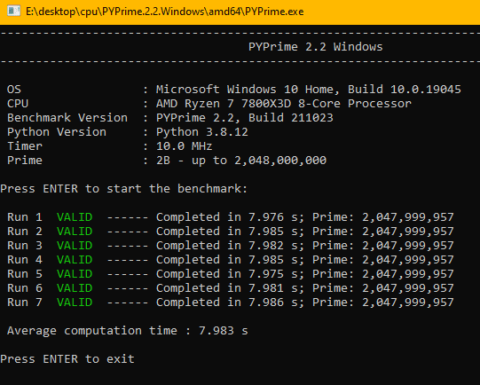

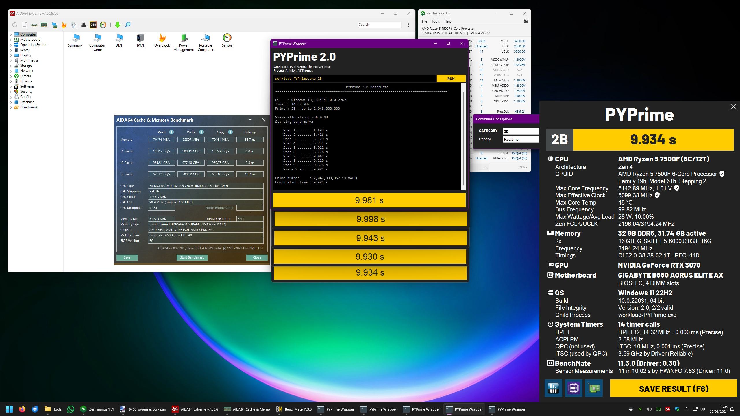

ich stöbere ja auch in mehreren Foren und für AM5 hab ich da auch noch nicht wirklich was zu gefunden. Irgendwann wird es auch etwas overkill mit den dann möglichen Kombinationen.
Deine RTTs sehen interessant aus. Wie bist du da vorgegangen? Ich hab alles auf Auto gelassen bis auf eine einzige RTT Anpassung von Veii.
Einen interessanten Eintrag, ich glaube es war im allgemeinen AM5 Thread auf PCGH hab ich zur PocOdt gefunden. Da hat das herabsenken dieser einen deutlich messbaren Unterschied bei den FPS in Cyberpunk? bewirkt.
ich habe/hatte keine konkrete Vorgehensweise - sehe immer wieder mal ZenTimings Screenshots mit diversen Kombinationen, diese probiere ich dann stumpf aus
bei manchen Kombi's hatte ich "das Gefühl" wenn mein System unter Vollauslastung (Prime95) steht das alles sehr zäh geht wenn ich dann z.B. Programme öffne obwohl alles stabil war ^^
die aktuelle Kombo funktioniert in soweit sehr gut als das ich bei 6200MT/s meine erforderliche MEM VDD & VDDIO um 200mV senken konnte im gegensatz zu vorher :banana:
leider sind mir keine belastbaren Tests bekannt nach ich denen ich mich rantesten könnte - ausser halt die diversen Empfehlungen von @Veii :wink:
aktuell beisse ich mir die Zähne an 6400 aus - will eigtl. meine Timings/GDM etc für 6400 nicht großartig entspannen, leider kann ich damit nur booten aber selbst PyPrime friert im ersten Schritt schon ein :fresse: ist also noch ein weiter Weg dahin...
