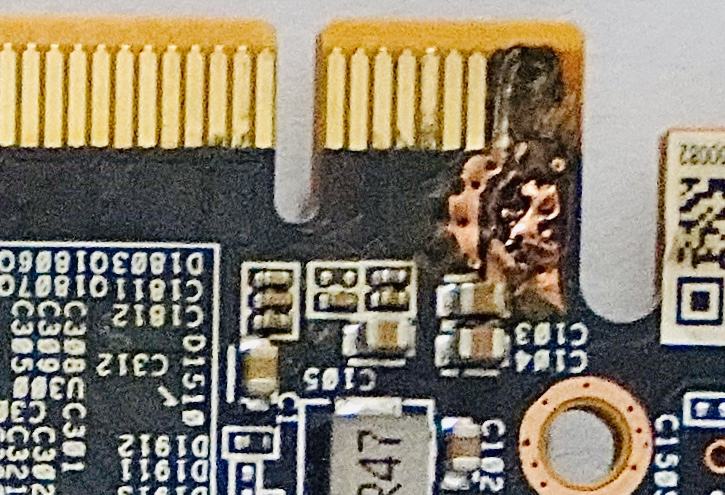

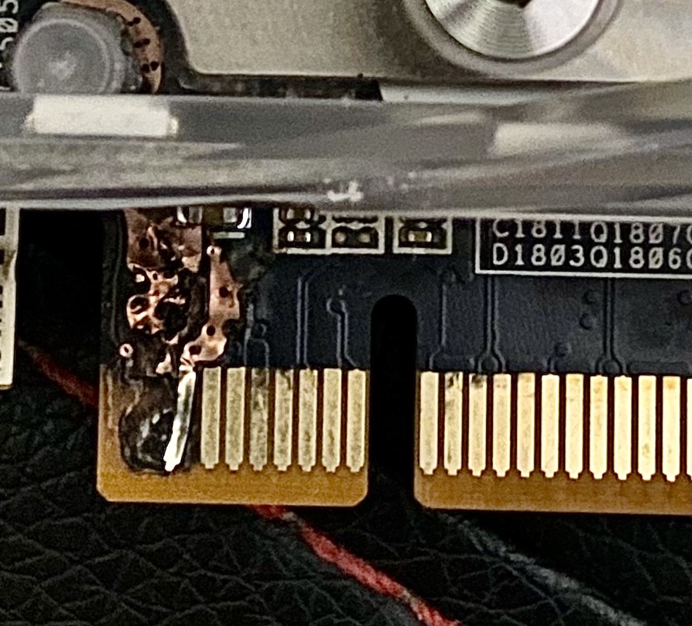

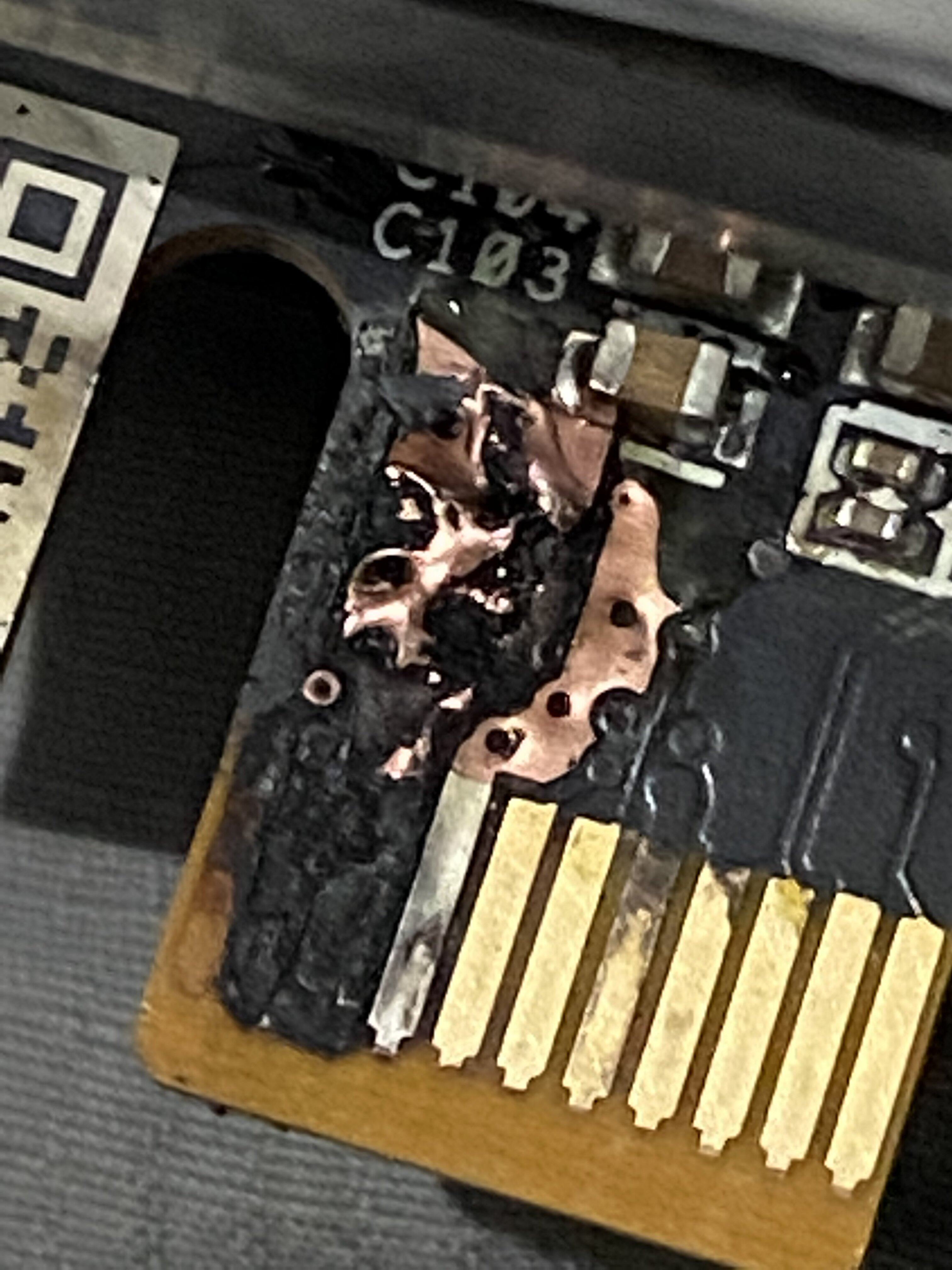

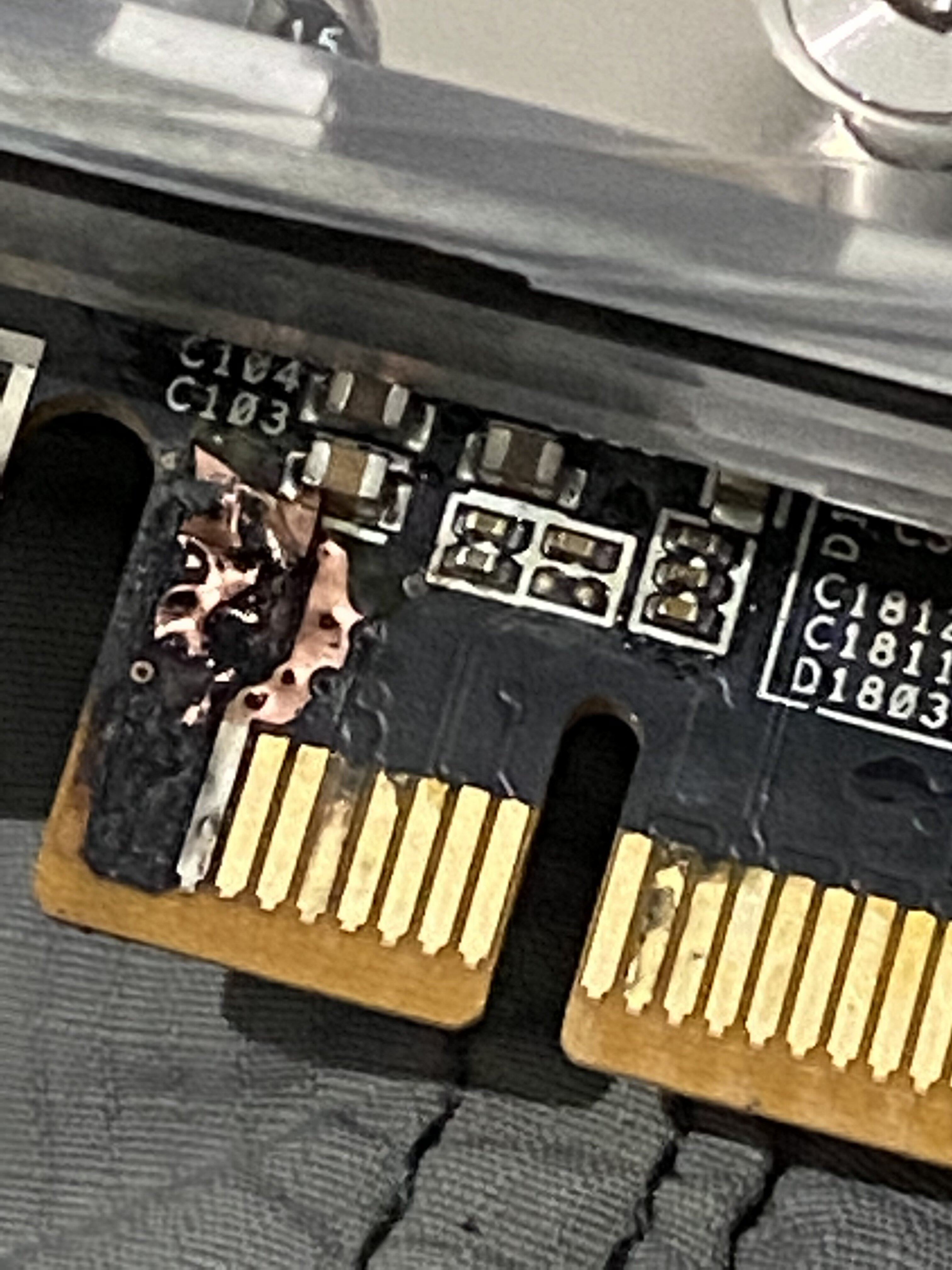

Sorry I don’t think you can expect anything more from me because I think I destroyed my 6950 XT. :(
I got myself a chiller and successfully ran some benchmarks this morning. Then I thought I should stop because condensation was bad.
Anyway, I was able to use the PC for about an hour (my boy playing Roblox), with the chiller off) and then we got a blue screen of death. Restarted the PC and it wouldn’t post (LED for RAM lighted). Reset the BIOS and it ran again. I finally booted to Windows

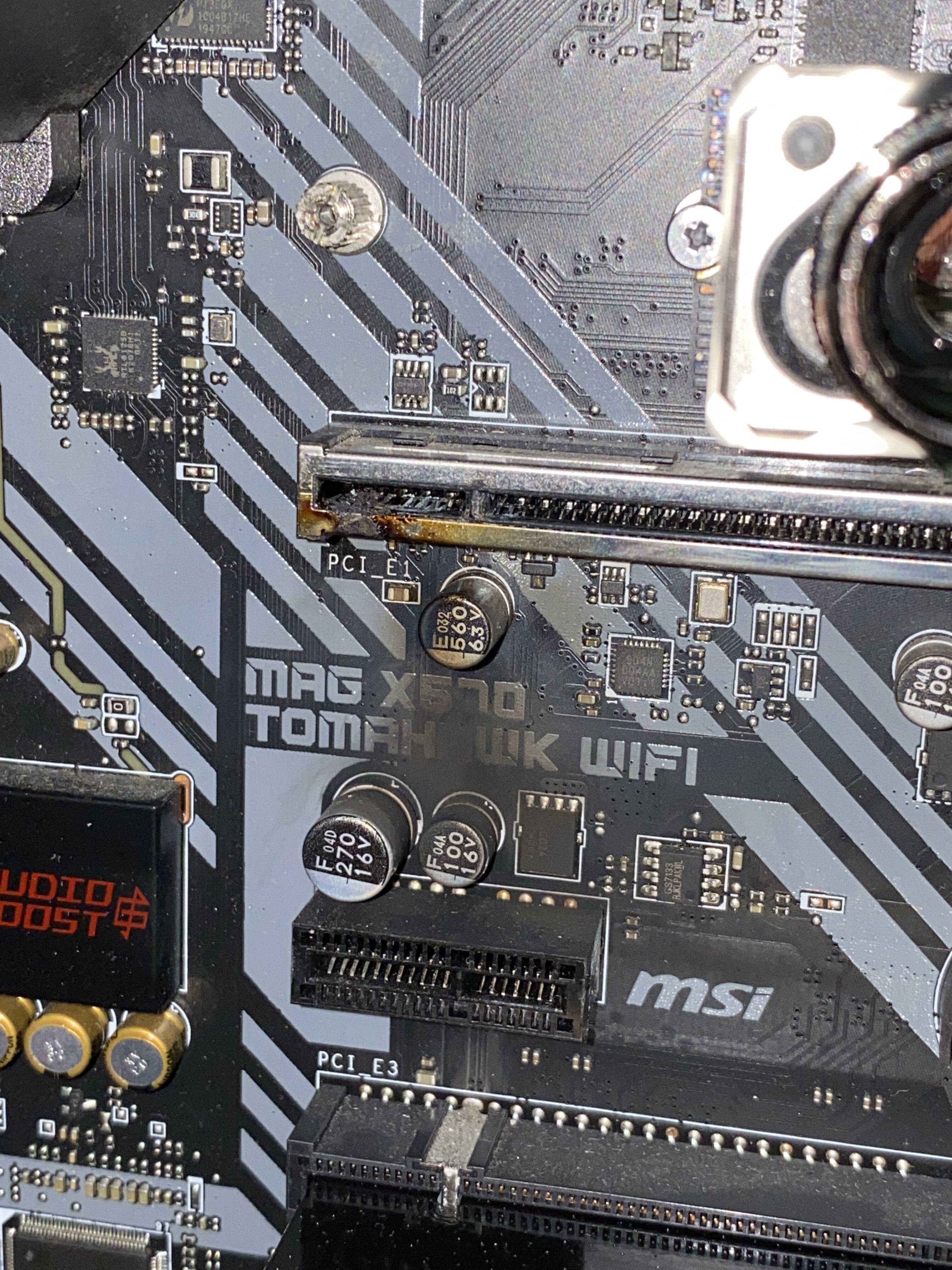

I was in Windows when the PC suddenly turned off and I saw and smelled smoke. I thought it was the motherboard. After disassembling the PC, I saw that the PCI slot where the GPU was sitting was burnt.
The GPU gold pins were also burnt. :(
Now I don’t know what to do. :(
My suspicion is water got into the PCI slot.

@Butanding1987 can you Share some better Pics? Is it an OC Formula?

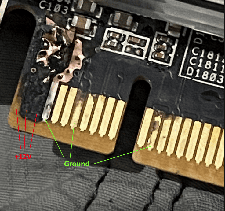

The Pins that are burned are the 12v Connection. The next Pin is ground. It would be difficult to repair but it could Work.
Kann man reparieren, wenns nur die Stelle ist, ist es auch nicht sonderlich aufwändig...
@ShirKhan I was using my brand new chiller for the first time. There were tell-tale signs of a problem (PC wouldn’t post — maybe it was a cry of help from the GPU). I forced it and when it posted, it died.
@L!ME I’ll post a better photo later.

@AssassinWarlord It’s too complicated for me. :d
Ja genau, das erste an was ich hier gedacht hab, war Assa, der zwar leider aufgehört hat selber zu reparieren - und hier ist die Karte ja auf den Philippinen, wenn ich mich recht erinnere. Aber mit ein paar Ideen von Assa und L!me lässt sich zumindest der Schaden eingrenzen und diagnostizieren.
Oh mann, tut mir echt leid für dich, @Butanding1987 so was ärgerliches. Ich vermute, dass es grundsätzlich reparierbar ist, aber ich hab keine Ahnung, wie bei dir drüben die Spezialisten sind, ob es da Möglichkeiten gibt.

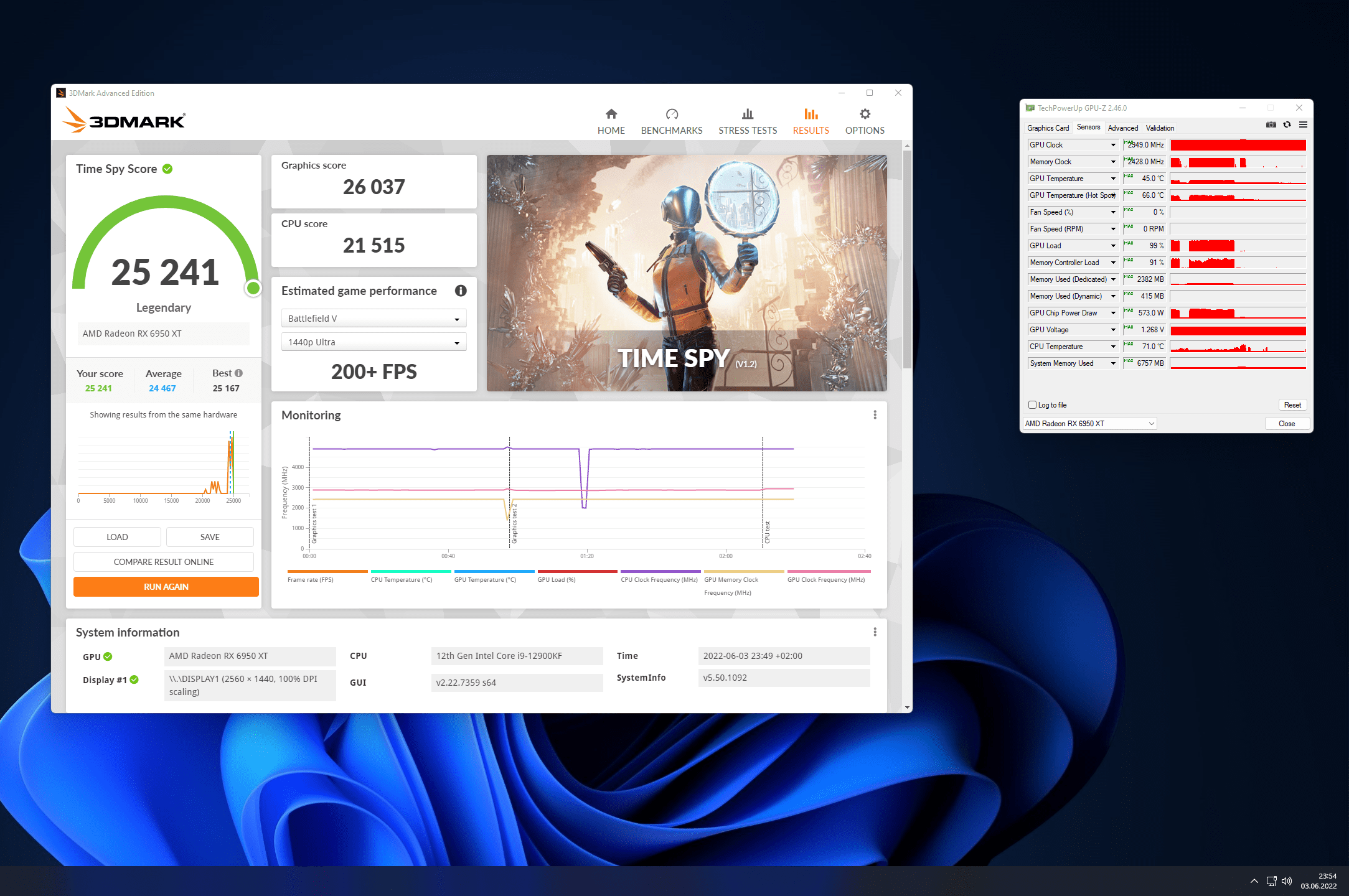

Das basteln hat sich gelohnt. Hotspot ging von 97Grad @ 1.25 auf 67 C @ 1.268. Core von 61 auf 45.

Naja, ganz aufgehört zu reparieren habe ich nicht :fresse: in Notfällen wenns kein anderer machen kann, könnte ich noch Karten reparieren...
Bei der Karte kann mans aber selber probieren - erstmal alles was schwarz ist und nach Kohle aussieht muss weggedremelt werden. Dann entweder von einer spender-Karte ersatz-goldpins da auf die rx kleben und verbinden, oder aber über einen der 8 pin PCIe ports den Strom nehmen mittels Kabel und die eingangssicherung oder eingangsspule für 12v da am slot versorgen

I don’t think the traces are visible. They’re covered by the melted copper. I wonder where that came from.

Schnapp dir ein dremel mit einem feinem Fräß aufsatz und dann weg mit dem schmodder da :d
Looks like some of the Contact Pads are burned of. Try to find the traces they were connected to. Use tools like a dremel and fine sandpaper 5000-10k. Take some pads from an old or defect GPU put them on the places they belong maybe clue them with superglue then solder a connection to the traces again.
Take off the waterblock and check the full PCB of the GPU.
Edit: I think the melted copper you see there actually are the traces. I hope you know or find someone who is good at soldering and fixing stuff like that. Wouldn't pay much for it to be honest the card is either dead or still working after the fix.
Next time put a bit more effort into prepping your PC parts for stuff like using Chillers and or Liquid Metall.😅
