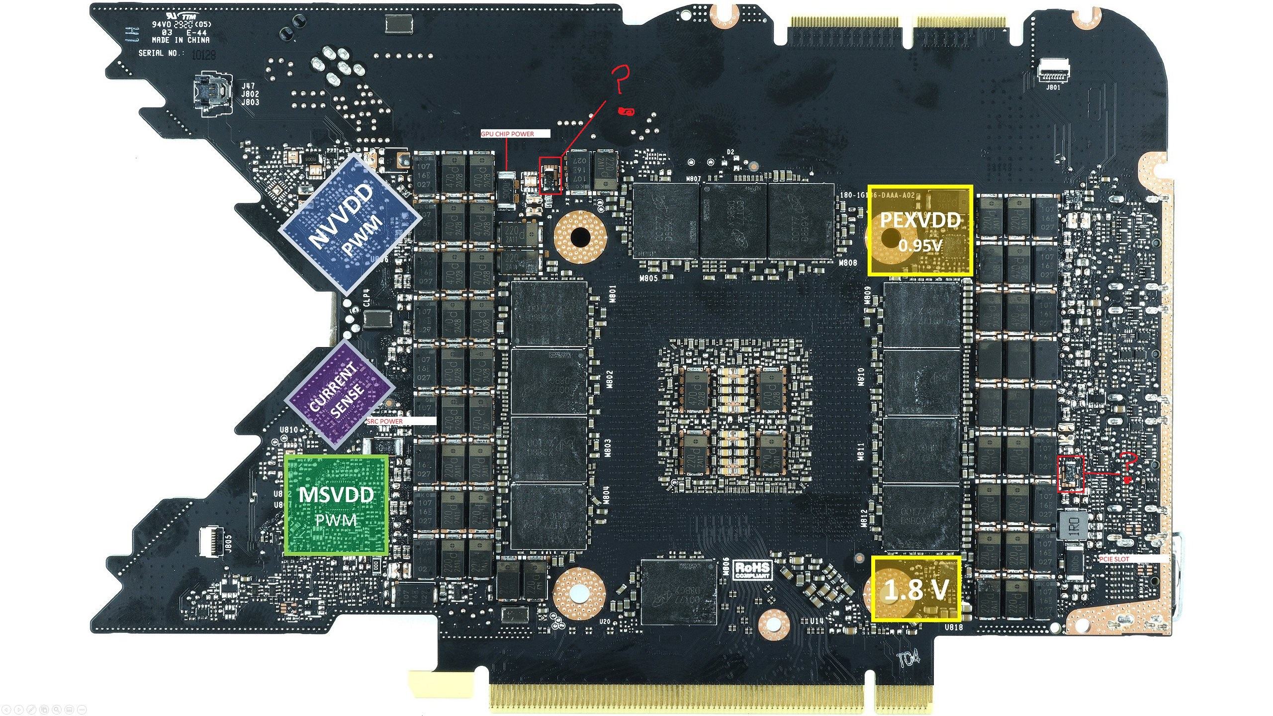

times my silicon tested ....
[ATTACH = full] 583382 [/ ATTACH]
hope there is something new around the 550w limit on the FE, a few people from ocuk / ocn are close, one supposedly made it but says nothing -_-
evc2 is also available
One of two things is possible only.
1) "possible" shunting (maybe with MG 842 AR silver paint, with careful protection with 3M polymide Kapton tape or Super 33+ tape) of the small 005 shunt resistors next to GPU Chip Power main shunt and PCIE Slot Power main shunt. No one has confirmed if this will do anything. Just two posts from people who claim "it didn't seem to do anything" without actually TESTING if 550-580W were exceeded.
2) "possible" big shunting (like 005 mOhm stack with 003 mOhm) of PCIE slot power shunt and SRC shunt, but 005 stacks on the other four shunts. That guy on overclockers.co.uk said that there is some sort of link (continuity?) Between PCIE Slot shunt and SRC shunt.
I am NOT going to be the person to test this.

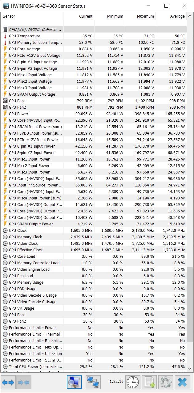

75W am PCIe habe ich auch mit FE. Gerade mal 2 Runden BF gezockt. Power Draw 398W. Memory Junction 102 grad ! Case ist offen, 1 Fan von unten blasend auf die Karte.
Blackscreens habe ich trotz 4,50m DP Kabel keine @ 144hz.
Ok dann wohl RMA
75W oder über 75W?
74,246 Watt laut HWinfo64.
Mit oder ohne OC?
Mit AB Kurve auf 1,05V und 2150mhz, sonst default.
