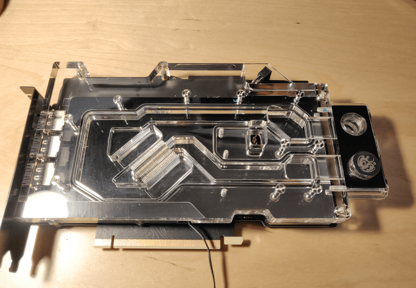

did you see differences between LM and good thermal paste? I had tested it on the 2080Ti back then; the temps were better at the beginning than with normal WLP, but after a few days there was no difference.
have planned something similar; have already had the bitspower block here for 3 days (only 3 days delivery time from china), but i am undecided about the inlet / outlet positions and may be waiting for the bykski.
Good temps with liquid metal to keep it lasting sustained require some extra work:
1) take 1500 grit sandpaper and wipe the heat block with it so the suface is NOT polished. Not sanding - just making the surface more rough --- this is for the liquid metal "tension".
2) clean fully with alcohol, then do ONE OF THE FOLLOWING:
a) apply LM on heat block, spend about 10 minutes wiping the LM around the heat block over and over - do NOT apply downward pressure - just wipe softly, normally. Careful to make sure no dust or grit or particles get on the surface. After about 10 min, the LM will start feeling "thicker" - this is good.
Then, apply a new layer of LM On top of the first layer, spread normally, then apply layer on GPU surface, then attach surface and use.
b) Apply LM on heat block, spread fully, then put the heat block in an oven for 2 hours, at 100C (212F), then after 2 hours, remove it, let it cool, then wipe off the liquid metal off the heatsink softly (do not apply pressure), leaving the * silver stain * fully intact, then apply a new coat of LM on top of the silver stain and assemble.
* THIS trick ALSO WORKS for IHS / Delids on integrated heat spreaders * (underside or both sides).
b) can only work on certain heatsinks/heat blocks that don't have wires or other fragile electronics in them, as they must be able to survive 100C temps. This is most commonly done on Laptop heatsinks, so b might be impossible on a normal desktop heatsink!
konnte nimmer auf den bykski block warten der noch in china steckt und hab nun den bitspower draufgeschnallt. endlich ruhe in der kiste
26c idle, 43c load. kein perfcap power, nur vRel und vOp :d
ach btw, kein spulenfiepen, jedenfalls hoer ich nix
