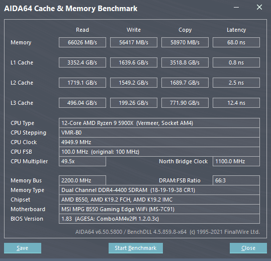

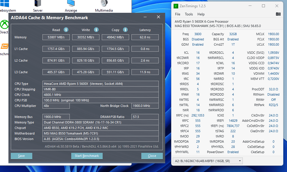

I'm get best aida result from ddr4 4400 setting. ddr4 4266 or ddr4 4600 is lower than that result. DDR4 3600 setting (1-1 fclk) is better for latency but bandwitch more important for me.

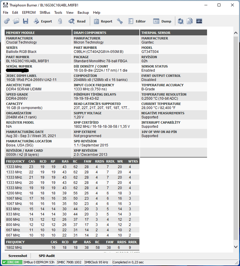

i'm using same chipset ballistix max 4400 settings. i'm tired / bored when searching tight latency settings before. if i found referance i can use it. ( different micron b die z22a chipset memory with lower latency ).

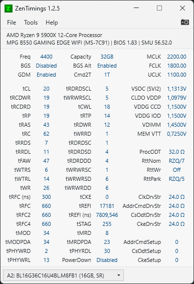

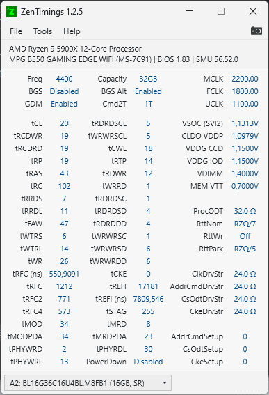

thanks @coolhead i'm tried advices. 573 not worked but 771 worked. now result is better.
i tried cl18. its little better.
You should be able to go down with trfc to 290ns/300ns. Try 660 for trfc.
And now you can try:
tRAS: 38
tRC: 58
tRRDS: 4
tRRDL: 6
tFAW: 16
tWTRL: 12
tWR: 18

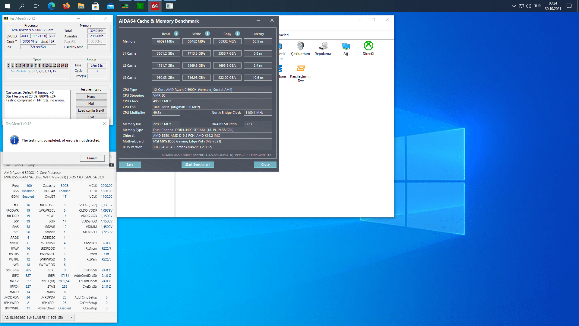

i'm formatted my pc to windows 10. i lost my aida 64 ram benchmark screenshots but i remember minimum latency with this bios settings. i was see best 67.4. also l3 cache scores far better with windows 10.
@toki1990 Please post a proper screenshot with ZenTimings, HWInfo64 and your stability test of choice and I'll add your result to the first post. In general it is a good idea to split your drive and create a separate partition for your data/images/documents, so that you can a safely reinstall without worrying about losing anything important.
sorry. i'm forget hwinfo64. but i can prepare screenshot again if this is not enough.
If you don't want to bother with doing another run, I can just add it as is. However HWInfo64 can be useful for the additional voltages and temperatures. There also are some newer configs for TM5, that are more useful than the old 1usmus_v3. My recommendation would be the new Anta777 absolute config, that you can get here:

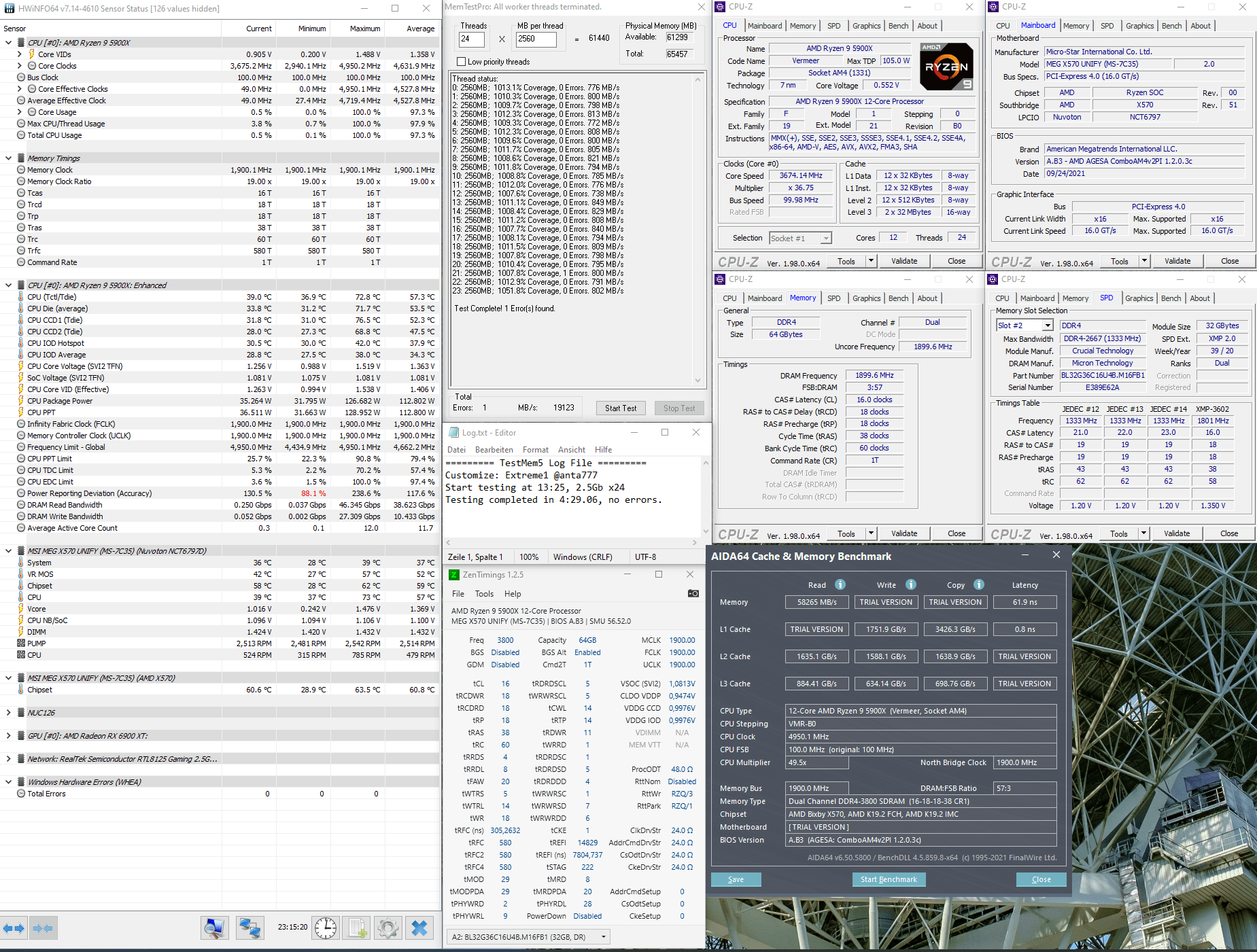

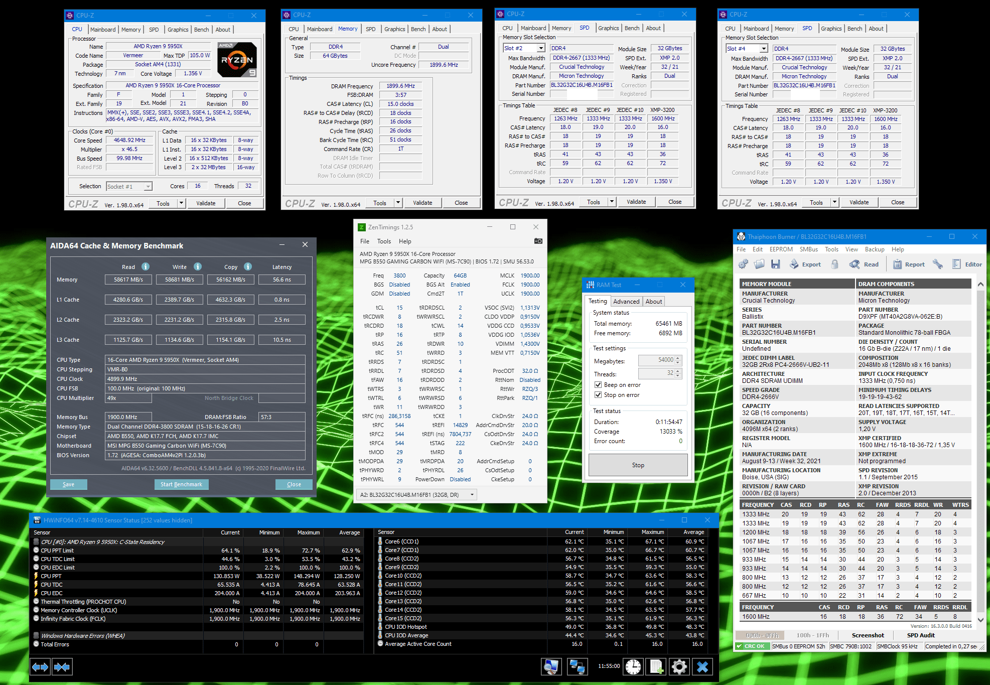

Nachdem RAM-Overclocking des Crucual Ballistix DDR4-3600 2x32GB (BL32G36C16U4B) vor einem Jahr mit meinem AMD-System und dem damaligen BIOS quasi überhaupt nicht denkbar war, versuche ich es mit aktuellem BIOS nochmal und bin positiv überrascht.
Da die meisten von euch GDM Enabled haben, hab ich's direkt mal mit CR1 + GDM Disabled versucht.
Habs nicht wirklich im Screenshot drin (nur als Log), aber TestMem5 Extreme@anta777 hat in dem 4,5h Lauf keine Fehler entdeckt.
HCI TestMemPro zeigt allerdings 1 Fehler, der laut Log bei 81% auftrat. Bis 1000% ist die Situation nicht schlechter geworden.
Für den Anfang bin ich damit recht zufrieden.
Overclock_3800_16-18-18-18-38_CR1_GDM_disabled_MemTest5_pass_HCI_MemTestPro_1000%_1_error.PNG
EDIT: 600% MemTestPro Screenshot bis 1000% weiterlaufen lassen.
EDIT2: memtest86 hat keine Fehler erkannt.

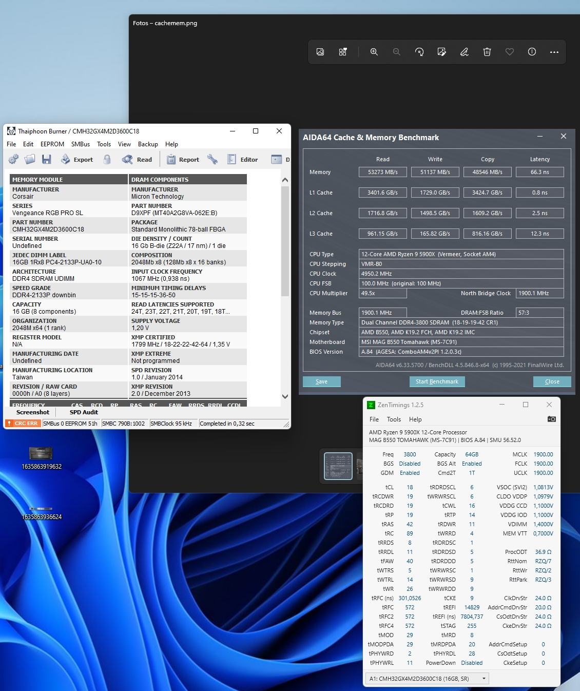

Bin von 2x16GB Micron E-Die auf 2x32GB Micron B-Die umgestiegen.
Erste Erfahrungwerte:
Mit dem E-Die Kit war mit dem Ryzen 3950X 3733 MHz (Ryzen 5950X 3666 MHz) ohne WHEA möglich, mit dem B-Die Kit sind 3800 MHz ohne WHEA möglich.
Das E-Die Kit war gut zu übertakten, aber das B-Die Kit scheint echt top zu sein.
Ohne Safe Mode habe ich bereits 57.8 NS Latenz erreicht mit 3800 MHz CL15.
Bin gespannt, was ich noch rausholen kann!

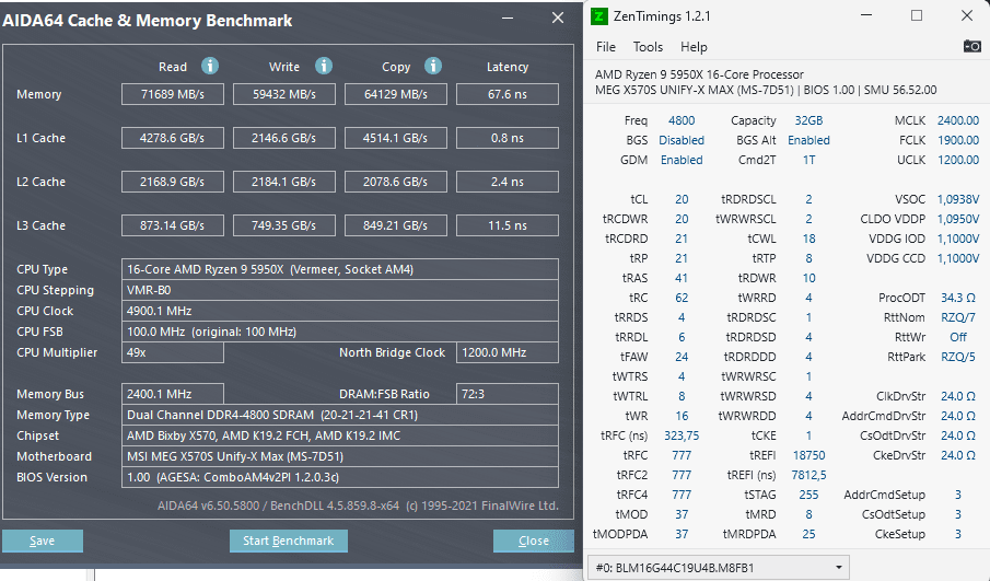

Hi zusammen,
kann ich das so lassen, oder würdet ihr eher ein scharfes 3800 setting empfehlen?
Teste ruhig mal, wie die "scharfen" 3800 in den für dich relevanten Anwendungen gegen die 4800 performen.
In einigen Use Cases hängt die Performance mehr an der Latenz, in anderen an den Bandbreiten...
Du meinst warum der Wert im Vergleich mit einem 5900X oder 5950X quasi halbiert ist?
Das ist seit den 3000er Modellen Architektur-bedingt bei allen Prozessoren mit nur einem CCD der Fall.

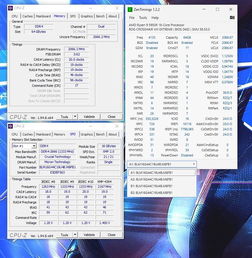

64GB-RAM:
Mit 4 x 16 GB Dual-Rank Samsung B-Dies war beim X570 Schluss bei 3.600 Mhz. 2 x 16 GB Dual-Rank oder 4 x 8 GB Single-Rank hingegen konnte ich mit 2.066 Mhz IF und 4.133 Mhz RAM ohne Zutun @ all Auto bei VSOC und co booten.
Nun kommen vier Single-Rank 16GB-Module Crucial Ballistix Max 4.400 CL19 @ 1,40 V mit 16 GBit-B-Die von Micron zum Einsatz und seht was damit an RAM-Takt ohne weiteres Zutun bei den Spannungen geht (fernab der WHEA-Fehler die natürlich bereits ab 1.933 Mhz IF auf ASUS-Boards kommen):
PS:
Hier geht es überhaupt gerade nicht um die Timings sondern nur erst einmal um den Aspekt, dass man mit 4 x 16 GB SingleRank im Takt so wahnsinnig hoch kommen kann. Das hätte ich nie für möglich gehalten.
