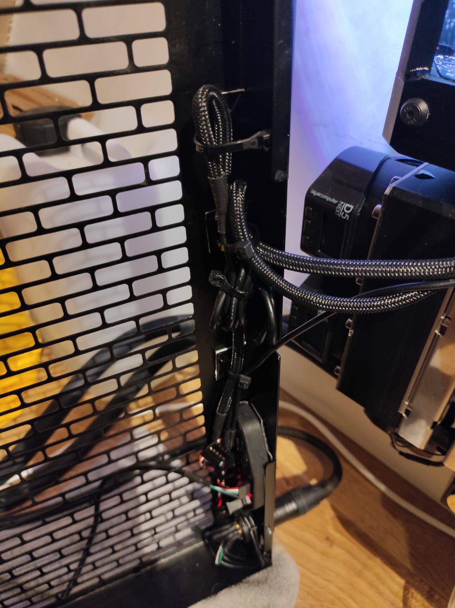

5 pin xlr on mine into the fan grill. From there to a hubby 7 and to a custom Sata cable for the 3 pumps
Can u show some detail pictures?
I can upload a picture later.
This is how the cable is made.

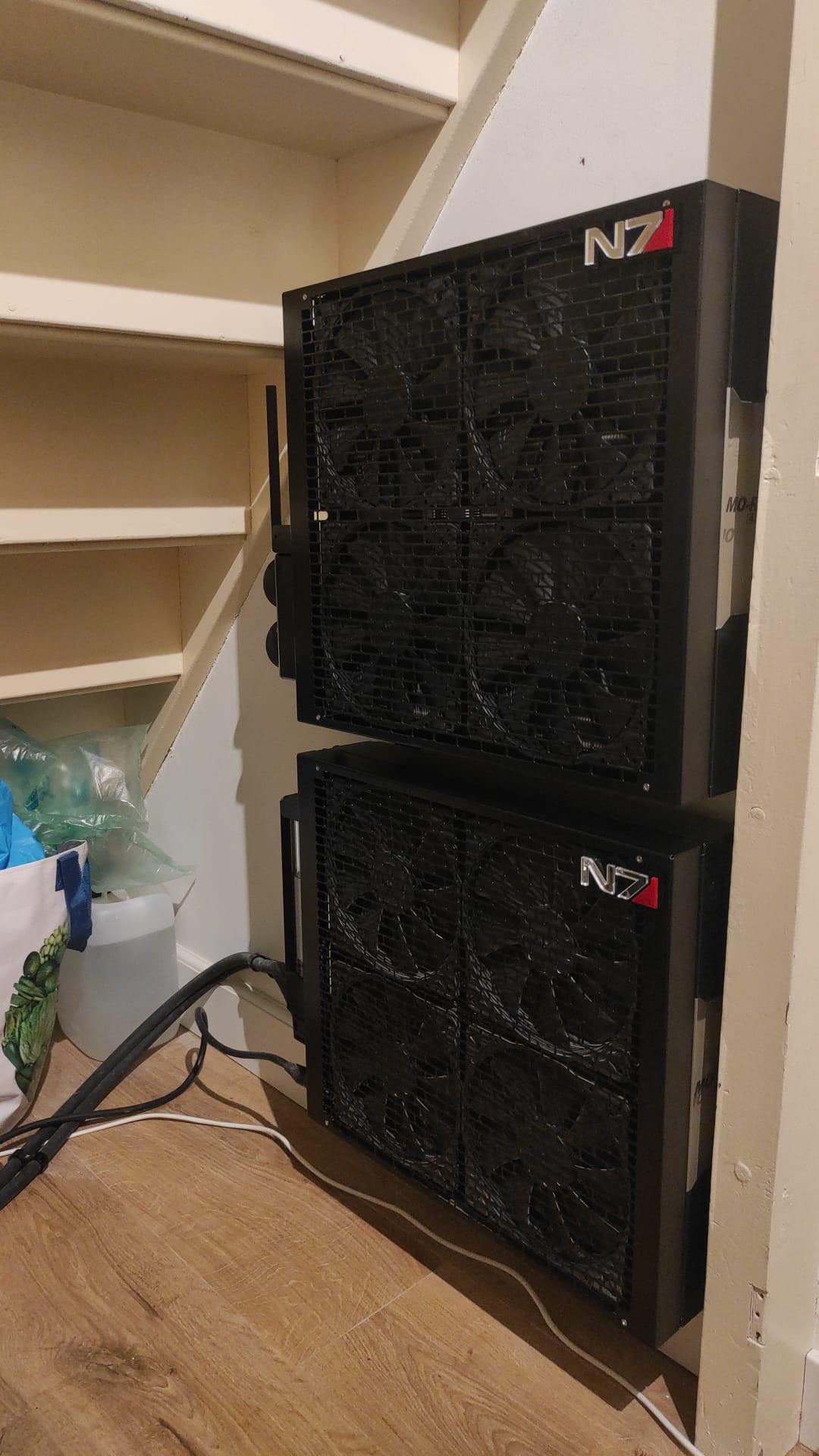

This is from when I first made it, I'm currently adding the second Mo-ra3 to the systemand hanging them on the wall so will look quite different when it's done. But the cable is the same. The fans are bundled together with the X splitter from watercool and powered by the D5 next. The second pump will do this as well, and the third will accept the signal of the Highflow 2 I've added to the system. I'm still waiting on some parts so it's not finished yet but the one in the picture is up and running.

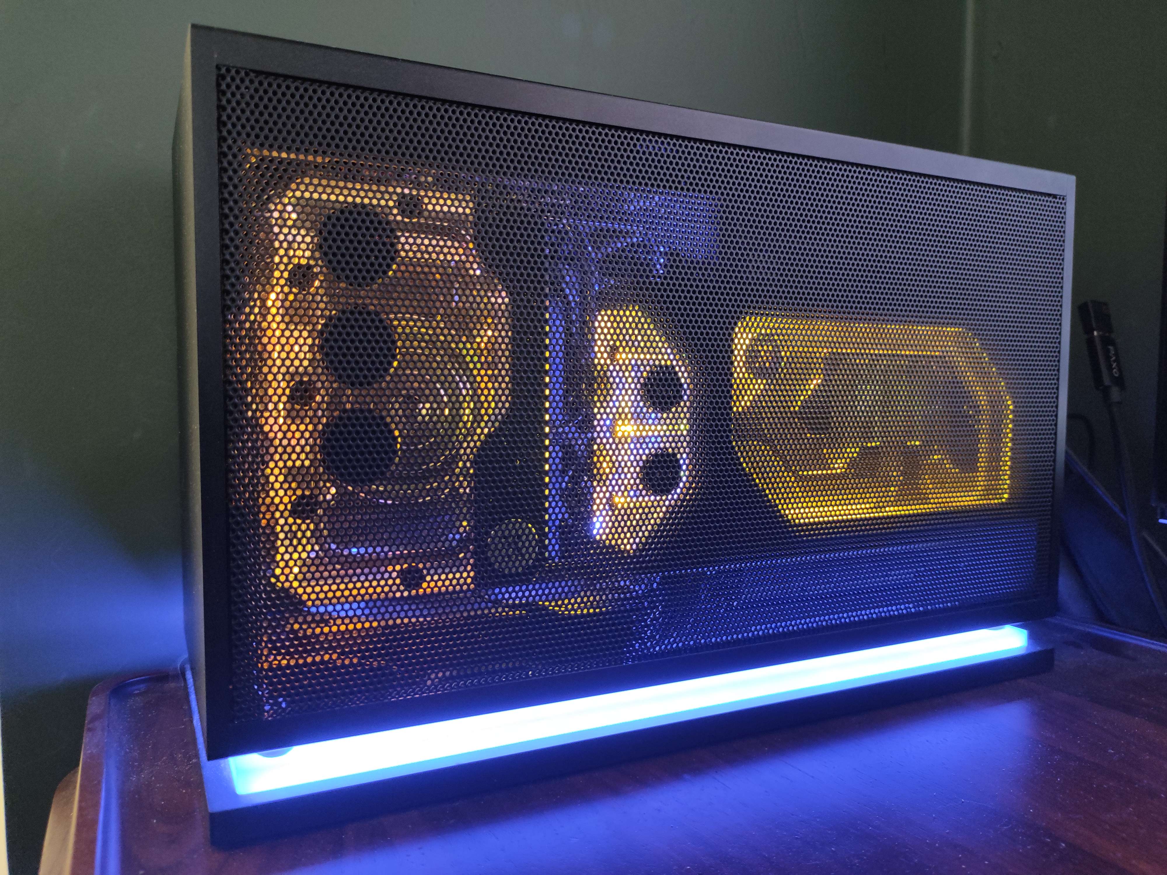

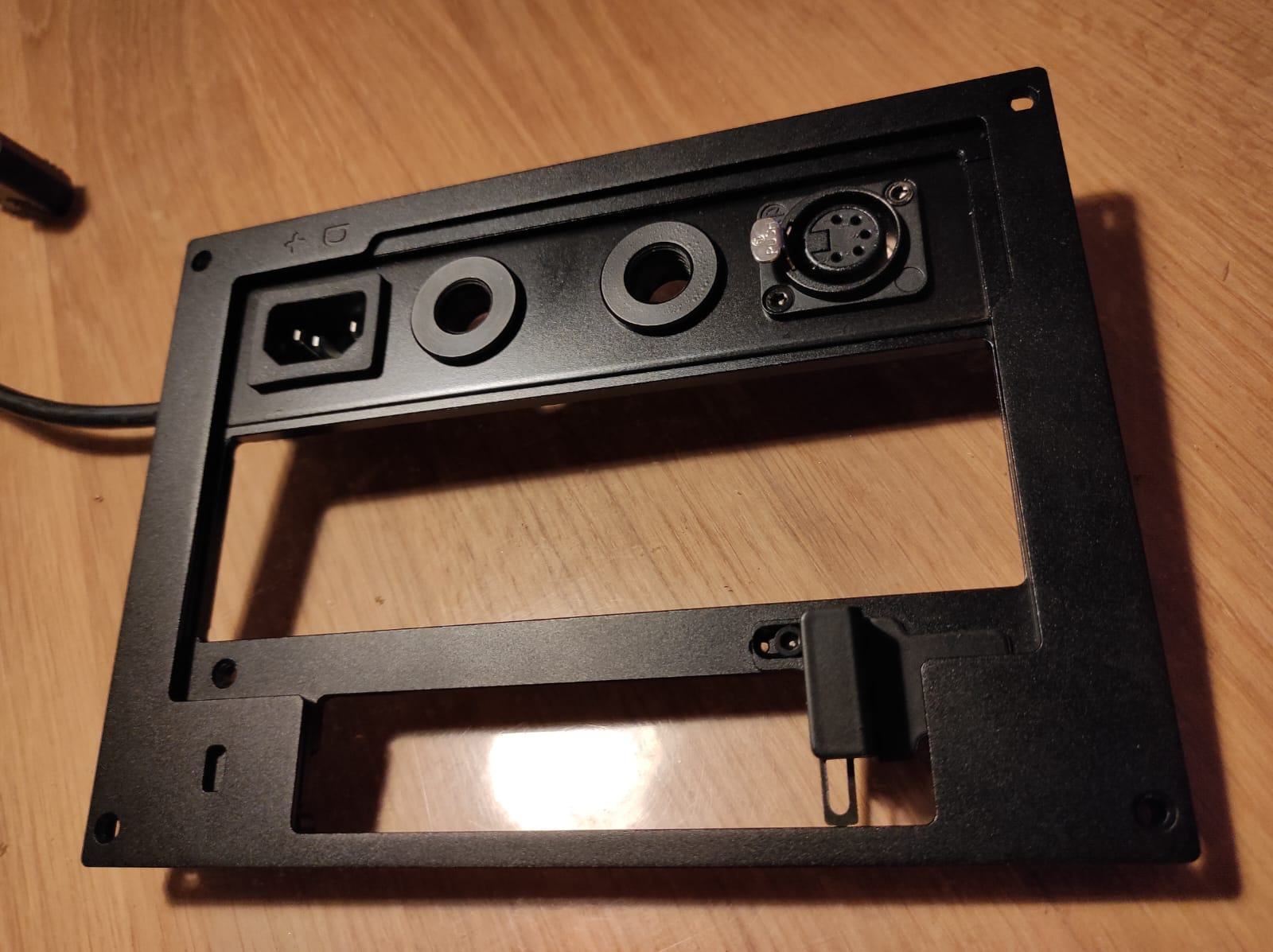

This is a picture of the back of my case. I made the part where the tubes and xlr go into myself. It's a 9 liter sff case so that's why it's small.
Anhang anzeigen 931494This is from when I first made it, I'm currently adding the second Mo-ra3 to the systemand hanging them on the wall so will look quite different when it's done. But the cable is the same. The fans are bundled together with the X splitter from watercool and powered by the D5 next. The second pump will do this as well, and the third will accept the signal of the Highflow 2 I've added to the system. I'm still waiting on some parts so it's not finished yet but the one in the picture is up and running.
which sff do u use? I´ll minimize my system too, thats why i went full external.

@HardwareMario the Hubby 7 with rubber housing fits inside the high fan grill and can be secured with 3m vhb tape. If you are planning on using multiple pumps this could be useful. If you use the D5 Next and make the custom cable you don't need the quadro on the mo-ra since the d5 will power the fans.
I got the dual pump mount with 2 Aquacomputer D5 Pwm, and an Quadro attachet to it.

Morgen zusammen

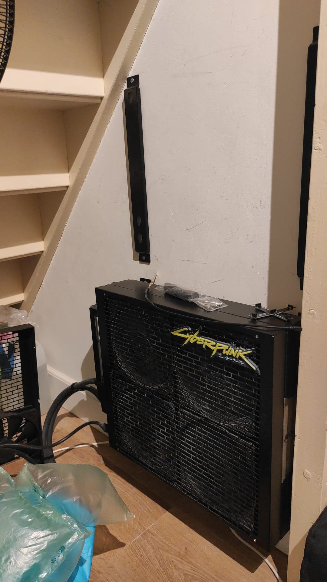

Ich habe vor im mein neues Haus meines Moras an der wand zu fixieren möchte nur wissen ob ich weniger Performance habe weil die Luft gegen der Mauer geschikt wird oder ist das egal ? Danke an euch
Morgen zusammen
Solang du 3 cm Abstand beibehältst, wird es keinerlei Probleme geben.
Im Worstcase, je nach Montageort, kann die Tapete dahinter vergilben.
Kann ich die wand halterung von watercool benutzen das reicht oder muss ich ein adapter benutzen fur mzhr abstand
Die Wand Halterung ist dafür ausgezeichnet. Sie können nach oben scrollen, ich hab den 20ste ein bild hochgeladen

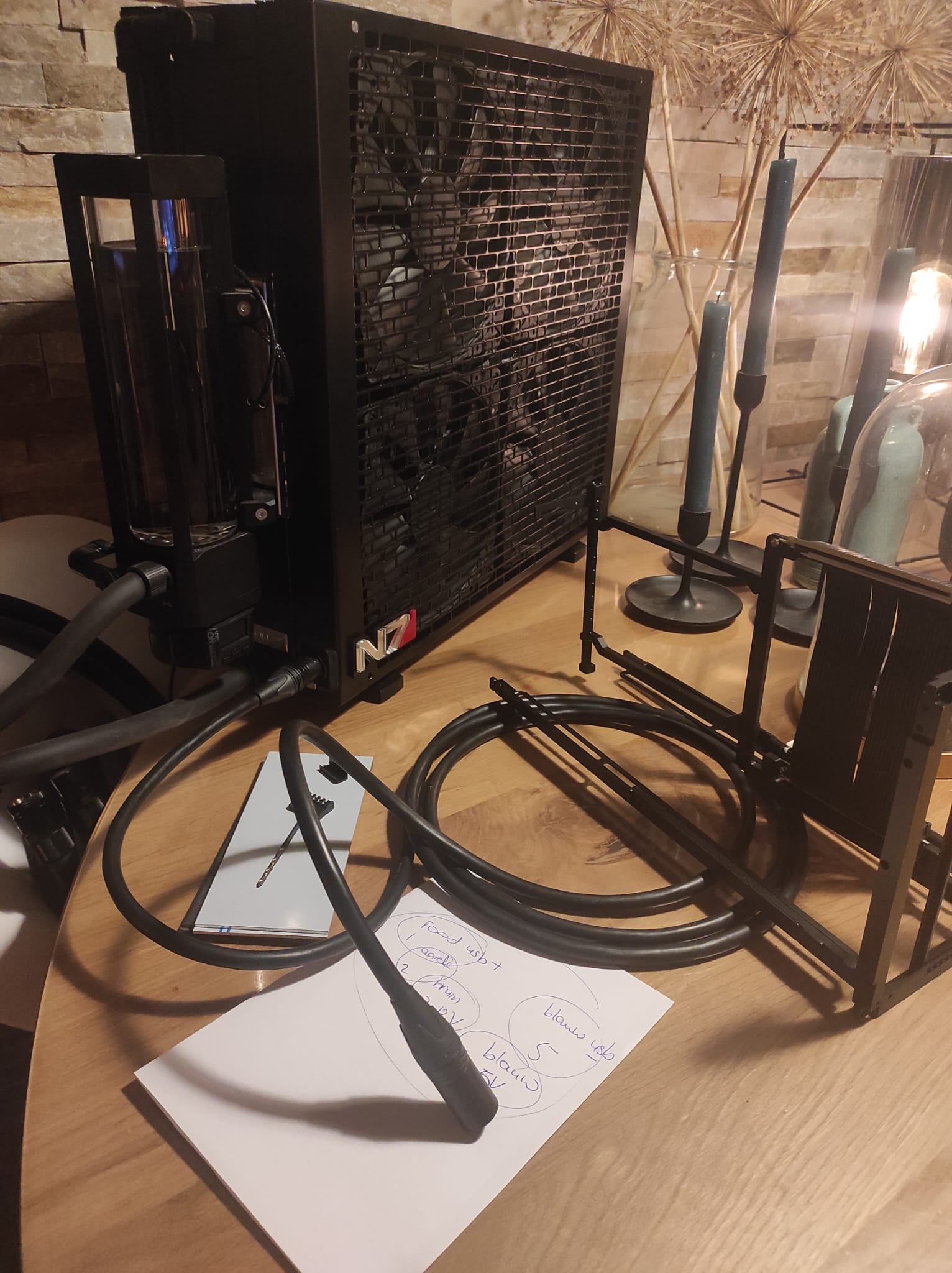

Ich hab heute auch wieder etwas gebastelt. Leider ist mir die sata power connector an Hubby 7 gebrochen und funktioniert es deswegen jetzt noch nicht ohne die external usb kabel weil ich jetzt power over usb bekomme.
Die ist aber nachbestellt.
Es funktioniert jetzt aber mit drei pumpen und ein selbst gemachter sata power kabel.

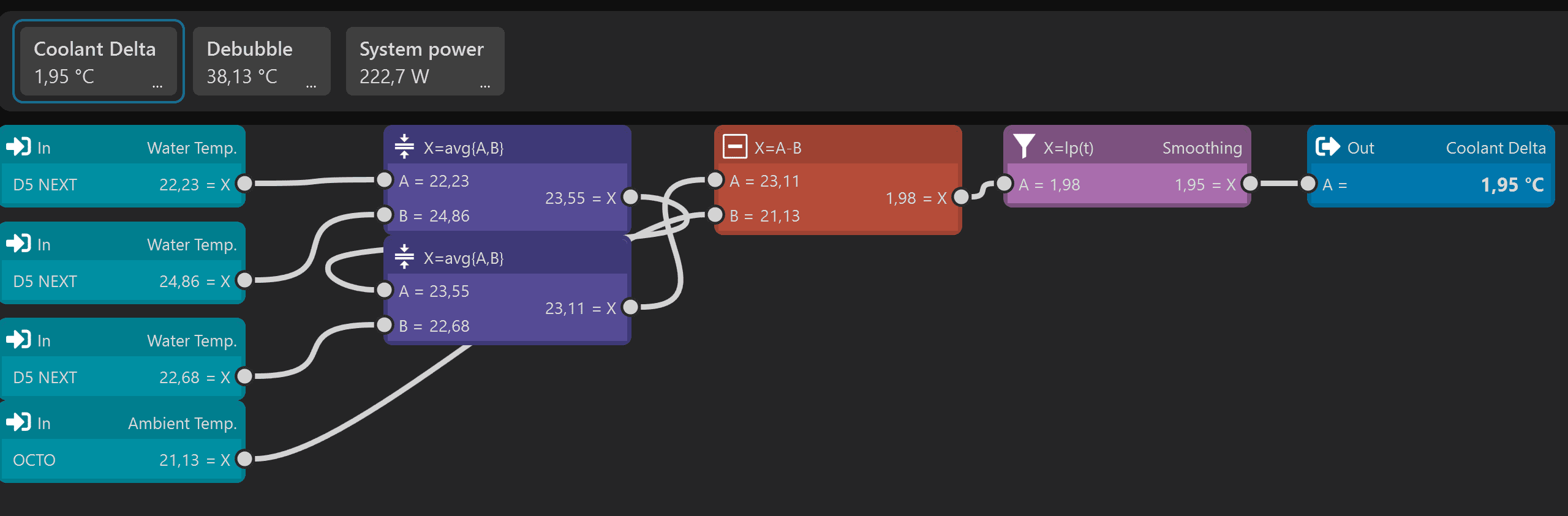

Jetzt hab ich fur die fan kurve ein delta T virtual sensor gebaut. Mit diesem kann ich im winter oder sommer das ist egal dieselbe delta temps erreichen.
