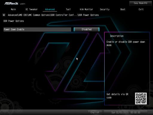

Ich habe gerade das BIOS vom neuesten Link mit USB Flashback geflasht und hier ist ein Screenshot der PowerDown Optionen.

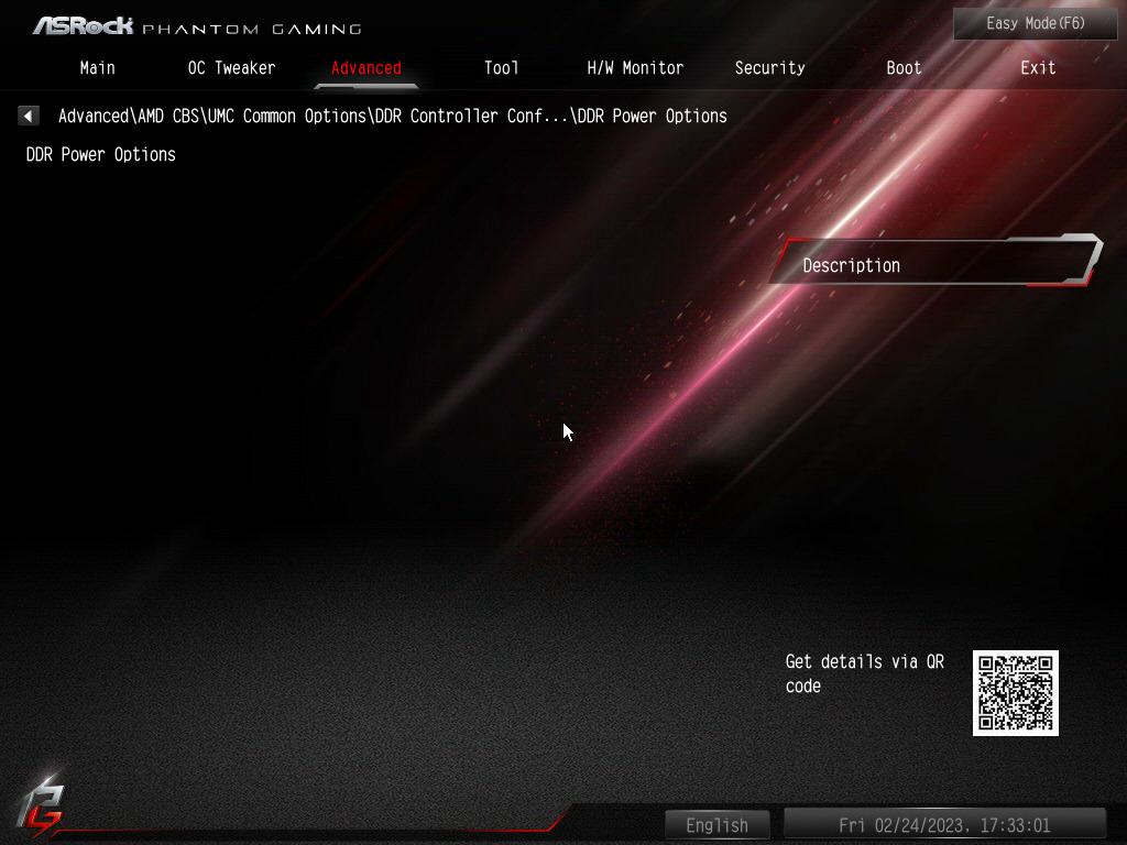

Habe es genauso gemacht aber das Menü bleibt leer :unsure: Ich bin hier auch nicht am Trollen sondern schildere einfach den Fehler den ich habe und würde gerne wissen woran es liegt

B650E PG Riptide WiFi -> downloaded ROM -> renamed ROM -> reformated USB with Rufus for MBR + FAT32 -> Moved ROM -> Flashback
Danke dir! Leider auch hier das gleiche Ergebnis

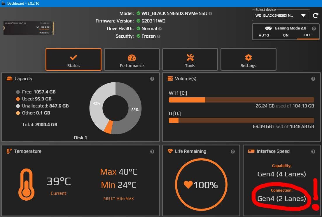

Hi mates,
I need some advice, as I still did not find the solution after reading a lot this forum. May be I should turn with this problem to another thread, but first I want to ask for your help, who uses the same chipset.
I got Asus Rog Strix B650E-F Gaming wifi, 7600X, 2x16GB ram and WD Black NVME ssd. I use integrated VGA, so no discrete vga or any other device attached. Windows 11, newest chipset drivers, latest (1222) bios. Bios changed to its default settings.
If WD Black is sitting in the PCIe 5.0 M.2_1 socket (under the cpu), crystaldiskmark's results are half of its factory speed and according to wd dashboard and HWinfo it uses only 2 of 4 lanes (=x2). If I put it to the PCIE 4.0 M.2_2 socket, it runs at x4 and full speed. No matter if I set in bios the pcie to gen 4 or gen 5, or leave it on auto, in M.2_1 socket it runs only at x2.
Any idea how to proceed? THX
Would make sure, that the CPU socket has no bent pins and if you are on the latest available BIOS. If so, would get in contact with ASUS and/ or Western Digital. WD SN850's are known to behave a bit strange on various boards
