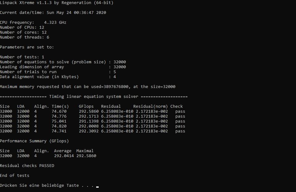

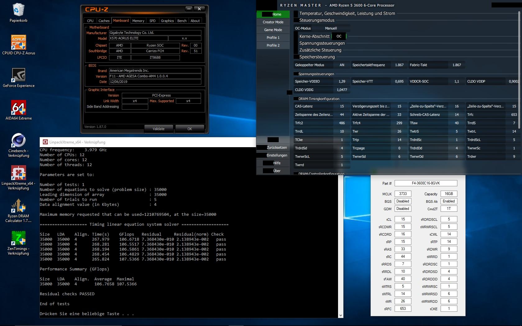

@coolhead Warum läuft deine GPU auf PCIe x4 statt x16 ? Und wie bekommt man LinpackXtreme so eingestellt das er mit der size von 35000 testet ? Bei mir geht es max mit 32000 und das Tool zeigt mir nur 6 Threads an statt 12 wie bei dir !?!
Vielleicht Auslesefehler der threads bzw windoof. Mit 16gb benutze ich die größen 5(10gb) oder auch 6(14gb).
Nachtrag... multithread y, disable sleepmode y und hw-monitor n.

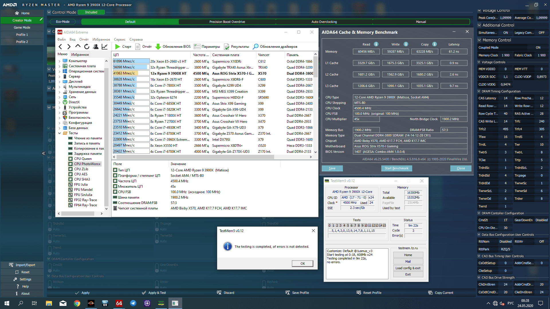

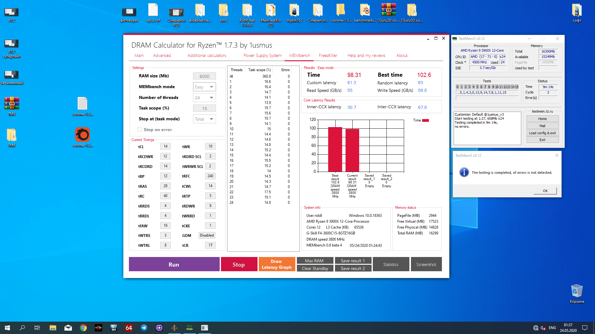

AMD Ryzen 9 3900X
ASUS ROG Strix X570-I Gaming
G.Skill Trident Z 2x8GB F4-3600C15D-16GTZ
Scythe Fuma 2
4500mhz fix 1.4v, SoC 1.1v, VDDG 950mv, VDDP 900, Dram voltage 1.52v, FCLK=MEMCLK=1900
CR 1. ProcODT 30. GDM off, Powerdown off.

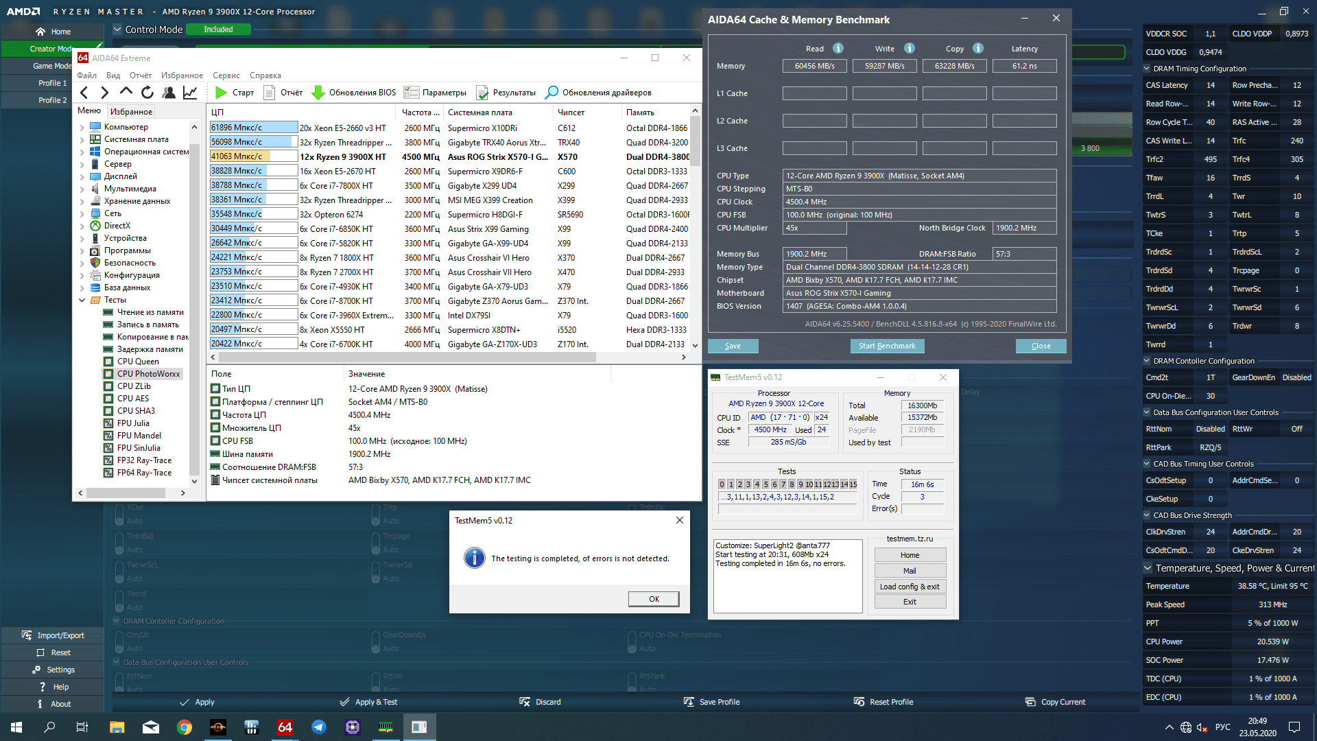

First karhu ram test
Russian utility TM5. Custom config superlight2 by Anta777
TM5. Custom config by 1usmus
MEMbench by calculator
CPU-Z validation
I'm sorry, but 14-12-14-12-28-40
not 14-14-12-12-28-40
second timing RCDWR

Btw do you prefer the Anta777 or 1usmus config? Have you noticed any difference?
About TM5 and all RAM tests
I don't want speak about 1usmus. because he doesn’t cause me anything but a smile)
will speak good or nothing
1) superlight2 - best custom config for fast test.
not 100% stability
can forgive "clamped" RCDRD and tRFC
good for everyday "home game config" on a cheap motherboard
2) Extreme by Anta777 - best custom config ever
faster and much better than karhu
99.999% stability (as possible)
but not enough fast for 32gb or more
3) newest config Universal 2 (by LMHz) - much faster than extreme
very hard, very fast
any test config or utilities can't find error after Universal2
but not for extreme overcloking - can damage RAM / motherboards phases (RAM)
U can use Universal 2 only with 1.45v or less
all these configs only for memory register, timings and dram voltage/VTT. unable to detect a slight voltage shortage VDDG (FCLK), SoC, VPP
note: change testing window size if have running problem 1536 > 1408 > 1024

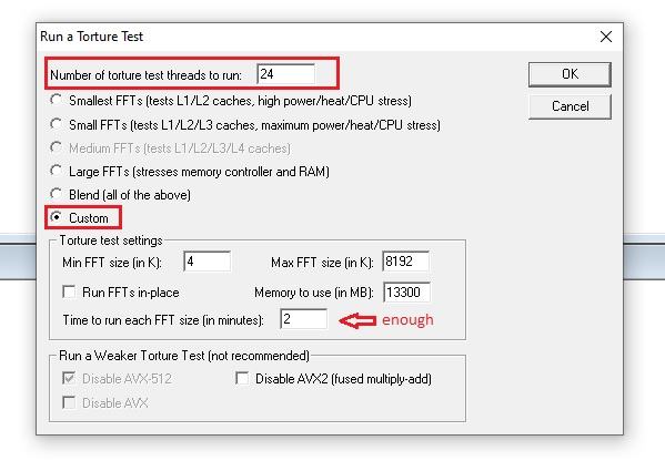

for 100% system stability for everyday use or work, after TM5 (karhu) better use prime95 custom:
u can make fix cores 3800mhz (for example) at low Vcore for test only ram error
Or use 180k as Min FTT size with in-place, or 280k without in-place. Both values are for 2 CCD-Zen2-CPUs:
These values seem to be the turning point for going from extreme heat/power-mode to way less heat/power consumption.
Yes, i know, mentioned this only from a heat/power consumption-view. If you want to test ram, don't tick "in-place".

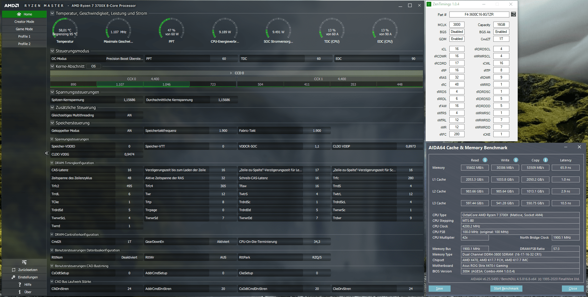

Das defekte Trident Z Kit wurde von MF ohne wenn und aber getauscht, habe derzeit folgendes Setup laufen. Läuft Karhu >10 k%, Membench >15 k% und auch im Windows sowie Games ohne Probleme; bspw. Division 2 und Snowrunner (war bei mir sehr empfindlich).
VCore: Offset - 0.0875 V
VSOC: 1.11875 V
VDIMM: 1.375 V
CLDO VDDP: 0.900 V
CLDO VDDG: 0.950V

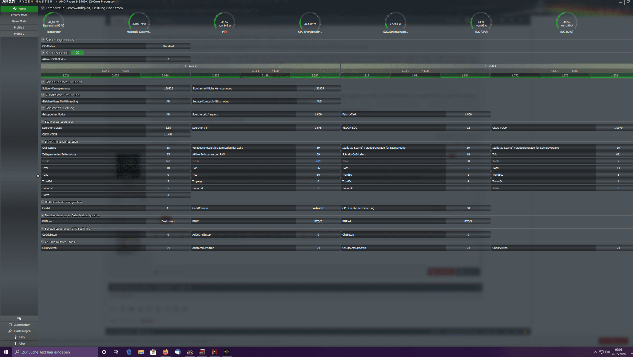

Hey @MrGlobalNades ,
kannst du bitte mal ein Screen von Ryzen Master posten, damit man sieht wie die ganzen Werte aussehen. Auf Anhieb würde ich aber sagen tRCDRD ist mit 19 ziemlich scharf eingestellt für 3800.
Der aktuelle Stand nachdem ich auf XMP mit aktuellem Bios gegangen bin (V. 2D); werde später Screenshots vom DRAM Calculator anhängen + entsprechende Werte mit 3800 Mhz CL16, muss nun schaffen gehen ;)
Was mich schon mal stutzig macht, ist das XMP nur mit Gear Down arbeitet und CL17 nicht erreicht wird ...
Danke schon mal für die Antwort
Gruß und bis später
MrGlobalNades
Ja, bitte den Screen mit 3800 noch anhängen, denn da gibt es ja dir Probleme. Du kannst dann aber schon mal probieren ob es ausreicht trcdrd auf 20 zu erhöhen. Ebenso ProcODT mal auf 40 setzen.
