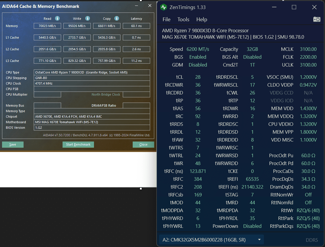

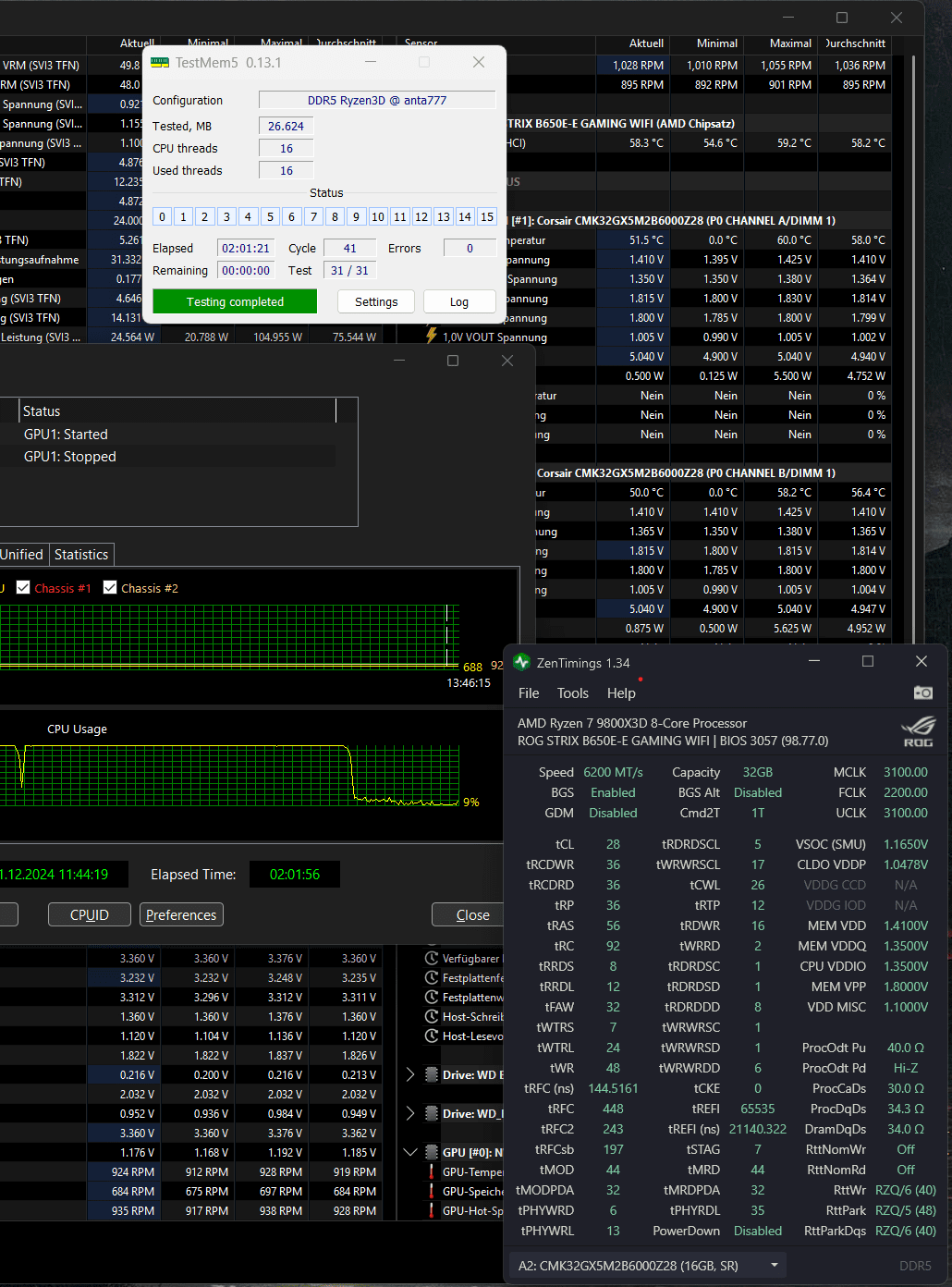

Jetzt nochmal mit dem PMU Timing auf dem Gene (addr... 2) die tPHYRDL auf 37/37 gesynched und nochmal laufen lassen und das Gskill Kit bleibt jetzt erstmal bis nach der CES (RGB abschalten hat 2° unter Last gebracht). FCLK 2200 läuft auch, auch wenn ich da erst noch benchen muss ob es das überhaupt bringt. Aida mit wenig Systemdiensten + Legacy war bei 61,5ns.
Meanwhile etwas an der CPU geschraubt mit eCLK/PBO (100.5Mhz/+200) und CO (6x-29/-24) und da auch nochmal was rausgeholt und laufen lassen. Prime95 Blend lief auch schon 2h, Rest kommt heute Nacht, wenn der Strom wieder billig ist.

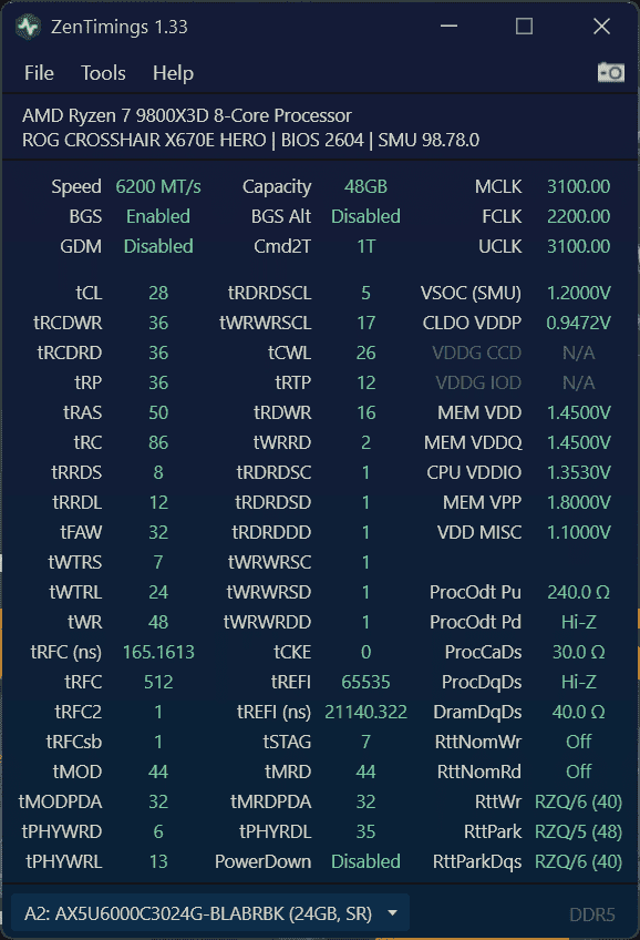

I have deactivated core isolation in the Windows Security Center, but I can't find the other one. Are both in Windows?
For you it says GDM is deactivated, what is that? For me it is activated
Hi "stranger GearMode" ~jokeing ~jokeing no ofense here 🙏
Let me explain Long story & short version GDM Enabled or Disabled coz I can tell, stay away from it enableing, only better way to gain endless stability, short latencies and fast speeds bandwidth is always fix it OFF 👍
Don't be surprised, coz we are not sitting on magic Luxxer carpet here, researching for better performance in stable Profile scenario who eats a lot of mems time consumer to fix it, coz you need to find out by yourself practising, testing and retesting how to face GDM Disabled, is not that easy just but clicking one tick in Bios Dram section, so be aware GearON is dealing with 1.5T you will need to work steps by steps on pure 1T GearOFF but a lot of headaches will shown up by instant BSOD or random reboots if not stable 🤕
But if it was easy on early Ryzen debut, we would have already found a route to one click OFF stable GDM scenario, without issues, from long time ago 🙃
Thats was more than clear from the beginning.
Don't build your mems AMD foundation with GDM ON.
GDM Enabled hides issues. Always. Too much. Failure was expected, soon or later coz of that.
Gear ON it's putting just a bandaid over it.
Its clear that you will never know if you are running unstable Profile, coz GDM will autocorrect issues always, in no time and you'll not even know which one was wrong timmings, low dimms VDD/Q voltages, maybe poor cpu IMC or simply too much high temps in mems PCB which mem chipset will heat them up too quickly, in productivity or mostly in long hard gaming session, idk which one it fits to your needs, here's your call 🤔
So confident y can find out which one memories Profile GearOFF is for you uclk/mclk 1:1 or 1:2 please just start removing that GDM and don't pick up the easy give-up route Enableing, like he isn't there 🤭
Accepting defeat tho GDM Off, won't make your issues go away.
Its not tooo hard. Come on. And your work rewards will always come with benefits, I can tell 👍

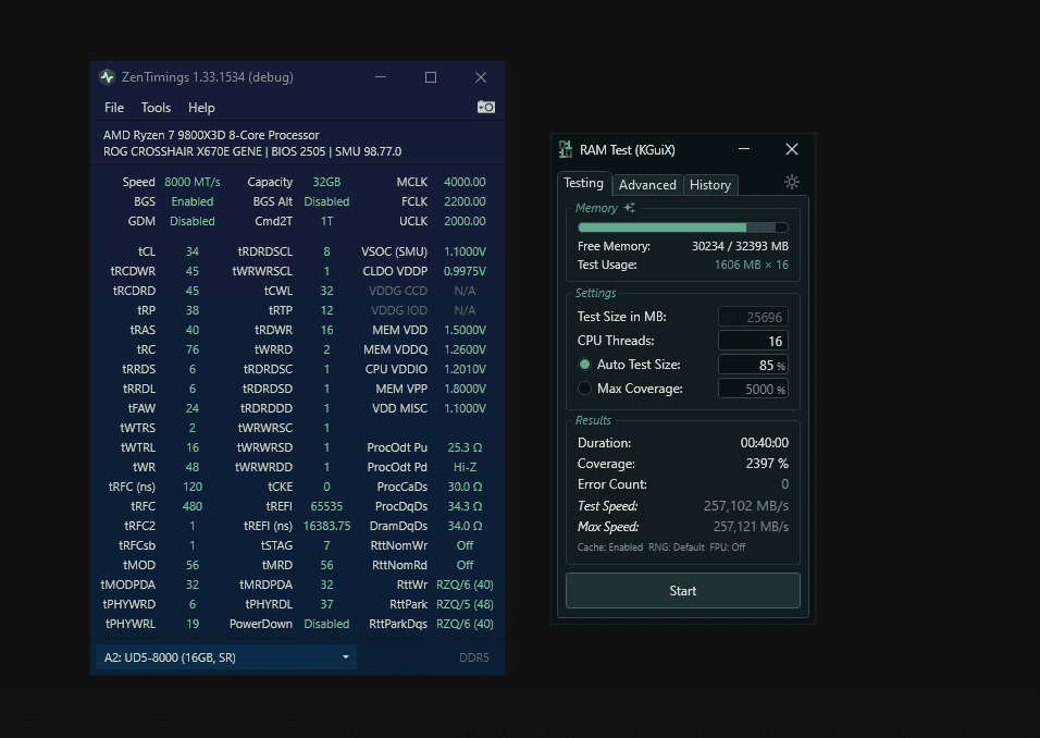

Please take a look on this hell of a Neo's baby sticks on Tommy the Stunny MSI motherboard, faceing stable Karhu mem test output % coverage in max. tightest timings ever possible in stable scenario included, coz they are not be seeing in AM5 OCing so often, sorry no ofense here y all enthusiast Luxxers 🙏
Profile 8000CL36 GearOFF 1:2 synced by channel A/B tphyrdl 37/37 manually tREFI 65535 & tightest timmings combo I can run them stable & validated, all manually inputs trfc(ns) 116 tRFC 464 trfc2 345 tRFCsb 212 rcdWR/RD 16/45 Faw/Wtrl/Twr 21/15/48 rrdls & wtrls 4/9/3 rtp 15 rdwr/wrrd 14/1 and rdSCL 8 rest all 1, all CAD's odt=Auto Vddio 1.480v VDD+Q 1.570 for Dram Settings and 5,600 cpu Allcores PBO enabled 105w TDP profile in Bios cpu section indeed.
No OPP, No Memory Timing Preset No HighEfficiencyMode all stays Auto
No Memory Try It, No Expo, No Nitro, No MemoryContextRestore, No Power Down and more... all stays Disabled
Stay happy, enjoy some games or HWbot benche's records if you want, wish you great party tonight and Happy New Year, let's see you all next year with better and better Profiles to deal with GearOFF only 🎆

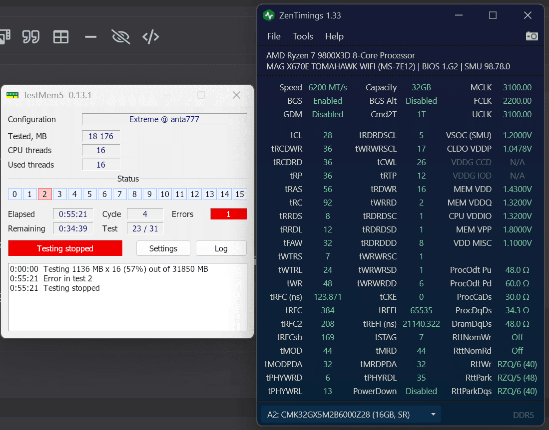

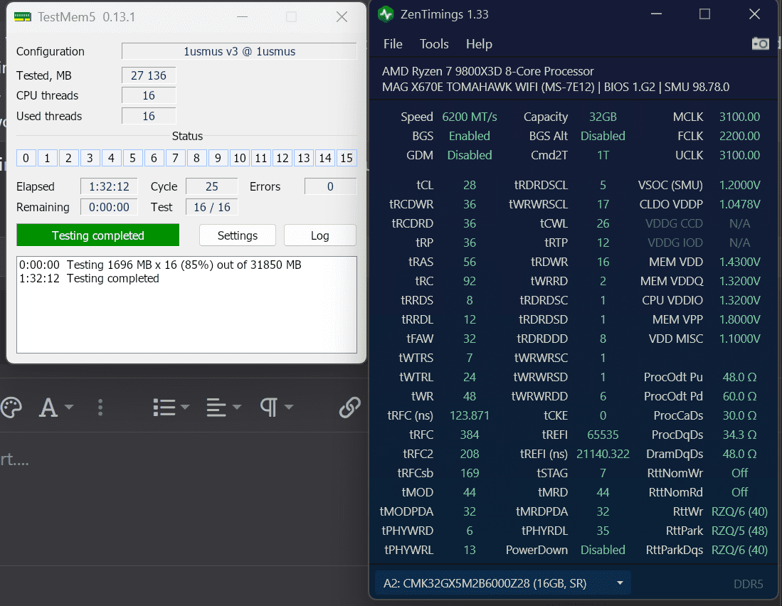

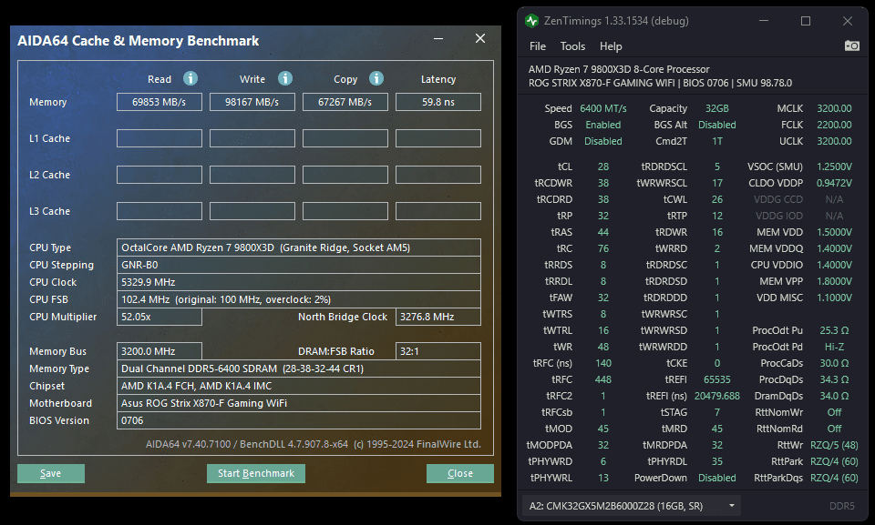

Ich schaffe mit den Timings nur 67,1ns. Naja es sollte ausreichend sein, um vernüftig zu zocken. Die meisten User und alle 9800x3d Tests gehen ja nur mit der 5600mhz Basis rein und selbst damit ist die CPU bereits die schnellste Gaming CPU.
Jetzt mache ich hier noch einen Khanu Test und wenn der läuft muss es wohl so sein. Ansonsten lief bei mir gestern ein CL30 Setup 12h durch, dass reicht ja auch. (69,1ns)

Ist mir auch nicht ganz klar, warum die letzten 6GB da ausschlaggebend sein sollen. Sollte doch jeder IC was abbekommen haben.
Lasse mich aber gerne eines Besseren belehren.

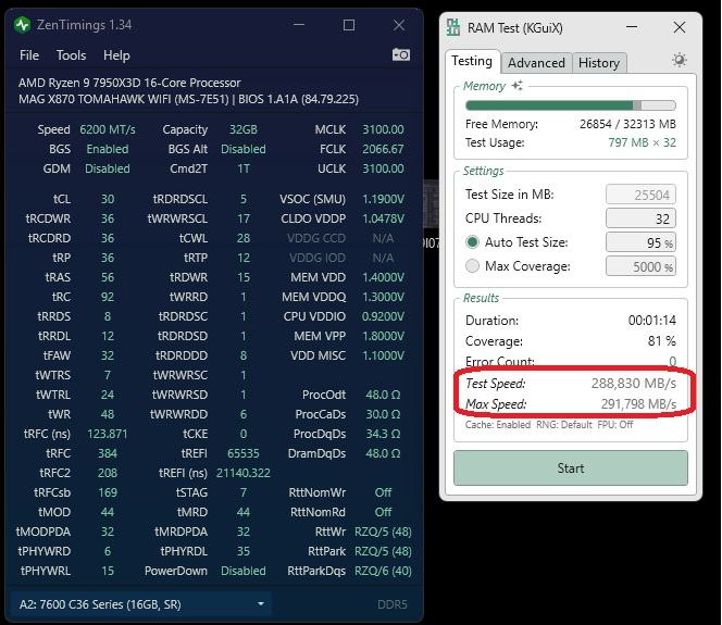

Für einen 7950x3d nicht das gelbe vom Ei. Lass min bis 500% laufen und mit 28800MB Testsize, dann hast du ungefähr den Wert der maximal erreichbar ist. Danach geht er meist nicht mehr viel höher. Spitzenwerte gehen in Richtung 340 MB/s und darüber.
Ich habe es versucht. Sie variiert zwischen 290 und 295 MB/s. Was erhöht diesen Wert?
tRFC runter auf 120ns (372), musst dann mit der Spannung nochmal 1 tick hoch und dann hast ein gutes Setup.
Was sagt Karhu im Durchsatz? Kommst du über 250MB/s mit Cache?
Danke! Hätte nicht gedacht, dass es bei fast konstant 60C für 2 Stunden durchläuft (via 100% GPU). Damit sollte ich durch den Sommer kommen.
FCLK Limit. FCLK auf 2200 und du erreichst ~300MB/s. Mit 6400 geht max. 310
bei 3 GB IC's? Vielleicht, sicher ist das nicht.
Ich denke einfach, man sollte so viel RAM wie möglich für Speichertests allokieren. Ansonsten kann man sich das Ganze hier auch schenken. 28800 MB als festen Wert erhöht auch die Vergleichbarkeit. Aber jeder wie er meint.

Für einen 9000er X3d ganz guter TestSpeed. Nur verstehe ich einfach nicht, warum man bei 32 GB nur 25 GB testet. TestSize muss min 28800 MB sein. Ansonsten kann man sich das Ganze sparen.
ich finde er hat vollkommen recht - 6GB nicht getestet sind bei 32GB ja auch schon knapp 20% ungetesteter RAM
aber ich gehöre ja auch eher zu der Fraktion "absolute Stabilität" - mir reicht es z.B. nicht wenn der PC nur Game Stable ist oder prime mal so 1h lief...

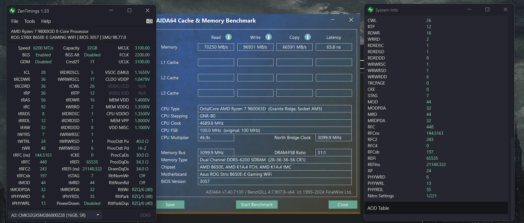

Ich hatte hier am 7950X 6600-30 aber nur 2133 FCLK - und in Karhu 307 MB/s. Interessiert mich auch, was da die Einflussfaktoren sind.
In der Online Ergebnis-Tabelle stehen ja auch die Karhu Speeds drin. Alles was sich oberhalb der 300 abspielt ist meist @Domdtxdissar mit meist ganz niedrigen Latenzen. Und zumindest drängt sichs nicht aus dieser Liste auf, dass der FCLK hier die einzige Größe wäre.

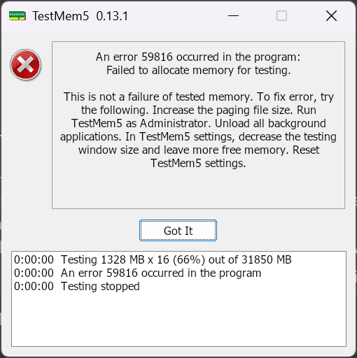

Speicheradressen sind statisch. Heißt wenn Karhu oder ein anderes Tool auf Betriebssystemebene konfiguriert wird nur kA 28/32 GB des RAMs zu testen, werden ausschließlich die Speicherbereiche getestet, die innerhalb dieser 28 GB liegen. Die übrigen 4 GB bleiben unberührt und werden somit nicht geprüft. Daten "wandern" nicht automatisch über die gesamte RAM-Kapazität, sondern verbleiben in den adressierten Speicherzellen, solange sie nicht aktiv umgeschrieben werden. Daher werden die ICs, die für die restlichen 4 GB zuständig sind, bei einem Test, der nur 28 GB anspricht, nicht überprüft.
Kann also bei 2x 16 GB DDR5 Single-Sided Modulen: 8 ICs à 2 Gbit (jeweils 2 GB pro IC) bedeuten, dass 2 ICs nicht mit getestet werden.
Um annähernd 100% sicher zu gehen dass alle ICs getestet werden, einfach 2-3 Testiterationen fahren nach dem stromlos machen des PCs. Dann ist die Wahrscheinlichkeit äußerst gering nochmal die gleichen nicht mit getesteten ICs zu erwischen. So mach ich das jedenfalls immer.
@Chris1975
nunja du musst dem OS halt auch immer noch etwas Luft lassen damit es arbeiten kann
ich glaube das alles oberhalb 30000MB bei Gesamt 32GB schon Probleme verursachen kann. So daß die RAM Tests nicht sauber durchlaufen werden, sondern mit kryptischen Fehlermeldungen abbrechen

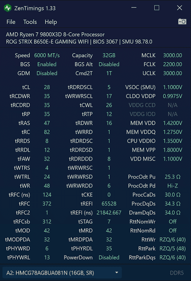

Mir wurde berichtet, dass das ASUS MB mit A-Die-Modulen (32- und 64GB-Kits) extrem langsam bootet, während es mit M-Die-Modulen (48GB-Kit) sehr schnell - also, wie @ default bootet
Hab leider keine M-Dies zum Vergleichen da, aber die extrem langsame Bootzeit mit meinem 32GB-Kit nervt mich schon. Also bis die rote LED leuchtet und endlich weiss wird
Jetzt frag ich mich, ob das nur bei ASUS-MBs so ist (hab das Strix B650E-E) oder generell bei allen MBs mit A-Die-Modulen so ist
Und ob ich mit irgendwelchen Settings die Bootzeit, wie @ default erreichen kann

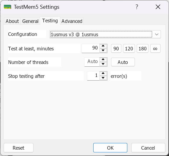

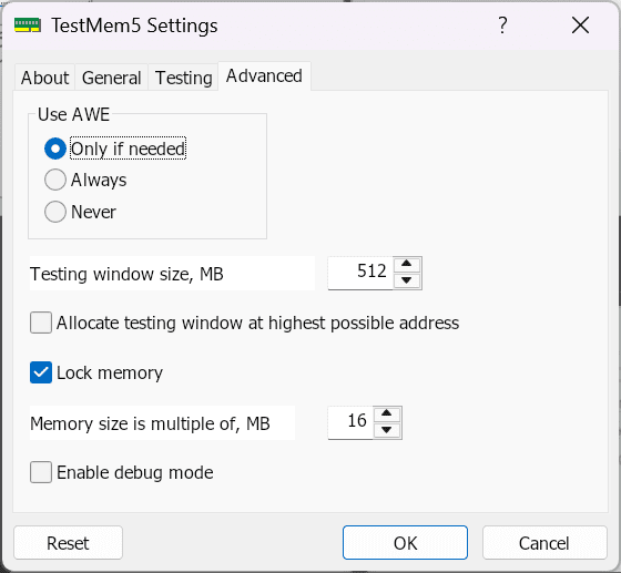

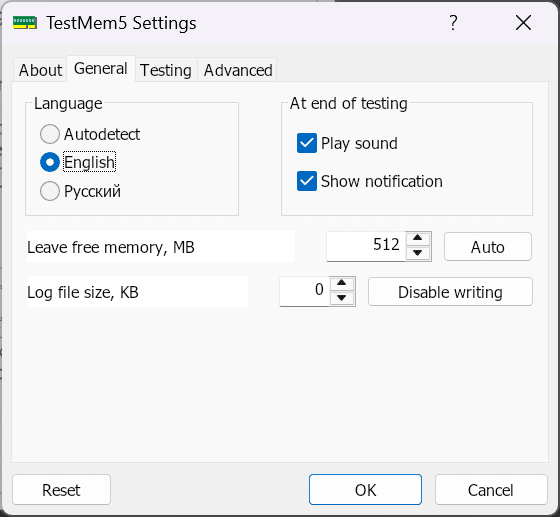

TestMem5: Mindestens 3 Cycle Extreme @ anta777 mit "Reserved Memory for Windows" = 880
Prime95: Min. 6h Blend
Prime95: Min. 6h Large FFTs
Ggf. noch Furmark zur selben Zeit.
Alles andere kann man auch gleich sein lassen.
