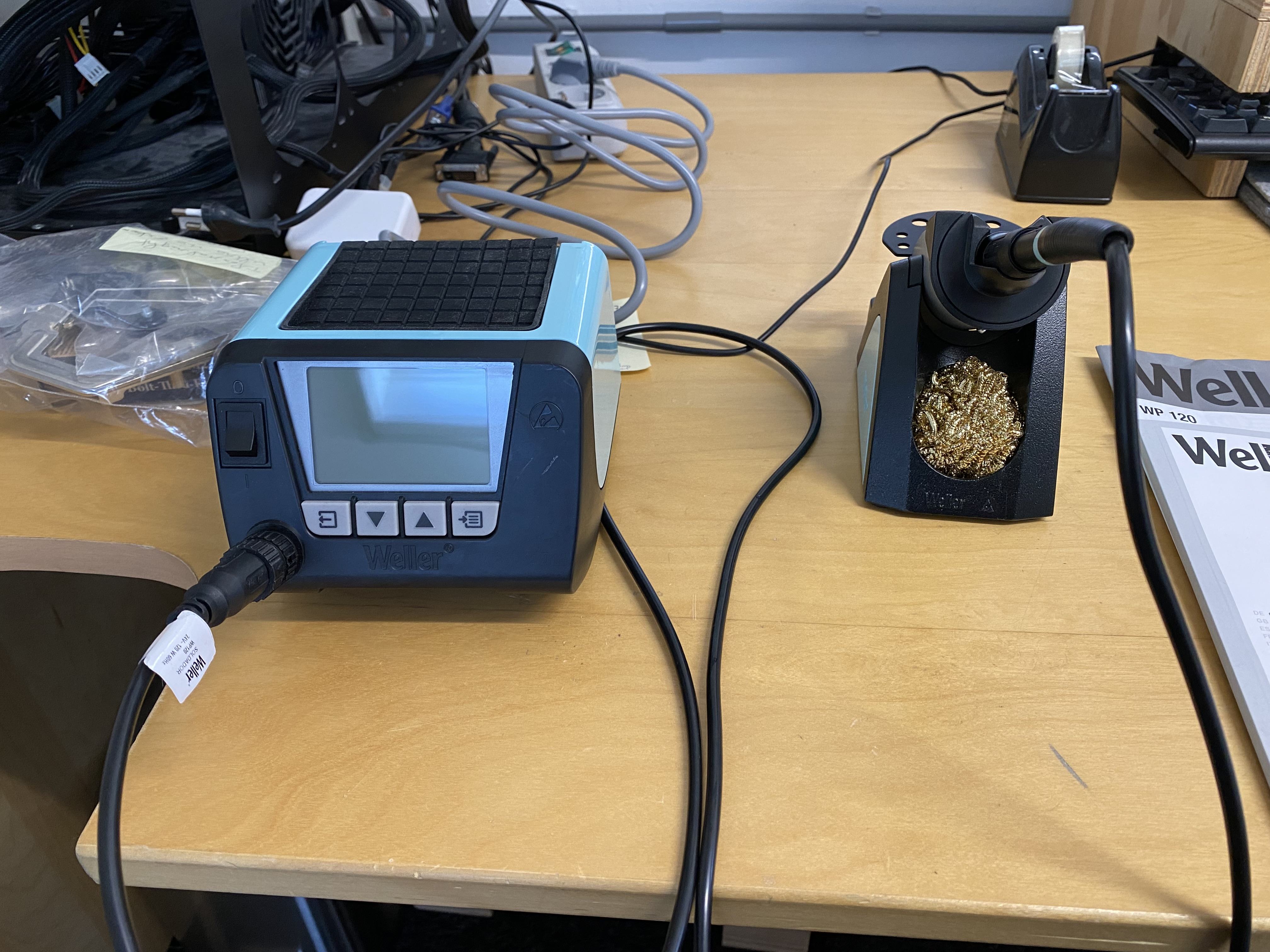

So the new soldering station is in…
The Ersa I ordered was to slippery (I burned my hands using it).
Weller WT 1H + WP 120.
150W as a possibility should be enough…
I have ordered a WTS 80 as well. It comes cheap via China.
