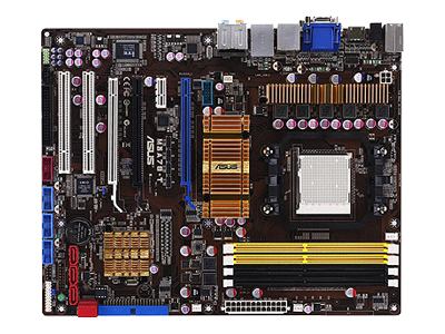

Which PCIe slots do you use for the PERCs? Is there a graphic card plugged in? U used all 4 DIMMs?
Interessting 4 me, did u measure the power comsumption of the M3A78-t?

@black_adder
English ist world language, so also the germans are able to understand it, not all, but the teens and ITler.
Er benutzt alle drei! Sie laufen in allen drei Slots ohne Pin MOd und das Board hat den 790GX also Grafikkarte onboard.

@black_adder
It's going to be a file server. So no separate GFX card.
- First PCI-E 16x slot used
- Second PCI-E 16x slot used
- PCI-E 8x slot used
Any combination works. I'm currently only using 2x2GB dimms, I will try 4x2GB later this week.
I have not yet measured the power consumption of the board. I have read some reviews where the power consumption was only a few watts above the 780G chipsets(if you downclock the onboard videocard)

Schlingel did u notice the new board for post #1?!
Thanks a lot Black_adder.
I think 4x2GB should work.
Well yeah the power consumption of the 790GX is low, but it depends on the manufactor of the board, whether the board can use it or not
