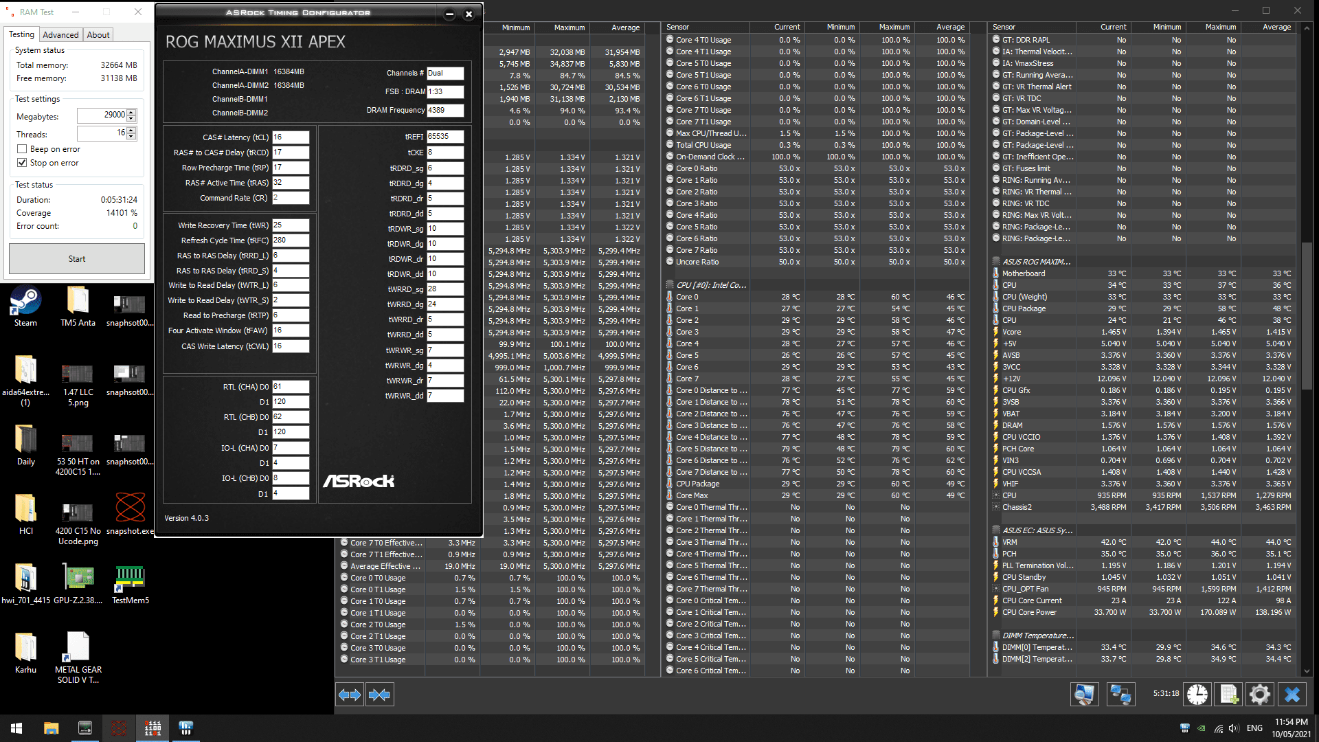

Personally i have invested a lot of time in slopes with Z490 apex + 3200C14 Dual rank bdie. It has got me no gains, I am starting to think my memory kit is the issue here and i need a more selected kit. Booting to 4400 C16 / C17 is not a problem, 4500 and above becomes an issue with mch fullcheck enabled it sometimes will fail to train, 4600 will rarely train. If you have the right set of dual rank bdie and a good imc i think slopes will be a worthwhile investment but for me it got no gains sadly. 4500C17 + is very hard to boot, even with some vref adjustments and late command training or early command training it is tougher to boot than CL16. At the moment i settled with 4400C16, 4500 was giving me issues one day i do over 4HRS HCI + 2 HRS 112K FFT prime and the next day i boot and run a stress test and system reboots with a black screen no BSOD, sounds like a VTT training issue to me but i can't use a different training VTT with the apex.

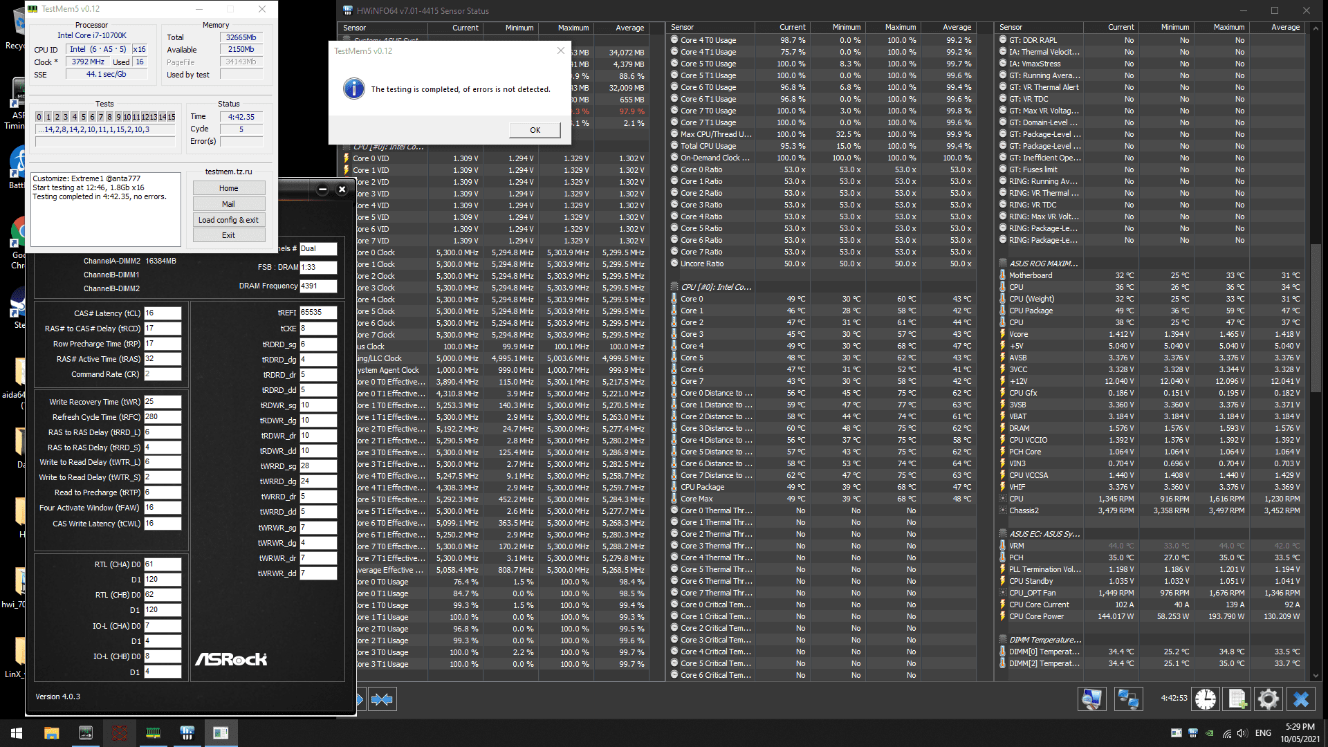

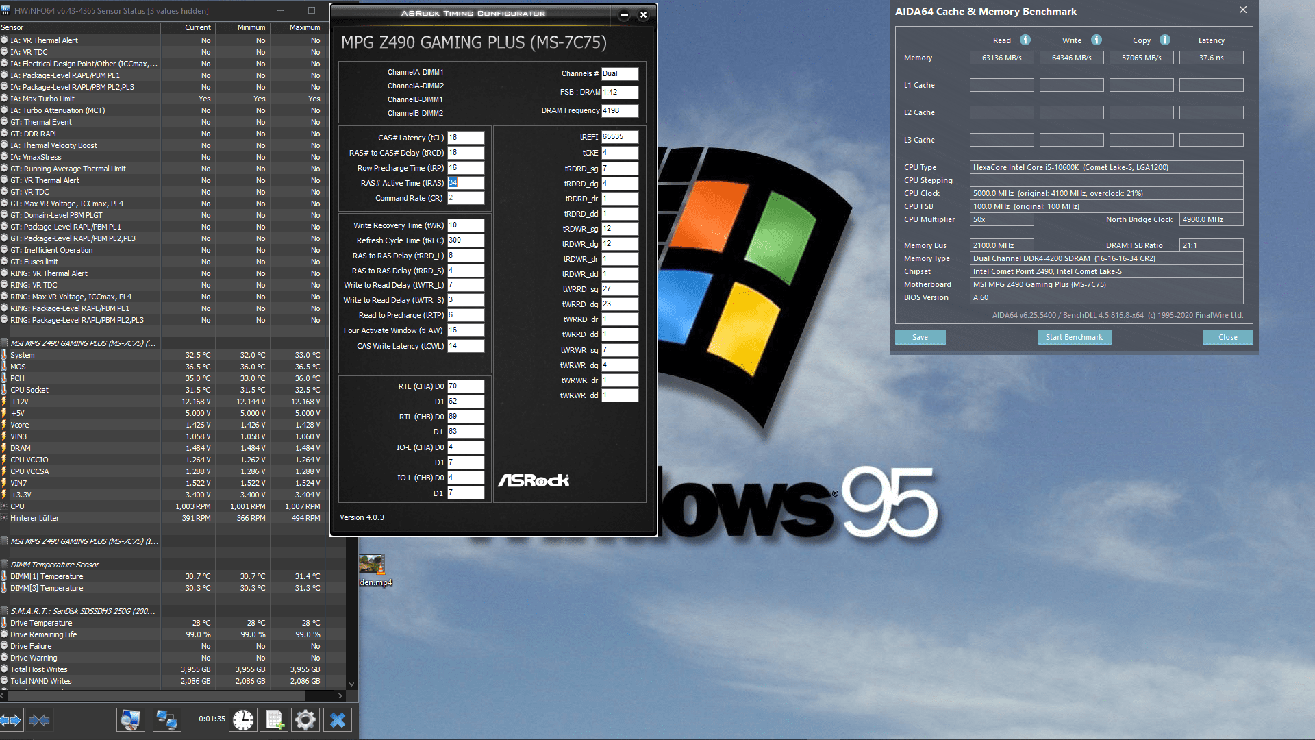

My current daily settings below, still yet to tune SA / IO i don't need this much. For TWR it gave me issues in karhu even at 20 so i just left it on auto for now. My set of dual rank seems to hold me back with 4500+ but 4400C16 is enough for now. Spend time on 4500 but it doesn't post consistently with MCH fullcheck and when tightening trdwr's it is very inconsistent on booting so no point for me.

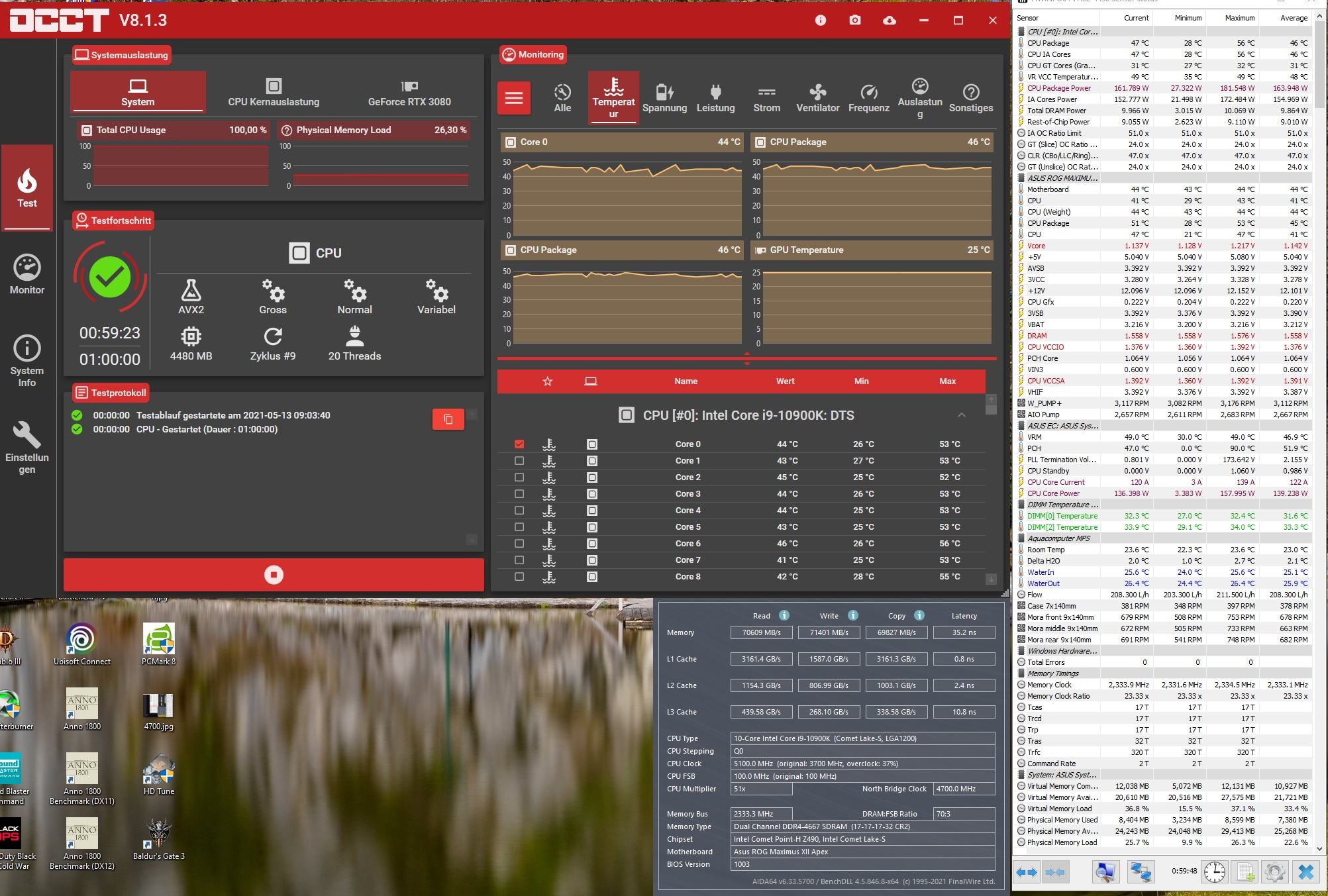

For me this has been the best cpu core/ring/imc test for daily gaming. Even on AVX games like battlefield there is no issues with stability. The standard version of large avx 2 is fine but extreme will need a bit more vcore. Also doesn't use too much current so easy to cool.
I have found the issue with booting 4600 consistently for me. With Cas 16 i need TCWL 13 to boot consistently. I have got this booting consistently now and i am working on the slope values, i hope i can have this fully GSAT stable soon.
For 4600 works better with no Sub's at 5.
Tcwl "change" RTL/IOL.
For me the biggest issue was booting consistently, i am testing GSAT now for slopes and have made some passes i just need to make sure this will work boot to boot. If i did TCWL 16 this would not even boot consistently. (With TCWL 13 i use TRDWRS at 14, This is the same performance as TCWL 16 TRDWRS 11) but for me boots all the time.
