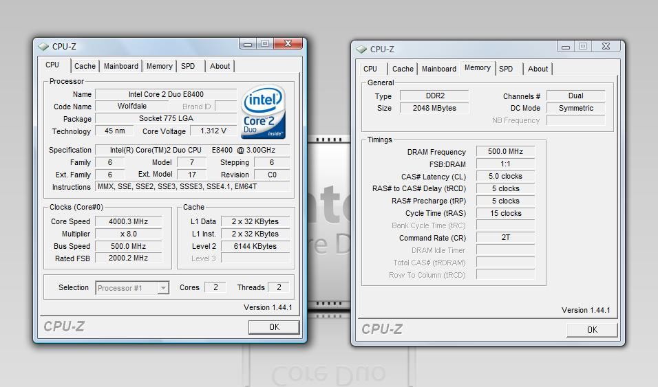

so nun meine optimale Einstellung- vielleicht ist ja für jemand was dabei:
Bios 0907 mit Bios 1003 ging es leider nicht!
CPU Feature
Ai Overclock Tuner [Manual]
OC From CPU Level Up [Auto]
CPU Ratio Control [Manual]
Ratio CMOS Setting: [8]
FSB Frequency [500]
FSB Strap to North Bridge [400]
PCIE Frequency [110]
DRAM Settings
DRAM Frequency [AUTO]
DRAM Command Rate [AUTO]
DRAM Timing Control [Manual]
CAS# Latency [5]
RAS# to CAS Delay [5]
RAS# Precharge [5]
RAS# Active Time [15]
RAS# To Ras# Delay [auto]
Row Refresh Cycle Time [auto]
Write Recovery Time [auto]
Read To Precharge Time [auto]
Read To Write Delay(S/D) [Auto]
Write To Read Delay(S) [Auto]
Write To Read Delay(D) [Auto]
Read To Read Delay(S) [Auto]
Read To Read Delay(D) [auto]
Write To Write Delay(S) [Auto]
Write To Write Delay(D) [auto]
DRAM Static Read Control [Disable]
AI Clock Twister [Auto]
Transaction Booster [Enable]
Boot Level: 1
Voltage Settings
CPU Voltage [1.3500v]
CPU PLL Voltage [1.60v]
North Bridge Voltage [1.35v]
DRAM Voltage [2.20v]
FSB Termination Voltage [1.40v]
South Bridge Voltage [1.075v]
Loadline Calibration [Disabled]
CPU GTL Reference [0.63x]
North Bridge GTL Reference [0.67x]
DDR2 Channel A REF Voltage [Auto]
DDR2 Channel B REF Voltage [Auto]
DDR2 Controller REF Voltage [DDR2_REF]
SB 1.5V Voltage [1.5v]
