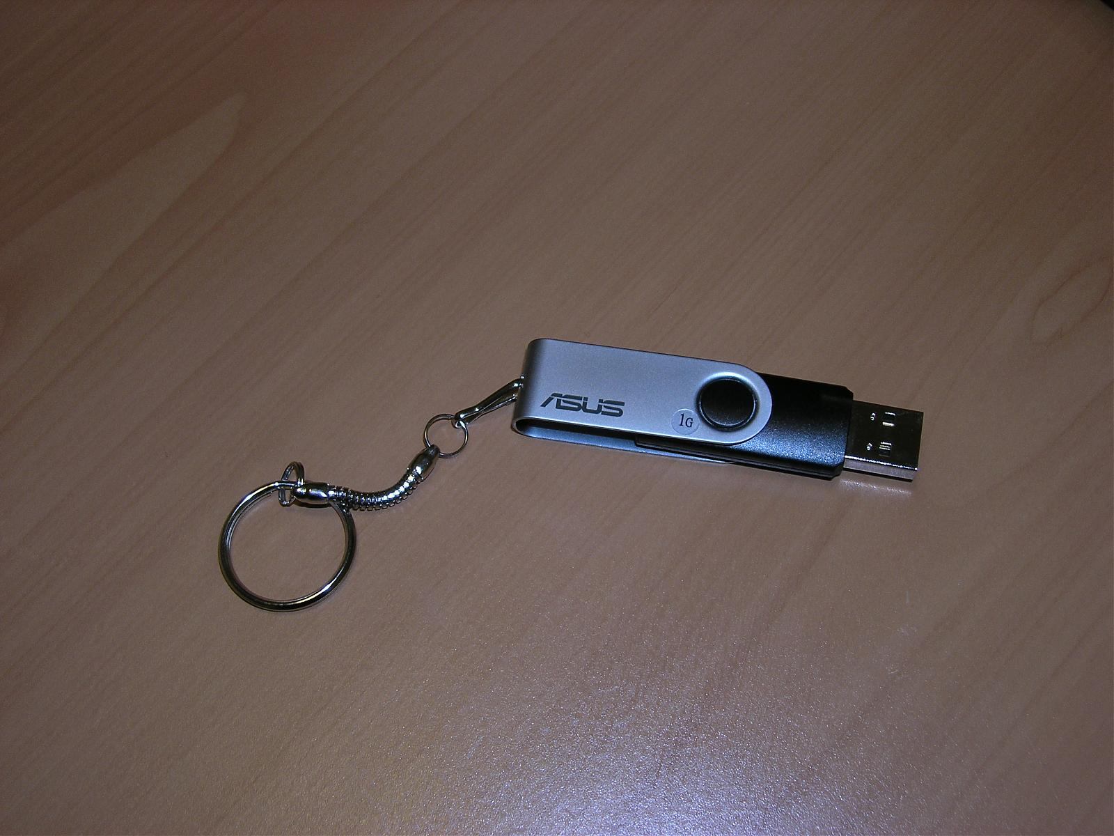

I just got today a very nice gift from them. :shot:
It is also strong evidence that makes believe that Kurim is part of the ASUS team.
I helped them to reach to the solution of the grainy screen problem, because I have described the grainy screen problem very clearly to them and which helped them to get right solution for it from their R&D branch in Taiwan and last Friday I have paid some money to the asustreiber.de to help them with the server costs they have to pay to run the website. Look here:
http://asustreiber.de/page.php?2
As a reminder this is not run by ASUS but privately by people who work for ASUS.
In response to all the help I provided to ASUS, they have sent me a free 1GB USB Flash memory. :love:
If Kurim was not working for ASUS I will not get a free gift from ASUS and the UPS post would not be coming from ASUS Abt. Kommunikation und Marketing in Ratingen. See the two attached pictures.
After this I don't care who believe it or not I don't need to prove anything to anybody from now on.
If you don't like or you are too scared that you lose 1400 euros just don't flash the bios v205. If you are happy with the grainy screen, just stay with it.
:mad:
I just want to say thanks to Kurim and ASUS for a very nice gift indeed.
This is a free lovely gift that they only give to very special people. :cool: :cool: :cool: :cool: :cool:
