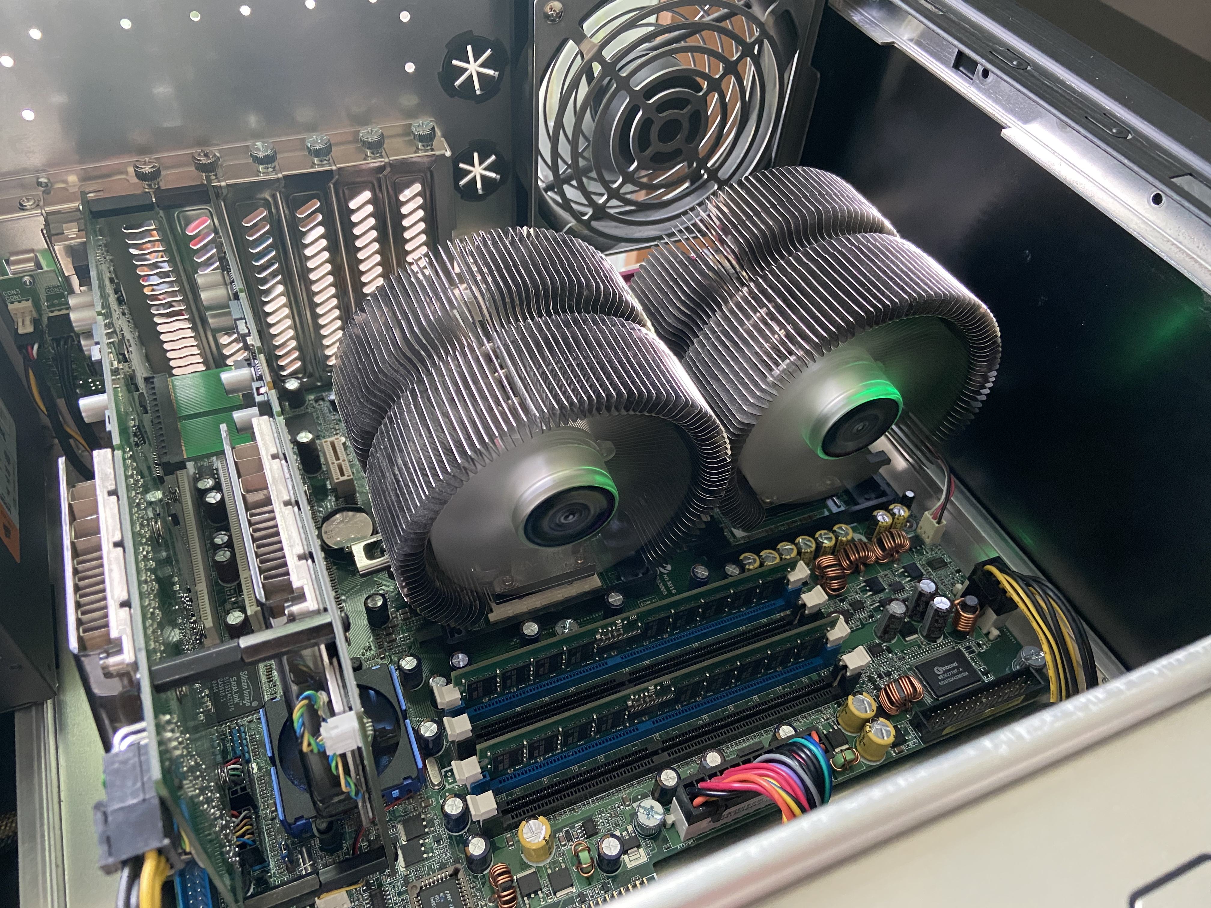

This is not the H8DCE-HTe, but the standard H8DCE (without suffix). You can spot the heatsink without fan (-HTe has a fan on that heatsink). Furthermore the topmost slot is PCIex4, not HTe. HwBot has a lot of errors in retro hardware scores, or the members intentionally submit wrong data.
I can tell that the H8DCE does NOT have any overclocking options within the BIOS, except for memory timings and memory divider. Every memory divider above 200MHz (read: 216, 233, 250) reverts back to 200. There is no way to enable hidden settings (I tried it, bricked the BIOS chip and hotflashed it back.) You can try some overclocking via nTune. There is a version that works with Windows 7 x64. I'm not sure if nTune really works, because I only tried overclocking my Dual 290s. An increase of 5MHz on the HT clock crashed the system. Didn't check for maxHT with lowered CPU multi. Maybe it's time to reanimate that 600W heat monster and try some serious stuff ;)

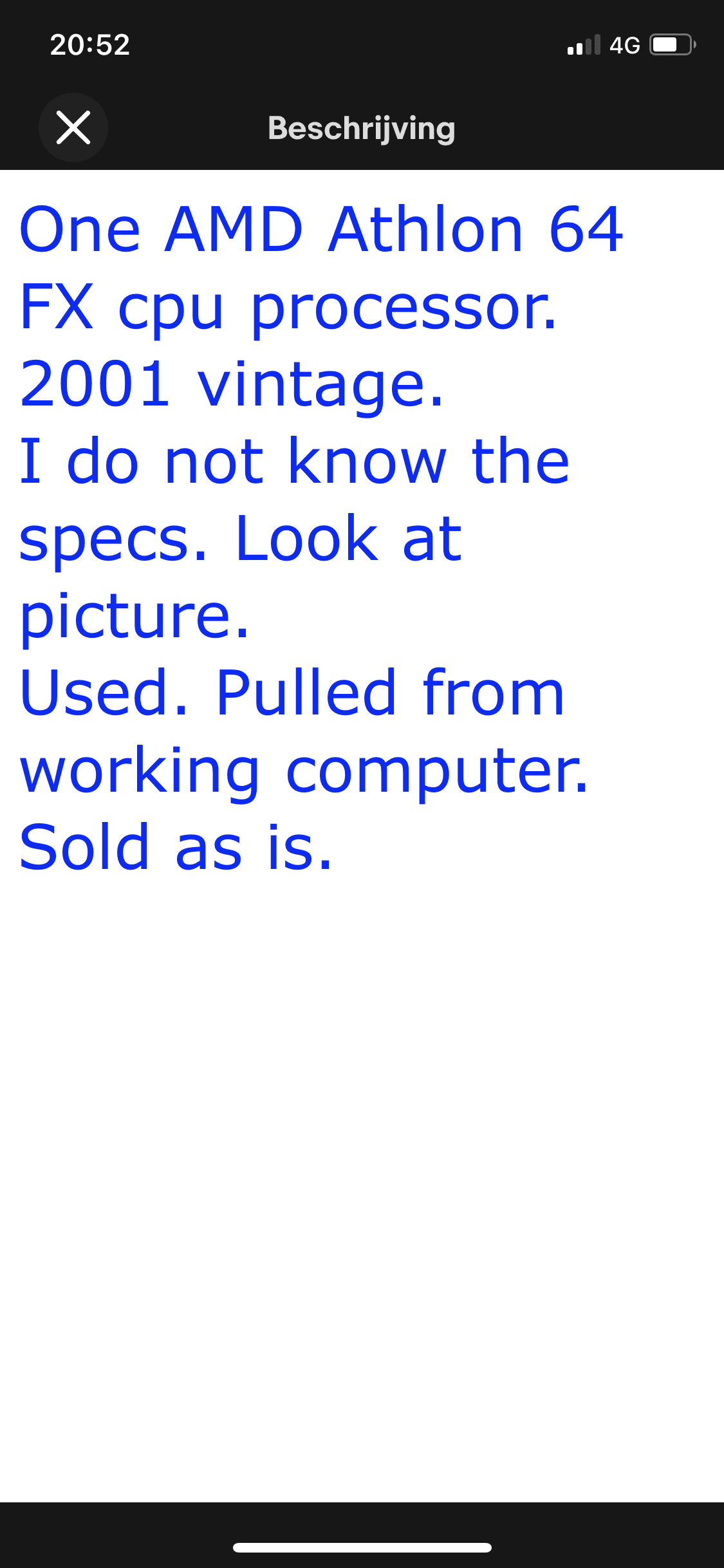

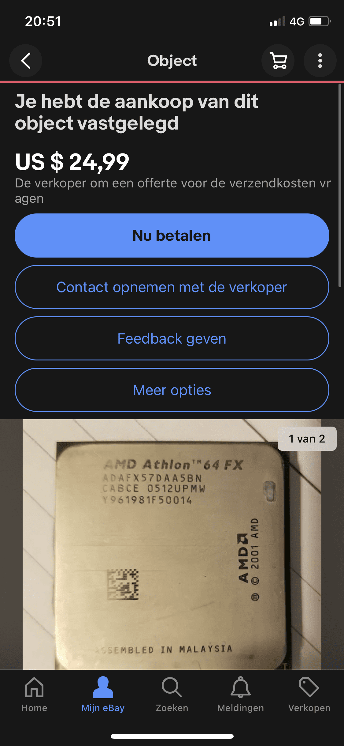

Das ist ja unterste Schublade, wer macht denn sowas ? Kannst dich glücklich schätzen. Ist zwar kein so gutes Stepping, aber hey, es ist ein FX-57, was will man mehr :d
Mmh, vielleicht zwei FX-57? Oder einen FX-57 mit gutem Stepping?
Also mir fällt schon etwas ein, was man mehr wollen würde... :fresse:
jk, good find/great deal! :)
