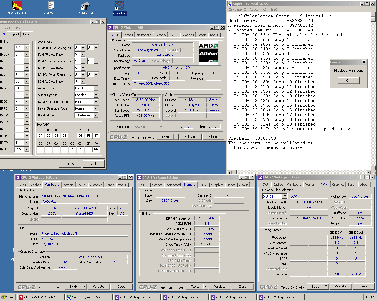

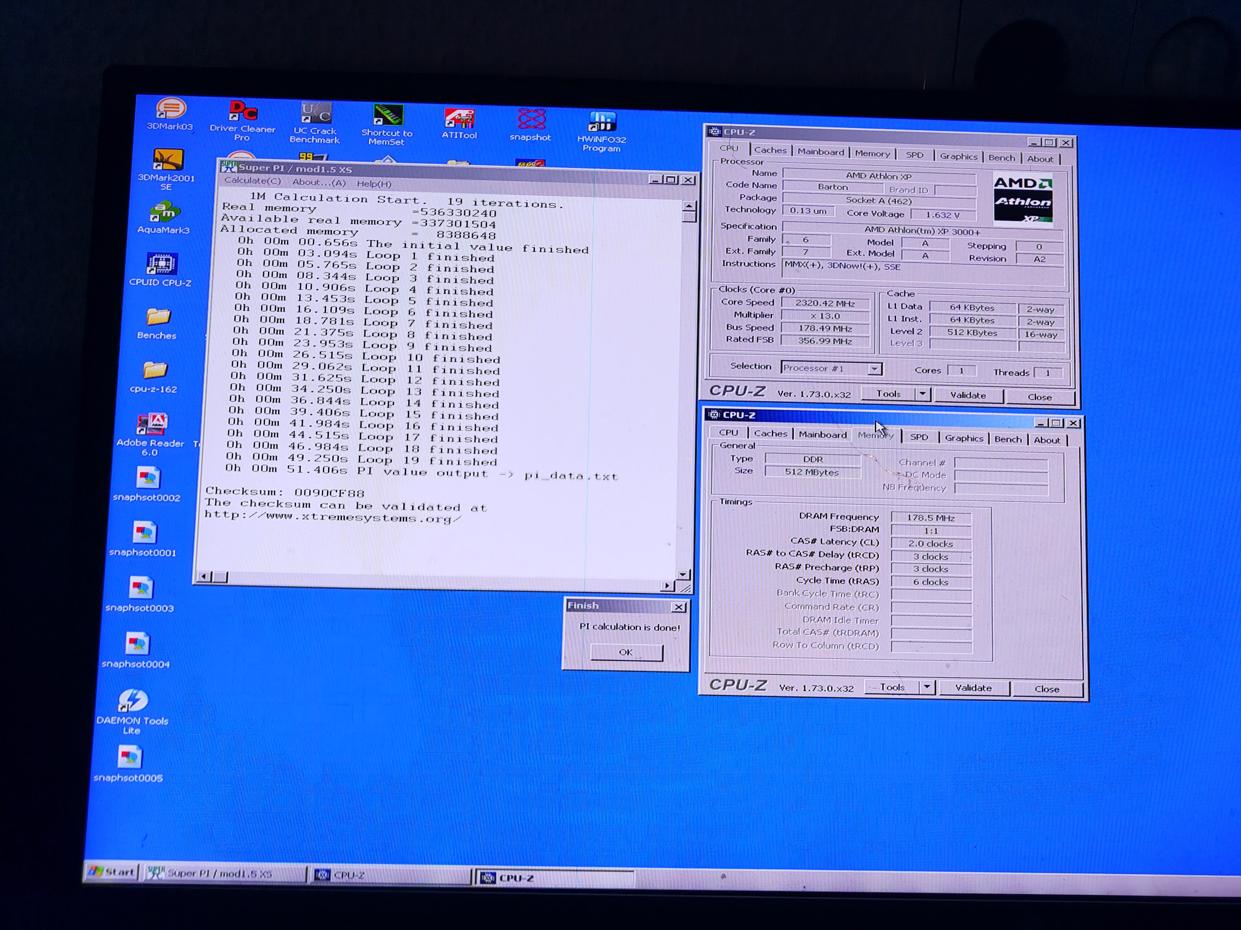

SuperPi 48Sec. mit 2,2GHz
Greif dir mal die SuperPI 1.5XS Version, die zeigt Millisekunden an. Gibts bei hwbot. Ansonsten ist 1M ne super Idee, nur wie gesagt das Board ist in einen Augen wegen der geringen Einstellmöglichkeiten nicht optimal. Das NF7 wäre vermutlich besser geeignet.
2.2ghz mit erhöhter Vcore liegt je nach Stepping im erwarteten Bereich. Ich habe sogar CPUs, die 1.9V für die 2.2ghz brauchen…

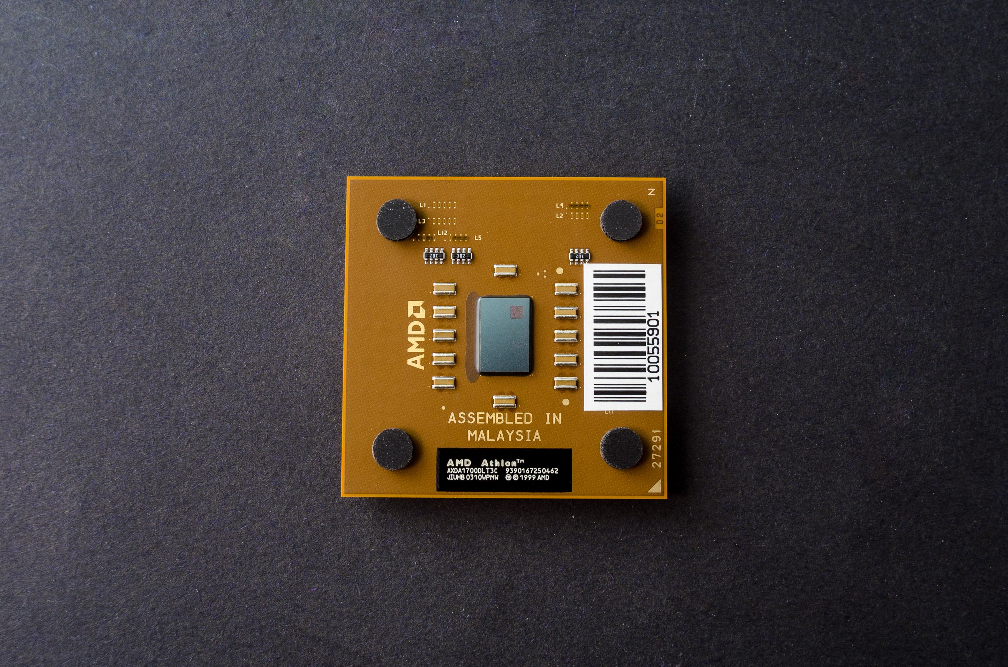

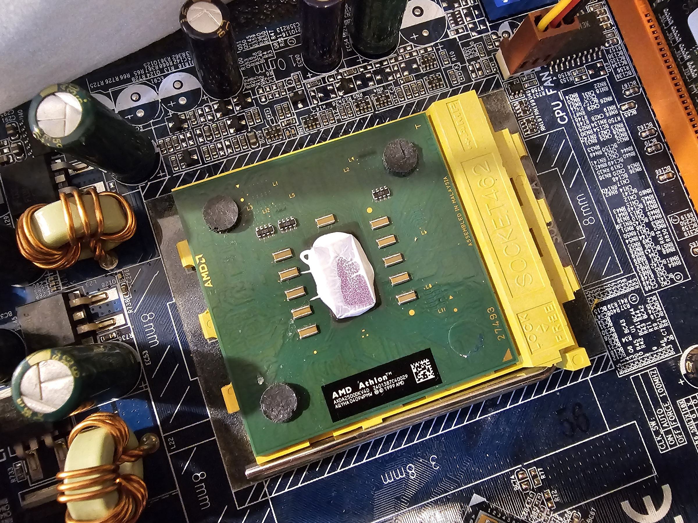

Mach einfach ein gut leserliches Foto deiner CPUs, dann kann man dir die aussichtsreichsten Kandidaten nennen.

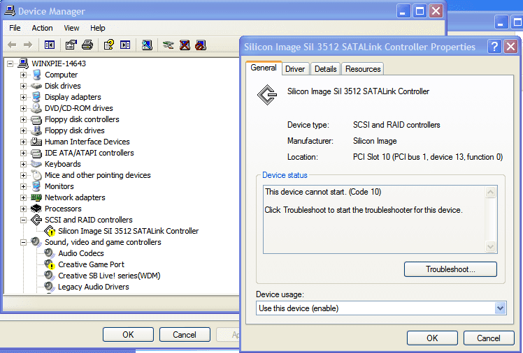

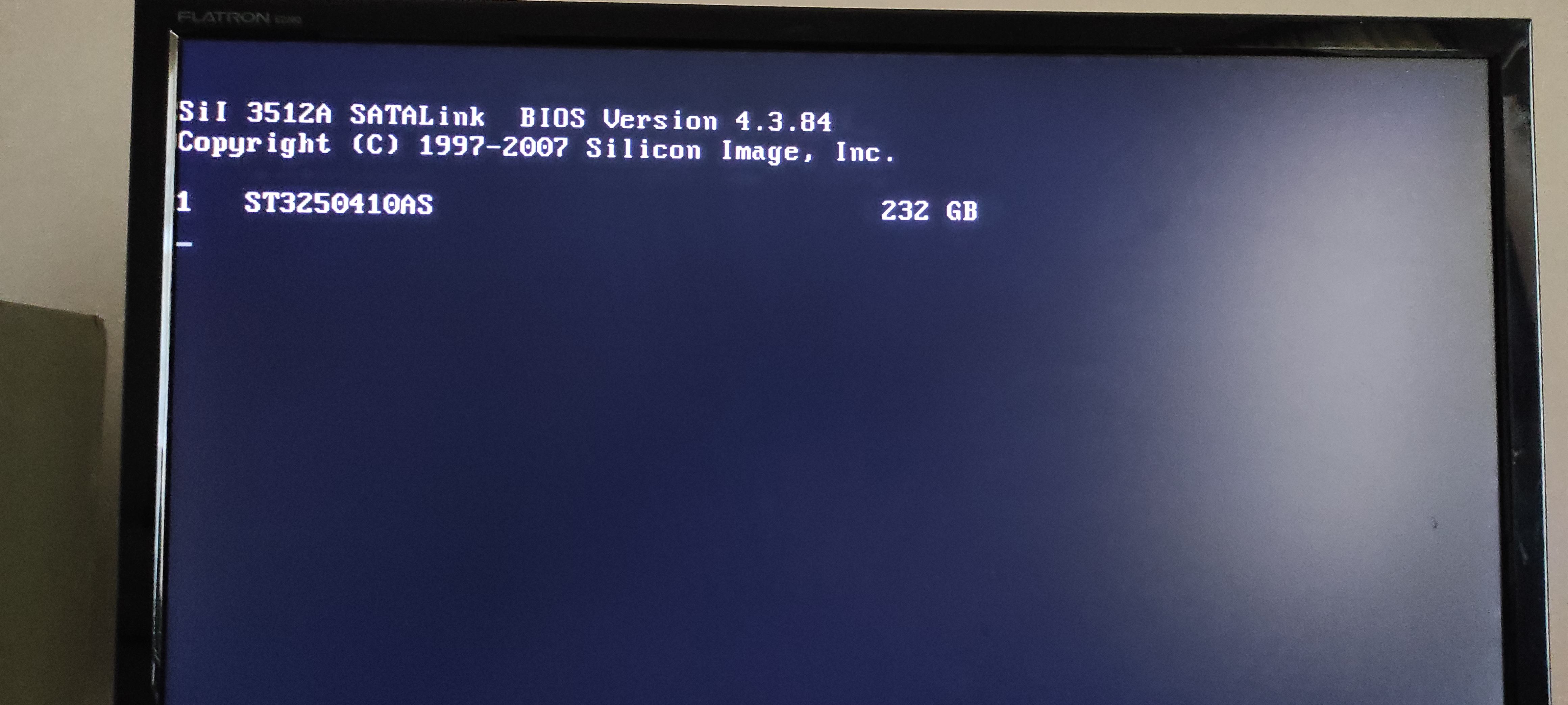

1. Is it an issue with the Sil Image firmware update in bios or am I missing something else?
Let me clarify:
There’s two sata firmware variants available which you can integrate into the bios: regular sata and sata raid firmware. If your modded bios has regular data rom integrated, then you need the regular data driver. If it has sata raid, then you need sata raid driver.
when the controller shows it’s initialization screen (where it displays the detected sata drives) right after the bios post screen, it shows if it’s raid or not.
I assume the upgrade is the last version (4.4.0.2?) so you also need a quite new driver for it. Probably released in 2006 or 07.

Thanks, the romsip is it the updated chipset/ram timing table for better overclocking? Yes Please :)
The attached zip is of the FK BIOS for this board with SIL 3512 v4.3.84 already integrated by Tsk
Thanks
Ok if i understand correctly digitalbath took SIL 3512 v4.3.84 from a bios image you had modded and added it in FK version bios, with L12, romsip and new nvidia lan image.

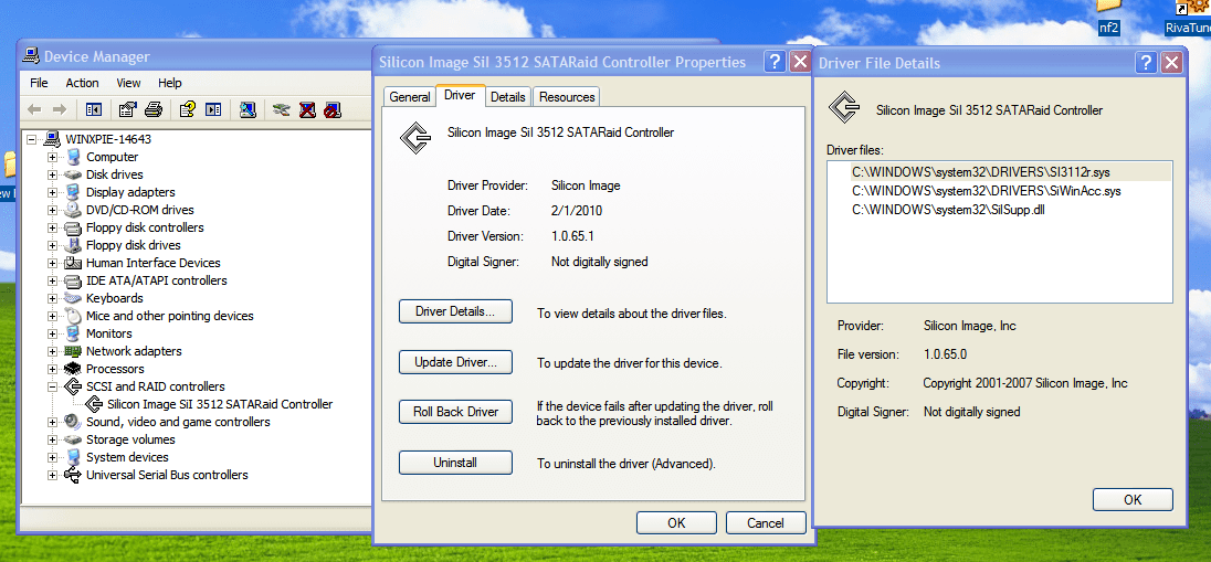

Can you please check the attached image, I tried 2010 driver and 2007 driver with same result.
edit:
Ok, i think i understand what you mean, but still i'm having the same issue.
So i installed Silicon Image Satalink drivers instead of SataRaid. If i set Raid on bios, inside windows the device cannot start giving me an error. Changing setting to Base inside bios, fixes the driver issue on windows but when i connect the drive in the sata port i still cannot boot.
edit2:
So, there is a motherboard version of the Silicon Image that is integrated inside the bios. It's not Base nor Raid version.
Final edit:
I replaced the sil image firmware with v4833 and still got the same error. Finally i replaced it with the v4333 and now i can boot to windows without problems. It seems my windows installation doesn't want to boot with newer sil image firmware.

Thanks for your help! I managed to downgrade the Sil image to v4333 with cbrom and the modded bios booted to windows properly, so no need to prepare. Check my edits in my previous post.
I'm guessing that either windows on boot is loading some older driver(because when booting in safe mode I can see that windows is loading sil3112 driver) or the flash885.exe that came with the official bios is not properly flashing the rom(!?). I need to troubleshoot some more though. Any thoughts are more than welcome.
Ah, nice! nice to hear. So the system is working now? No need for other versions? If you need other BIOS versions, feel free to ask. You also can tweak the SIPs with the tool in windows to find most stable values. I can mod your values into the BIOS.

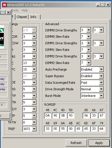

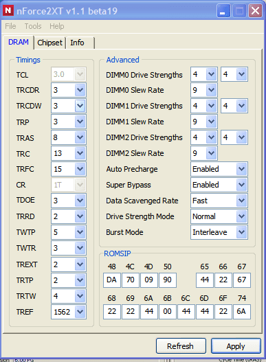

you can try these values. Drive Strength and Slew Rate depends on your board an dimms.

Yeap it's booting fine. First flash was with @BIOS gigabyte utility and still had the booting issue with v4834. So maybe it's just the windows installation that has the issue. But I'll troubleshoot it.
I'll try to find some info on sip timmings in this thread so I can fiddle around. At this point I have Thermaltake Dragon Orb 3 cooler on the cpu, which looks retro and nice but is really trash for overclocking.
Is 11x multi good for ED sip?
I forgot what Multi didn't work out that good on ED SIPs. Probably 9.5x or 8.5x. I am not sure. I test my boards most of the time with the Multi 9.0x to find its limits without a CPU bootleneck. After that, I raise the Multi to the CPU limit. Multi 11x should generate a good memory performance.
Dragon Orb3 is a really nice oldscool cooler, but yes there are other cooler with a better performance. :)

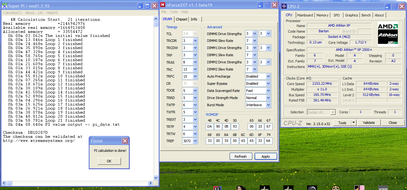

Just copied your settings.
Ok some realizations about the mobo. It really overshoots in vcore. Default vcore= 1.670-1.692v. Other people have also reported this. I have replaced some cpu vrm caps, but probably this isn't enough.
11x195 is stable(3dmark03 cpu test/ spi4m /Mozilla FF) at +5% = 1.696-1.712v
11x200 is stable(3dmark03 cpu test/ spi4m /Mozilla FF) at +7.5%= 1.73-1.77v
Can't really go higher vcore atm cause of the cooling(and banana cpu as it seems :P). Probably the thermal diode also overshoots in temperature, but at +5% it's around 65C and +7.5% it reaches 70C.

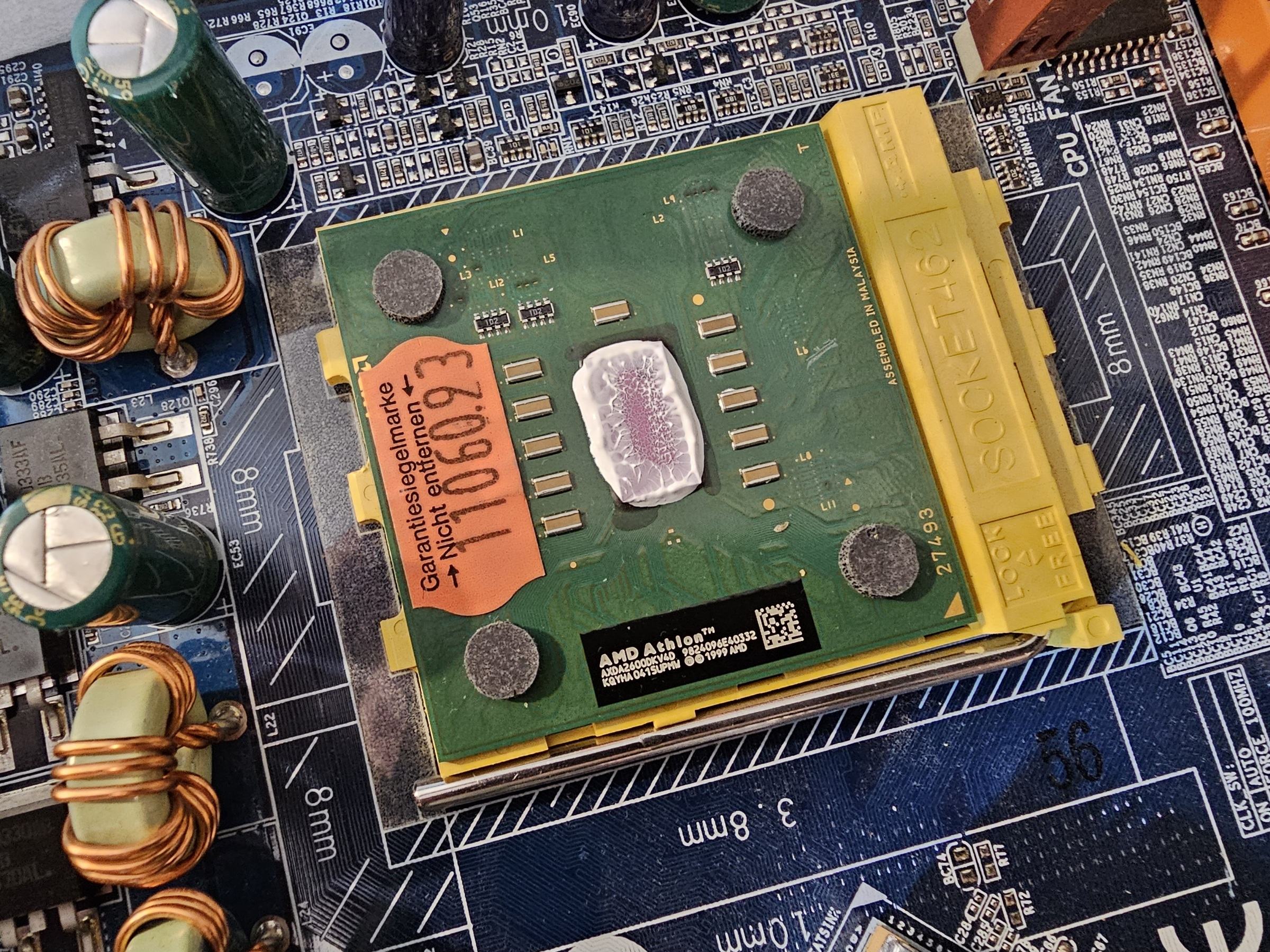

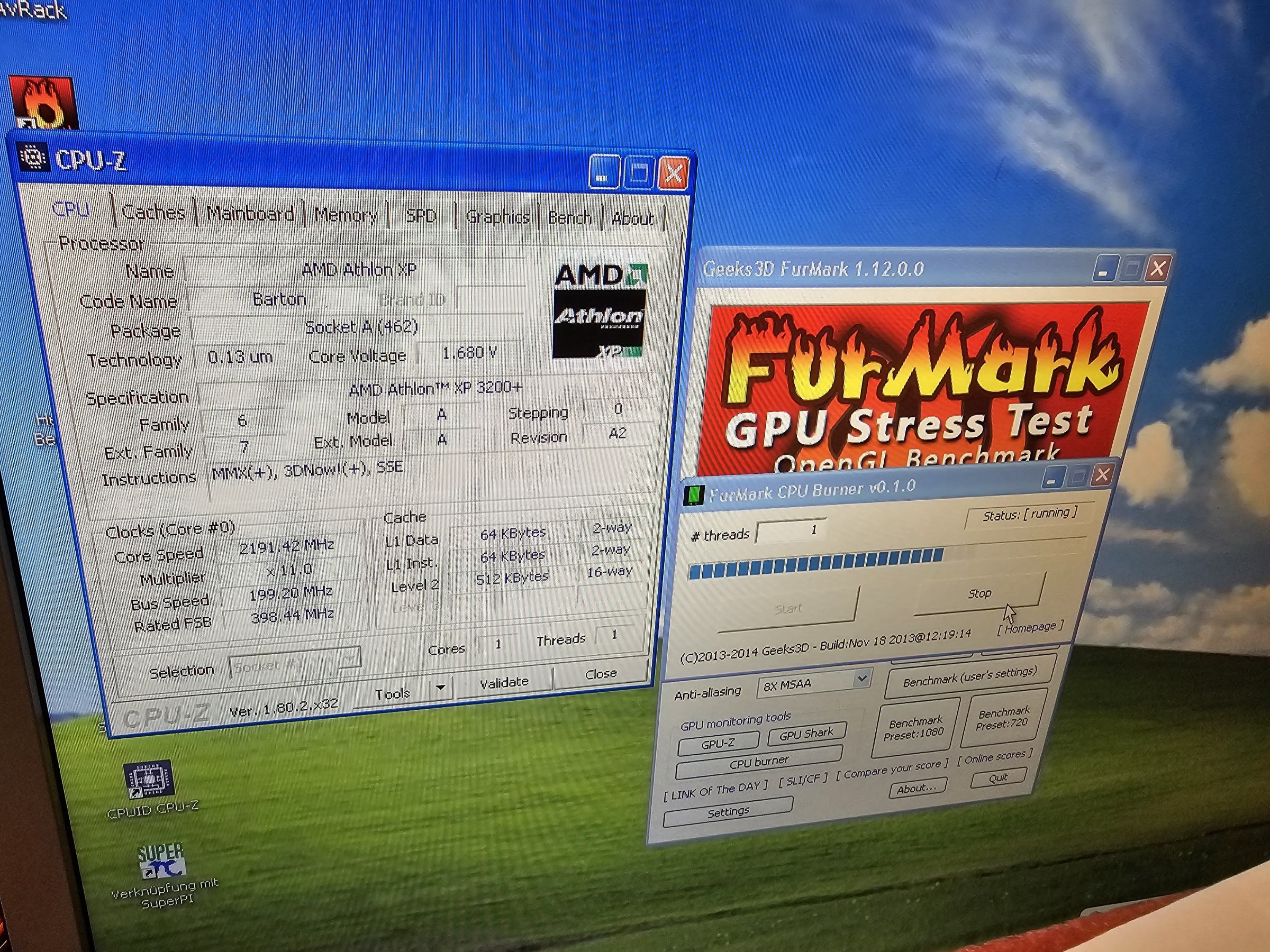

So endlich, mal ein 2500+ erwischt der mit 2,2 GHz ohne manuelle Spannungserhöhung lief :)

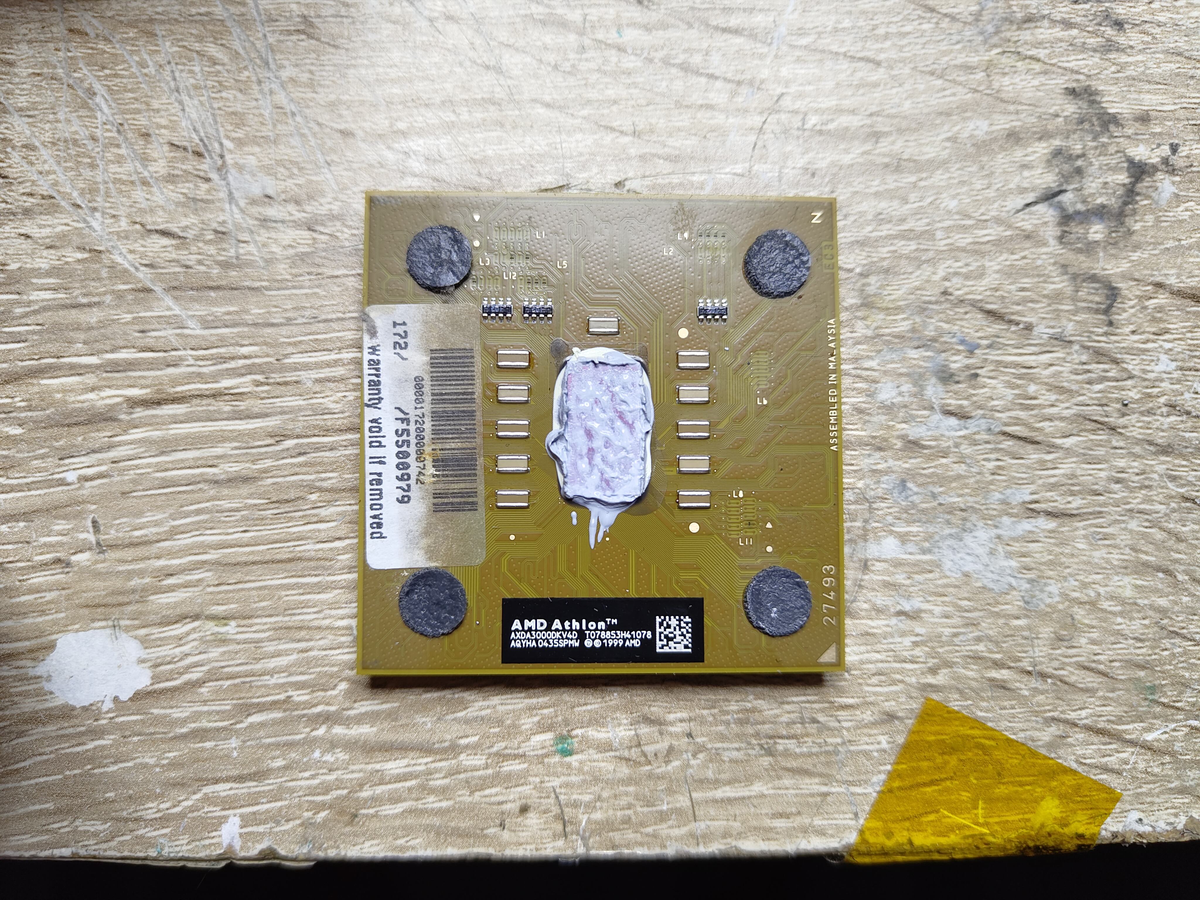

AMD hat bei den Athlon XP nicht vorgesehen, dass die eindeutig identifizierbar sind. Die haben keinen internen Speicher mit der Modellnummer. Das BIOS knobelt unter anderem anhand des erkannten Standard-FSB und Standard-Multiplikators aus, welche CPU das ist. Deshalb kann es selbst bei eingestellten 200x11 sein, das die CPU wegen ihres originalen FSB von 166 nicht als 3200+ erkannt wird.
Übrigens wundert mich das Ergebnis vom obigen 2500+ nicht, das ist ein 0409er AQYHA und damit eins der besseren Steppings aus einer vernünftigen Produktionswoche.
Falls du schon andere getestet hast: welche Steppings haben das nicht gepackt?
Danke, sortiere alle grob und kann dann die Fotos machen inkl Spannung die benötigt wurde für 2,2 GHz
Aktuell habe ich noch nen ziemlich schlechten 2600+ erwischt. Der benötigt die maximale Spannungerhöhung des Boards (+10% also ca 1,8V) und pack grad so 190 MHz FSB. Bei 192 Steigt der schon wieder aus.
Bzgl der Erkennung. Könnte gut sein dass es wegen dem Mulit ist wie du sagst. Der 2600+ wird immer als 3000+ erkannt wenn. Den 3200+ Gabs glaub nur in 2 Versionen mit 333MHZ und 400MHz FSB. Vermutlich muss der Multi dazu stimmen sonst schätzt er es als was anderes ein.

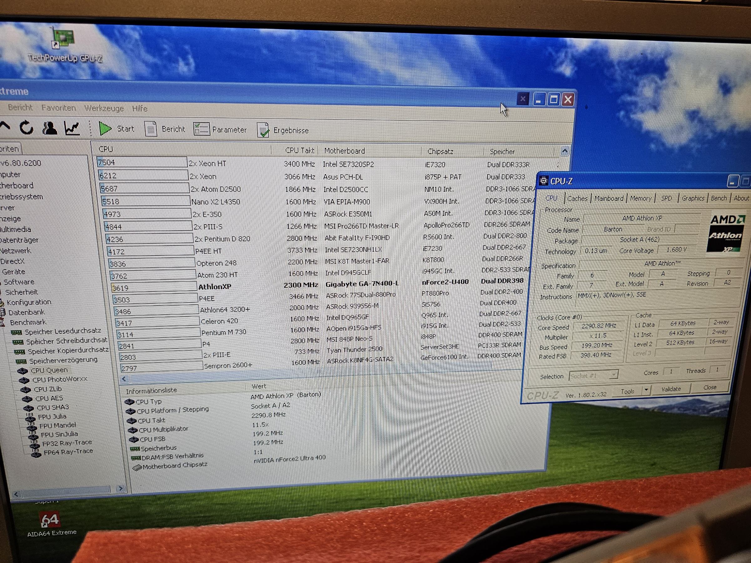

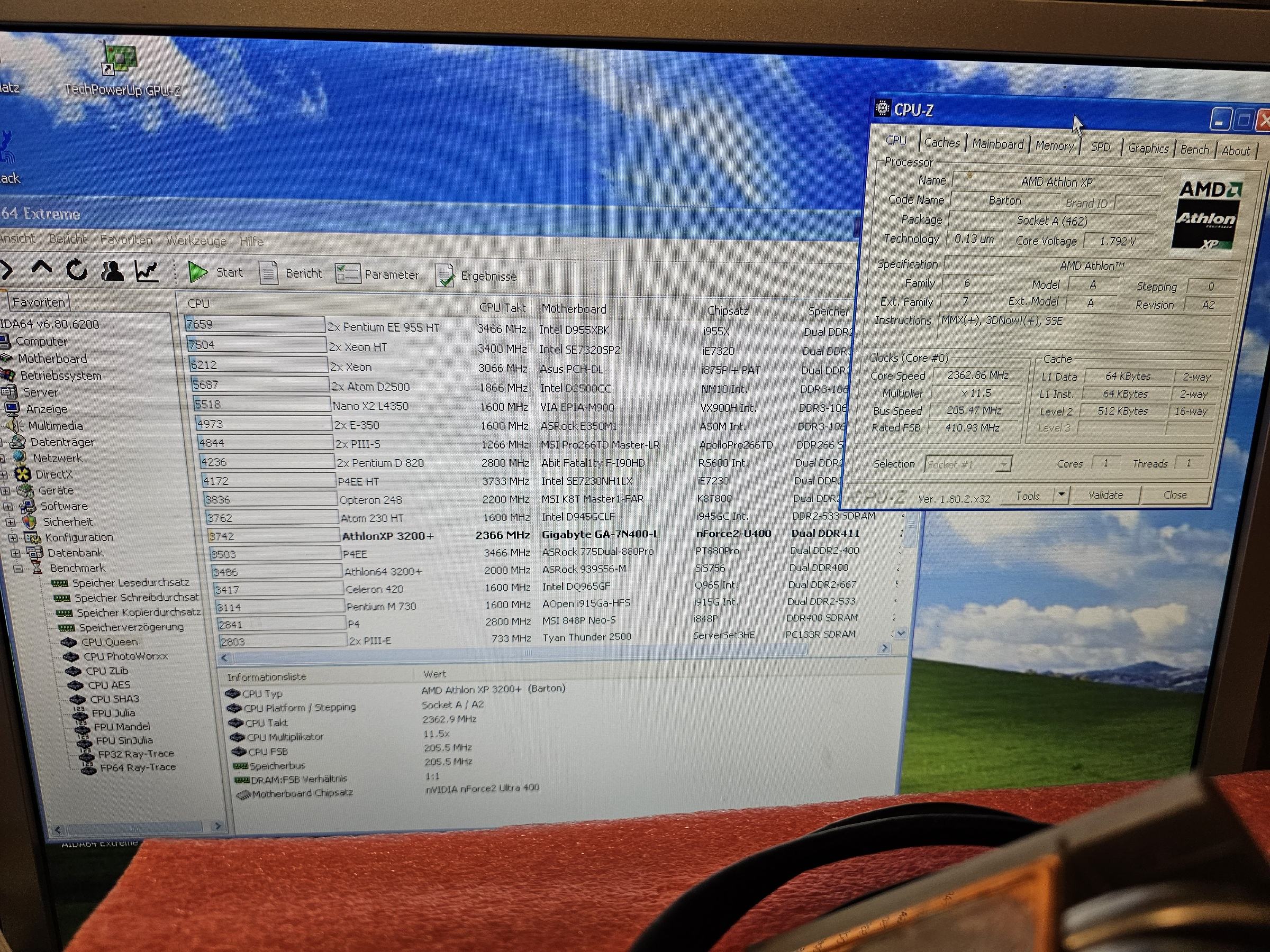

Update zu meinem besten Barton bisher: Die CPU macht 2300MHz@1,65V und ca. 2375@1,75V.
Oha Glückwunsch! Mit FSB Anhebung oder? Und wie gebencht?
Bzgl meinem Benchen aktuell. Folgende Reihenfolge:
1.) Mind 10 Min Furmark CPU Burner. i.d.R steigen Problemfälle da in den ersten 30 Sek. aus. Wer 2 Min schafft, schafft meist auch die 10 Min. Selten schmieren aber welche genau nach 8 Min oder so ab. Teils lasse ich es auch 15-30 Min laufen.
2.) Super Pi M1. Wenn 10 Min Furmark geklappt haben klappt der eigentlich immer.
3.) Optional: Aida64 Benchmark um die Leistung grob einzuordnen
Ja, mit um die 180 FSB oder was das war. Danke. Auf meinem Epox 8KRAI und mit SuperPi 8M (läuft ca. 10min).
Hier ist noch ein Bild mit 2320, das war aber nicht stabil.
Wegen dem Single Channel Chipsatz und dem niedrigeren FSB leistungsmäßig aber trotzdem etwas hinter einem 200x11 Barton auf einem NF2 meine ich.

Ich glaube ich habe mal Glück, gerade nen 2600+ der FSB 200 packt ohne Spannungserhöhung. Also 2,3GHz mit 1,65V (2.Bild).
CPU Z zeigt als auch 2,68V an. Mir scheint generell um so eher ich gegen 3200+ einstelle um so höher wird das. Kann es sein das kleinere CPUs weniger Spannung haben als der finale 3200+? Spannung habe ich eben nicht erhöht im BIOS.
nice! Man muss bedenken, dass CPUs mit dem "K" Stepping [in deinem Fall KQYHA] eher CPUs mit dem schlechteren bin sein sollten. Umso schöner dass es trotzdem nicht schlecht läuft!
Das anzeigen des CPU Namens ist eigentlich egal. Die CPU ist dadurch weder schneller noch langsamer. Es ist eher das Raten des BIOSes welche CPU drin sein könnte.
Bei einem AMI BIOS wird teilweise bei mobilen CPUs "Athlon XP mobile 3200+ LV" oder so angezeigt. :)
Der VIA wird etwas langsamer sein. Man müsste schauen, ob man da noch tweaken kann. Zu dem VIA KT600 habe ich mal eine PCI register tweaks heraus gearbeitet. Dazu müsste man auch mal die romsips ansehen.

Ah ist nen andere 2600+ wie der aufm Bild in meinem letzten Post. Er ist noch verbaut. Wollte schauen wie weit der noch "unprofessionell" weiter getrieben werden kann. Bei 2366 MHz war ich mit 1,8V. 2400 ging auf Anhieb nimmer lange in Furmark
