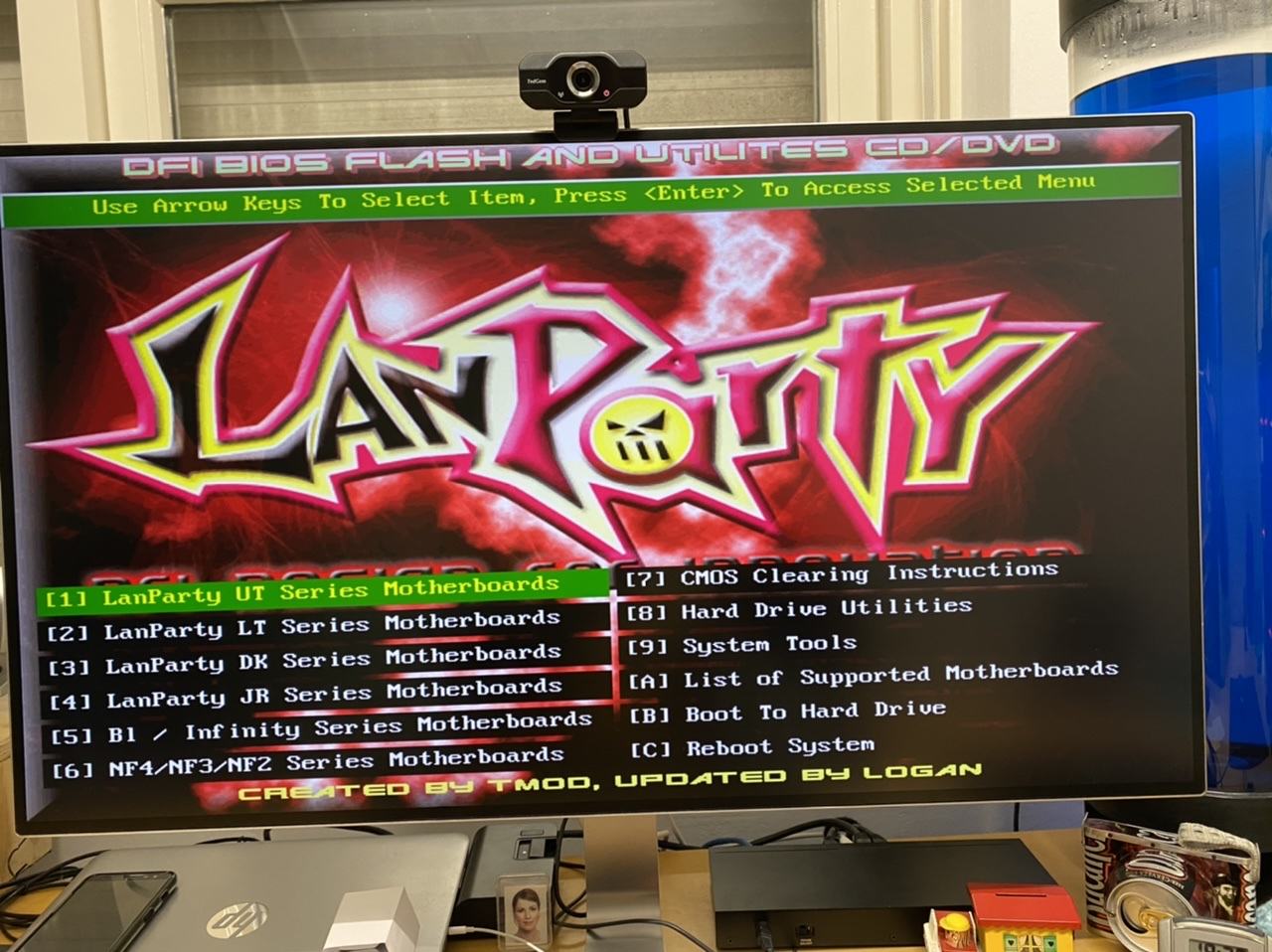

Question: How can I burn or use the Tmod cd? I can't burn it on a DVD and it is too big for a CD (807MB).
Using a USB format and start tool gives me a warning that it won't boot and is unusable. I can mount it on my pc or unzip it but it is completely unknown to me how this works.
Try YUMI. Step 2 = unlisted ISO and then choose the tmod cd

I think I just succesfully booted the tmod cd from usb.
All ram settings were on auto once. I will look into it later.
iirc i burned the tmod cd v11.1.1 onto a regular 800mb CD. I've never used the v11.2.1 as i sold the dfi board before i found a working link online. Nontheless you should be able to boot it from USB or even in a VM.
