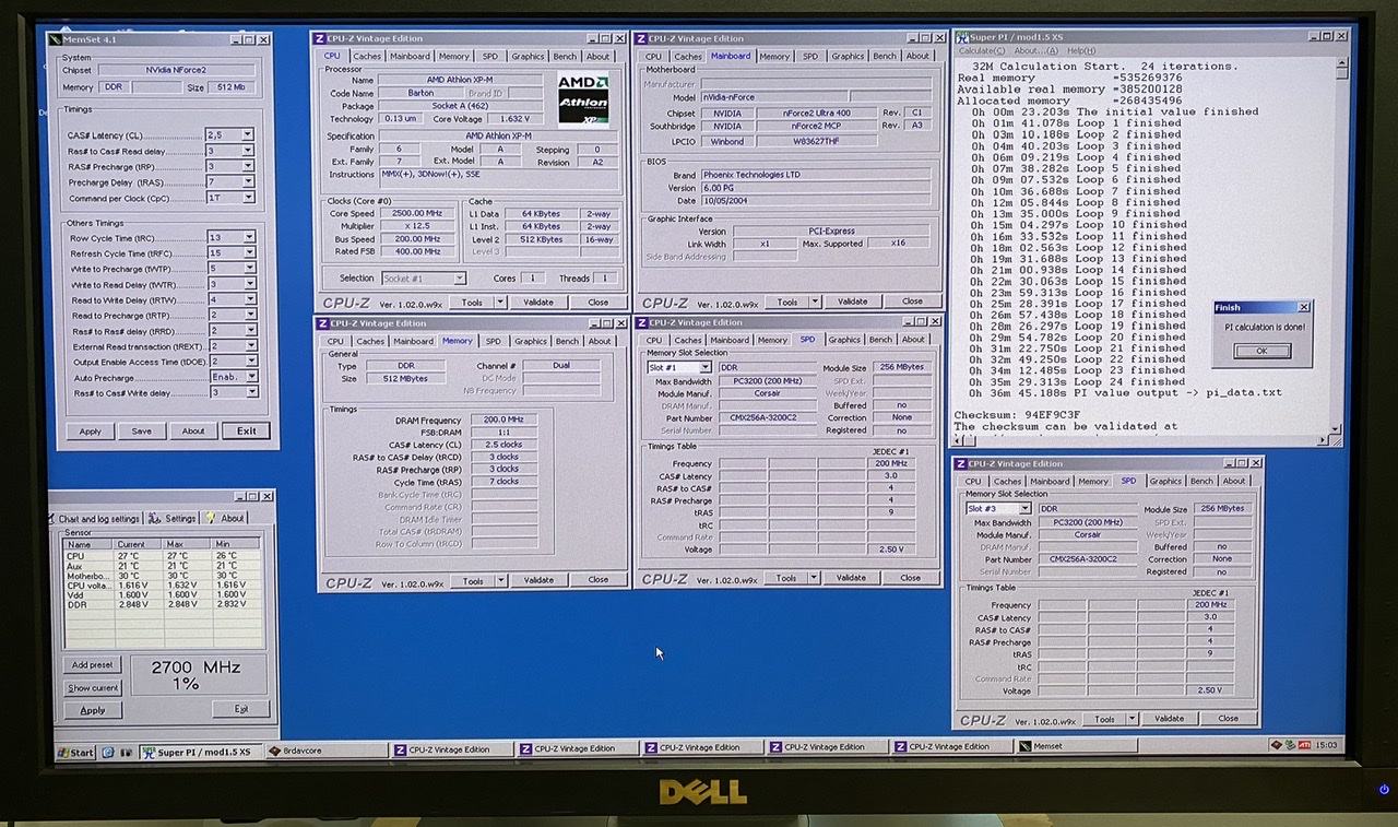

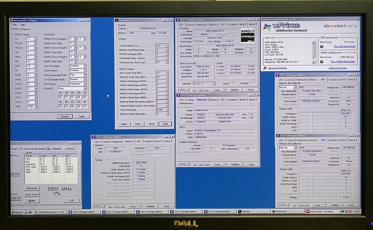

That 32M result is indeed very good. I'm not sure how much better the best "golden" Cpus actually are. I'd guess maybe 1.625V to 1.65V (on coils) for 2500?
Prime95. 3DM01K Lobby 640x480 loop...
Absturz=fail
leider...
32M ist Witzlos, als auch Memtest (lol)...
I can test my other 2500+ xp-m. That cpu seems a little better then this cpu.
It’s 2nd run in 1.625v ran fine to my surprise.
It measured 1.648v on the coil of the motherboard (not 1.659v what I measured before).
Great cpu so far, just not my best 2500.
I have my doubts with 32M as well. It will probably not prime it when making a long run.
At least it is not completly unstable.
My best 2500+ scales (just) a little better on high speeds/voltages.
And no: This or the other 2500+ is not my best cpu. My best cpu can boot 2500MHz at 1.575v (bios voltage, don’t know the exact real voltage by head).
Just for the record. Which exact Prime version are we talking about?
Stock sys will run Prime (older,newer) for years without failing, also 3DM01.
Just don't trust 32M or Memtest. please don't and claim that it's stable...
pick your poison
When I want to be sure my memory is stable I use the tool I got from Sam (Tapakah). I promised him not to share it etc...
I won’t be running prime or 3dmark or other tools for now. I will see what it can do when I have my single stage.

I usually used Prime95, there's a legacy version for winxp you can try:
Or, if you got a decent 3D card on the machine, run a loop of 3D Mark 2001SE. It usually crashes way before Wprime or Spi 32M does.
I have a version of Prime95. It is just that I found this version to be the better version. But for the record, there are not much differences looking at load vs crashes. If this crashes, Prime95 crashes as well and the other way around (in my experience).
3D Mark 2001 SE didn’t run completely but I am not sure about my drivers as well. I had some troubles with Heaven as well and that was with settings my cpu was no issue. That was with a different cpu by the way.
Oh and I have a hd4350 pci at the moment.
Edit: There is a 30.3 build6 version of Prime95. Your link is the older version.
Edit2: the newer versions of Prime95 don’t seem to be working in Win XP 32b (using the 32b or 64b verion). I needed to get v258 to make it run.
  • Danke
Reaktionen: Tzk

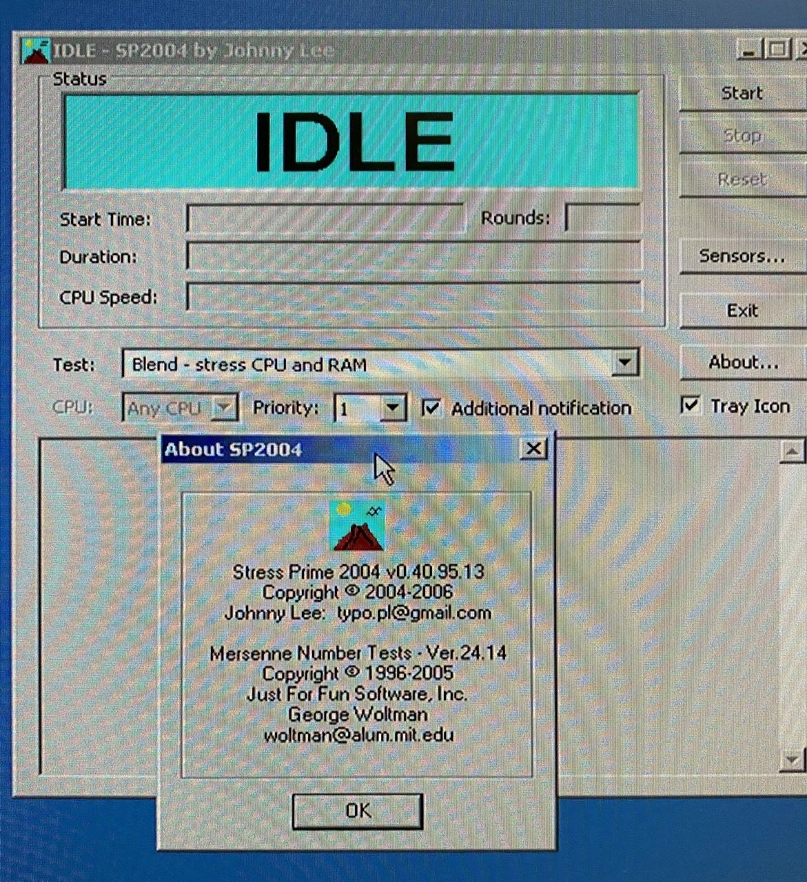

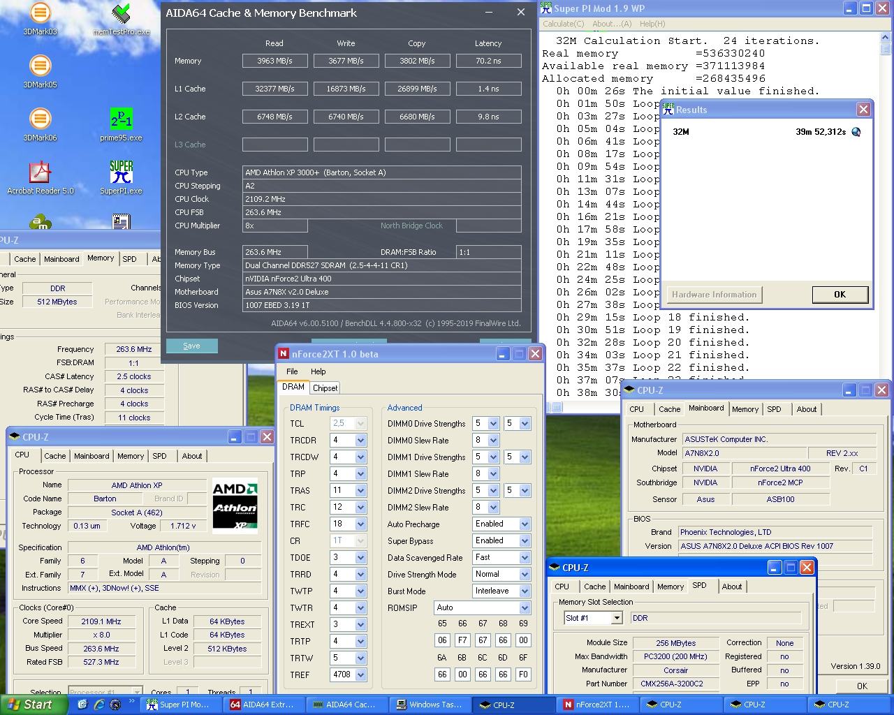

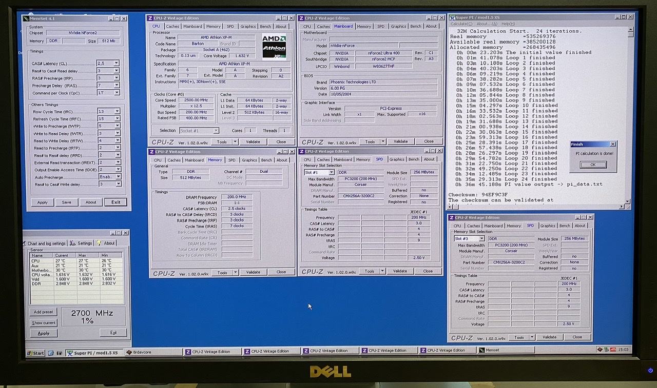

Sparks, what's the "idle sp2004"-programm and the window on the left corner downside your screen?
It just tells you if it is idle or has load. It is SP2004 prime. Back then Prime95 could not run more cores then 1 and sp2004 could. Both do the same stress tests.
On the left is 8rdavcore.

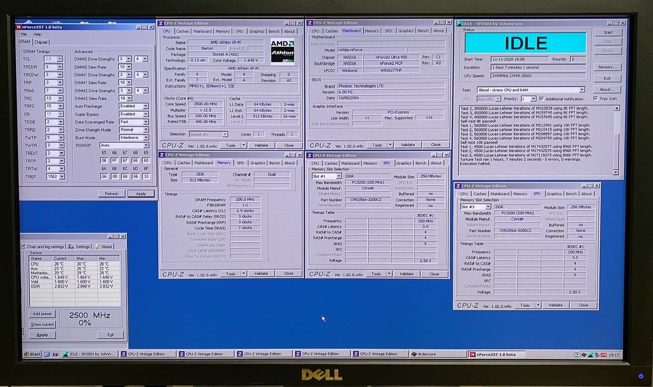

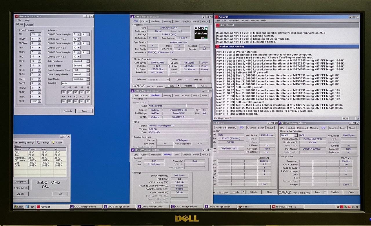

Prime 95 1 hour run with the same voltages as with sp2004. I never tried lowering them. It feels rock solid.
Sp2004

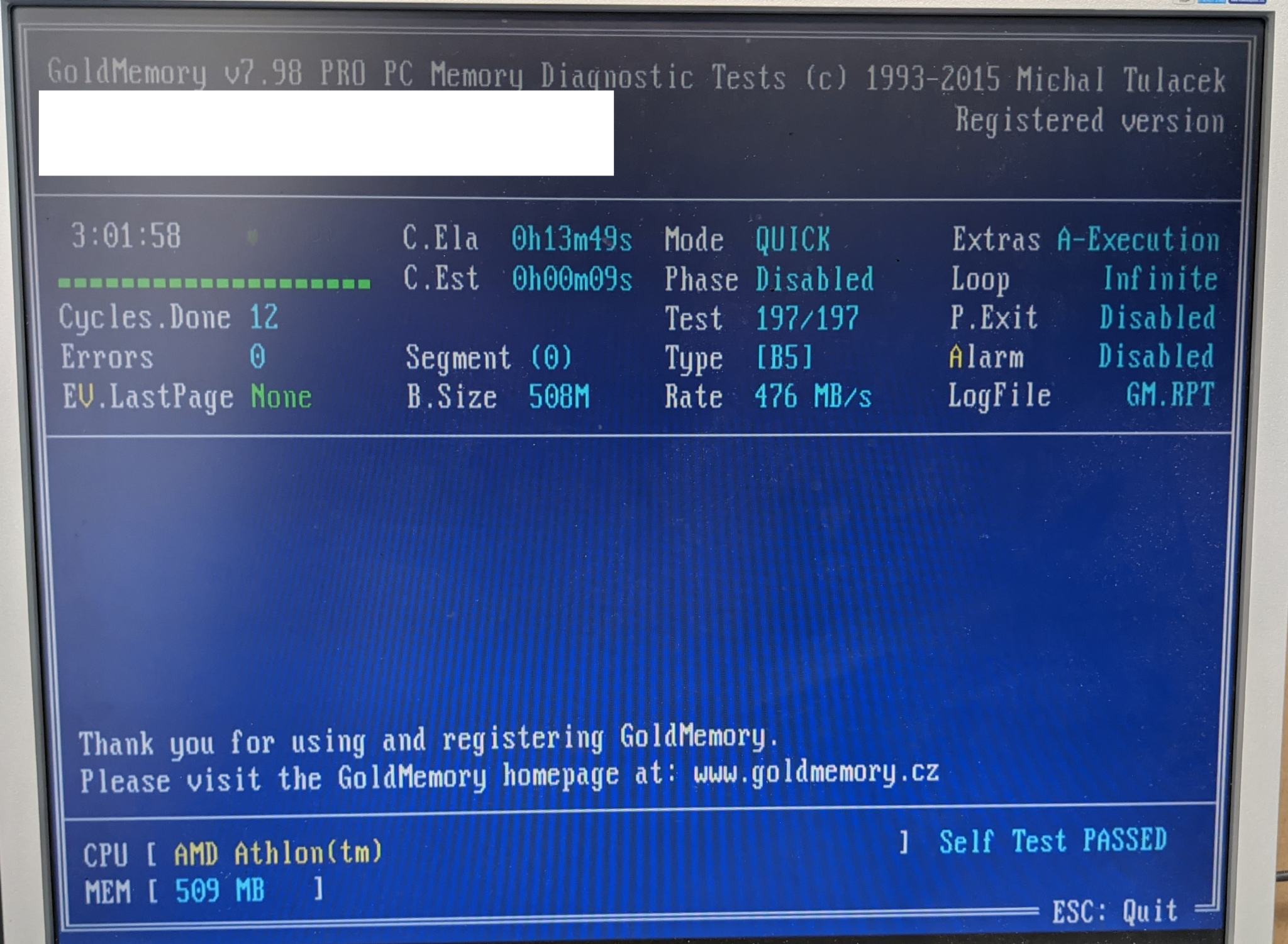

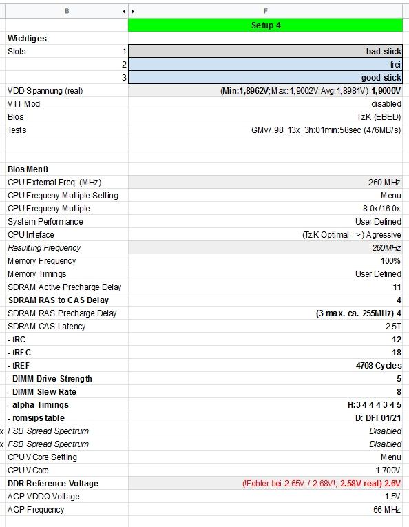

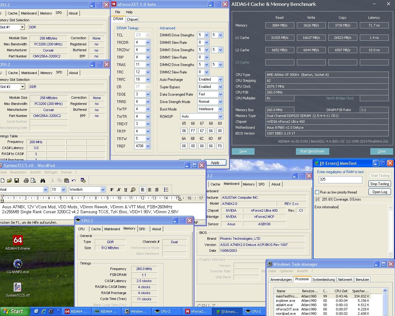

Das Maximum was ich stabil aus 2x256MB Samsung TCC5 auf dem A7N8X holen kann. Spannungen ab 2.65V produzieren irgendwann Fehler, daher habe meine kleinste Stufe von 2.58V benutzt. Deckt sich ja mit euren TCCD Erfahrungen. Für kleinere Spannungsabstufungen war es mir zu viel Fummelei.

@Atlan1980
auch hier ein super Ergebnis! Hast du mal versucht die Vtt Spannung zu verstellen? Nicht dass die TCCD/TCC5 einfach nur schlecht laufen weil die Vtt (leicht) zu niedrig ist? Auf dem ASRock laufen meine TCCD besser als auf dem ASUS. Das ASRock übervoltet leicht die Vtt Spannung; das ASUS untervoltet leicht...
Der VTT Mod hat hier in beide Richtungen nichts gebracht. Habe ich Dank Dir versucht. Die Fehler kommen ewig spät bei zu viel Spannung. Nicht umsonst hat das High End nF4 Ultra D so viele "Weak" Drive Strength Tweaks an Board. Hier können wir mit dem Asus nicht mehr viel holen.
