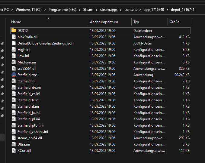

Update Rückgängig machen:
If you're on Steam like me and had auto-update enabled you can do the following to revert back to the previous version of Starfield where this mod still works while the author works on an update:
Windows Start > Run >
steam://open/console
to open the Steam console
Run the following command in the Steam Console to download the files for the previous version:
download_depot 1716740 1716741 4447793252473787578
When the download is done, it will tell you where the files are downloaded, for example:
Depot download complete : "D:\Games\Steam\steamapps\content\app_1716740\depot_1716741" (21 files, manifest 4447793252473787578)
Navigate to this folder, then copy all files to your Starfield install dir
<steam install folder>/steamapps/common/Starfield
In steam, disable auto update by going toLibrary > Starfield > Properties > Updates > Only update this game when I launch it
Now you should be able to run the older version of Starfield with this mod enabled again.
