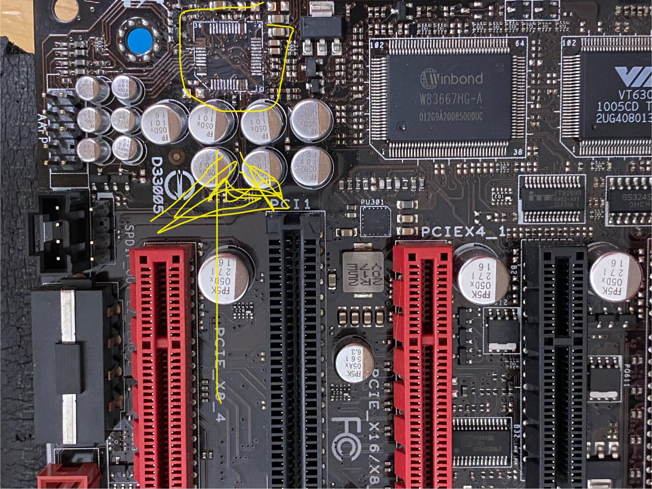

One tip for all who have a post issue on Rampage III Extreme.
I could not make a full post. Turns out my Realtek audio chip was defective and preventing the motherboard to make a full post. I could see all post details but it refused to go to BIOS or boot to Windows.
I tried flashing a BIOS with all devices off (which might help with defective SATA). This did not help.
De-soldering the Realtek audio chip did help. All back to normal.
I did not take the effort to de-solder it super nice, so some pins are gone. Not going to replace it anyway.
Thanks to HWBot tips.
Did you actually have to fully remove it? From memory I thought you only have to cut off a couple of pins.
Well that could work as well. At least I expect it to work. But since it was more work to look for which pins I needed to remove, I removed the chip completely. I removed it completely in 5 minutes.

Cutting the pins might be an option for others, who also don't care about the onboard audio and don't have the tools/skills to remove the codec in 5. If it ever comes up again, I might still have the info-graphic of which pins to cut somewhere.

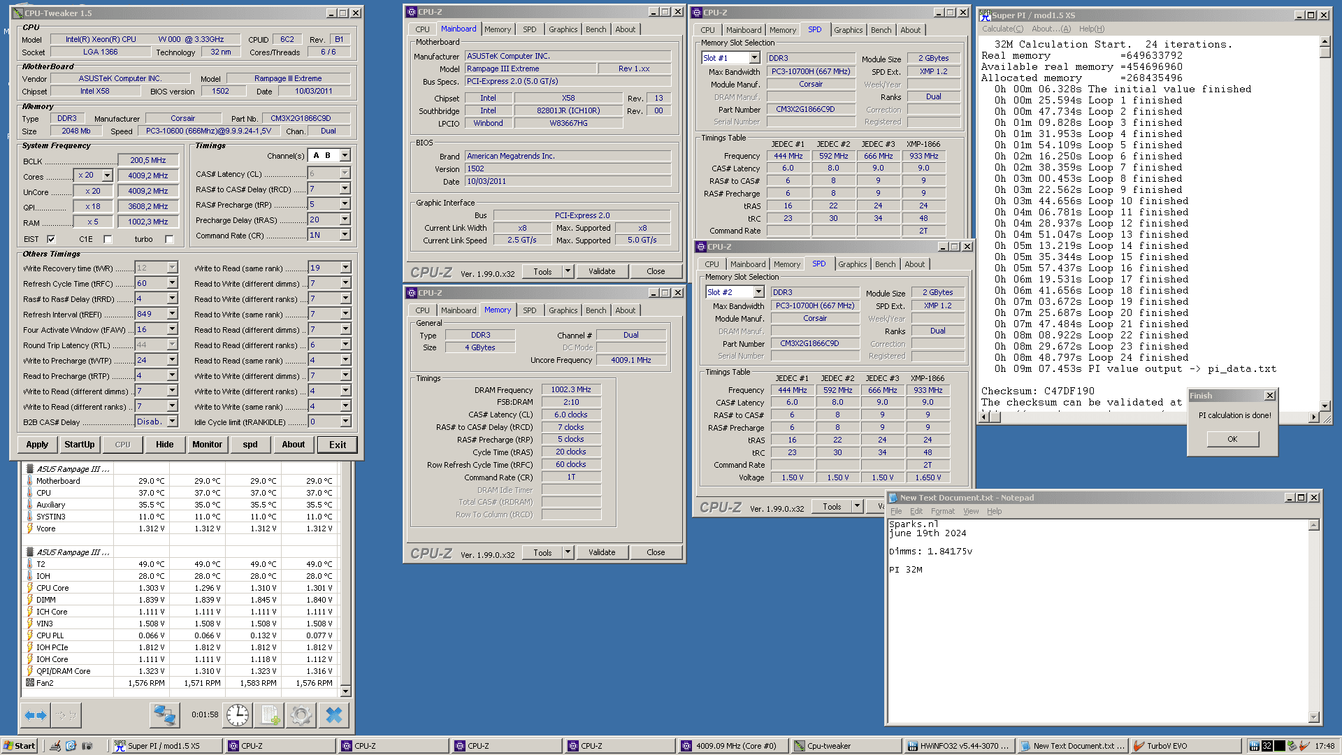

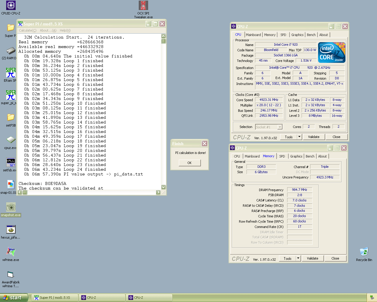

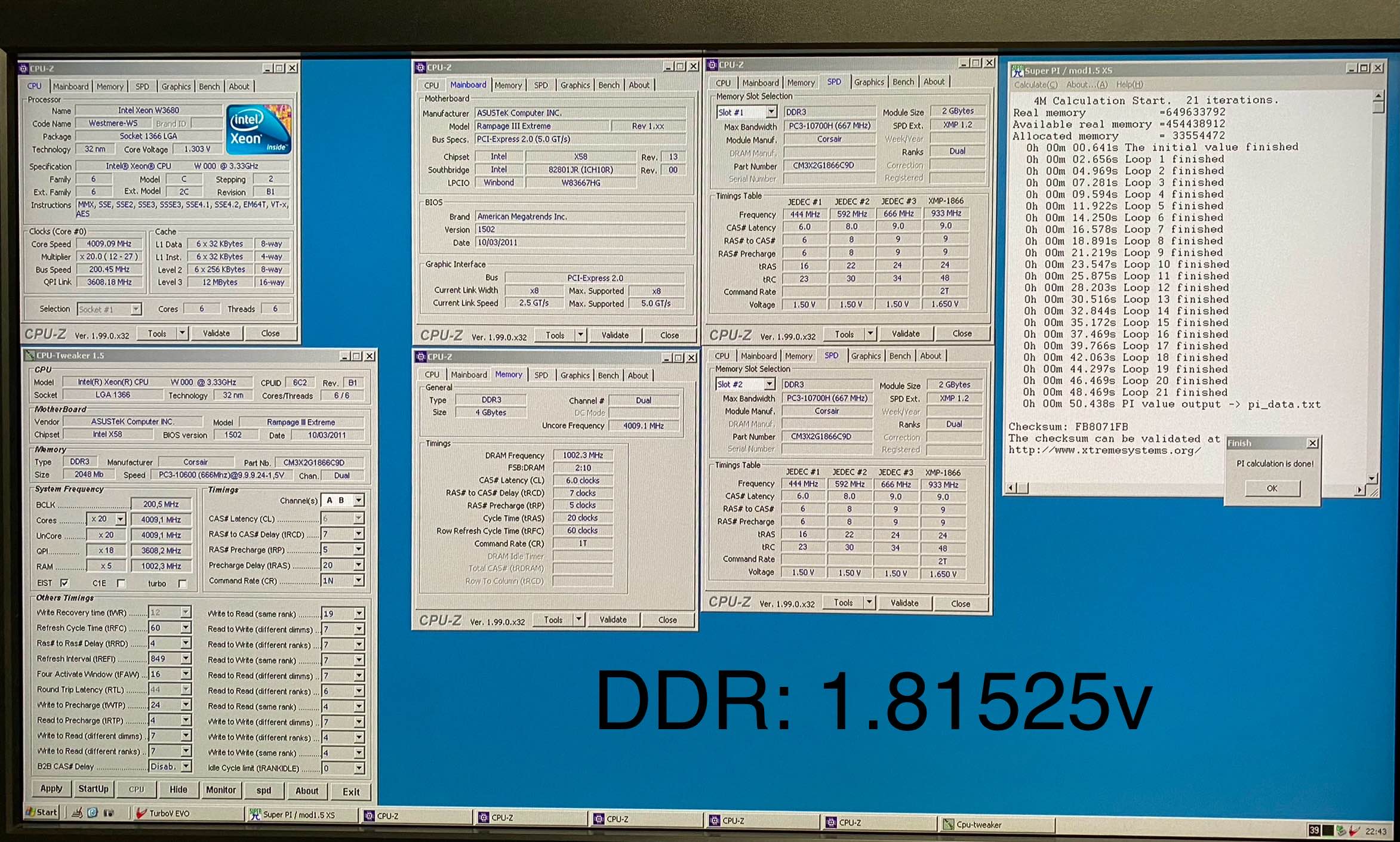

Testing my 2 potential best hypers with PI 4M in DC at 1.81525v and 2GHz C6-7-5 1T.
Out of all things, you found your best sticks in that bin? That is pretty impressive tbh^^
I have these for I while now. I know they run 2GHz C6-6-6 (<2.00v) as well. All my other dimms could not run it. So I started with these. Not expecting others to keep up.
Yes I bought them for €50 some years ago. After much doubt I boubt them. Was a succes so far.
I would be inrested in the schematics if quickly found. Who knows if I ever have the same on another board.

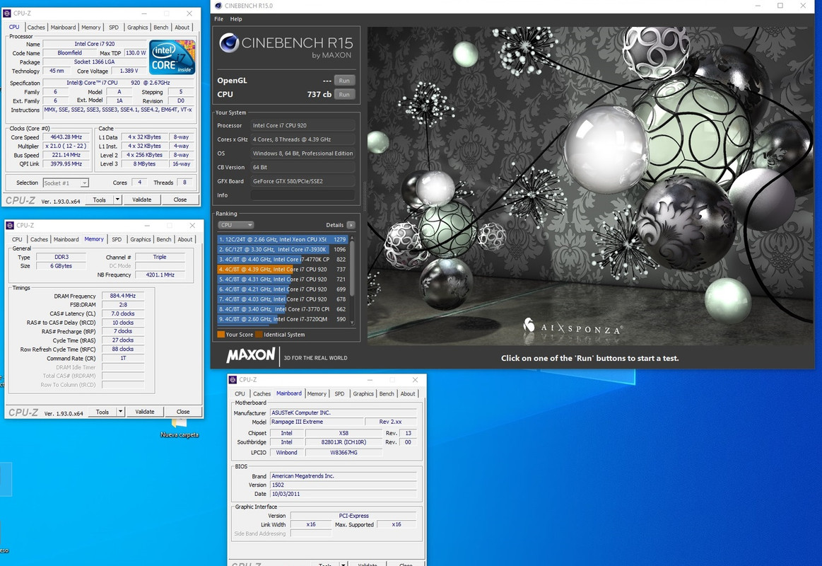

Are you using the onboard buttons on X58A-OC? I had the same thing happen, but it was just a display error. This said x19, but the actual clock was x21
It depends on how often you up your BCLK compared to your boot clock, not just a BCLK value in itself.
Here it changed to displaying x20 because I booted a lot higher, still x21 real multi:

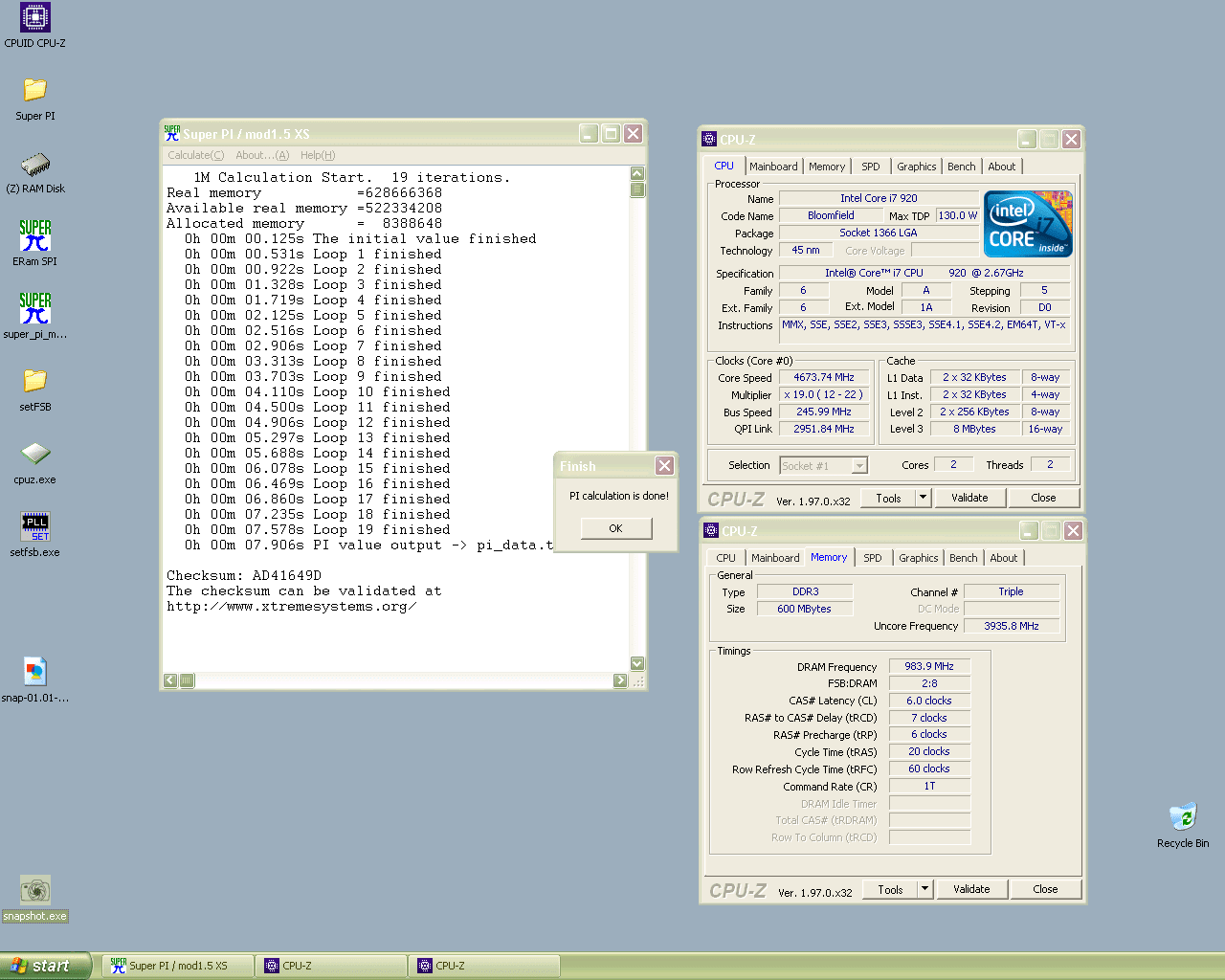

On all my x58 boards, for two years now, the multiplier has been reduced every 5 mhz BCLKAll power or thermal protection options are disabled.I don't make sense of itOn my motherboards the BCLK limit is 221-223, I have not tried increasing the frequency of the PCi-E 110-120mhz, that in theory allows me to reach 230-255 BCLK, how do you do it to reach 245 BCLK? Thx
221
That's exactly how, higher PCIe clock to drastically increase max BCLK :) I also ran this with a PCI GPU, but that was probably not necessary. Those scores I posted were on dry ice though, I'm not sure how much BCLK this CPU likes on ambient.

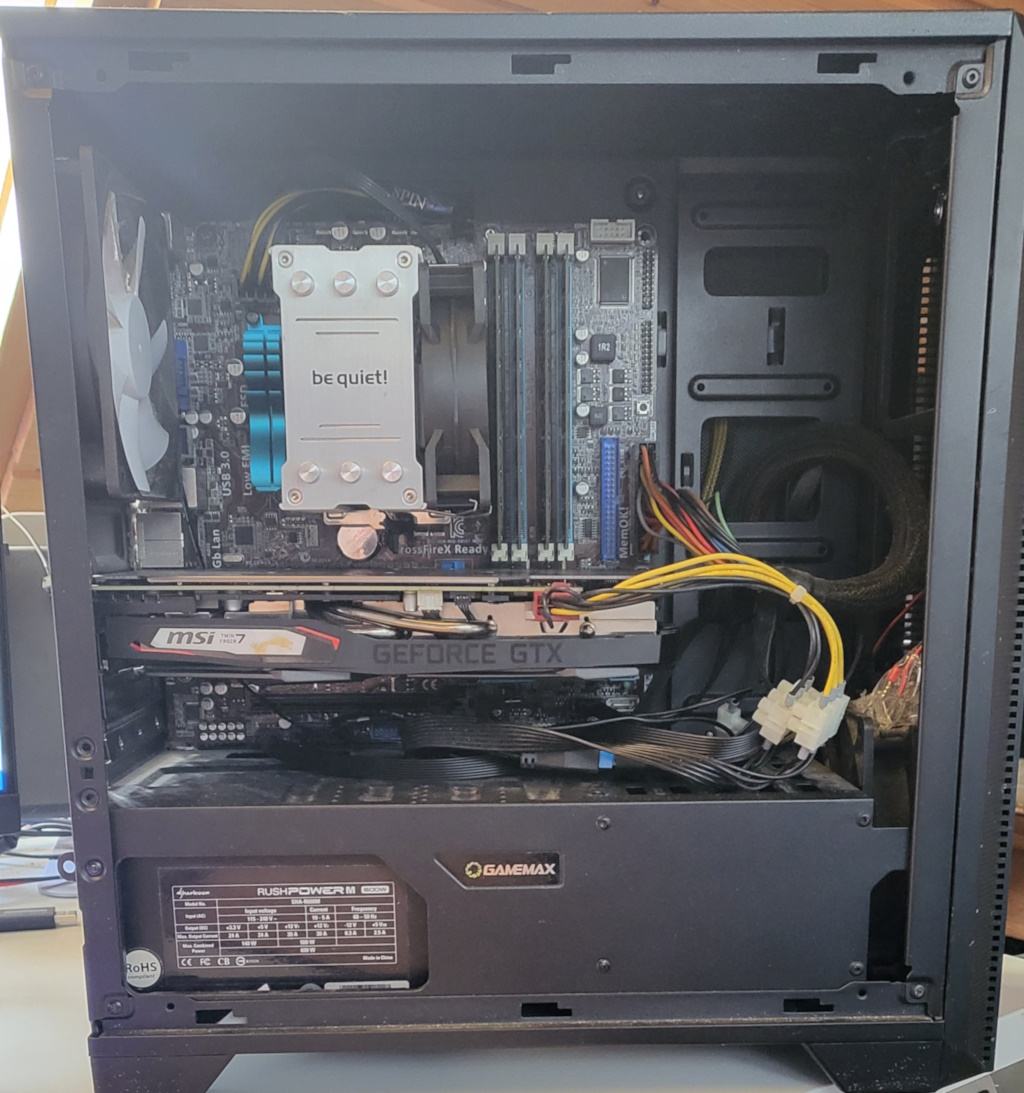

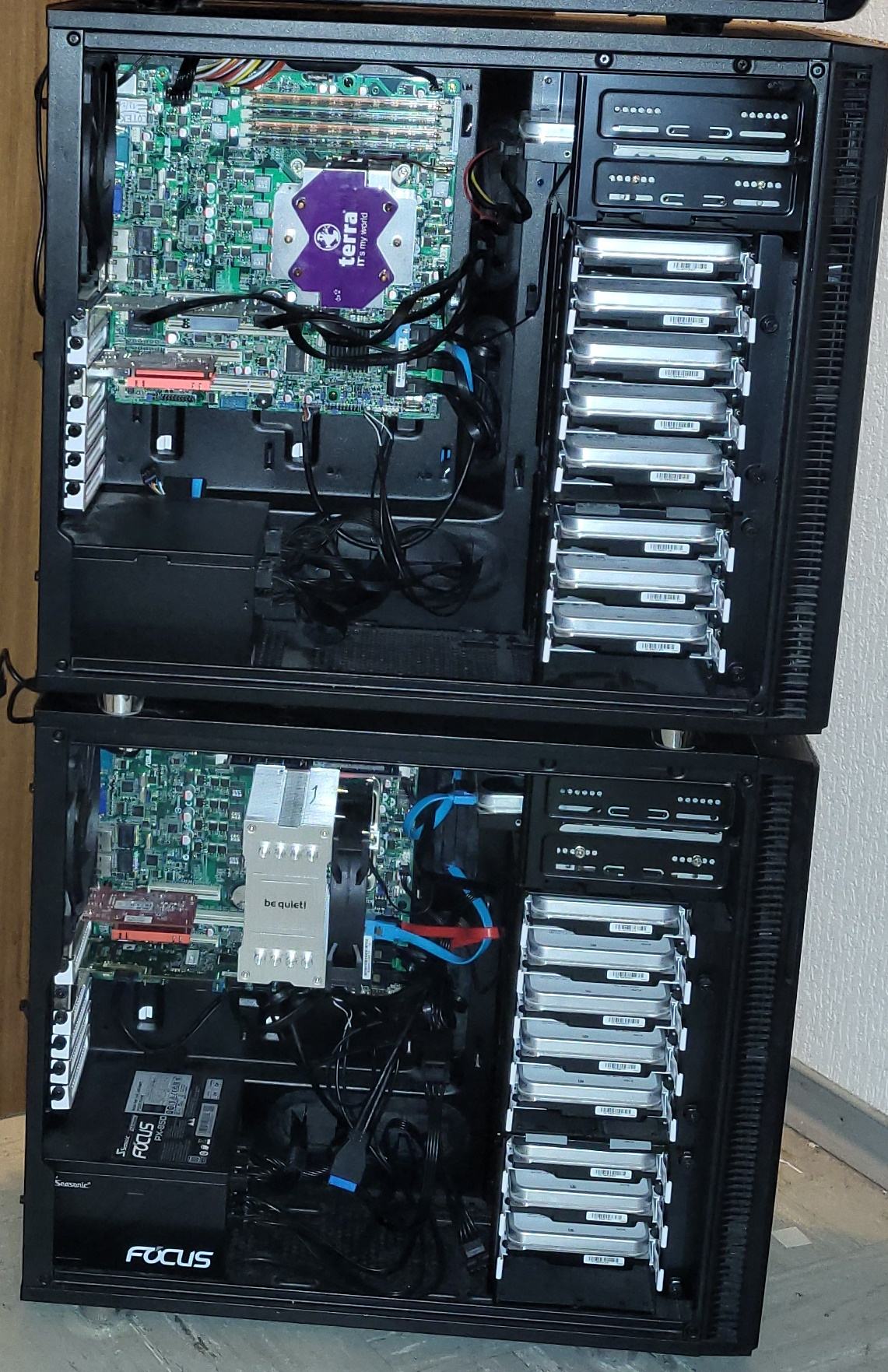

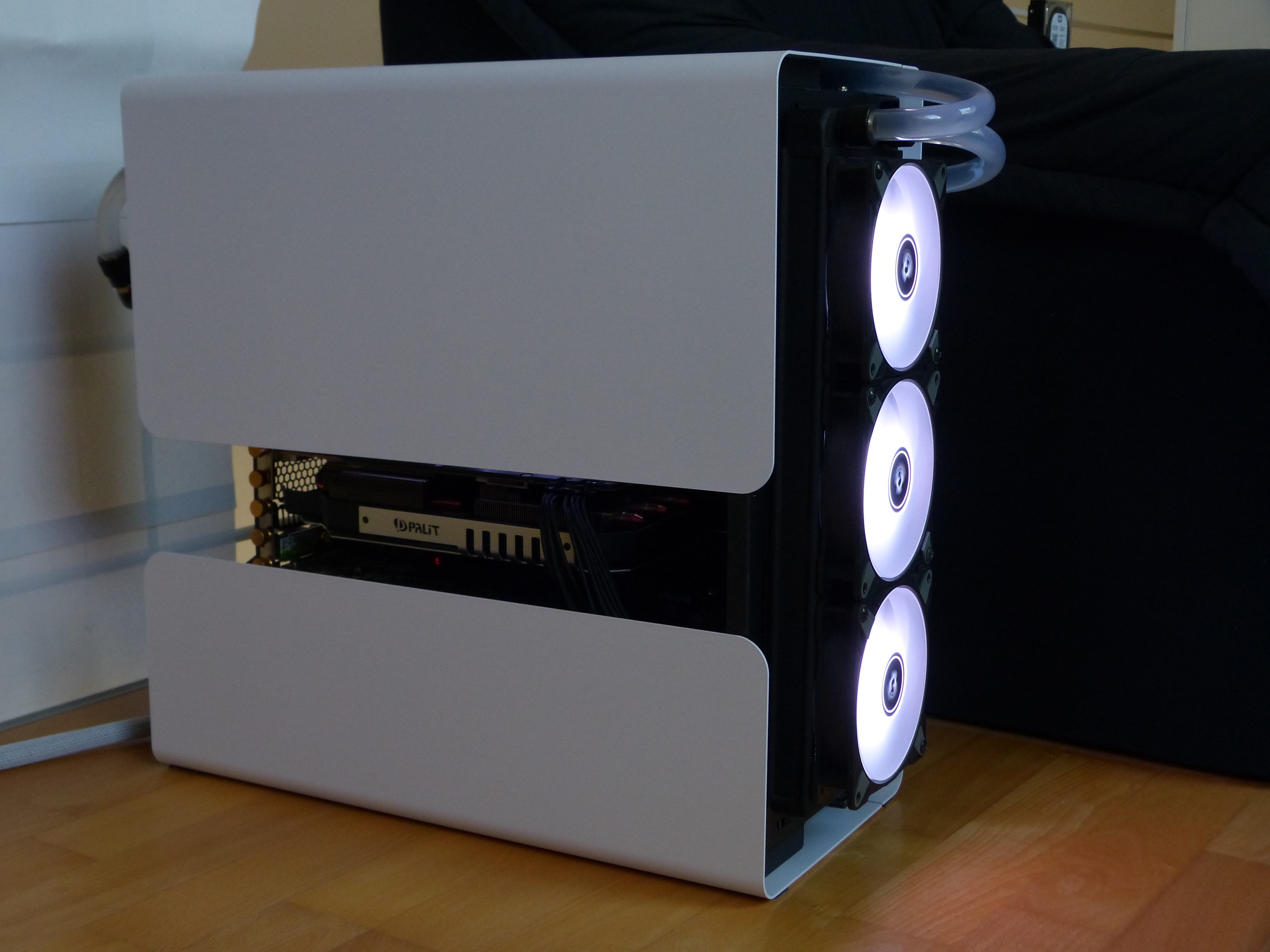

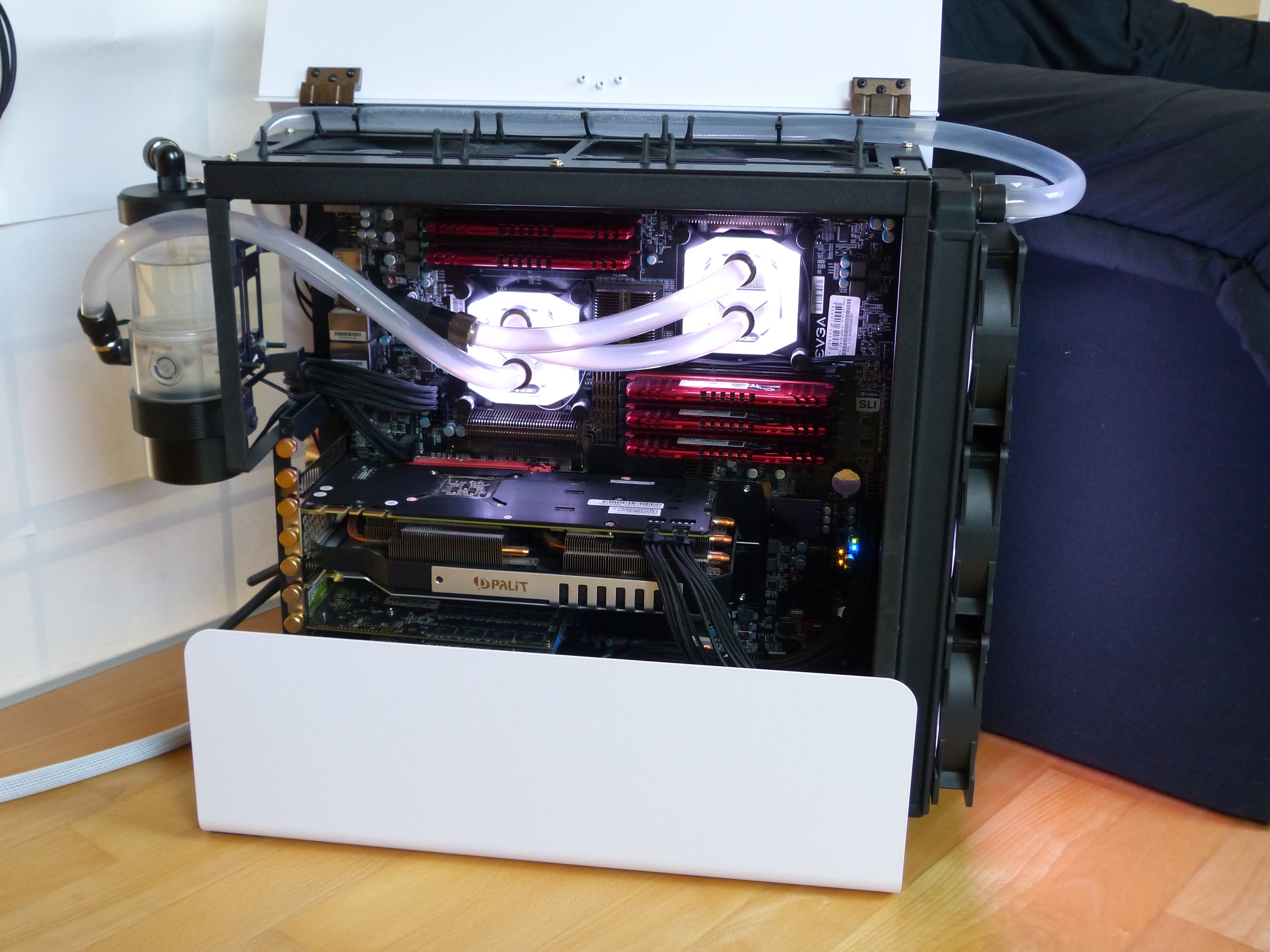

Hmmm bei mir sind die 2x 1155 noch voll im Tageseinsatz als Sever - uind 1x 1151 der ist ja aber schon recht modern mit DDR4 - das sind für mich tatsächlich kein "altes" Blech sondern einfach zuverlässige und auch vergleichsweiose sparsame CPU Gen - es gibt recht problemlos ECC Ram und glaub selbst die V2 Xeons haben schon PCIE-3.0 (oder 2.0) ? :d
inzige was mit bei den 1155 Boards fehlt ist USB 3.0 aber das liegt halt an den "Workstation" bzw "arme Leute Server-Boards" :d bei Constumer 1155 gab es das schon, hab auch noch einen 1155 als Desktop Variante der steht aber aktuell im Regal.
Inzwischen hat auch der "obere" ein Platinum (oder Titanium?) Seasonic (vor allem wegen der Einschaltstrombegrenzung) und beim Umrüsten auf Kryosheet statt Paste auch einen neuen Lüfter bekommen, 1155 kompatible Lüfter gibt es ja problemlos neu.
Ich habe zumindest nicht vor die 1155 oder 1151 zu ersetzen, finde im Serverbereich oder allgemein "non gaming" als "normal Use" war das so spätestens die CPU Generation die eigentlich schon so gut ist dass man auch heute noch nur aus Langweile oderSpass am Basteln upgraded. Bei Gaming und "Spezialanwendungen" klar da lohnen sich neue CPUs auf jeden Fall.
Hehe das zweite ist mein 1155 XeonV2 (1270V2) als naja so halb Retro mit GTX 1650 Super, einem Sharkoon Netzteil mit Lüsterklemmen :d , 32 Gb RAM und glaub 2 TB SSD.
Board mit EIDE, SATA und USB 3.0 und auch optischem Audio Ausgang richtig hochwertigen Kondensatoren glaub - echt verrückt was es da alles gab. Ist halt wie ein Mercedes W123 :d Den hatte ich mal meienr Schwester vor ein paar Jahren geschenkt und der war bis Februar 2024 bei ihr im Einsatz - bis sie jetzt meinen alten 5900x mit RTX 2060 (12 GB) bekommen hat.

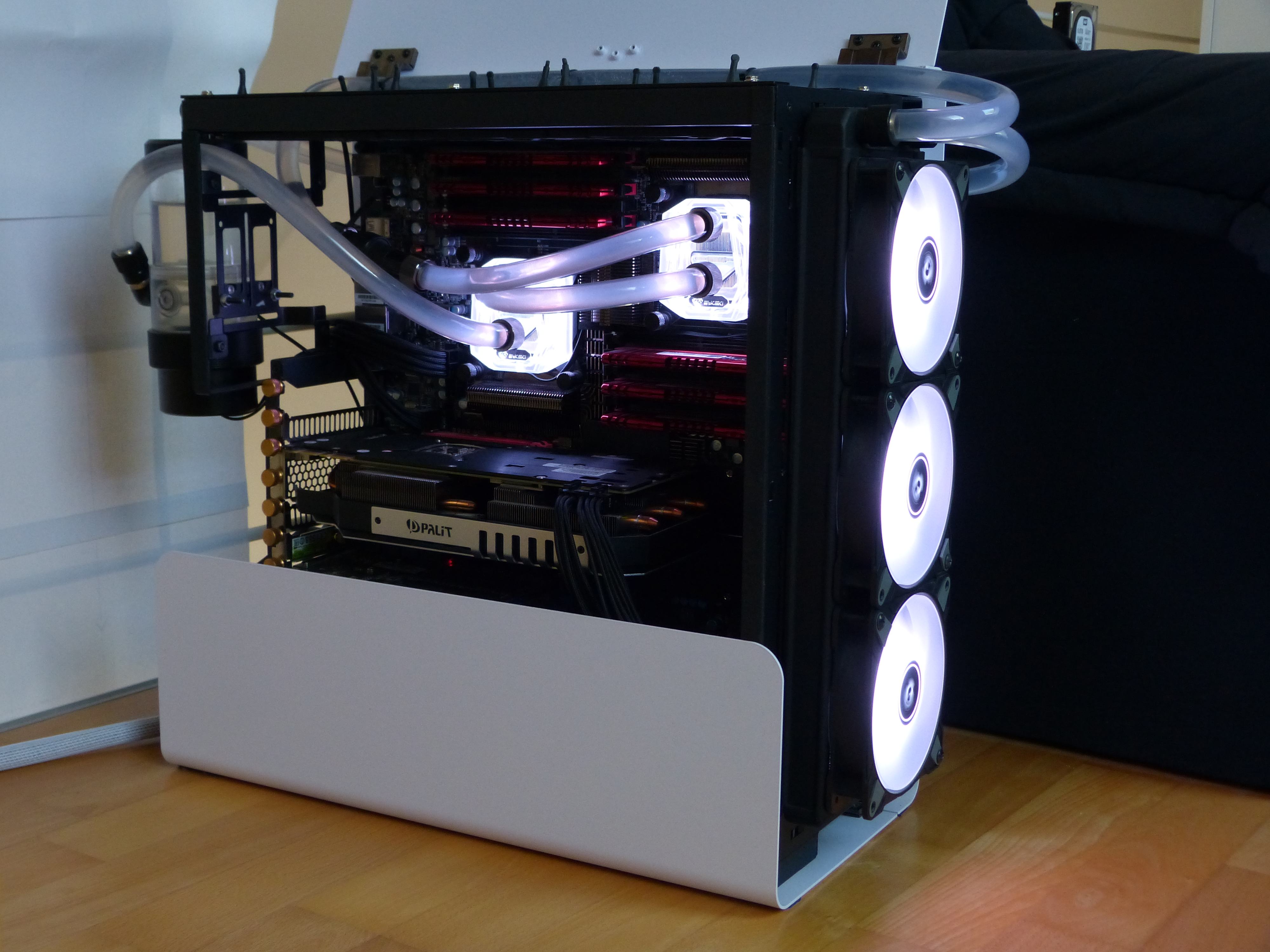

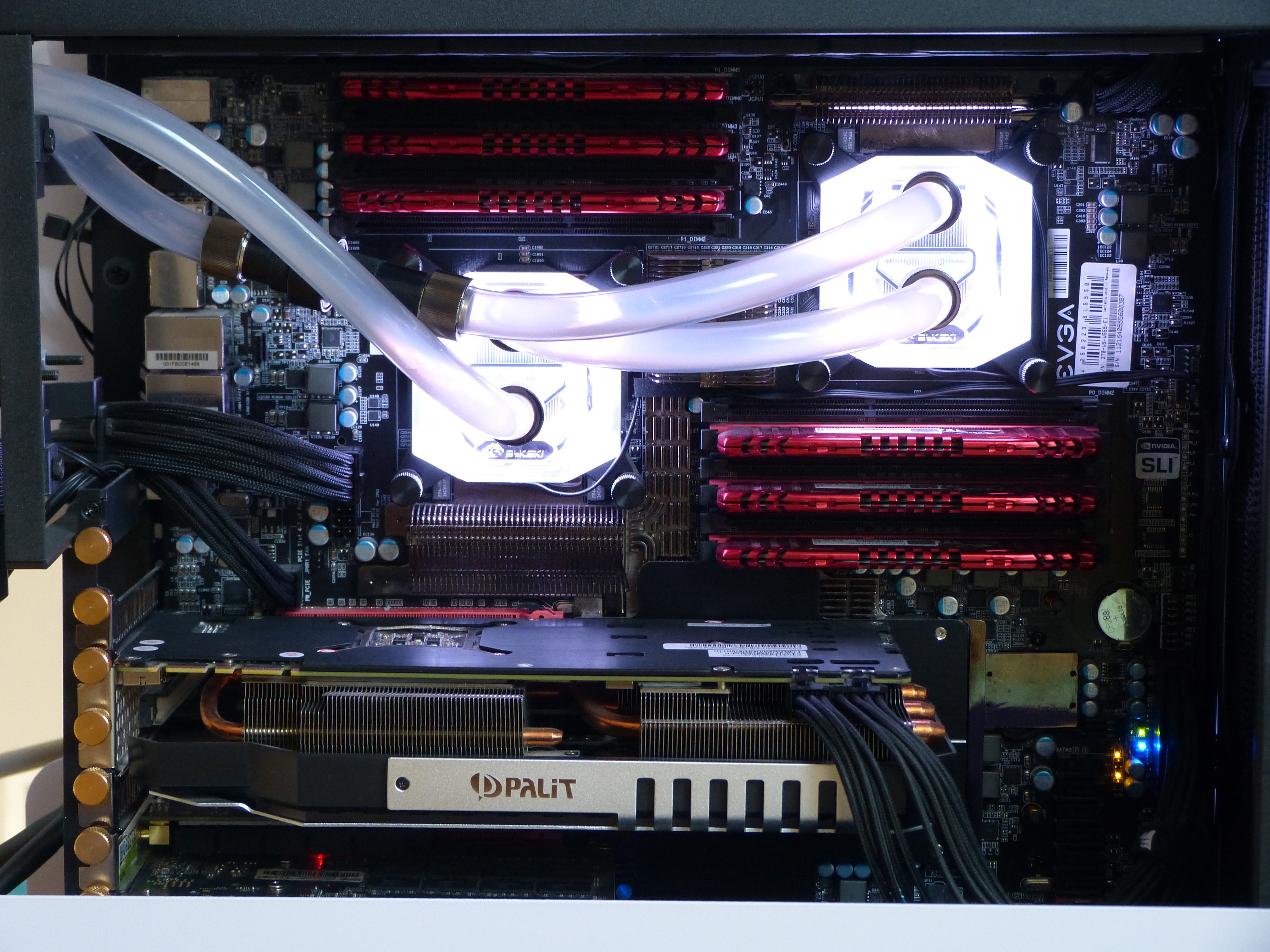

EVGA SR-2​

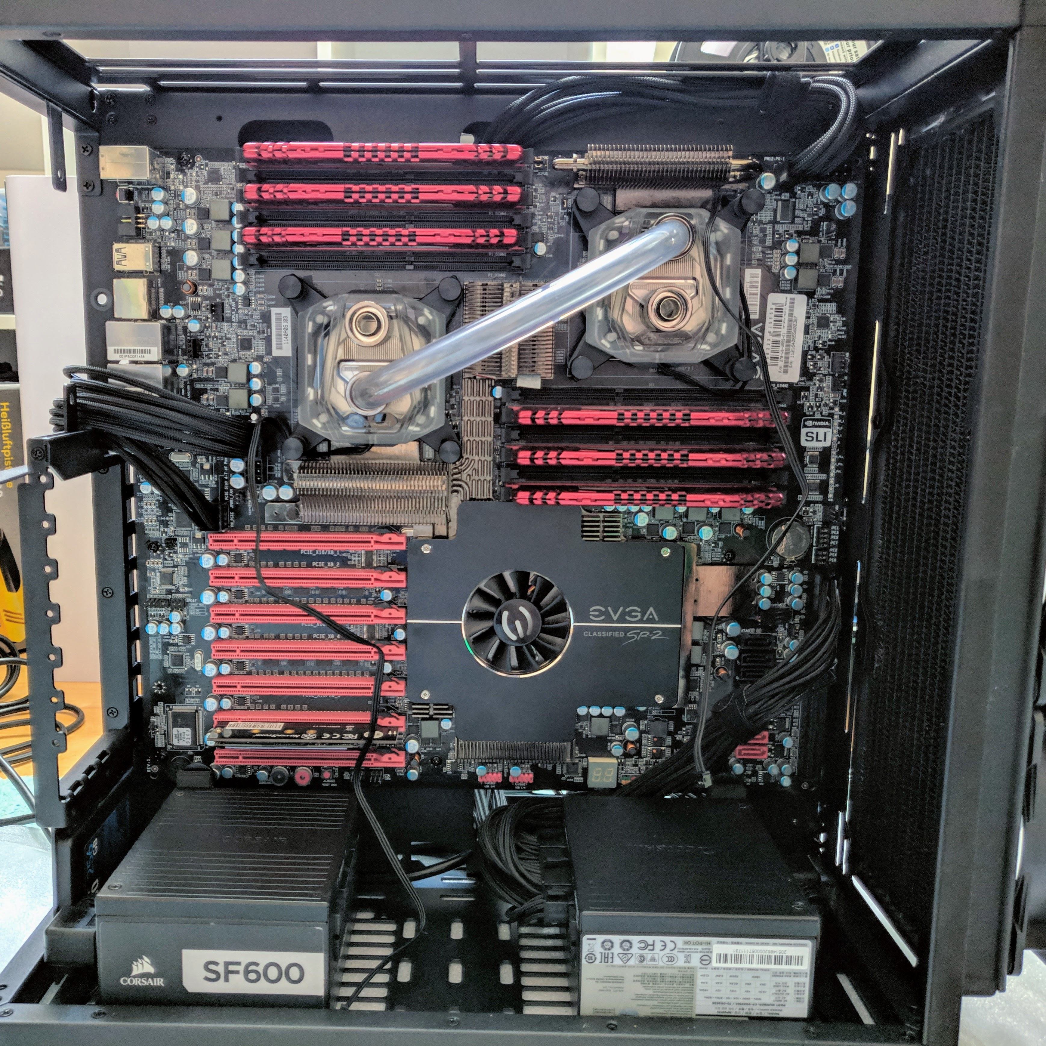

SR-2, da hab ich auch noch eins zur Schau gestellt:

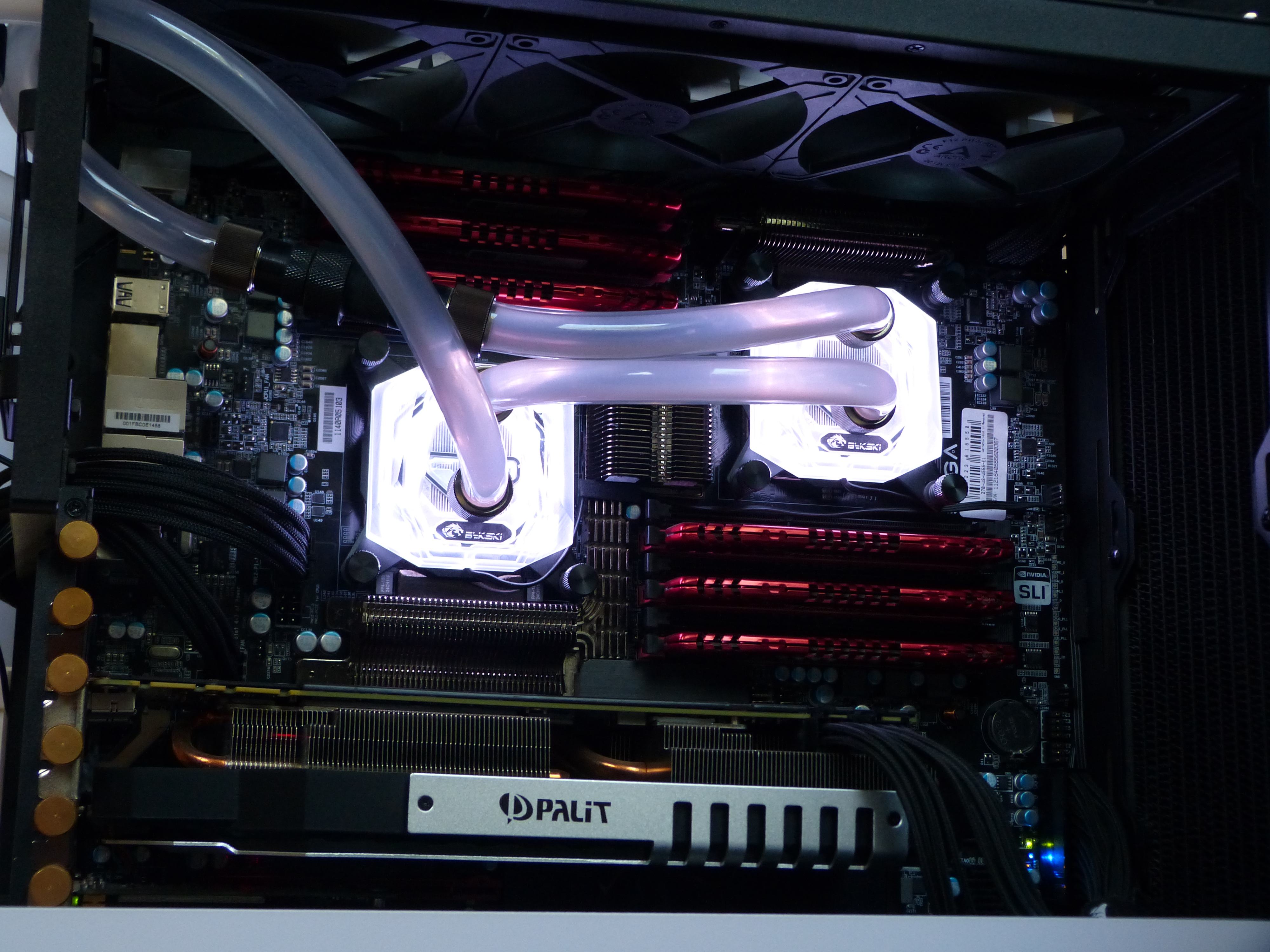

All housed in a modified Azza Cast 808:
Running 2x X5680 with a total of 48GB Ripjaws Z DDR3. Cooled by a 360 custom loop.
I've run them at 4.5GHz for a short while: https://valid.x86.fr/f6y09z
But temps weren't all that great. I probably should have repasted the chipset heatsink before putting it all together...
Daily settings are more moderate 4.3GHz: https://valid.x86.fr/6a3hjn

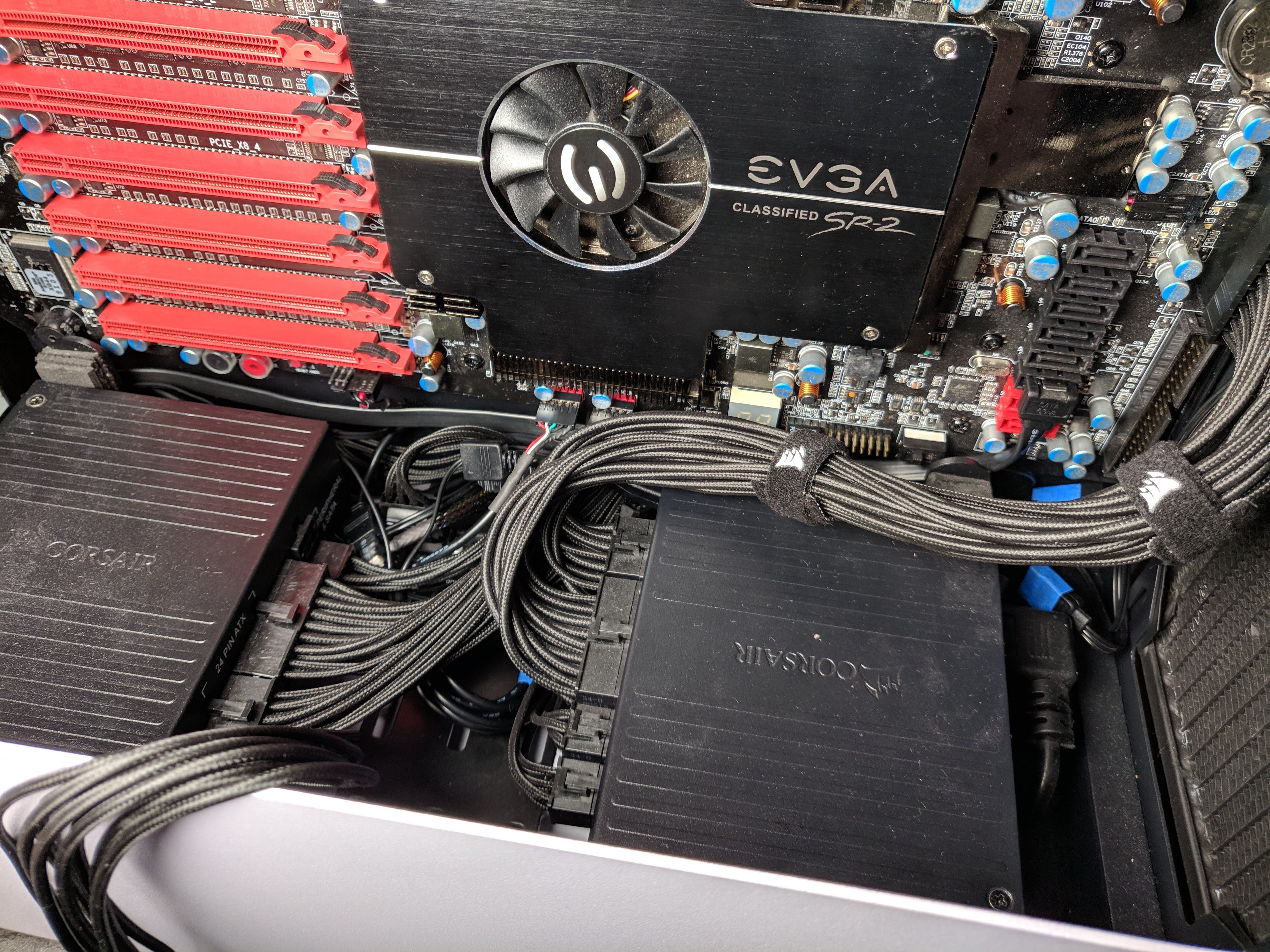

Powered by dual PSUs, a combo of SF750+SF600, linked together with a hopefully not sketchy Add2PSU. Power cables to board, slots, cards etc carefully split between the two PSUs to hopefully not overload either.

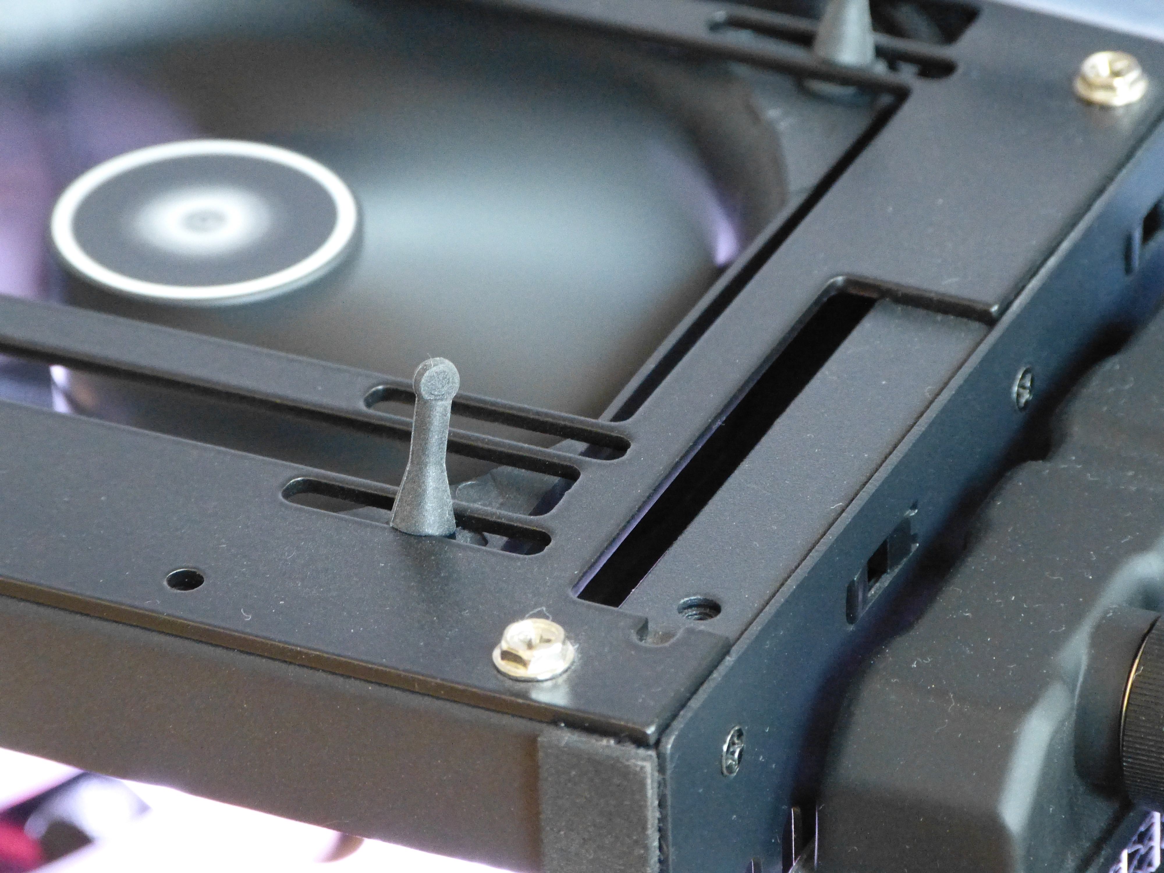

The case officially only fits up to ATX, but has just enough actual space inside the frame for HPTX. To mount the SFX PSUs and some top fans, I've had custom top and bottom mounting plates laser cut and powdercoated to squeeze around the original frame and mounting points. Also a small stabilizer plate underneath the PCI frame to prevent some sag/wobble and allow mounting a 2.5" drive.

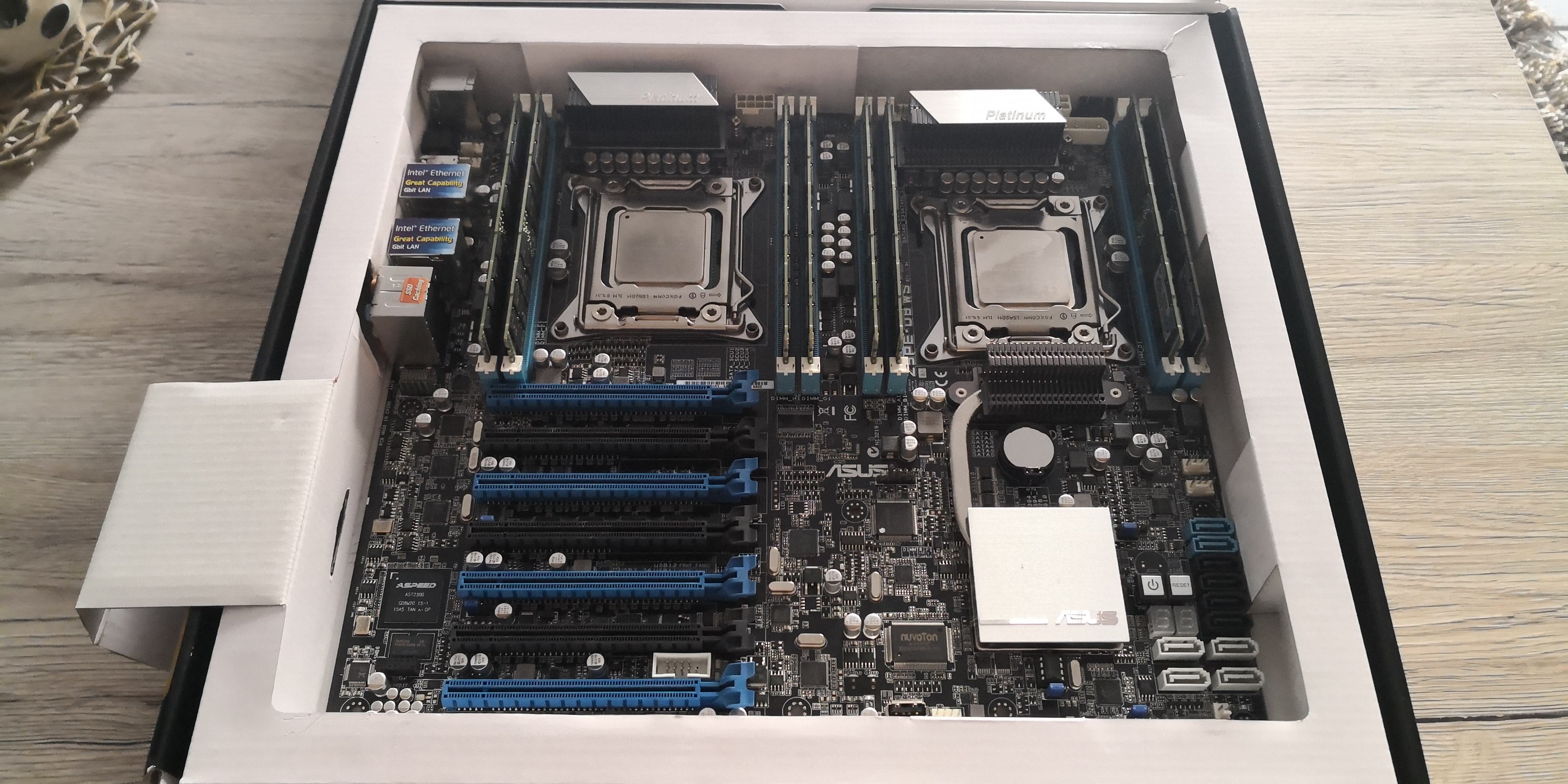

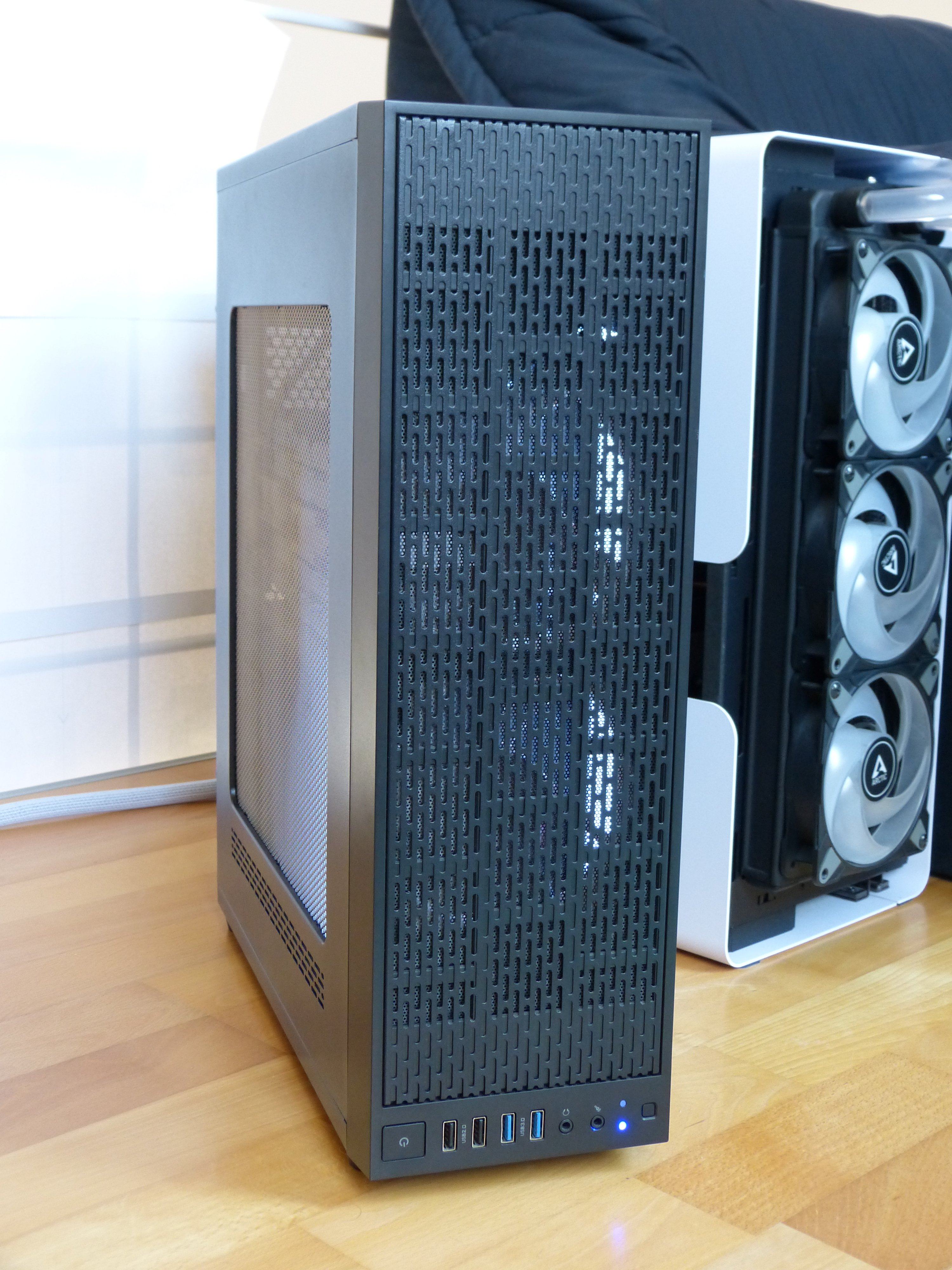

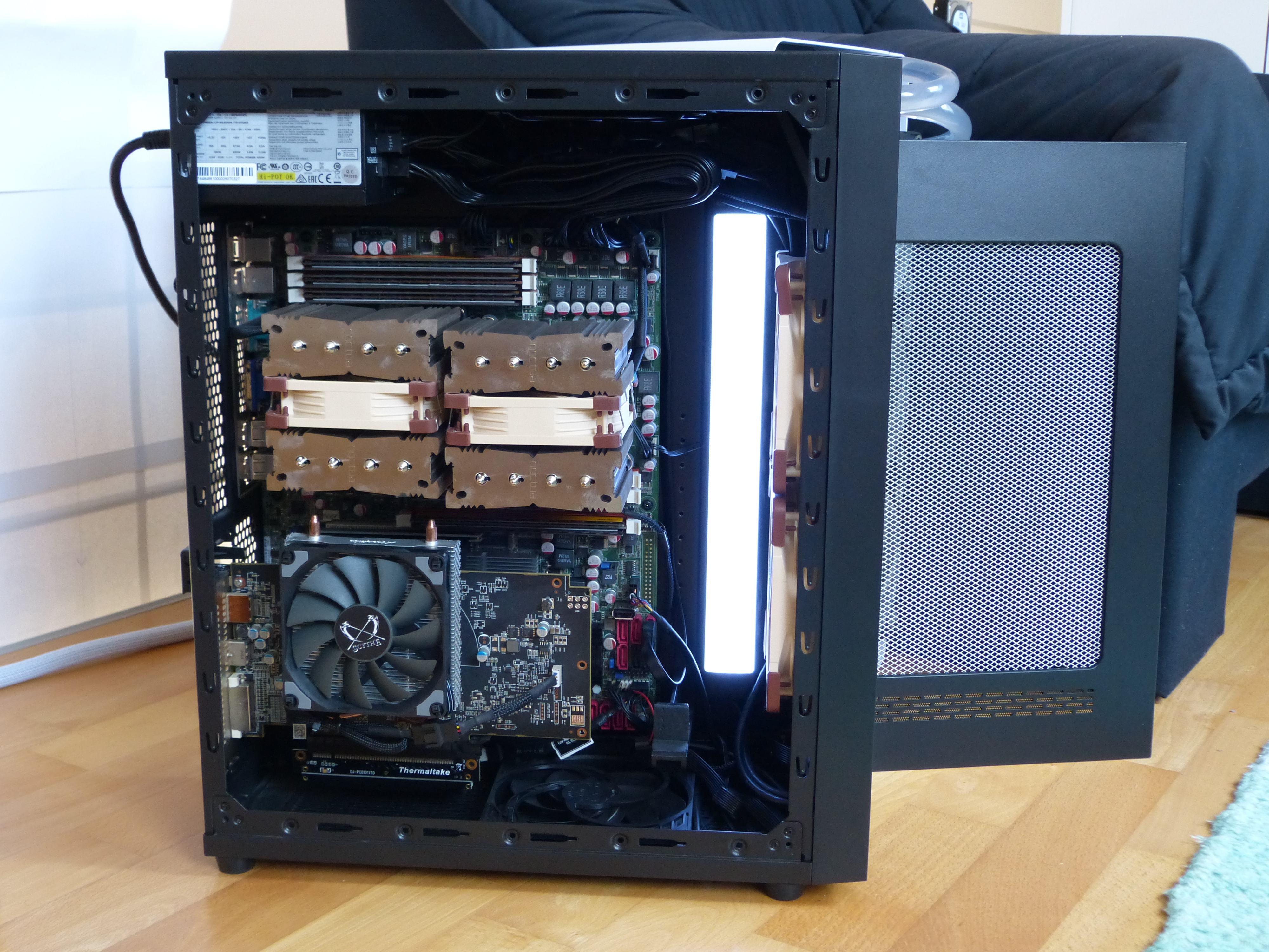

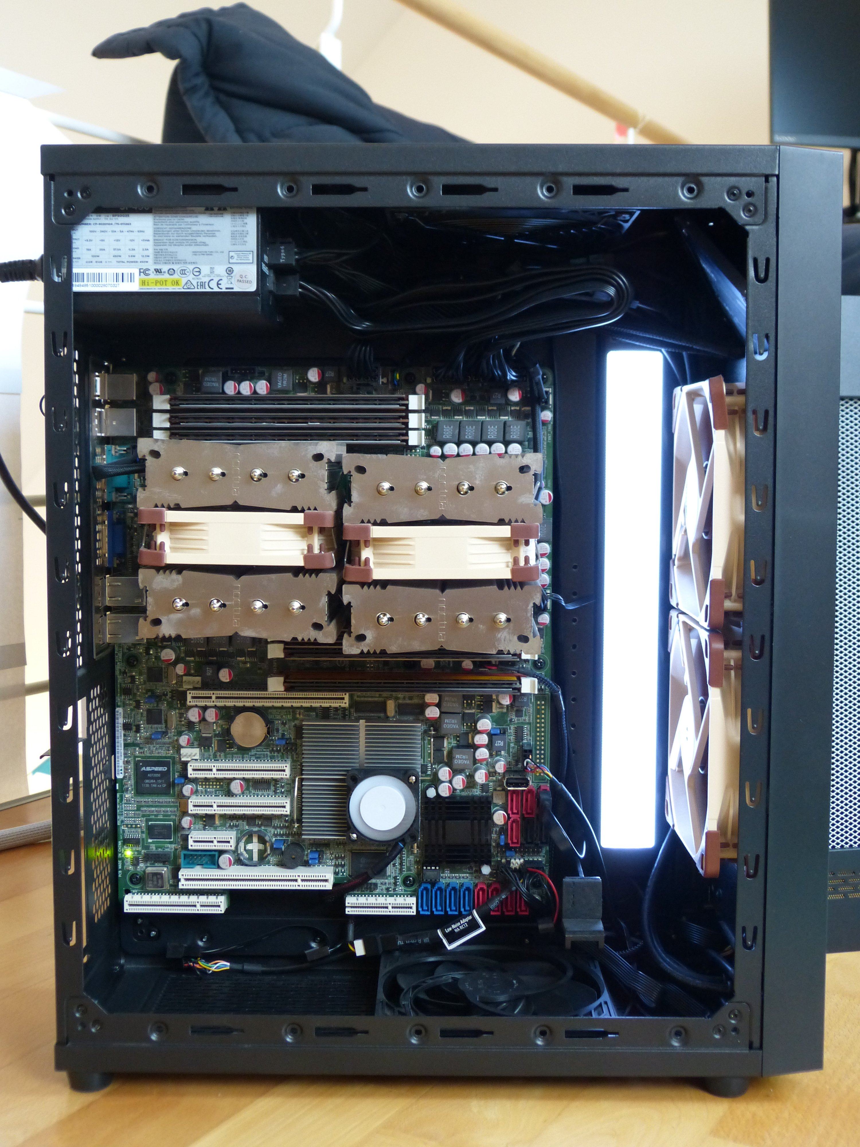

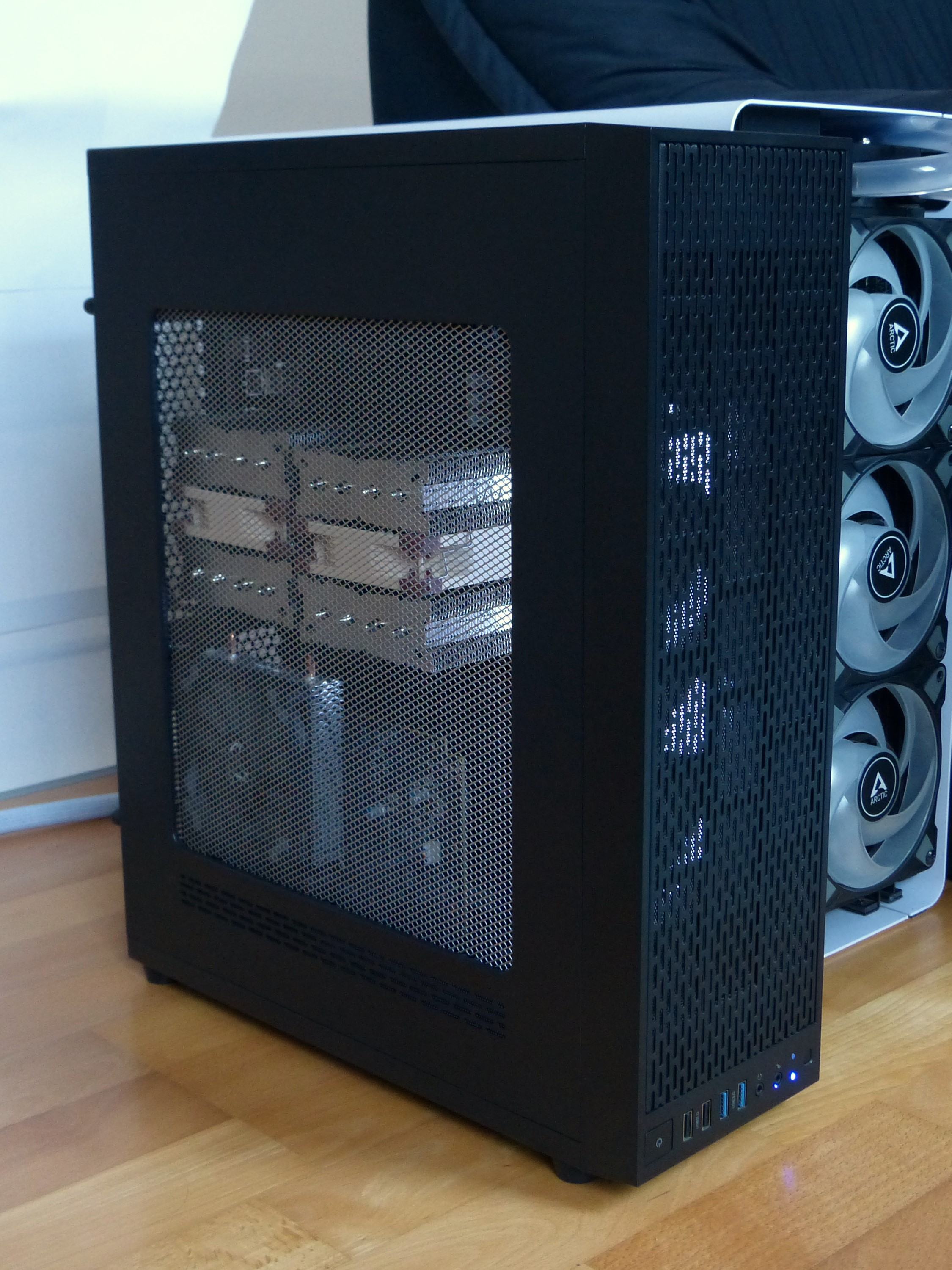

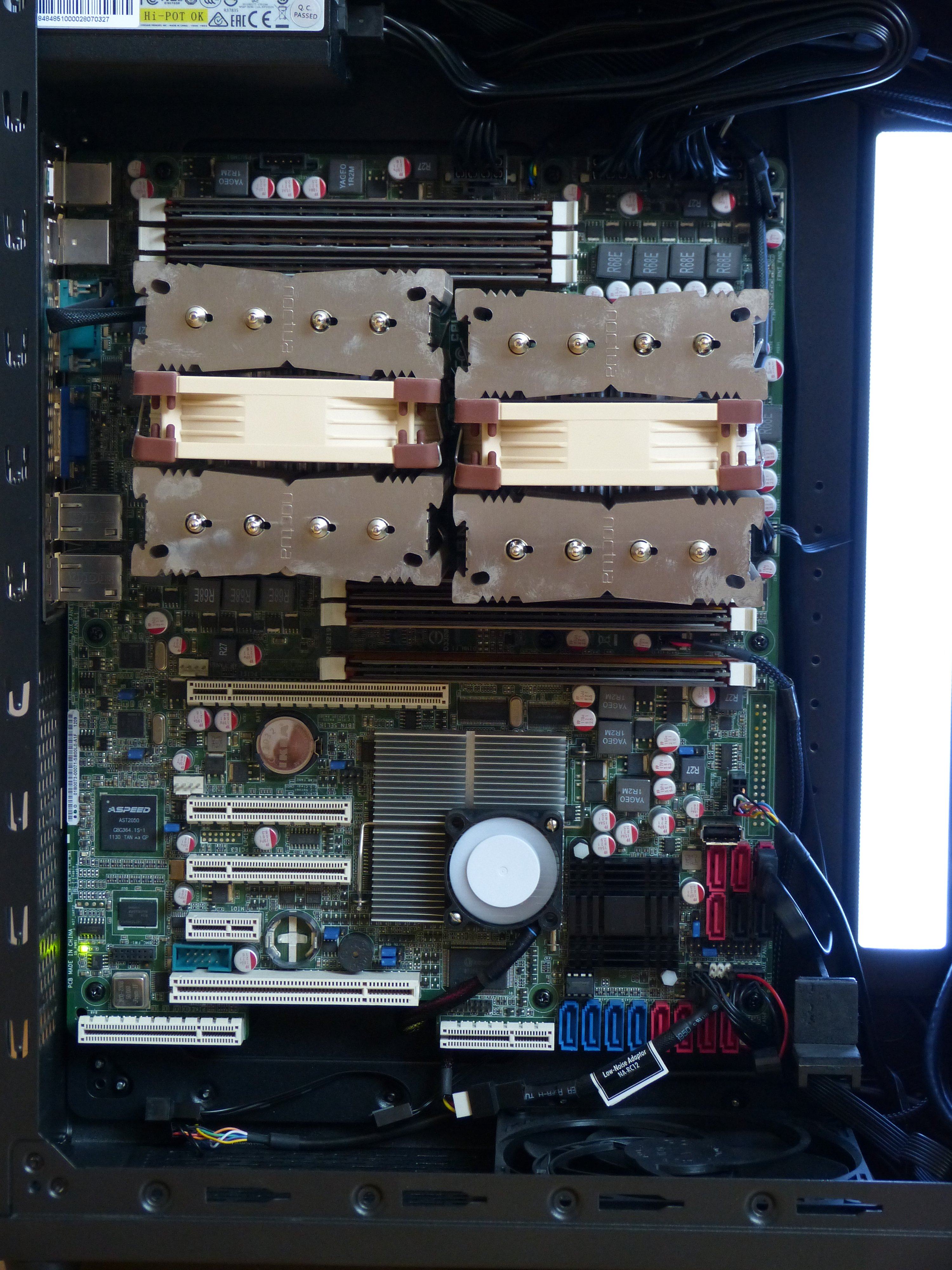

Asus Z8NA-D6​

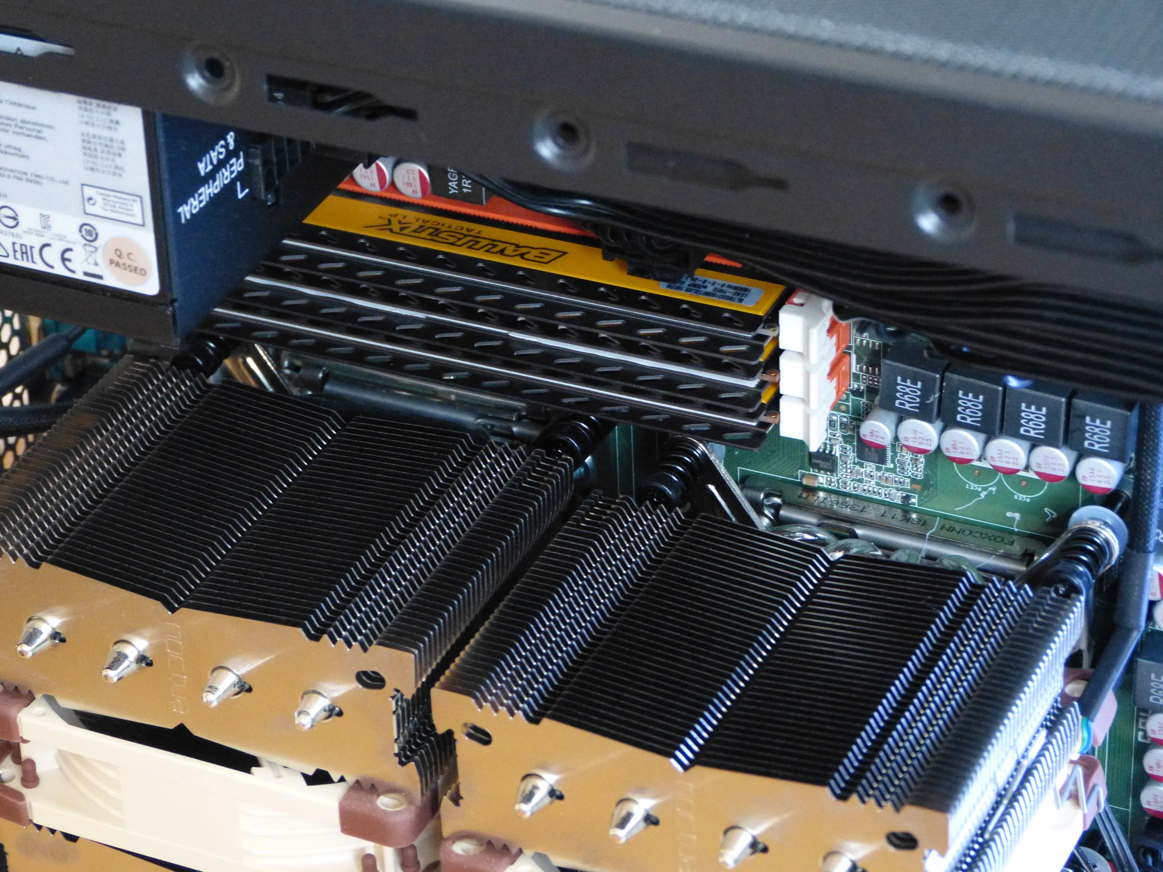

Und dann nochmal dual socket 1366, aber etwas vernünftiger:
Alles in einem TT Core G3, schön kompaktes ATX. Auch das modifiziert, nämlich das Plexifenster gegen Streckmetall "Mesh" ersetzt (davor hat die GPU gekocht...).
Hardware ist ein Asus Z8NA-D6 mit 2x X5675 und 48GB Ballistix Tactical LP. Darauf zwei Noctua NH-D9L. Versorgt von einem SF450.
Aktuell steckt dazu eine RX 560 mit Alpenföhn Klara drin. Da überlege ich, welche nette GPU stattdessen passen könnte, ohne die vermutlich übrigen ~150-200W Netzteilleistung zu überschreiten. Vielleicht aus Spaß mal irgendwas aus der Workstation Sparte...

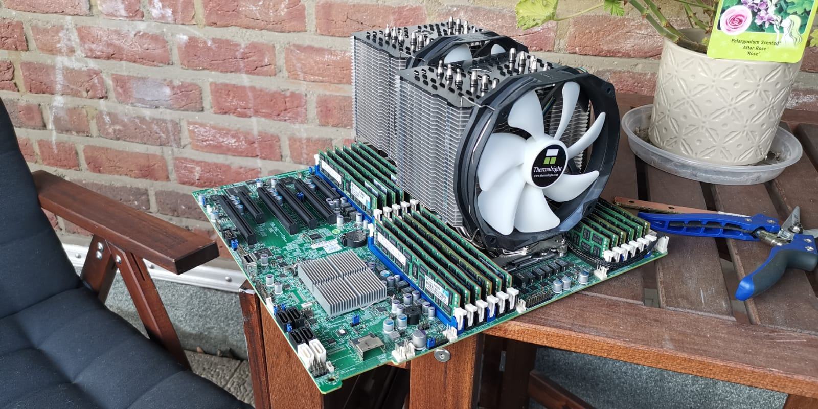

Hier haben wir 192GB DDR3:
Und hier 512GB DDR4 und 2x E5-2699V3:

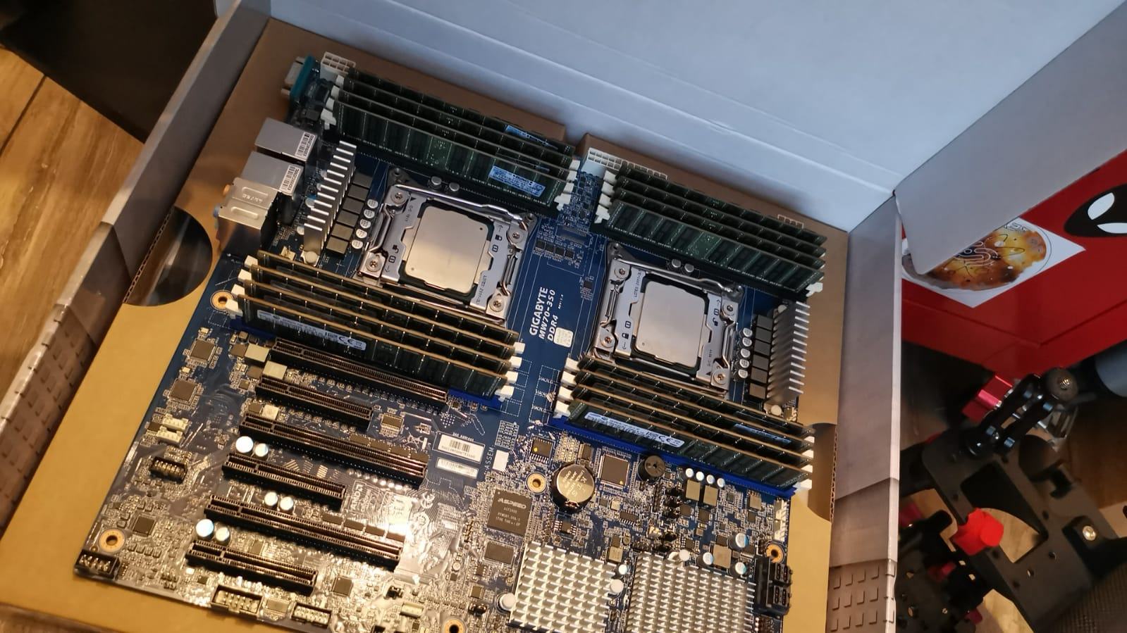

Und hier eines der Boards, das ich nie hätte abgeben sollen. Davon hatte ich auch zwei:

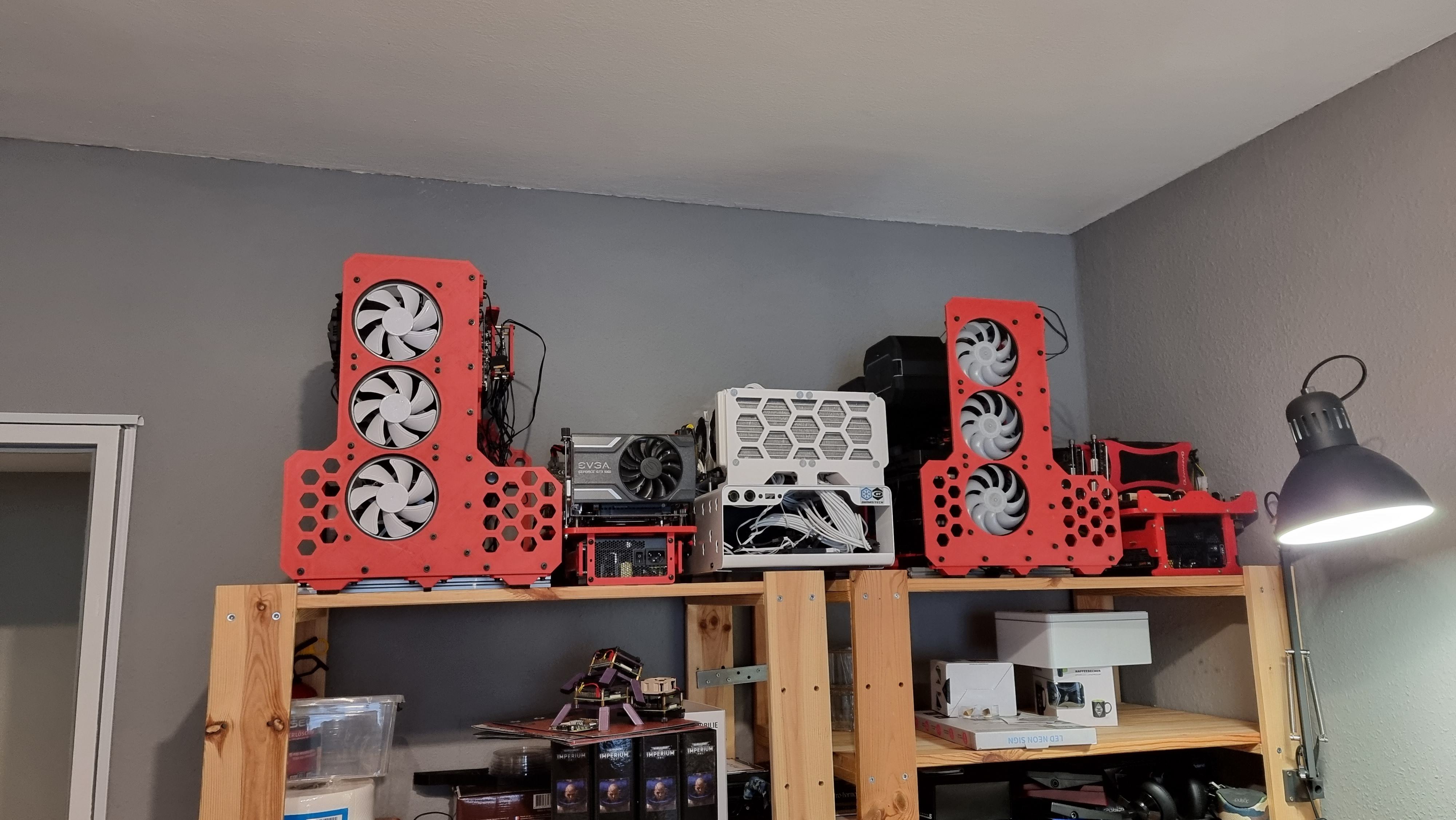

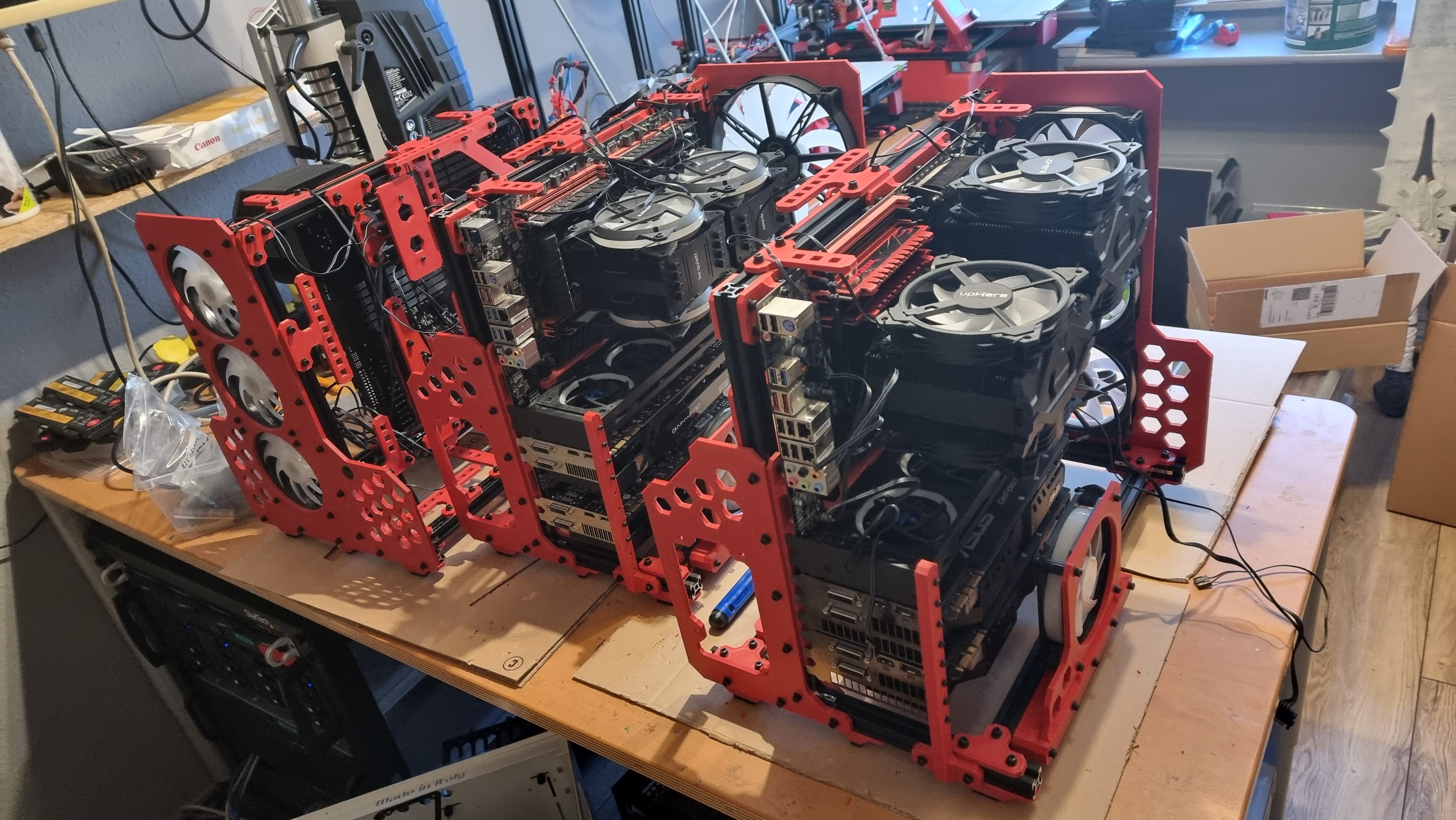

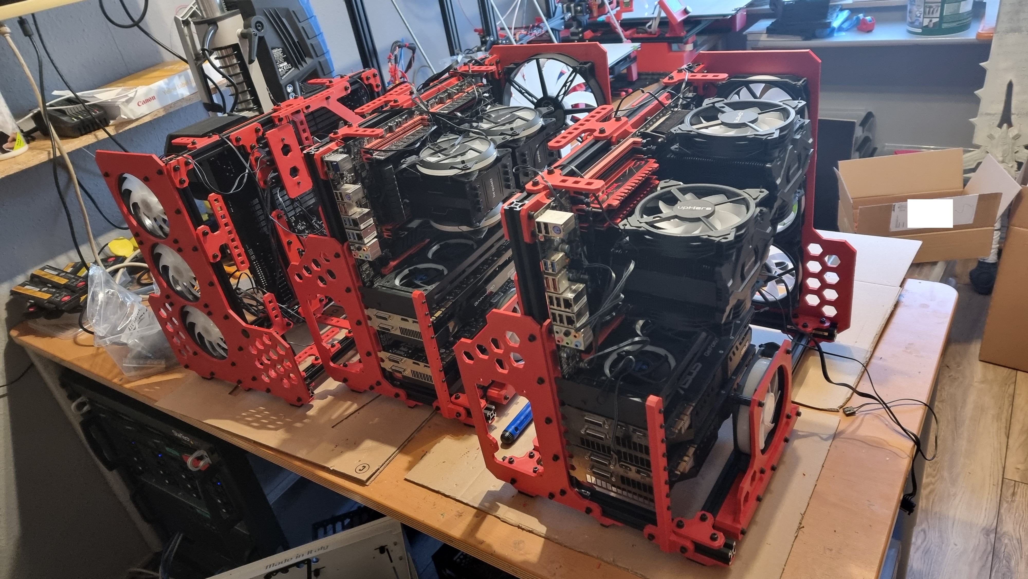

Die Open Frame "Gehäuse" sind echt schick, schönes Design und funktional natürlich auch. Das kleine mit der EVGA 1060 ist dem Open Benchtable nachempfunden?
Ich seh schon, ich muss mir sowas auch mal drucken... :bigok:
Uh aber franzeln da die Schaubenlöcher nicht schnell aus bei den gedruckten Teilen? oder tut man die mit so Sekundenkleber so so hart machen?
