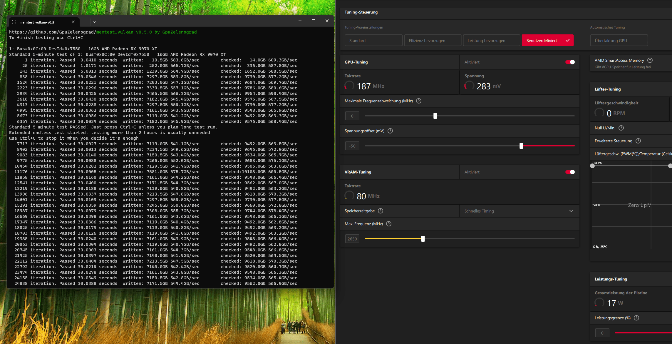

Witzige Entdeckung zu den wankelmütigen Werten in m_v.

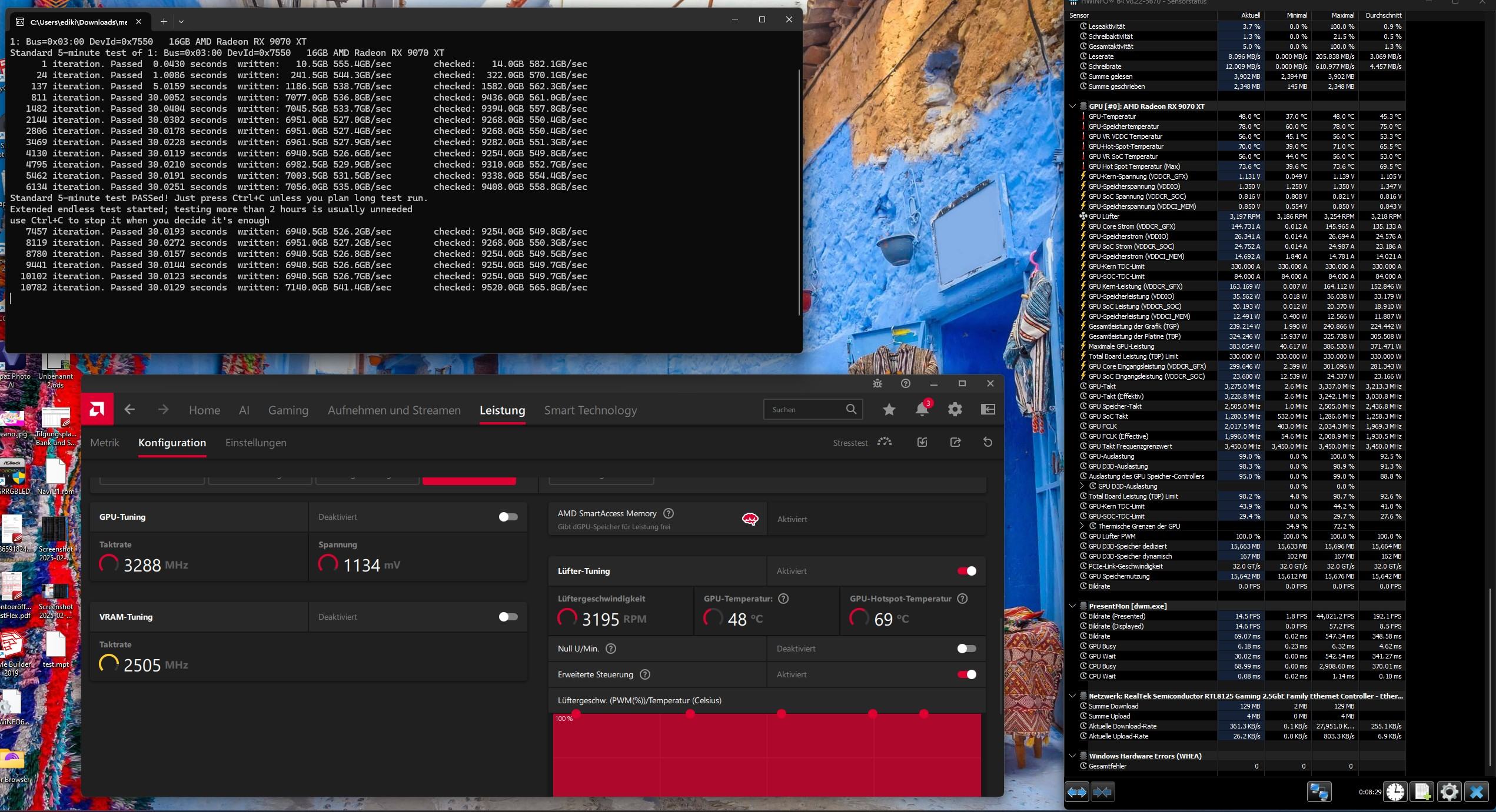

Meine Graka: Sapphire 9070 XT Pulse mit Werten: 2764 MHz | -50 mV | 85% PT
Die Konsole blinkt so vor sich hin:
1: Bus=0x03:00 DevId=0x7550 16GB AMD Radeon RX 9070 XT
Standard 5-minute test of 1: Bus=0x03:00 DevId=0x7550 16GB AMD Radeon RX 9070 XT
1 iteration. Passed 0.0424 seconds written: 10.5GB 559.4GB/sec checked: 14.0GB 591.6GB/sec
25 iteration. Passed 1.0154 seconds written: 252.0GB 564.6GB/sec checked: 336.0GB 590.5GB/sec
143 iteration. Passed 5.0226 seconds written: 1239.0GB 561.9GB/sec checked: 1652.0GB 586.3GB/sec
843 iteration. Passed 30.0137 seconds written: 7350.0GB 558.8GB/sec checked: 9800.0GB 581.2GB/sec
1542 iteration. Passed 30.0250 seconds written: 7339.5GB 559.0GB/sec checked: 9786.0GB 579.2GB/sec
2242 iteration. Passed 30.0282 seconds written: 7350.0GB 558.3GB/sec checked: 9800.0GB 581.1GB/sec
2943 iteration. Passed 30.0218 seconds written: 7360.5GB 559.7GB/sec checked: 9814.0GB 581.7GB/sec
3642 iteration. Passed 30.0140 seconds written: 7339.5GB 558.4GB/sec checked: 9786.0GB 580.0GB/sec
4336 iteration. Passed 30.0309 seconds written: 7287.0GB 555.9GB/sec checked: 9716.0GB 574.2GB/sec
5035 iteration. Passed 30.0074 seconds written: 7339.5GB 558.6GB/sec checked: 9786.0GB 580.2GB/sec
5733 iteration. Passed 30.0069 seconds written: 7329.0GB 558.5GB/sec checked: 9772.0GB 578.8GB/sec
6432 iteration. Passed 30.0334 seconds written: 7339.5GB 558.8GB/sec checked: 9786.0GB 579.1GB/sec
iterations: 6432 | min. written: 558.3 GB/sec | min checked: 574.2 GB/sec
Das Ganze nochmal mit konstanter Mausbewegung während der ganzen 5 Minuten:
1 iteration. Passed 0.0408 seconds written: 10.5GB 589.1GB/sec checked: 14.0GB 608.9GB/sec
26 iteration. Passed 1.0169 seconds written: 262.5GB 588.6GB/sec checked: 350.0GB 613.0GB/sec
149 iteration. Passed 5.0040 seconds written: 1291.5GB 588.5GB/sec checked: 1722.0GB 613.0GB/sec
880 iteration. Passed 30.0013 seconds written: 7675.5GB 585.2GB/sec checked:10234.0GB 606.1GB/sec
1607 iteration. Passed 30.0026 seconds written: 7633.5GB 583.2GB/sec checked:10178.0GB 601.8GB/sec
2336 iteration. Passed 30.0160 seconds written: 7654.5GB 583.8GB/sec checked:10206.0GB 603.7GB/sec
3067 iteration. Passed 30.0224 seconds written: 7675.5GB 585.0GB/sec checked:10234.0GB 605.5GB/sec
3798 iteration. Passed 30.0277 seconds written: 7675.5GB 584.7GB/sec checked:10234.0GB 605.6GB/sec
4528 iteration. Passed 30.0227 seconds written: 7665.0GB 584.2GB/sec checked:10220.0GB 604.7GB/sec
5257 iteration. Passed 30.0102 seconds written: 7654.5GB 583.9GB/sec checked:10206.0GB 603.8GB/sec
5987 iteration. Passed 30.0296 seconds written: 7665.0GB 584.2GB/sec checked:10220.0GB 604.4GB/sec
6716 iteration. Passed 30.0049 seconds written: 7654.5GB 584.1GB/sec checked:10206.0GB 603.9GB/sec
iterations: 6716 (+4,4 %) | min. written: 583.2 GB/sec (+4,4 %) | min checked: 601.8 GB/sec (+4,8 %)

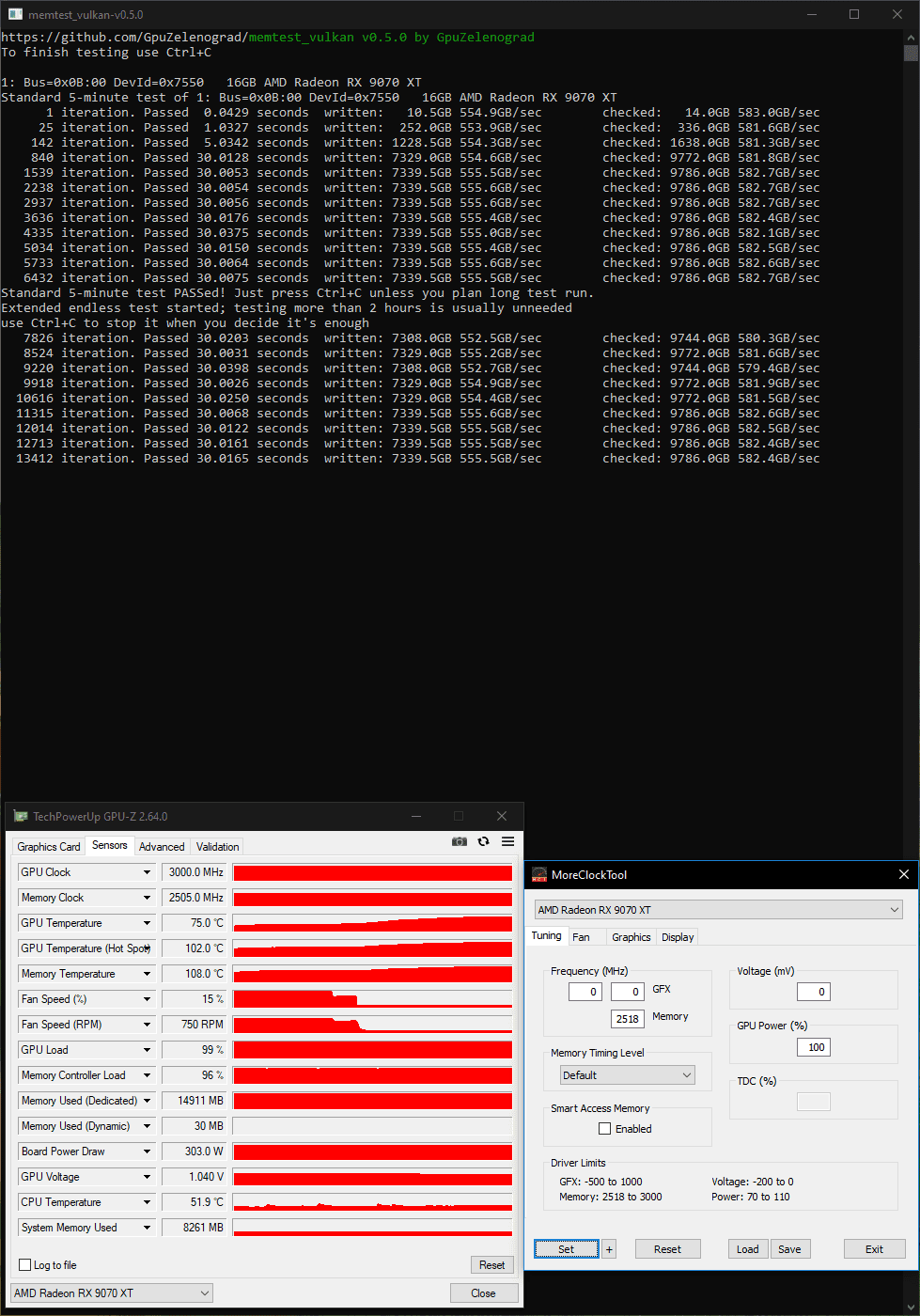

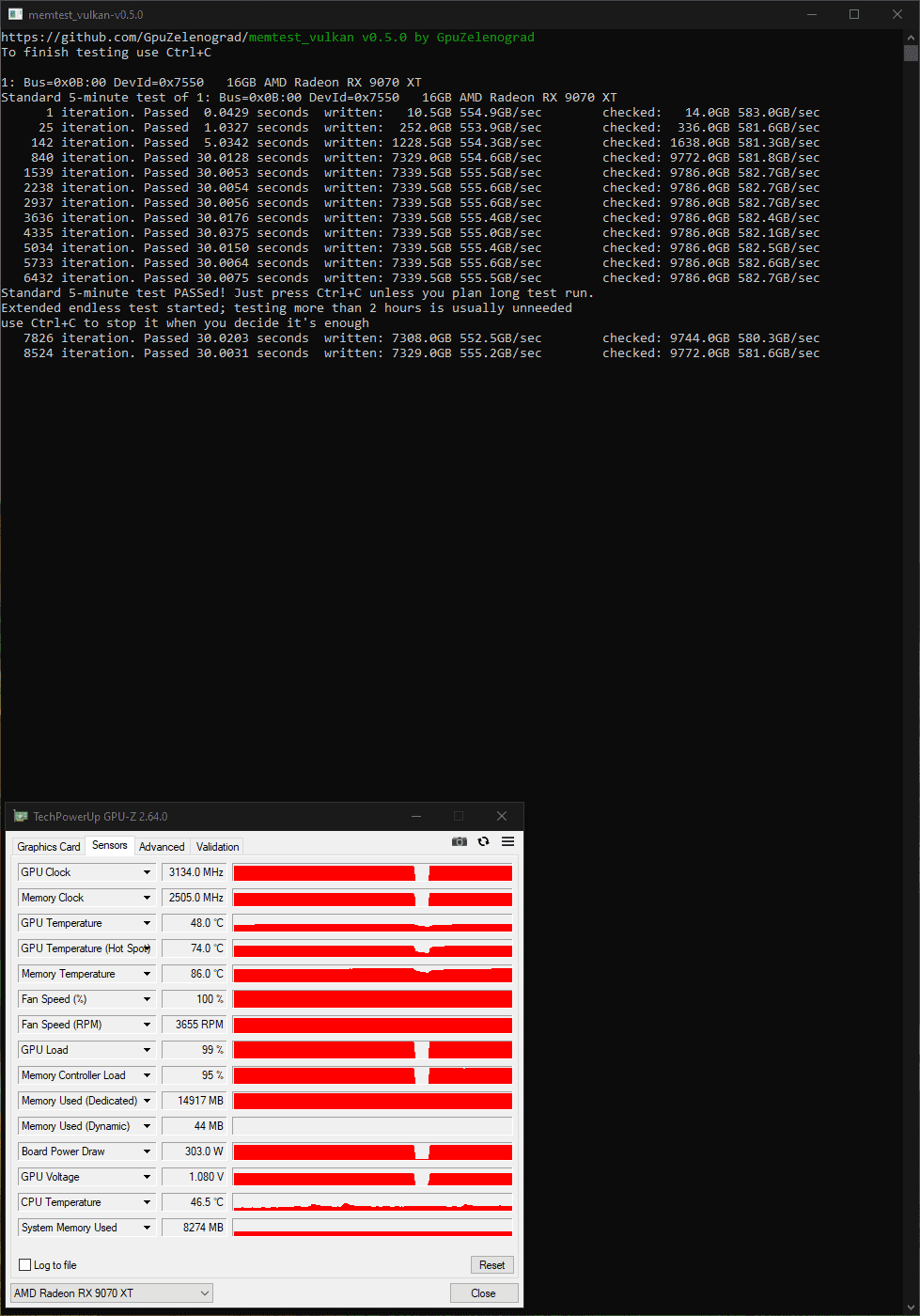

So dann bitte ich mal um Beurteilung. Gerne auch von dir @MehlstaubtheCat
GPU-Z und AMD Treiber Konfig habe ich erst für das Erstellen des Screenshots angeworfen.
2680FT +10% -80mV

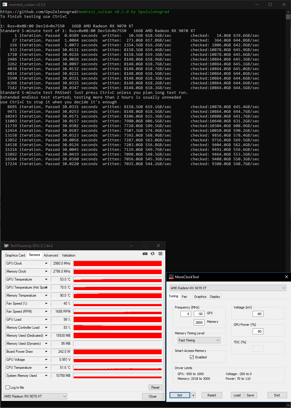

586 GB/s zu 549 Gb/s ist viel zu groß.

Da lässt sich tatsächlich nichts rauslesen. Dachte, wir reden von 4 GB/s, nicht von 40. Zeitverschwendung für alle Beteiligten, no offense.

hab neu installiert. Windows 11. Allerdings kein Tiny oder so. sieht das jetzt besser aus?
2650 FT -50 +0%
Nur zur Sicherstellung. Du machst den Test an und lässt den PC in ruhe und machst nichts? Echt merkwürdig...

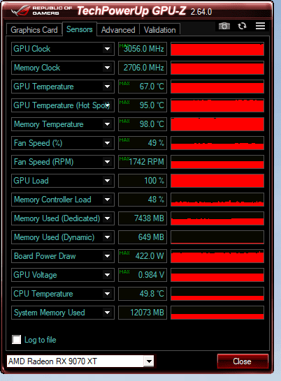

Was steht bei dir im GPU-Z in der Startseite? Mach mal bitte ein Screenshot davon.
Außerdem in dem Screenshot ist ja Zero RPM an, und somit laufen die Lüfter nicht. Ich weiß ja natürlich nicht ob die vorher liefen, daher bitte ich dich Zero RPM auszuschalten und alles auf 100% einzustellen. Dann einmal einen Testlauf mit Stock Settings (bis auf die Lüfter) also 0mv, 0mhz, 0 Power Target und RAM stock.
Nach dem Run dann noch einen wo man nur Ram auf 2700FT ändert.
So ich bin wieder ein paar Erkenntnisse reicher. Ich neide ja auf die stabilen Memtestwerte von dir @barium56 im Beitrag #349
stock mit Aussetzer? Keine Ahnung wie der zustande kommt.
Stock weiterlaufen lassen:
2650 FT, rest Stock - Es gab wieder einen Aussetzer (habe ich aber kein Bild von gemacht).
Gucke mal gerne bei deinen 9070XT, wo du meintest die +-3 GB zu haben @MehlstaubtheCat
Hier sieht man ja schön, solange die gleiche Menge GB geschrieben und gechecked wurde, alles soweit passt und keine Schwankungen vorliegen.
Ich teste weiter.
Sehe gerade, dass ich mit meiner alten Windows Installation #645 auch entsprechende „Wertepaare“ finde, wo es auch zusammen passt. Also Schwankt mein Memtest einfach stark. Aber die Werte passen soweit. Oder was meint ihr dazu?
Ich teste weiter.
Diesen Aussetzer hab ich bei meiner RX 9070 XT auch manchmal, egal was ist einstelle. Also egal ob Stock, ob PT hoch oder runter, alles egal.
Kannst du den Taktoffset mal auf -400MHz setzen?
Ich habe das gefühl das die Schwankungen mehr damit zu tun haben, das GPU und IMC/RAM um Leistung-/Wattbudget "streiten" oder so.
Das Verhältnis was er geschrieben hat und das was er geprüft hat bleibt ja immer das gleiche.
