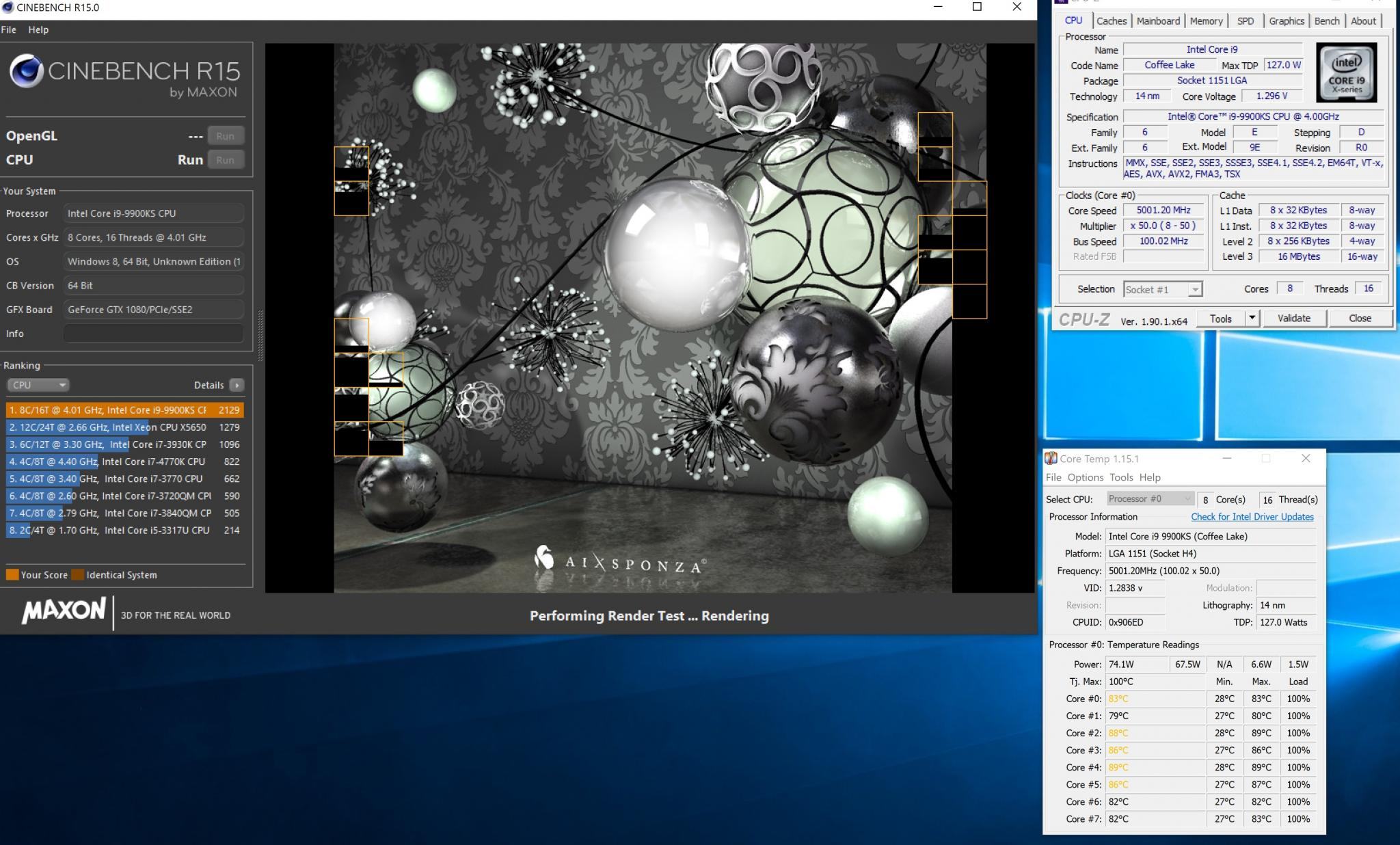

BSOD on cinebench.oliver shall i raise vcore or what now
Did you define all the options that I have mentioned?
Then let's first check if everything fits so far and if it is "only" at the temperature.
Set 4.8 Allcore and let run 5min Prime NON AVX Small FFTs and post please a screenshot with all voltages and temperatures. Best with HWInfo and Coretemp.
yea i did all in bios as u said , and non AVX prime95 temps went to 90 and in cpuz it was showing 1.20v.Hero maximus will come on monday since mediamarkt already gave the packet to DHL.I will install Hero maximus mobo and re-apply the thermal greeze on CPU and will report you back on monday.My cooler is H150i corsair.
Is your cooler realy working? 90° is too hot for a 9900ks even with a 360 AIO you should be at max 80° with 1.2v load voltage
Don't think its your Board... sound more like a cooler/cooling problem.
And when you have 1.2v @load its maybe to low on the Strix. The real value is then something like 1.11v and not all 9900ks will make 5ghz with that voltage.
You have to be under ~80° to get this cpu stable. Some make already WHEA at 83°
Please post a screenshot with all settings, voltages and temperatures.
So we can help a lot better.
As Rauwman says, 1.2 load at 5.0GHz is probably a bit too low on the Strixx. Which LLC did you choose?

Oliver , i re-seated the H150i cooler and temps also came down to 80´s ..i did all settings as you told me to do in BIOS but stil CPUZ shows 1.296v for 5GHz and i think thats why temps are high.Please check i ran Cinebench.i took these settings which u told me.
Ai Overclock Tuner [Manual]
BCLK Frequency [100.0000]
ASUS MultiCore Enhancement [Disabled]
SVID Behavior [Auto]
AVX Instruction Core Ratio Negative Offset [0]
CPU Core Ratio [Sync All Cores]
1-Core Ratio Limit [50]
2-Core Ratio Limit [50]
3-Core Ratio Limit [50]
4-Core Ratio Limit [50]
5-Core Ratio Limit [50]
6-Core Ratio Limit [50]
CPU SVID Support [Auto]
CPU Core/Cache Current Limit Max. [255.50]
Ring Down Bin [Disabled]
Min. CPU Cache Ratio [8]
Max CPU Cache Ratio [45]
CPU Core/Cache Voltage [Manual Mode] > 1.325
CPU VCCIO Voltage [1.25000]
CPU System Agent Voltage [1.25000]
CPU Load-line Calibration [Level 5]
CPU Current Capability [140%]
Long Duration Package Power Limit [250]
Short Duration Package Power Limit [250]
IA AC Load Line [0.01]
IA DC Load Line [0.01]

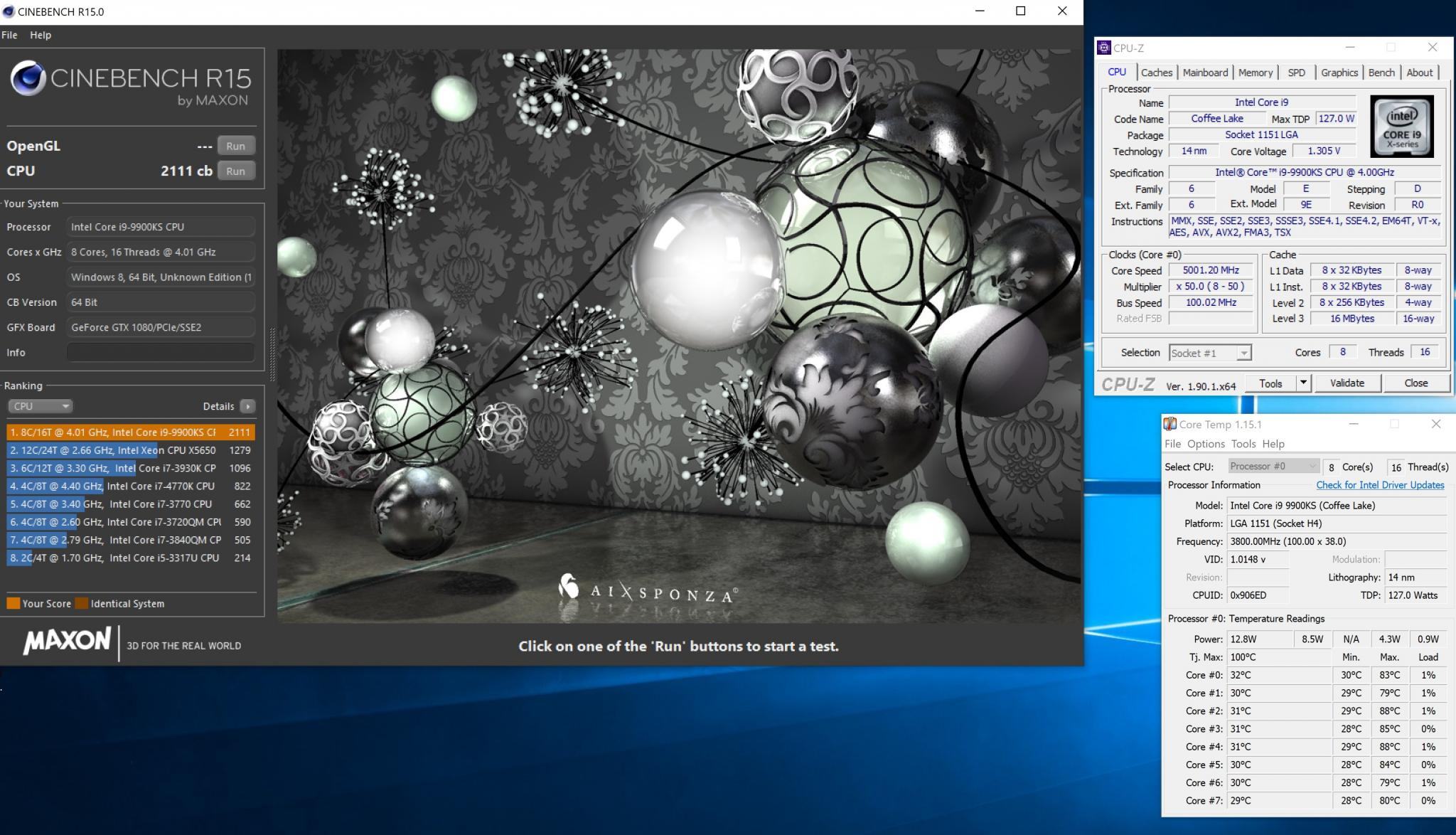

Now i tested on 1.30v and cinebench ran fine.below 1.30 BSOD comes for me.but why its showing load 1.30v to me in cpuz OLIVER ? 1.30v is in BIOS so it must show me 1.23v or not as u said before ?

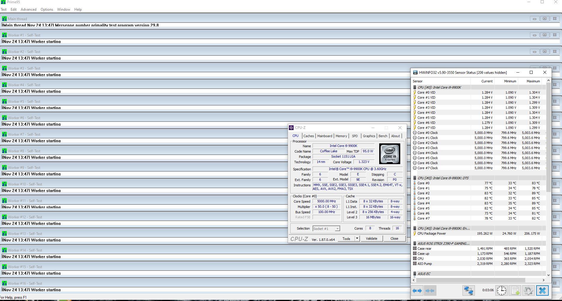

@HugoLOST mach mal nen richtigen HWinfo screen mit der Vcore min max nicht VID (die bringt uns nix)
