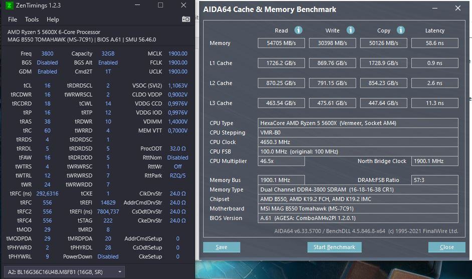

Aktuell sieht es so aus, dass es auf 1833/3666 mit ähnlichen Timings rausläuft wie bei @Exlua. tRFC brauchen meine Module geringfügig mehr als 300ns, bin derzeit bei 560 bzw 305ns, das hat ab und zu Langzeitfehler geworfen. Demnächst dann mal das finale Setting dafür. Copy sieht für den Takt richtig nice aus bei Quadrank.

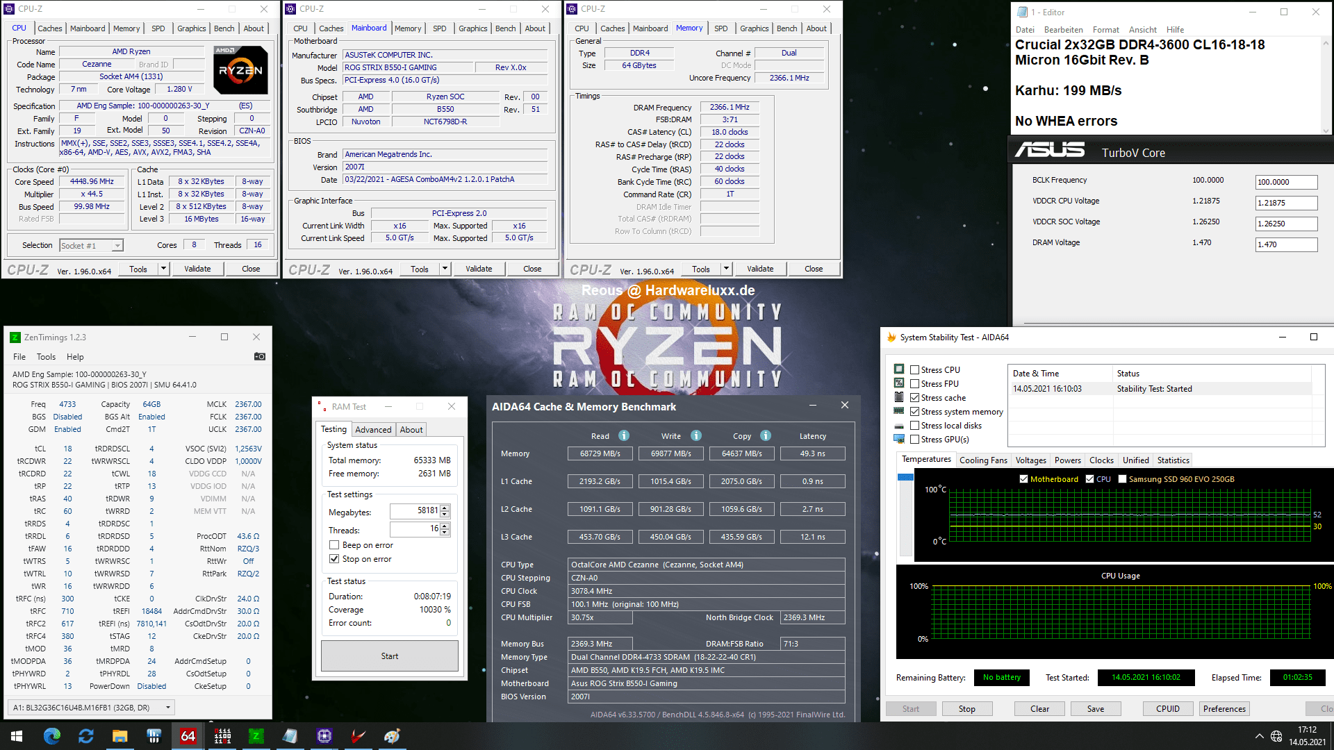

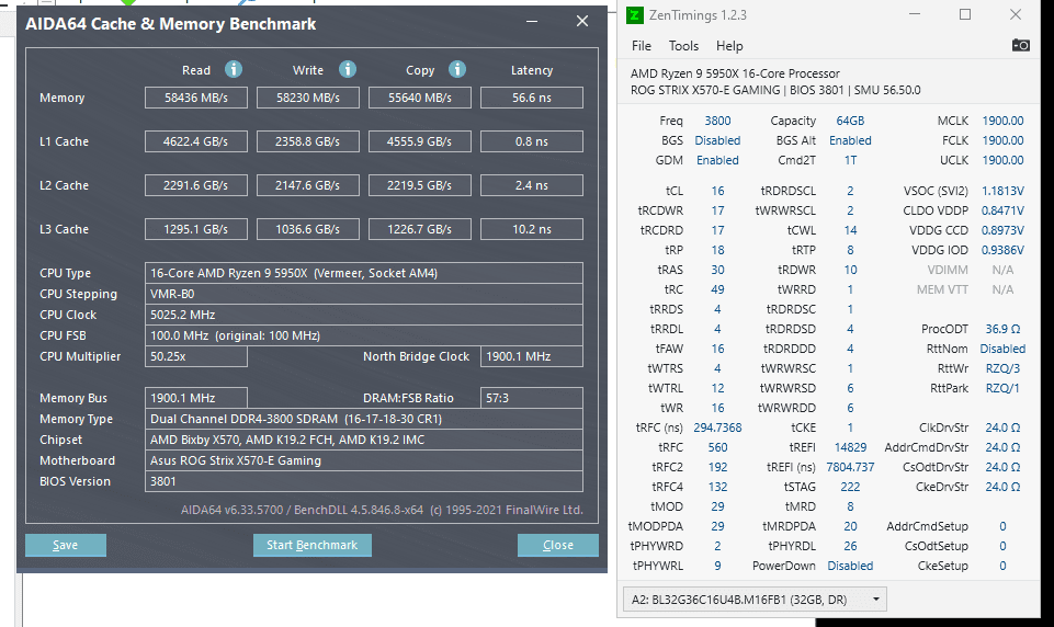

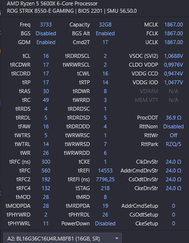

Great info in this thread. Currently stable on this. Cant get FCLK any higher than 1900 without stability issues showing in latencymon.
Any suggestions on improving the timings? (goal = lower latency)
many thanks
Timings looking good :)
Voltages are probably set to Auto? Soc looks a bit high and CCD/IOD looks low.
If you don't get any WHEA errors with higher FCLK you could try it again with different voltages. For example Soc 1.15V, CCD 0.975V, IOD 1.00V
Voltages are probably set to Auto? Soc looks a bit high and CCD / IOD looks low.
Manually set voltages - I found the lowest CCD and IOD voltages that were stable with 1900 on my board.
SOC - I will drop down when once I'm happy I have the best timings possible. (I just left it there for some headroom).
FCLK - I believe 1900 is the 'fully' stable limit with my board / cpu trying the following voltage ranges (with all other clocks at stock). Tried going all the way up to 1130 mV IOD and 1050 mV CCD in hundreds of combinations. Was able to boot and pass a lot of stability tests up to around 2066 but none were truly stable without any error handling or interrupts in the background. I found at 1900 dropping the voltages down to 850 mV VDDP, 940 IOD, 900 CCD didn't have any negative effects on FCLK stability.
So now I think I'm only left with the option to improve the timings (unless you can see something else?). I come from a computer background but memory timings are not my strong area so any changes to what you can see in the to the above screenshot would be appreciated.
Thanks again and keep up the good work :-)
Maybe tRCDWR 16 and tRP 17 is possible? Main timings for low latency are already set.

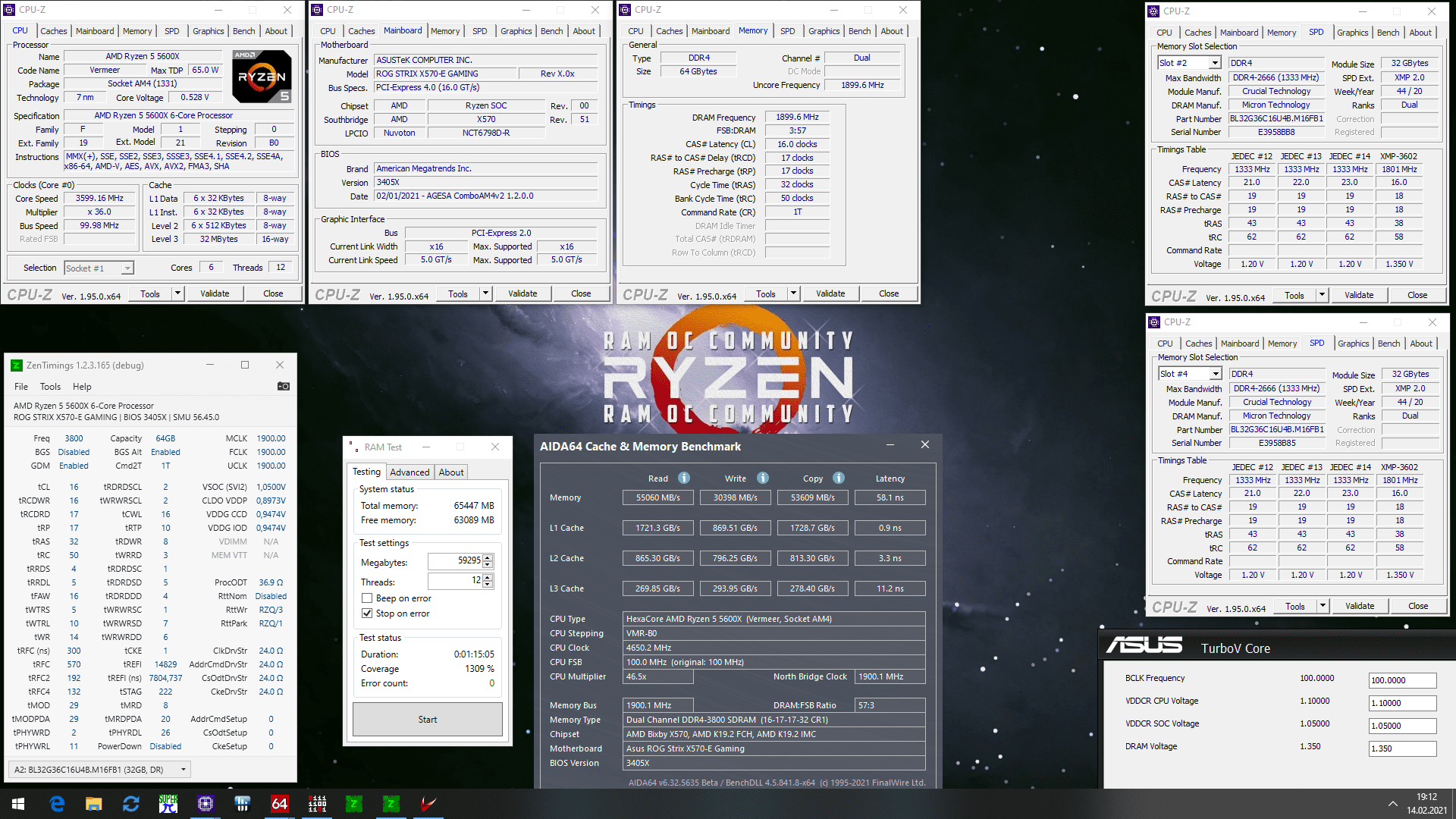

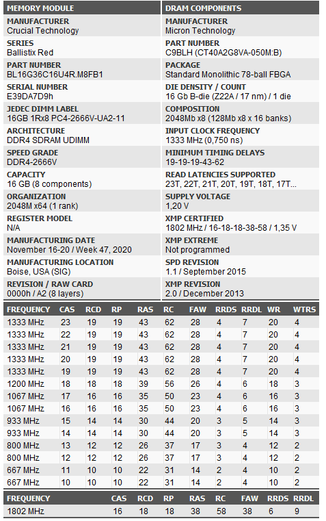

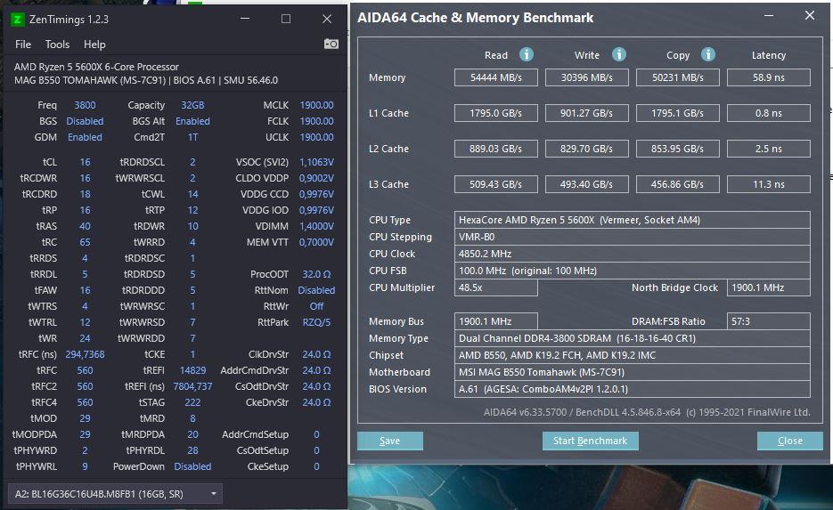

Abend, bei mir war mal wieder die Post. Habe eben das 64 GB 3600er Kit BL2K32G36C16U4 bekommen. Die Bestellung hat ebenfalls Wochen gedauert. Nun stehe ich wieder vor der Frage, auspacken oder return to Sender. Eigentlich wollte ich mittlerweile das GSkill 32GB 3600 CL14 mit S B-Die. Kostet ja leider genauso viel.
Habt ihr Erfahrungen mit dem Kit?
@Reous Sehe ich das gerade richtig? Du hast das selbe Kit? Falls ja, mit was für Settings kannst du 3800 laufen lassen? Grüße
@roca_xx
Nur kurz angetestet mit XMP Spannung

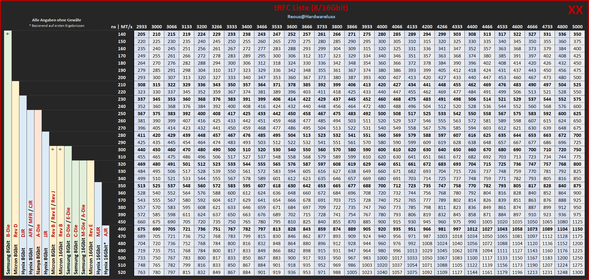

Latenz ist von mehreren Faktoren abhängig. Mein Cezanne kannst du schon mal nicht mit Vermeer vergleichen.
trfc ist auch kein fester Wert. Um die gleiche Leistung zu erhalten muss man den Wert bei höheren Taktraten ebenfalls erhöhen. Deshalb bevorzuge ich den trfc Wert in ns anzugeben.
Beispiel:
DDR4-3200, tRFC: 480 = tRFC: 300ns
DDR4-3800, tRFC: 570 = tRFC: 300ns
DDR4-4733, tRFC: 710 = tRFC: 300ns
Unterschiedlicher RAM Takt, unterschiedlicher tRFC Wert aber alle drei haben letztendlich die gleiche Leistung. Für den Zweck habe ich die tRFC Liste von curious fortgesetzt und über die Jahre ergänzt.
@Reous bei deinem Scrren ist der Bench im L3 nur ein Drittel von meinem? Liegt das an den Crucial? Ich habe eben nur mit meinem 5600x und den Viper Samsung B-Die @ 3800 16-16-16-32 verglichen. Die anderen Werte sind nahe zu identisch.
L3 ist CPU abhängig, hat also nichts mit dem RAM zu tun.
Schlechter L3 Wert liegt am BIOS. Macht die neueste Version drauf und hofft, dass euer Board den Fix hat.
