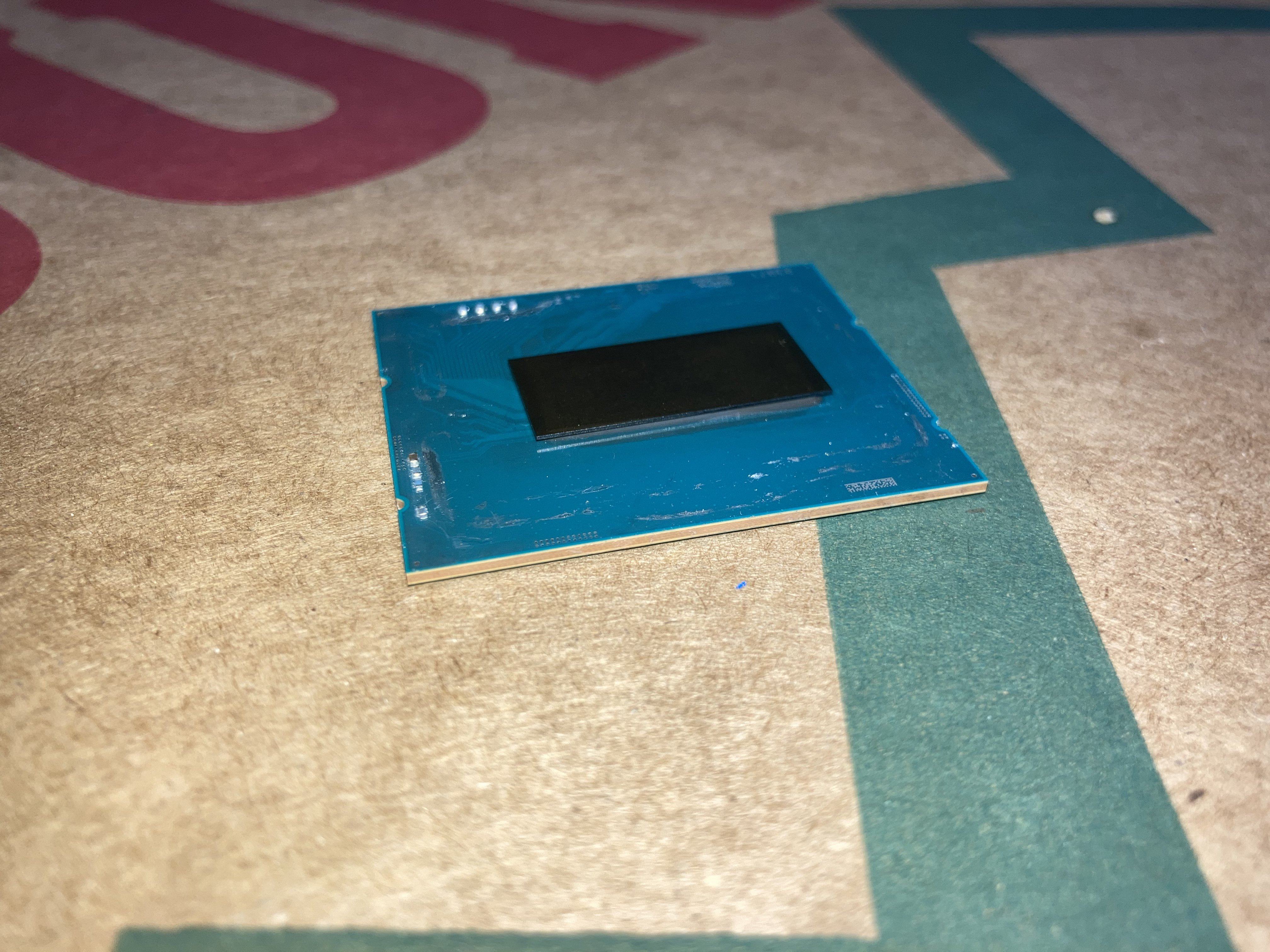

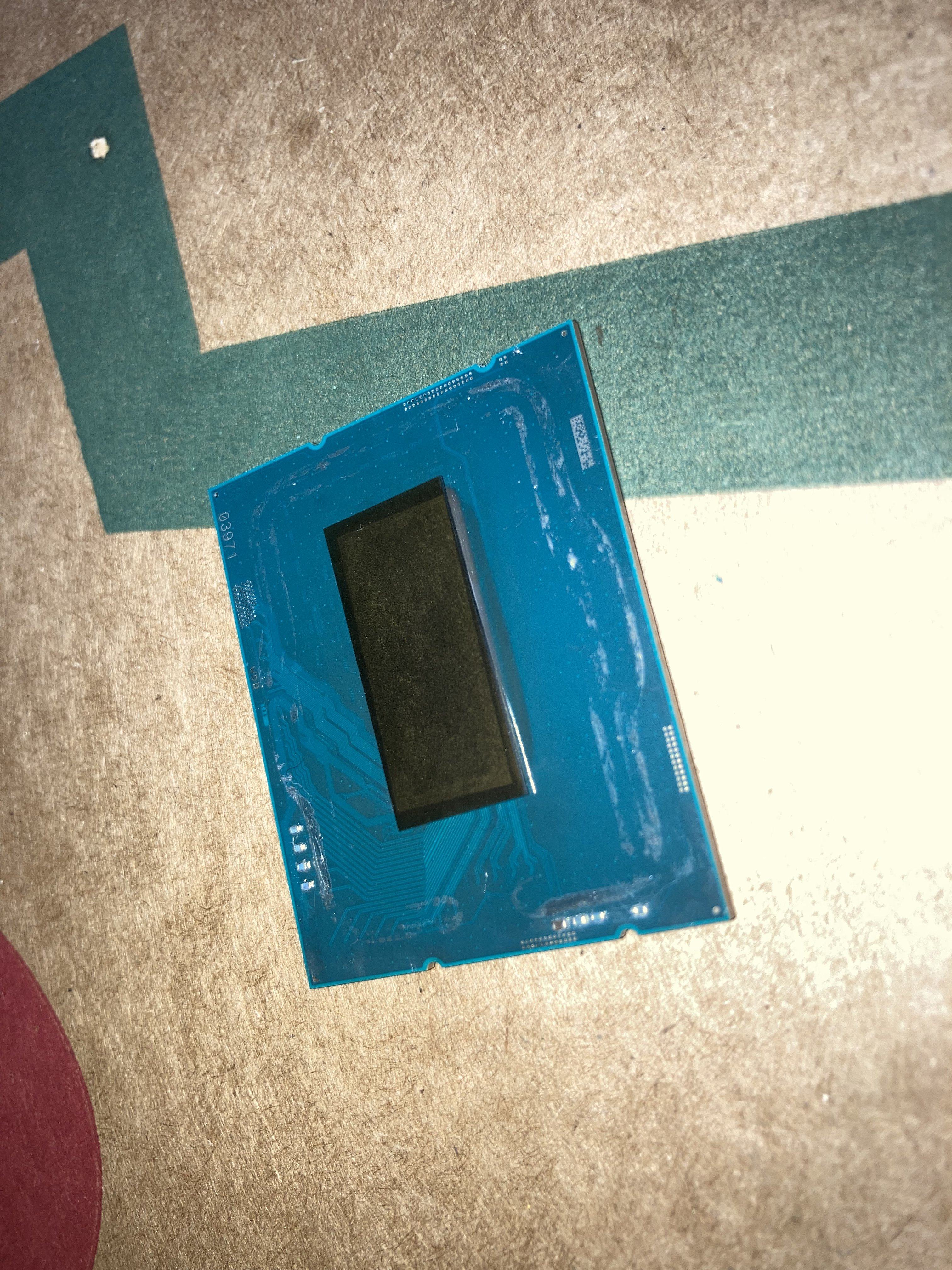

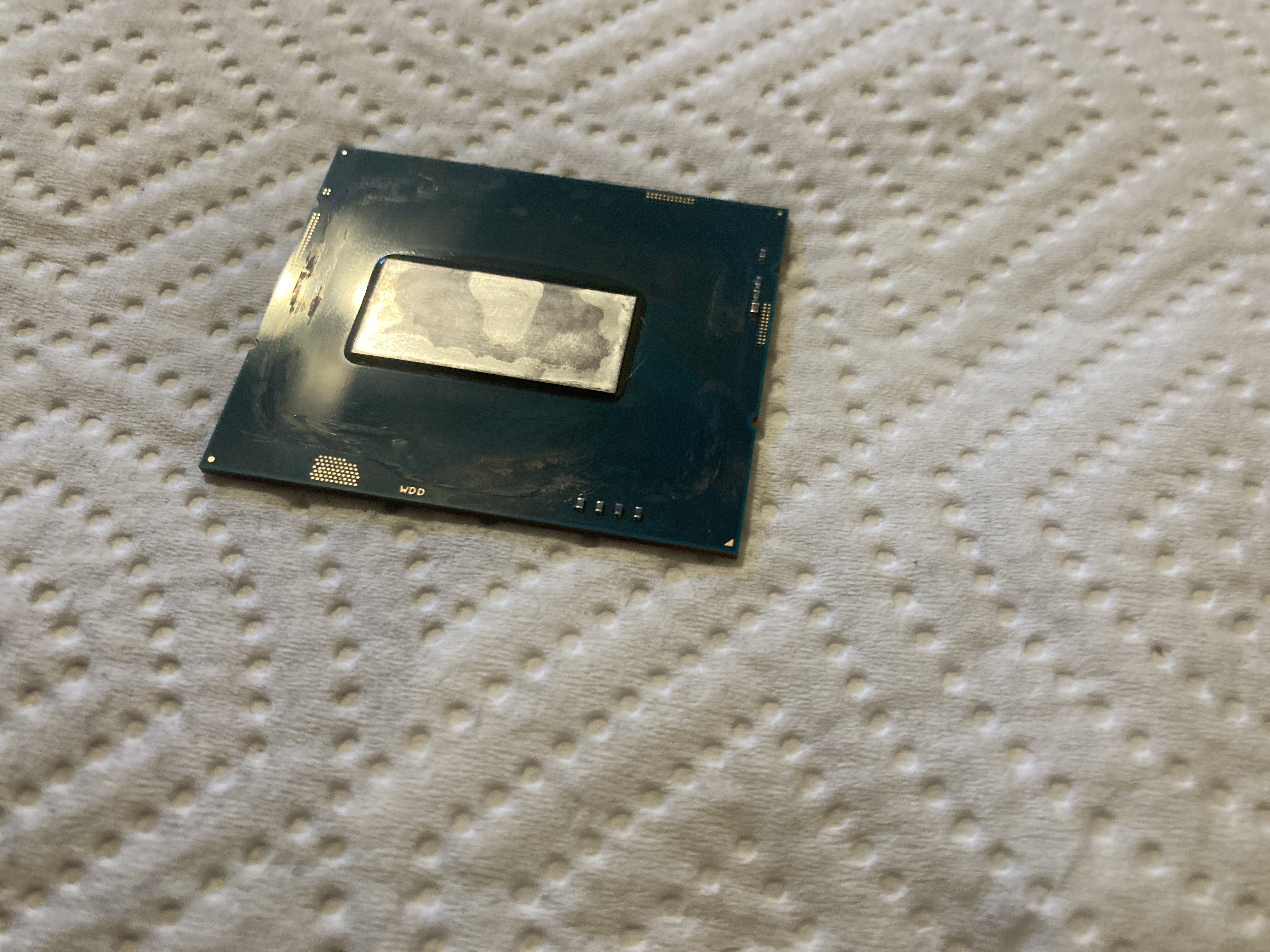

I lapped my die only a little with 2000 grit, wetted with water. I only took off the top layer in an area about 1 cm square, but in an odd shape due to uneven surface. The uncovered area looks similar to a silhouette in a Rorschach test.
I forgot to take photo after the mild lapping. This sample had very poor adhesion of the solder to the die. The dark areas are the poor adhesion; the solder just flaked off. Meanwhile the lighter areas had solder that was very stubborn to come off and required 3-4 applications of small amount of LM to dissolve/break free.

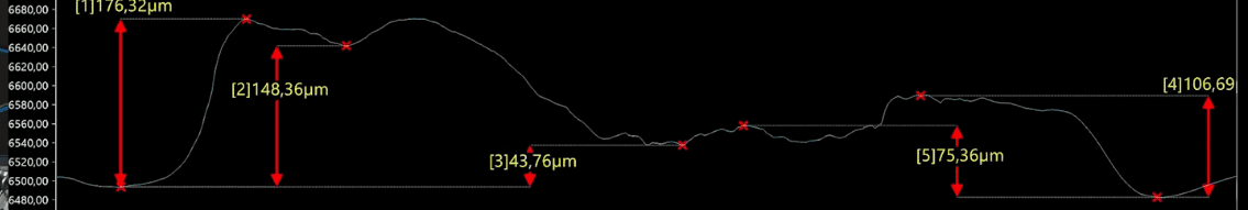

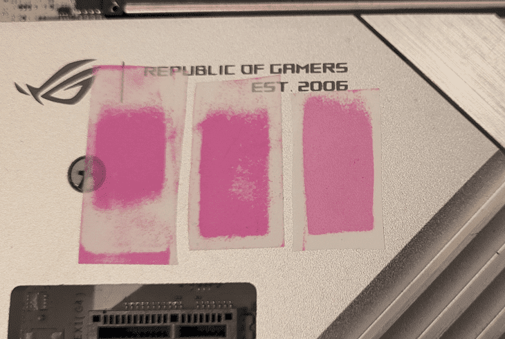

Without lapping you can see how bad it was.
Of course the corners crack first...
All CPUs are at a rollercoaster like igor shows on the pic from the last post
And normal spreading simply wont make it accurate
The issue here is rather the irregular pressure + the sensitivity of the crystal
While the paper needs software to map out the height, it does show it well with PSI how inconsistent it is

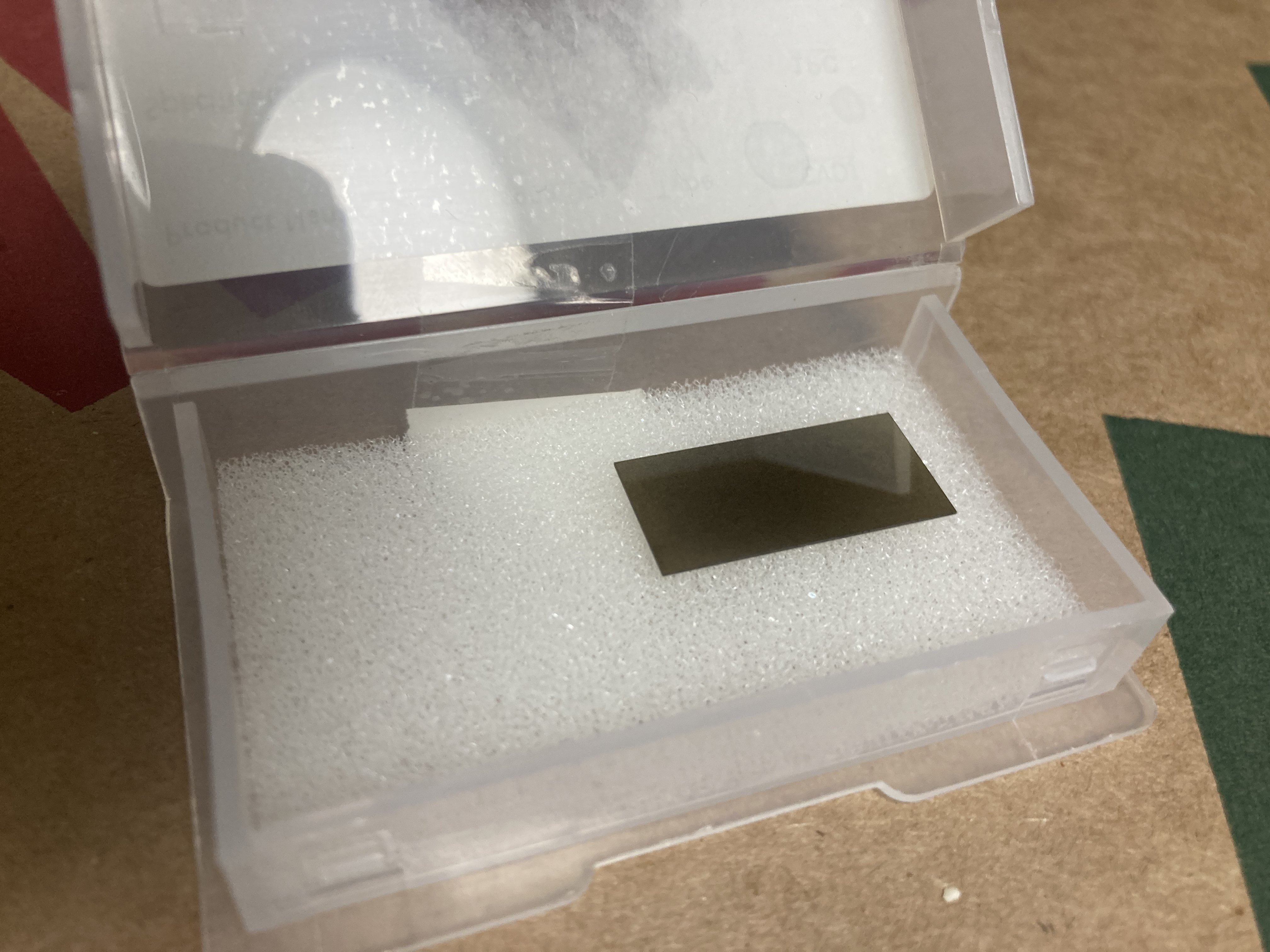

// the lowest you can "test it" with is a grocery store recipe or any very thin paper this is around 100microns thick. +/- 5 to 10µm
Usually those LLLW's sell for 50-60$. the LLLLW for 100-120$
It feels like a no brainer seeing their sample pack for 10$

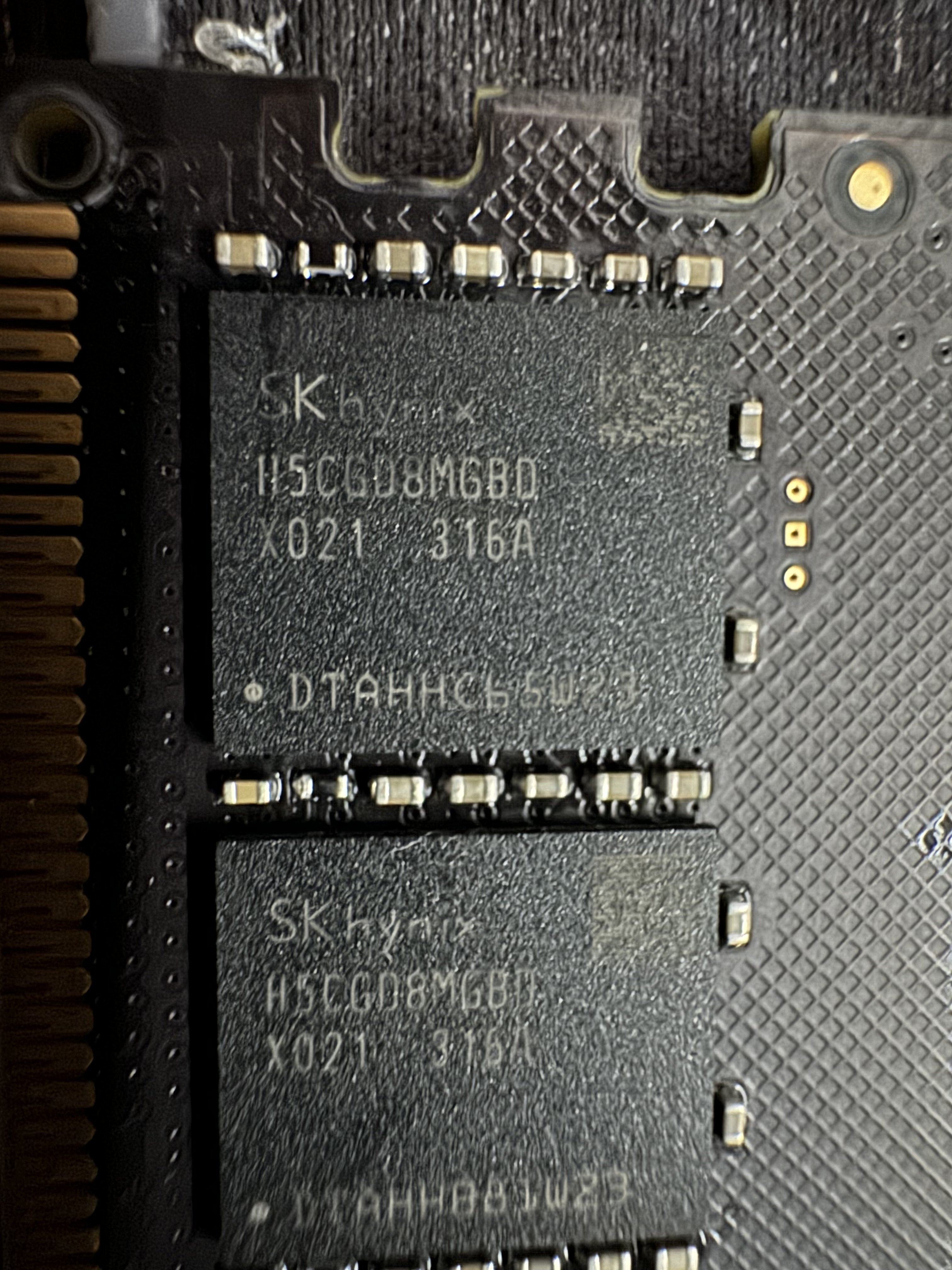

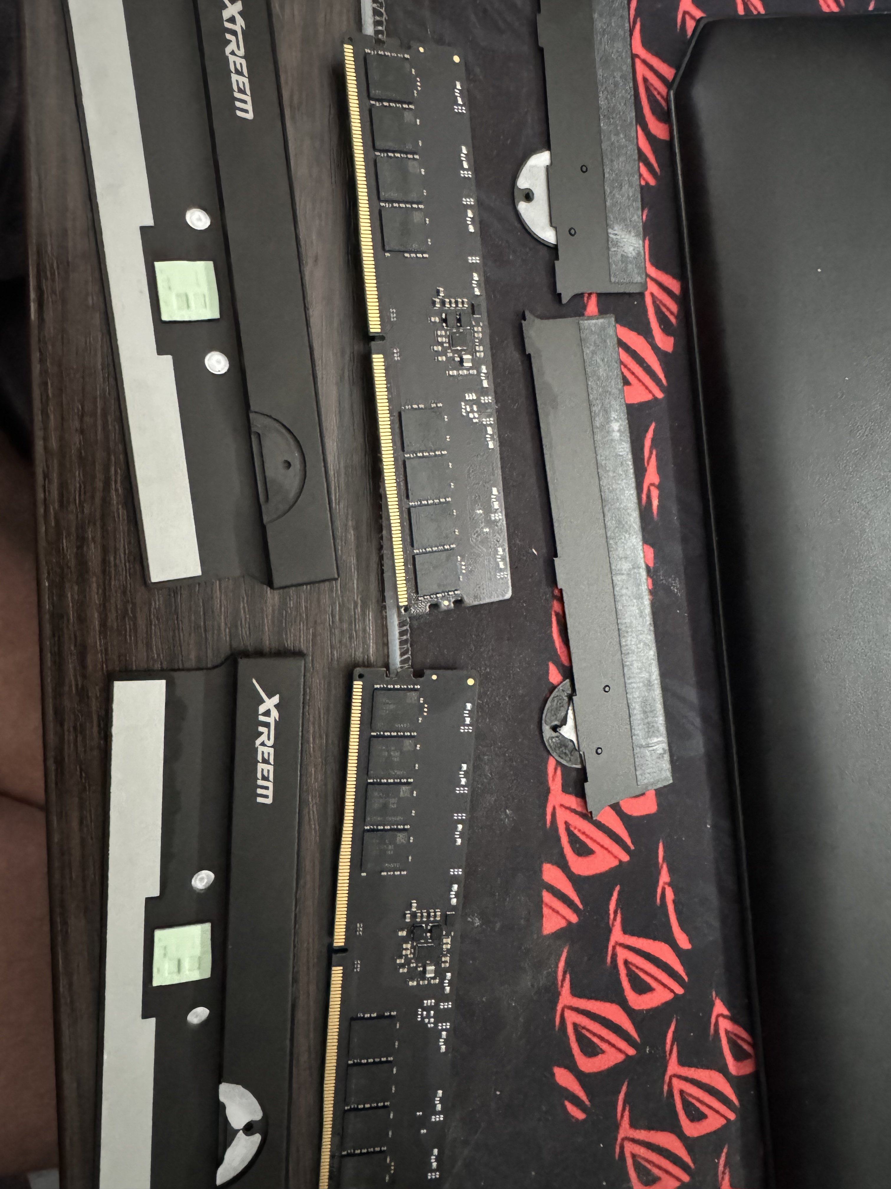

Today I teared the O ring on the Supercool block and flooded the RAM slots with ccolant. :d (wanted to reapply the LM and play with the tightening a little bit.)
My PC decided to not turn onn with RAM in DIMM A, so I cleaned the slots, and the CPU socket and installed my good old Iceman block.
And guess what? It's better. At least my TG Xtreem started to work. It will worth to put the waterblock on it. :)
Through ICs or only into the slot ?
Seems past edit, dimms look good
Class A is nice to see too.
They were, yes
But 8400 is nothing new for you :-)
Just a sanity check or ?
I flooded everything, even the dimm.2 slot too. That made the boot hang on 00 for some seconds.. it's removed now, should dry out a little. Gskill works too just this was easier for slot testing without water block.
8400 was never happened on this particular Teamgroup kit.
But I am still looking for answers, acts totally different compared to Gskill. This one doesn't like the high in-mem deltas.
I need some time to find out.

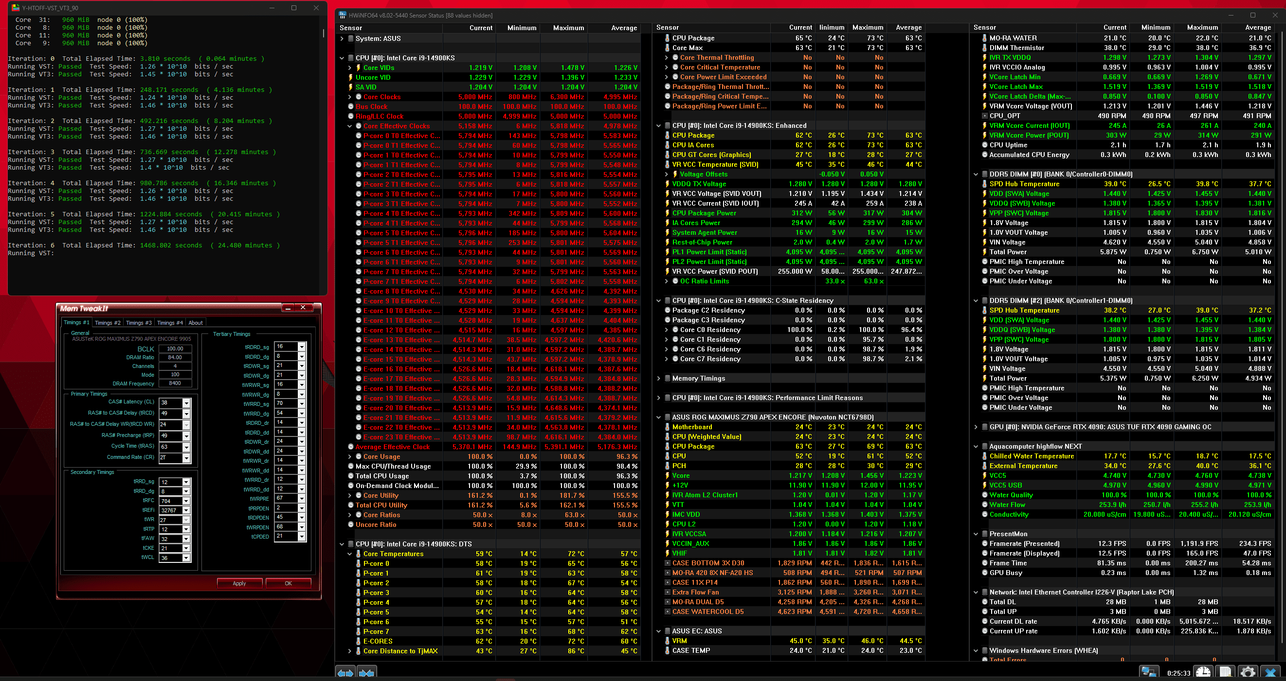

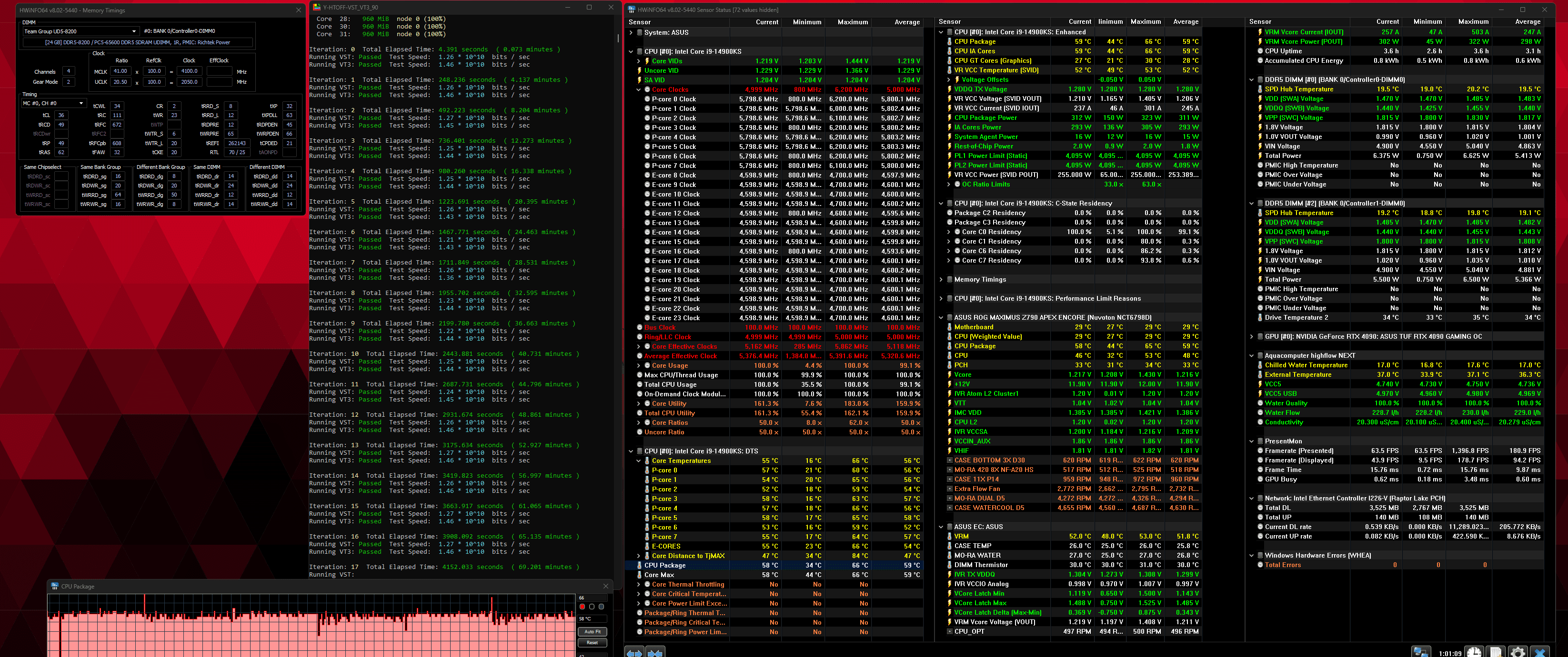

Started on water from 8200C36 to find out how it works.
Cleaned and polished the block and the die, reseated several times. Now the temps are looking okay.
MVDD: 1.48V
MVDDQ: 1.44V
SA: 1.20V
CPUVDDQ: 1.28V
VDD2: 1.431V
RON 48/40 - 40/48 (RON training disabled, VDDQ training disabled)
Did some work on the PC during the test, so bitrate is not constant.
@Veii

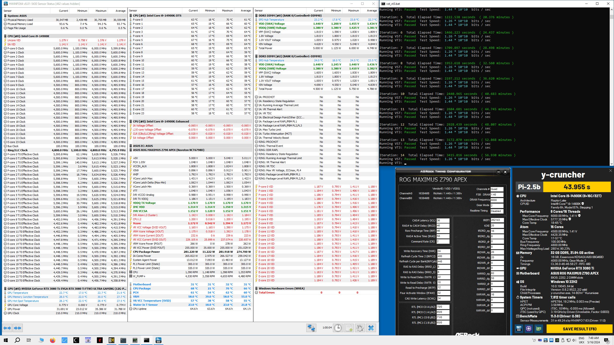

Got a new 14900KS and have hard time getting 8000 VST/VT3 stable. I remembered you suggesting to run MC SP x 5 to see how constant are the values. So i did that and got, 80-86-80-84-87. I use a TR contact frame, so this might be the issue? Shall i change to original ILM and retry?
BTW here is my VF table, so im open to voltage suggestions. My 2x16GB kit can run 25 loops TM5 Usmus at 1.47/1.41 8000 36-36-36-58 no issues.

For it to turn into a thin oxidation layer without permanently bonding both materials together
// Basically users distance always was high enough, soo this inevitable event doesn't occur in its fullest worst-case
I probably will remain to dislike it, because if you already try to go direct-die
Your first and foremost focus should be a good contact, for lower thermals to occur. // because thermal-transfer-resistance is the most annoying part of any TIM. Plain air has the highest one.
Air is a far too good insulator, and it wouldnt matter much how well thermal transfer resistance is ~ when the Z-Axis is tiny (~50µm), compared to normal usecases of 150-200 microns
There the paste quality wouldnt matter and you'd prefer something with much finer ingredients compared to our common viscose pastes.
Something very liquidy and/or oily that doesnt evaporate.
I also have a 0.3mm Z-axis height chemical vapor deposition diamond heatsink that I haven't tried. I paid a company in China to manufacture it.
Even though the Z-axis thermal conductivity is supposed to be very high (1400 W/mK) it still adds Z-axis height for the heat to move through to get to the water if placed between direct die coldplate and die, so I lately I don't think it will improve things. It adds a bit of thermal mass (25mm x 13mm x 0.3mm=0.0925cm^3, 3.51g/cm^3 x .0975cm^3= 0.342g).
It may also help move heat in x and y axis a bit to be accepted by a larger area of the coldplate. It has advertised horizontal thermal conductivity of 600-700 W/mK.
I have dreams of designing a direct die block with only CVD diamond between the water and the TIM to the die. The diamond for this application would need to be much larger than the one I have as it is only slightly larger than the dimensions of the die and would cost something like $500 US just for the diamond portion.
EDIT: If chemical bonding between the LM and the die is to be worried about, perhaps my diamond heatsink would be a good permanent fixture to a fully lapped die. I wonder if thermal transfer would be the same once the chemical reaction is fully complete and all the LM is bonded to the crystal? It is a good CPU sample and I wouldn't mind this happening if thermals are good.

Got some free time this morning, coffee and DDR5 :)
Managed to gain some stablity finally...
VDD/VDDQ 1.46/1.41
SA 1.18
TX 1.30
MC 1.425
56/44/44 HT Off
VDDQ ICCMAX 15
Unlimited ICCMAX Dis
CPU CUrrent Limit 400
PL1/PL2 250w/250w
IA AC 0.01
IA DC 0.82
LLC 5
IA VR Volt Limit 1550
Does incosistent VST indicates instablility of any kind?
With meteor forged chemically deposited layer or unicorn sparkles blessed by the poope. :LOL:
Too many buzz words
Basically a copper heatsink with (or allu), idk what that last part is supposed to mean
Got any pics of that thing
Given the need of buzz words, i would doublecheck its manufacturing tolerances, because ya
Too much marketing, too little data for the product to speak about itself
EDIT:
I understood later :) nvm
But your problem still will be the layer created to your waterblock. Nickel will not prevent it, just slow it down
If copper, its the same thing
Thermal conductivity rating is such a marketing word :d

its less the material or the indium thats the "issue".
Its the gaps and lack of flatness which brings people to go the delid route - just to mess up again and introduce airgaps 🤭

Just get the gap tiny or at very least flat , and use a liquid TIM that will not evaporate till 140°C. All issues resolve
Material ringing is a very interesting property and barely understood tlll today.
usually a droplet of machine-oil is plenty to hold both together, if there wasnt only the thermal expanding factor
Eh the crystal is stable enough between -100 -> 200°C.
Only your waterblock should be your worry and the roomtemp flatness of the crystal.
RTTs :)
G.Skill uses own stuff.
Teamgroup & OloY , mutually most likely use a similar thing
Chance is very high to be the "common" HJ 10 Layer.
its a bad timing ~ but it would be good to use the G.Skill's and find your old base again with manual RTTs.
Then we can transfer this to the Global HJ's.

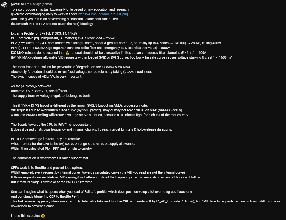

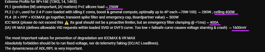

I actually would also like to try and cut VR MAX down to 1500mV @ 400A ICCMAX
Last days calculations makes it fit just perfectly inside 400A.
I would like to know if i understood VID spreading well, or UncoreVID will cause me/us trouble.
If you find the time, can you make me a table/paper writing with the ~score~ results on:
GB3 (Core+Mem), GB6, CB23 or 24, CB15 Extr, y-cruncher FFT 3-4 loops (takes 8min max)
Between 1600mV and 1500mV VR MAX.
^ it may destabilize your memOC ~ but probably first result in degraded boosting perf
Happy to see Intel finally "coincidentally" agreed on 400A as absolute max.
nice to seee ~ tho they remain silly with PT1 = PT2 ideology.
Now they just need to agree at 1600mV VR MAX vs 1720 and remake the basic curve through ME update.
Then we are golden and i'm happy with my talk against a brickwall~~
Whoever makes the frame is not as important as your own caused mistake :)
Yea please remount
TR frame can be tightened down nearly fully ~ but if you apply too much pressure by your cooler, you'll mess it up
Pressure only needs to come from the frame.
TR screws sadly loose grip over time
They are cheap. I broke them twice so far
I would suggest on an Apex to see if its flat on the original mount + original screws (put the protective cover on)
And if not, loose all backside screws a bit, so we dont have a banana Board.
Only then tighten down your Socket mount. Dont do the reserve order please.

@Darkthrone , use ASUS Tool.exe to manipulate your V/F curve.
Do not use Telemetry Faking.
Yea please remount
Sadly the Apex is in the case and cant check if its any wrapped or not.
I use an Alphacool Core 1 cpu block + backplate. Shall i tighen the TR frame at the max, and block + backplate go by hand till it start to get resistance? Does this sound good?
Btw TR frame uses the boards ILM screws, does not have any in the box.

So change for VST/VT3
PL1/PL2 256w/280w
IA VR MAX 1600
IA AC Auto
IA DC doesnt affect vcore so i can keep it as is
CEPs Disabled
Oh thats funny
Guess its a good thing, because they were bad and breaking inside the Backplate :d
Only your drill saved you then.
Yes, does the Alphacool core Manual not say "tighten fingertight" ? :-)
My suggestion is, to hold thumbscrews with first 3 fingers (tingertipps) and then tighten as strong as you can be ~ but only use the fingertipps.
Thats plenty and around .6Nm . Tho Nm "depends" :)
Alternative is to full tighten and then unscrew all 4 screws a bit, but that gives a random variable.
I remember my Alphacool mount does have springs and washers
The springs are hard to put in, so i had to use a screwdriver just to press them into the backplate
Then fingertips-tight only (y)
All the pressure-creation, belongs to the frame.

Can force to 1.1ohm
between 1.08-1.12 or so ~ Boardloss focused. Usually LCC also should stay droopy , because its either LLC or its IA_LL messing.
// i can do both because i do silly stuff sometimes - but dont do as me. Do it right. Messing with LLC is also quite suboptimal as you never have measured the Board.
// Boardpartner knows the best the required LLC of their designed Board
Intel is also doing mystery work and jumps between 1.1ohm and 1.7ohm , haha.
They can't decide on something and neither does ME reflect it. Till recently it was 0.5ohm with a high high voltage default curve that can supply 1.7v to the CPU when 2 cores are loaded.
Oh dear.
PL1/2 limiters should be only your worry with an AIO or a weak PSU.
They are dynamic slow limiters and do not matter if they are high or inf. They should have some logic in them tho, aka PL2 be what its supposed to be, a short boost limiter.
If they are tight, you will throttle on many places ~ which factors in your memoryOC voltages too.
With VR MAX of 1600mV , you also will mess with the curve,
because all by default is far too overvolted.
I suggest to work on your curve, and lower it ~ else you may not come far with memOC ~ as you'll reach CEP and other throttle points by stock operation
// that's how bad it is right now, well always was.
At least its safe,
But it will be throttle hell till you fix curve yourself.
So i can keep LLC 5 and just have AC LL/DC LL at auto?
I want to keep PL1/PL2 as low as possible to prevent any kind of degradation till i have my mem tuned. Thats why i keep both Pcores low and set PLs
With VR MAX of 1600mV , you also will mess with the curve - So which vlaue is ok?
I suggest to work on your curve, and lower it/But it will be throttle hell till you fix curve yourself. - From the OC tool where can i find the VF curve so i can post it here for some advice?
Too many buzz words
EDIT:
Material thermal-transfer resistance is what plays a key role ~ as its the factor of when wm/k even starts to matter.
Same one goes for direct-die shenanigans.
You only need a heatsink if the gap is big, mostly past 200 microns where pads come into play as liquid TIM loses usefulness on such a gap.

I'll send photo today after I return home from work of my diamond heatsink.
It isn't a product. I contracted a manufacturer in China to make it per my specifications (dimensions).
The salesman has been hounding me for 8 months asking what the performance is like. I still haven't installed it :)
EDIT: Chemical Vapor Deposition is the name of the manufacturing process, not buzzwords. They bombard the surface with carbon atoms in gas form to crystallize on a substrate in a specific environment (temperature, pressure, etc). This is purely an idea I had that may help get the heat out of the die more quickly, and spread over a larger surface area that makes the contact area with the coldplate larger.
I can try it later. Now it's 1600, but with the beefy ccooling I can go lower I believe. :)
If you force low clock and force IVR to throttle mem voltage
What are you working on to test ? :)
Wattage is average powerdraw metric
You can run them as:
Ansonnsten wäre es
PL1 300W, PL2 476W, 400A ICCMAX , 1550-1600 VRMAX ~ fürs "Veii Extreme"
PL1/2 is not soo relevant :-)
Pic is updated those values are better, but non of those causes degradation haha.
It will hit ICCMAX first. PL1/2 are not degradation limiters. Rather powersupply protectors
They are average thermal limiters. Way to slow to be used as current limiters.

Unfortunately even that process is far from flat.
You need to start from a flat surface, else lapping that layer will cause you much trouble.
Lets see the outcome :)
Curious about 3 things
substrate to crystal height
crystal to IHS height
And if you have factored in the additive height of the corner feet (silicone glue)
Unless you thought to do that on the native IHS ?

Supposedly the manufacturer lapped the diamond before shipping.
It will go under Supercool direct die coldplate, between die and coldplate.
If I end up further lapping the die, I think 0.3mm shouldn't be an issue considering the material removed from the die.
Also I may shim under ILM. Shim washers I'm considering: https://www.mcmaster.com/90334A209/
I wonder how much you removed
100 microns you can remove from the crystal.
150 becomes dangerous already
200 i can not recommend anymore.

I can't imagine I removed even 100 microns yet. Maybe 50. Only a small area in the center of the die is missing the outer layer. Maybe 1 cm^2.
There will be no additional conductive/inductive material. Only 13x25x0.3mm diamond heatsink (die is ~12mm x 23mm). Just Supercool direct die coldplate and that is it. It is same dimensions as IHS.
Anhang anzeigen 999640 PL1/2 is not soo relevant :-)
I am testing VST/VT3 for mem stability.
So i changed PL1 256w/PL2 320w/ICC MAX 400A/IA VR MAX 1600mv/AC LL Auto
Now Cine23 run at 56/44/44 1.172v-1.181v 253w and VST at 55/44/44 1.163-1.172 270w which is far more than it needs.
Which option shall i use in OCTool to link you the VF curve?
Its not about manual undervolting~
Either it fits like math says or it does not, because i did not factor in some parts.
Dont touch curve pls.
Got confused :-)
Indium should have been between 250-350 microns (0.25-0.35mm)
Well ~200 + silicon feets/ring of IHS.
Its a far too small range to measure unless you invest in mitutoyo measuring gear with a ruby ball (not worth for your task)

Just to understand fully, this is:
~ a single crystaline synthetic grown crystal, like they use for LEDs
~ a copper ? sheet just with a diamond coating deposited on it
~ some other base material that you inspected to have good Z-Axis Wm/K rating, and hopefully low thermal transfer resistance.
Which is far more than it needs.
I'm sorry, but i didnt write the tool. I dont remember its dropdown position.
By the time you waited for the answer - you could look up how to use it and find the pages
There is no tutorial for it written out.
The curve parts probably sit near the Intel dropdown menu.
Take a look and you will find them. Explore the tool
The "tutorial" of it may lie back ~150 to now ~180 pages back
or if you track mine, zebra's , tibcsi's posts you will also find pictures.
I don't know :-)
Repeat it like couple posts ago how to use it.
Play with it, its straight forward & explore this thread.
You may find answers for other duplicate questions you have~

It was already polished when I got it. Maybe too thin?
Eh, at worst not flat but tilted. Things you can measure, as waterblocks/aircoolers generally dont tilt easily.
But besides that, i dont think so.
Too thin would crack or make the lithography visible. Hope i used the right word
Basically would clearly show the inner life, haha.
There is space above it, but too low and things crack too easy.
I have some 1000 grit sandpaper here, I wonder should I check the die with a liner and try to polish it. What do you think? Maybe that would help with the MC SP fluctuation as you suggested before.
1000 grit is too little for crystal polishing. You'll just scratch it deeply
1000-1200, even 1600 is for metal polishing. Copper for example or nickel.
2000 may be for steel bars or other material you want shiny , like kettles. EDIT: (not all kettles are soft brass)
2000 should be the bare minimum for the crystal.
// XOCer like bisobiso for GPUs for example use flat knife polishing stones for this type of work. Else a Marble/Glas surface and high grit plus water droplets is the way to go (of course leveling required)
Sure you can start with 1000, but why even scratch it more than needed :)
