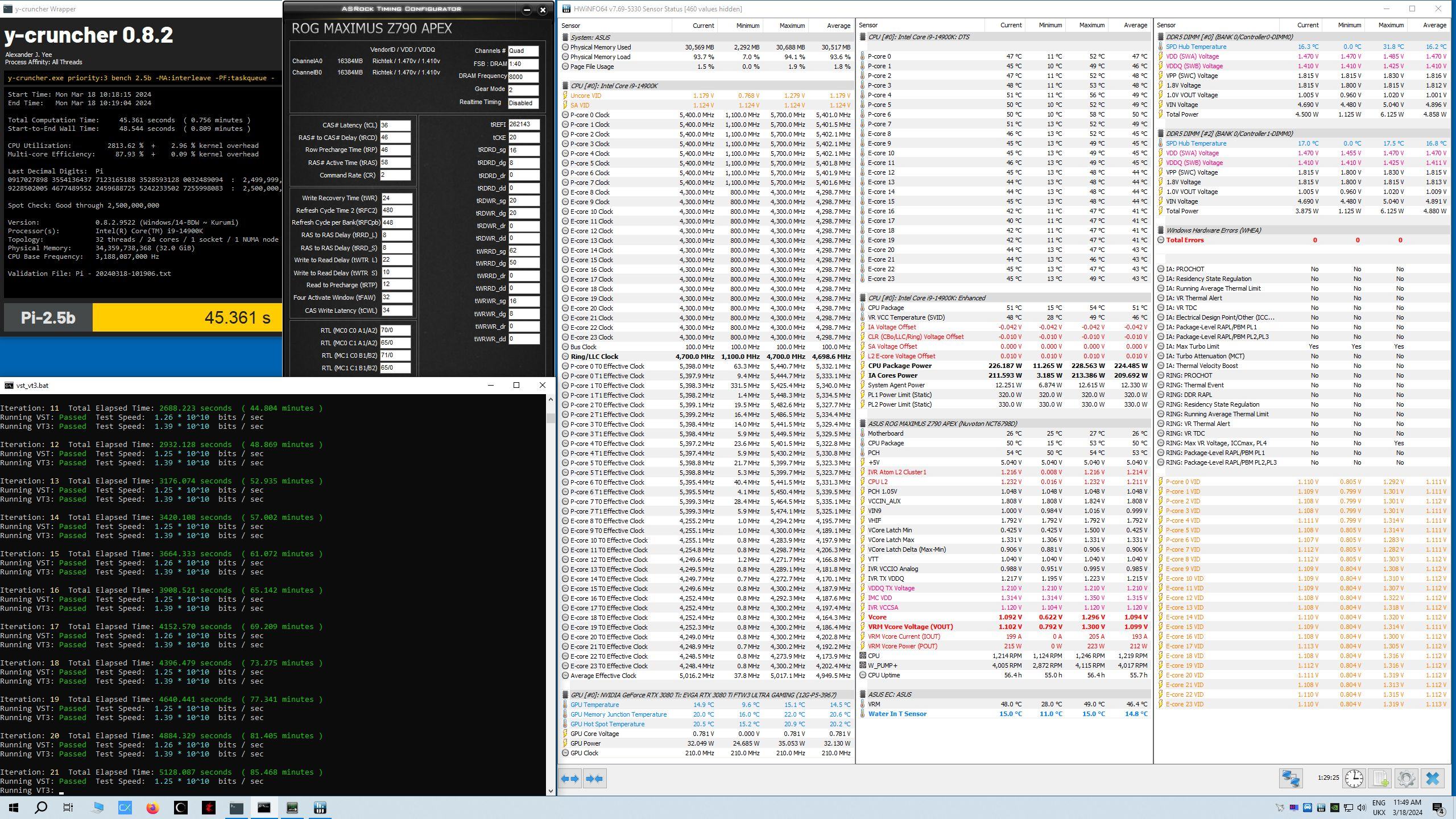

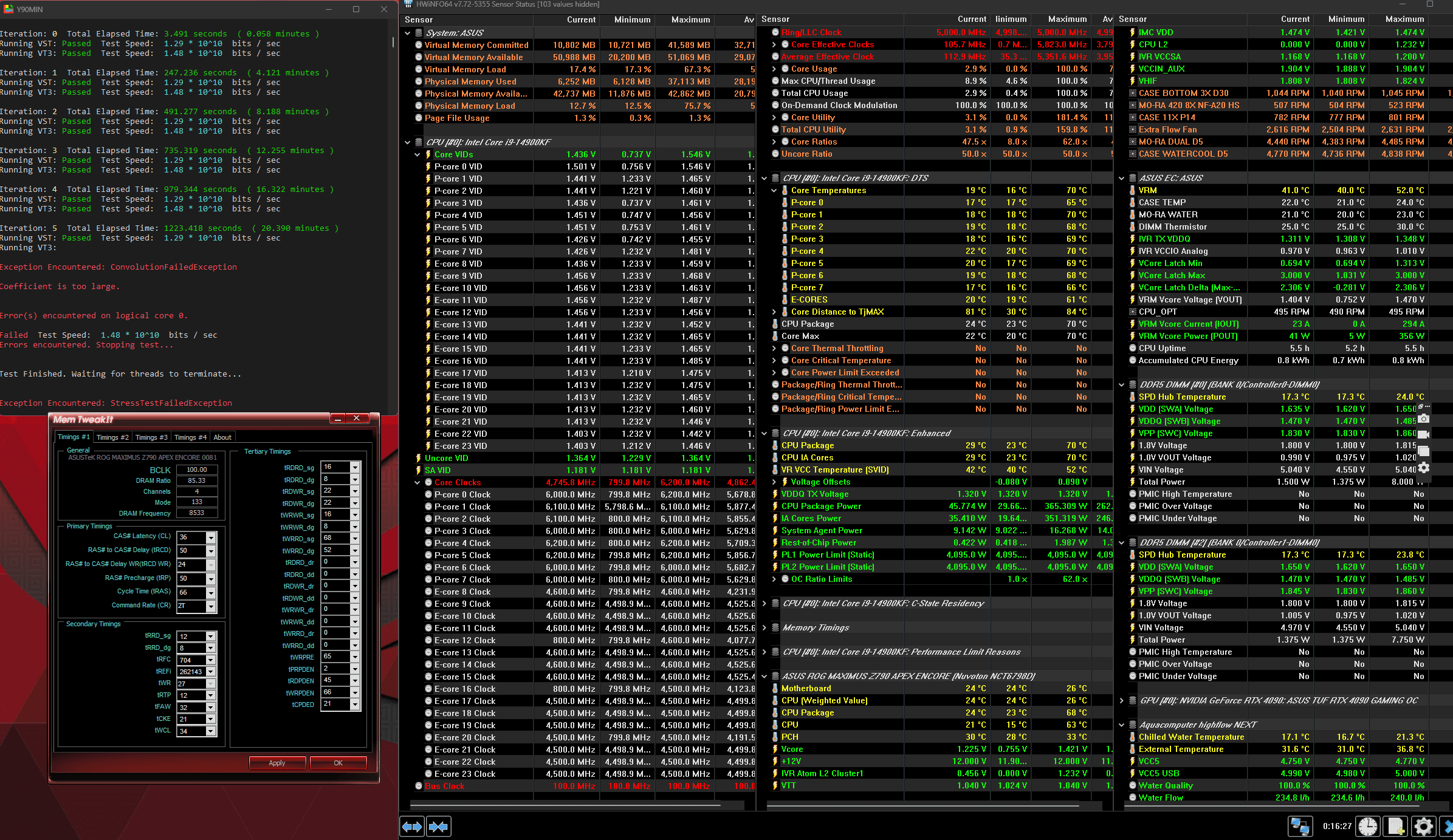

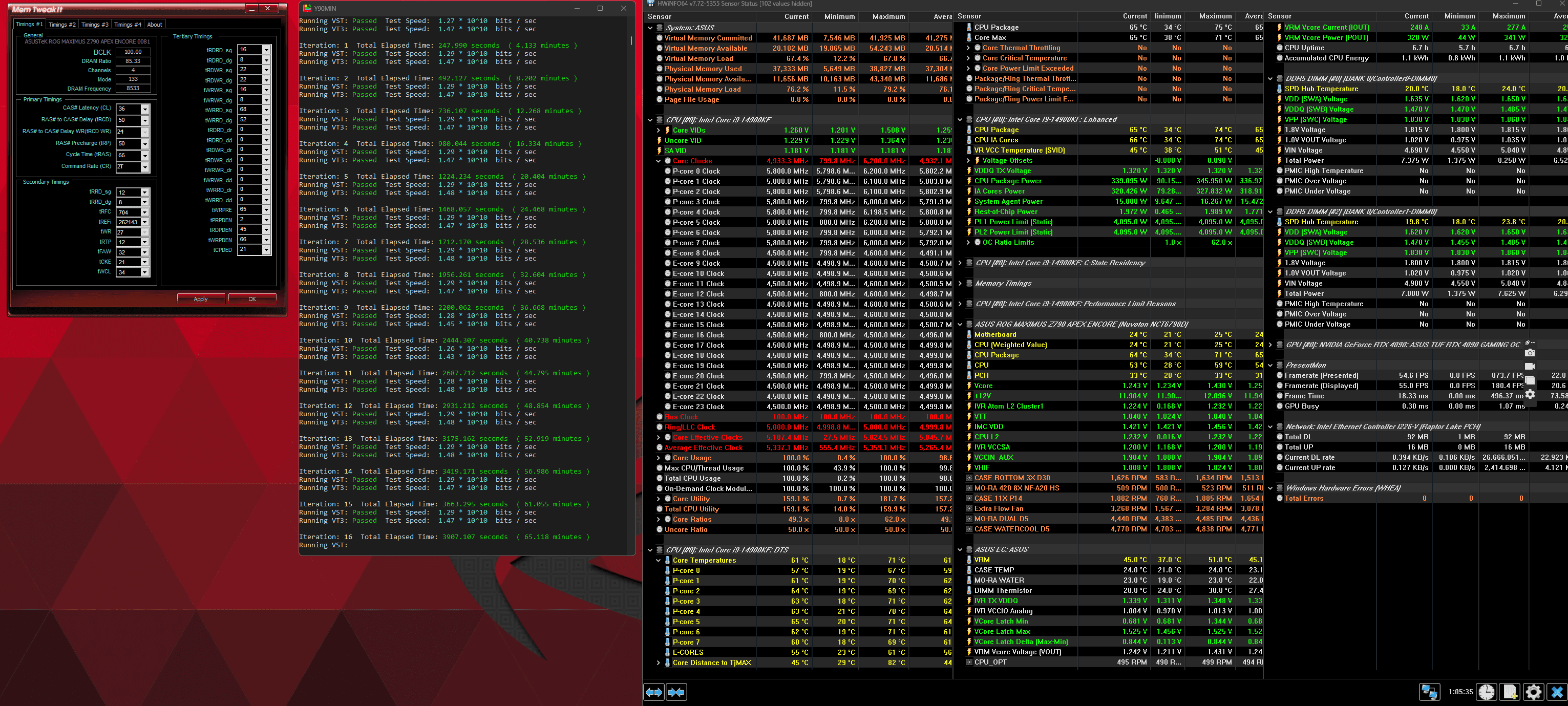

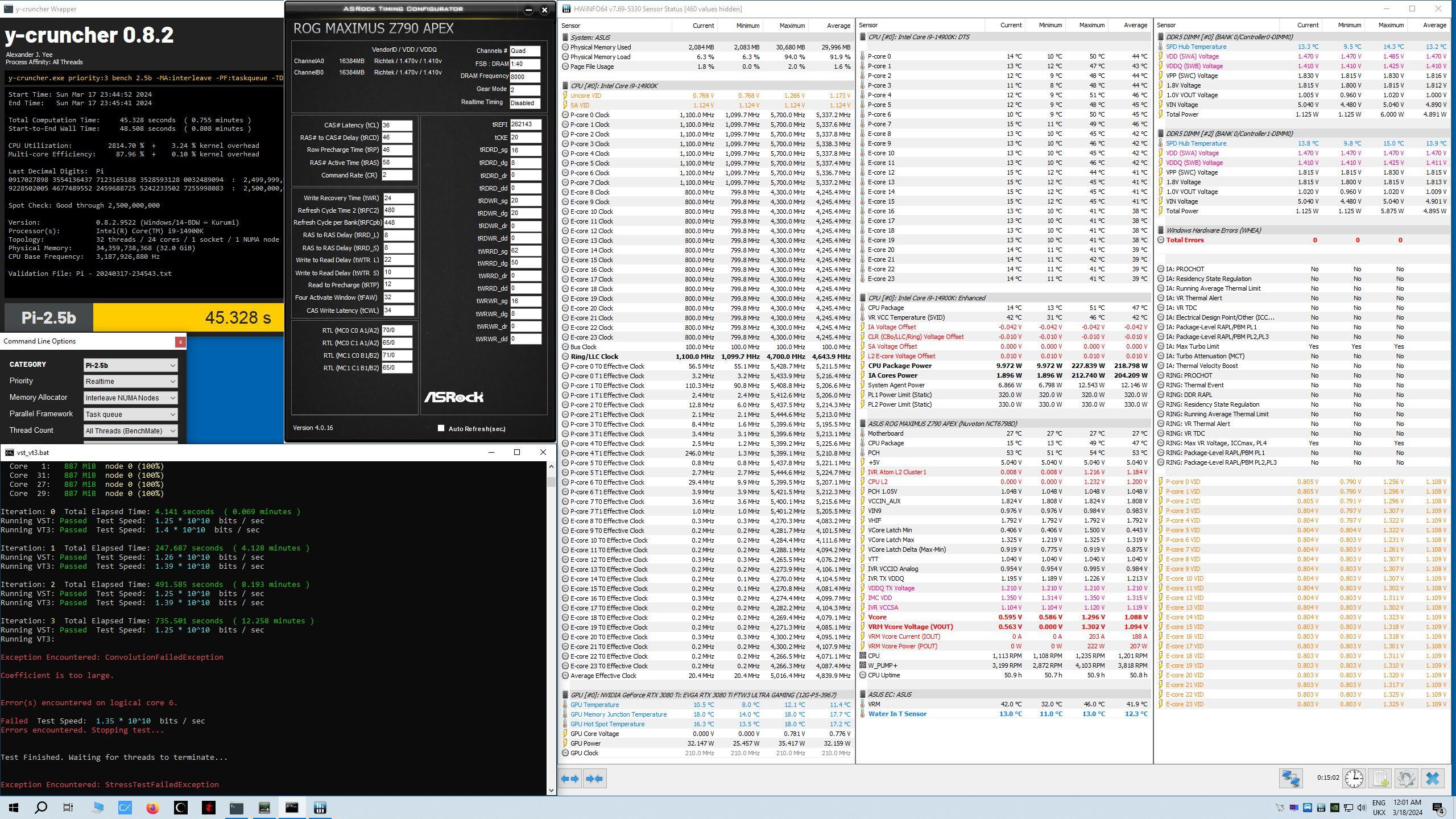

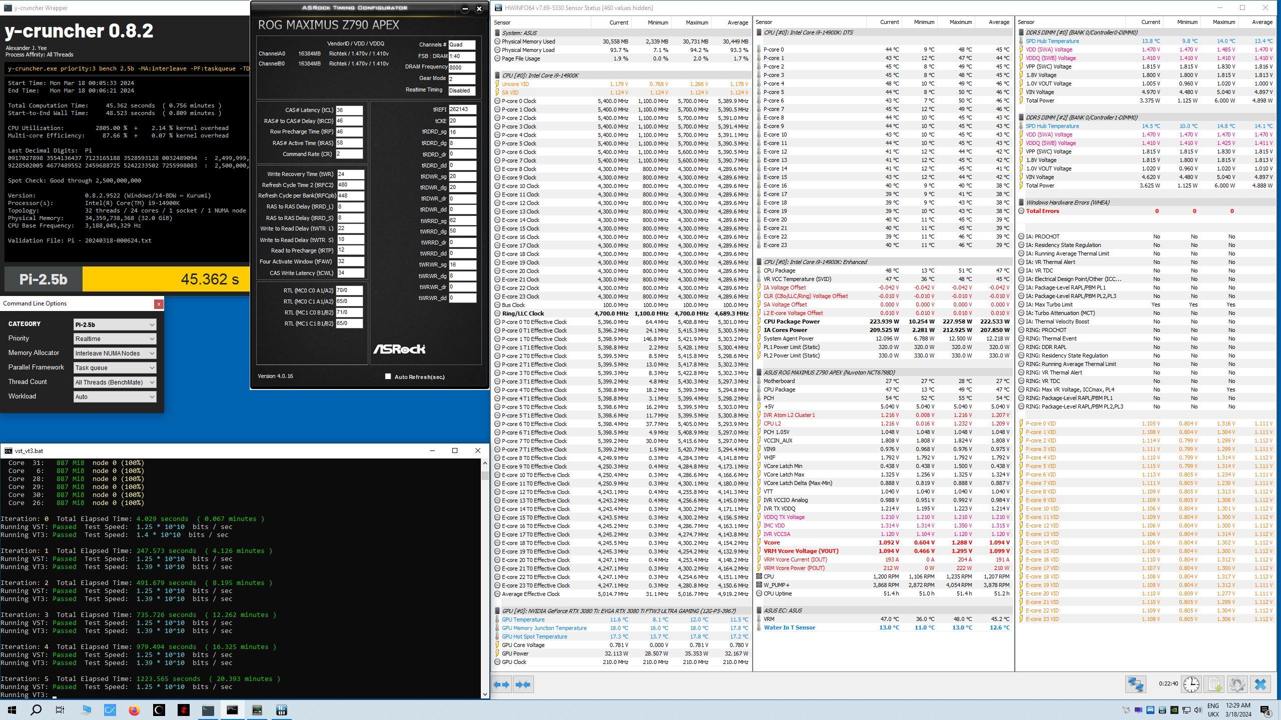

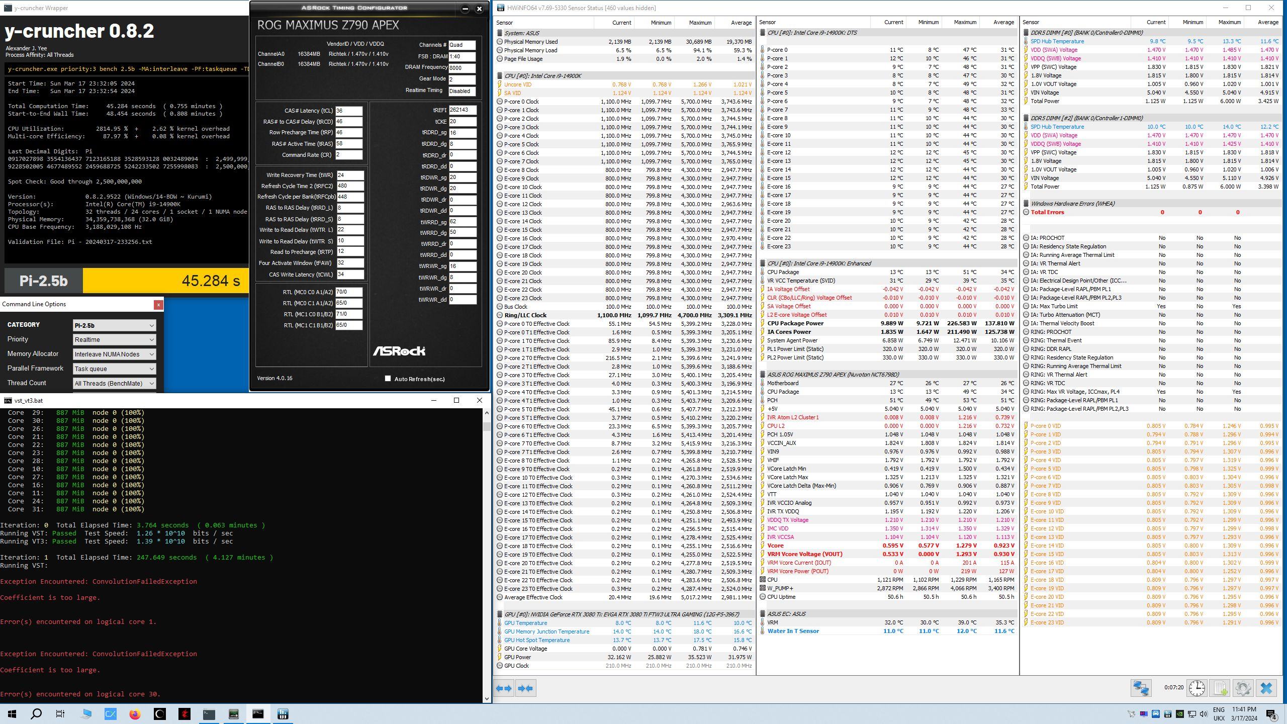

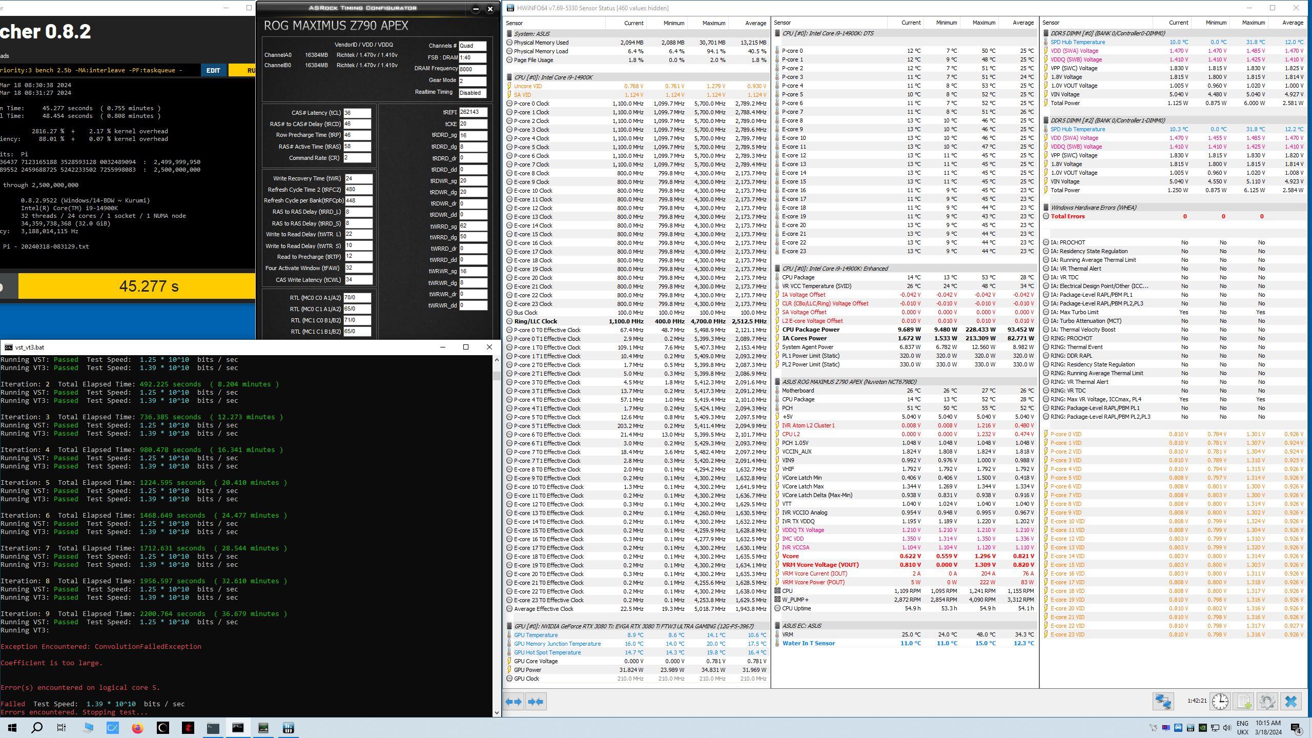

Status Update:
CMDVrefDn:
20=2.5b error
10=2.5b error
30=BSOD
40=2.5b error
50=2x training loop, 2.5b 45.284s VST error 7. minute
60=2.5b 45.328s VT3 error 14. minute
70=2.5b 45.362s 22. minute pass, 1.25/1.39 bits/sec *10^10 ///EDIT: VST error
///Edit: 80= 38 minute later error
50 is very fast, but it makes mistakes.
60 is a little slower, but they also have their faults.
70 seems good, I stopped after 22 minutes.
If it goes like this, I'll have to slowly check it again with a 6 hour run.
There is a small gain, it shows bits/sec, but if I drive at the limit, there will be a chance to make a mistake.
I interpret it as experiencing the "safety reserves".
///Edit:
Back to auto,
I check it on a 90-minute run, so it's good.
Sorry, I can't find this. I have included the new pictures.

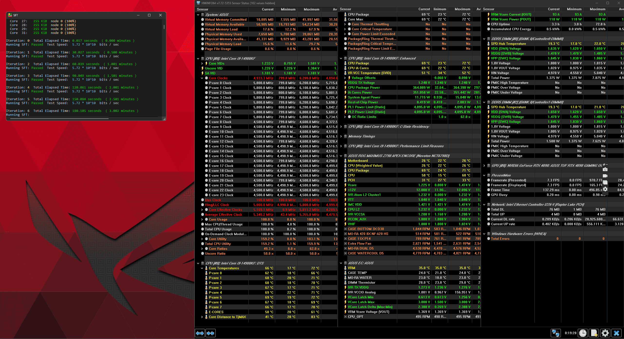

One more thing.
Today I briefly tried running the Y at base frequency to see real, non-downclocked numbers.
The Vcore was low, so it didn't make an error, but simply froze later. It's not interesting, I don't even want to run the cpu at 57x ever.
Numbers look nice on 57xP 44xE 48xR without overclock. OK, 24/7 stay me 54p 43e 47r
Well, I tried, but it seems like they put some protection in the BIOS. I could read it with 0080. There should be some way to read it...
Your VT3 results are very good, the Bitrate at 8000 surprises me. I think I'm at 1.40.. But I see that you have excellent cooling, which is not my case. That changes everything! Have you tuned your VF Curve? 1.3v SVID for 5.7 seems a bit high to me, have you set ACLL 0.6? Because the power draw is excellent.. Very good job

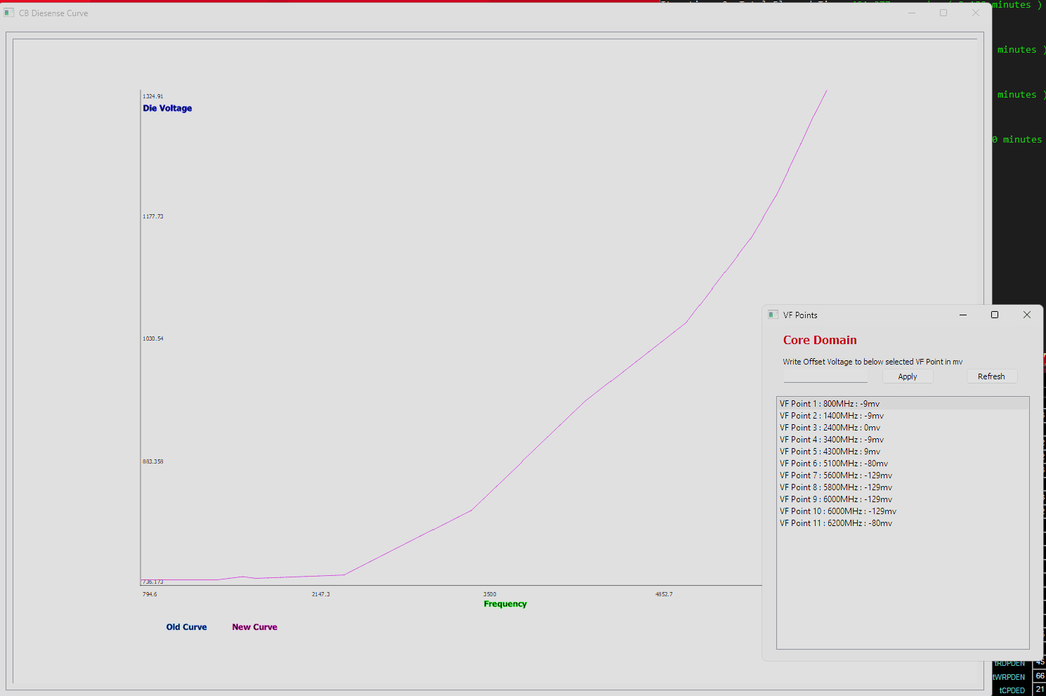

Of course, but I made a special curve, deliberately for this downclocked frequency.
I used deep offsets because I didn't want the AC LL to be very low. Currently, it is not high either, 0.25
5400Mhz ~1.09V load die sense /VT3

So,
habe heute mir mal die Mühe gemacht und den Contactframe runter gehauen und mit dem ILM getestet, da es mir komisch vorkommt dass das Board/cpu nur 7200 stable mitmachen.
Aber auch mit ILM sind nur 7200 Stable drin.
Genommen wurde das XMP Profil der Titanium 8000 mit runtertakten auf 7600->7400->7200.
7800 habe ich gleich übersprungen.
Timing habe bei 7600 vom Corsaor Titanium 7600 genommen, also 36-46-46-46-96-2T Ram Spannung auf 1,4
Ich kan einfach nicht glauben dass das Board bei 7200 dicht machen soll, wenn die 7800 schreiben und der RAM bei 7600 laufen soll.
So,
Wie sind die restlichen Spannungen, SA etc.?
SA liegt bei 1,28, vdd und vddq bei 1,4, vpp 1,8
An den Dimms Temperaturen lags auch nicht, die fehler traten teilweise schon bei 40°C auf.
Versuch doch mal mit 1.1V SA
gerade mit 1,1 sa getestet bei 7600 @c36 - fehler.
V/F curve sichtbar auf deinem Hero ?
Bei "Fehler" immer Daten beilegen worauf sich das bezieht.
Bei "stabil" gilt grundsätzlich das selbe. Bilder beilegen was man genau getestet hat.

Wenn 7200 gerade so stabil ist (wenn überhaupt) wird das 7600 nicht plötzlich.
Der Zwischenschritt ist 7400MT/s
Viel Glück
