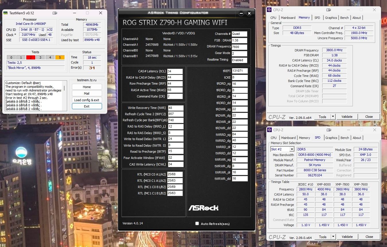

Is it possible to test only one of them at a time and leave the others on auto, or should I change all of them together?
Unfortunately no, haha
Auto training = read user value, remain to lookup table, if non try to train
Disable training = enforce user value and if non , check lookup table. If non, fail boot
Enabled training = override lookup table, train new values which may or may not be good ~ up to cpu stability.
WR, NOM, PARK go together
PARK & PARK DQS go together
Sadly no~~
You can "just" change NOM & PARK together and leave WR be
But if WR changes, PARK and NOM scale will change. Their effectiveness too
Change on PARK & NOM go hand in hand with RRD & WTR.
Absolutely zero solo value exists anywhere in memory. Often its just a pair. Sometimes a tripple.
VID-SA, IVR VDD2, IVR VDDQ is a trio. NOM WR PARK is a trio. RFC XSR REFI + CPDED, CKE, XP both are trios.
RCD RTP are a duo, RC RP + VPP_MEM VDD_MEM are a duo. RAS CAS CWL are a trio.
WR WTRS/L are a trio. Aaand so on.
Its bad to only change one value and track for change. Side issue vs main issue.
But RTT testing is easy with TM5 :)
First check current TM5 progress on 8600 before we create more rabbit holes.
Cycles you always want 25. 1usmus_v3 is not a normal discharge test like HCI/Karhu or anta's config.

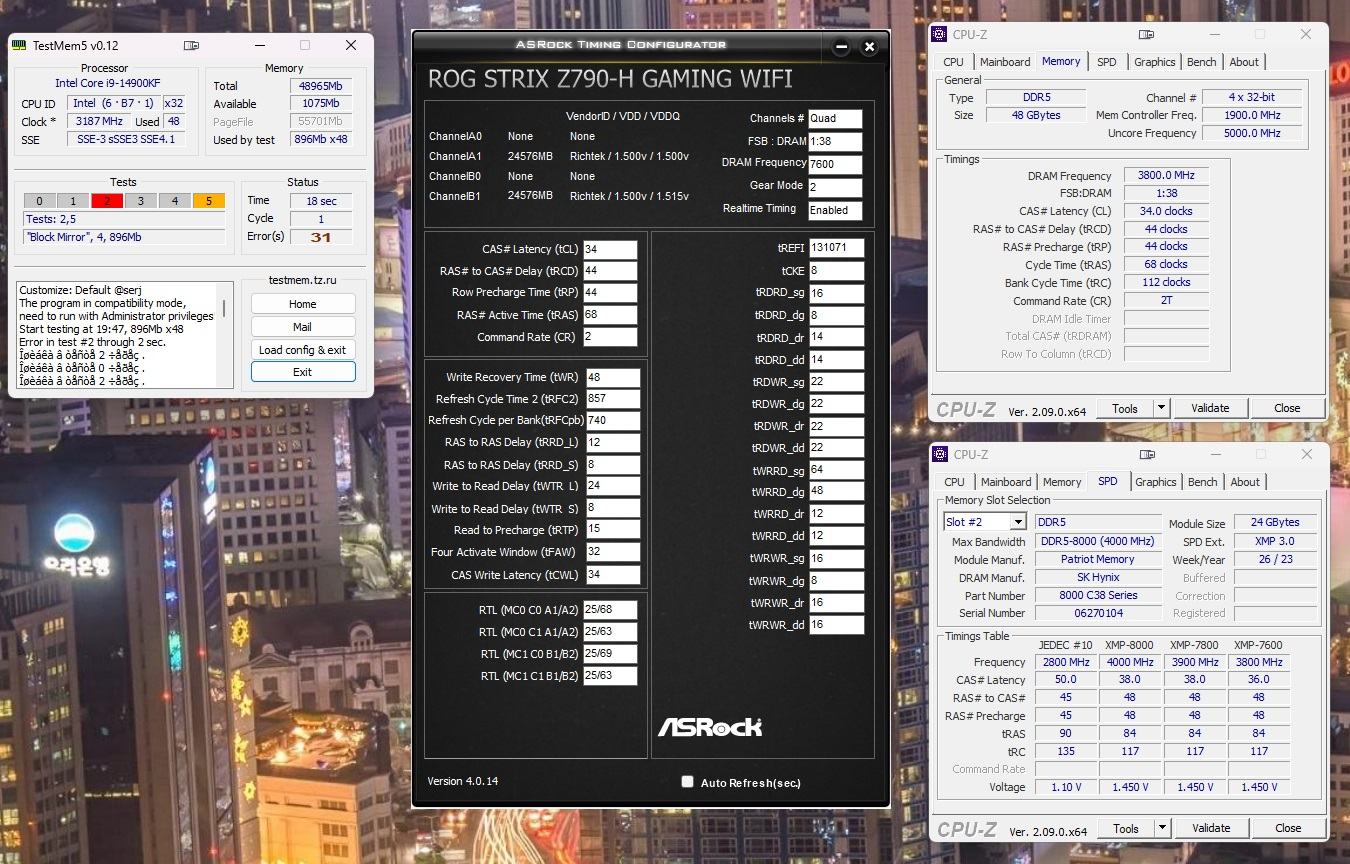

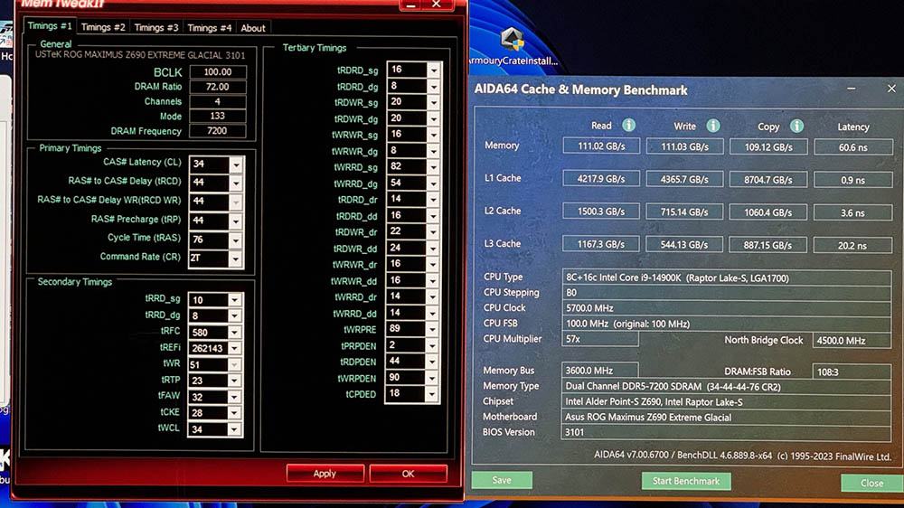

Kleiner Zwischenstand - Zum testen habe ich mal folgende Module hier:
G.Skill Trident Z5 RGB weiß DIMM Kit 96GB, DDR5-6400, CL32-39-39-102 1,35v
F5-6400J3239F48GX2-TZ5RW
(Damit erreiche ich nur 6800 MT/s mit sehr gelockerten Timings, danach ist es für mich nicht mehr stabil zu bekommen.
Corsair Dominator Titanium 96GB Kit DDR5-6600 CL 32-39-39-76 1,4v
CMP96GX5M2B6600C32W
(Diese Riegel skalieren sehr schlecht mit der Voltage. Bei default 1.4v waren Sie am stabilsten. Auch hier 6800 egal welche Timings, danach ist Schluss.)
G.Skill Trident Z5 RGB 48GB Kit DDR5-8000 CL40 1,35v
8000J4048F24GX2-TZ5RS
(Diese Riegel habe ich auf 7200 MT/s 34-41-41-41-30 karhu 2000% stabil bekommen. Mehr MT/s bootet zwar, ist aber nicht mehr stabil. Eventuell hat einer einen Tipp wie da noch mehr drin ist. Siehe Anhang)
Wenn ich das jetzt richtig betrachte, ist das Board und die CPU in der Lage mindestens 7200 MT/s zu fahren oder eventuell mehr mit 48GB? Mir scheint es so, dass es sich schwerer oc lässt mit 96GB Ram. Ist das wirklich so? Bin in dieser Sache noch nicht Erfahren genug um das zu beurteilen, aber schwer motiviert das maximum mit meiner HW zu erreichen :)
CMP96GX5M2B6600C32W
Mit dem Z690 haste schon Luck, dass du 7200 soweit Karhu hinbringst. Z790 ist da anders mit 2x24GB. Mit 2x48Gb bist ebenfalls bei 7200 ziemlich am Ende bei Z790. Das ist schon lange bekannt dass 7000MHZ +/- 200 das max ist, was OC machbar ist bei Z690. Einzelne 2Dimm Boards machen bei 2x16Gb gegen 8000, aber das sind wenige.
2DPC ~ 7600MT/s +/- 400MT/s
1DPC ~ 8000MT/s +/- 400MT/s
Z690 usually 2DPC 7400MT/s, 1DPC 7800
Boards and bioses got quite a bit better since last year
Soo 2DPC 7600-7800
1DPC 8200-8400 is reasonable
Actually its rather 1DPC ~10000MT/s G4 or 9600 dual slot
But i guess CPU arch hinders.
Z690 APEX ~ 7400-7600 stable, 8200 peak (dual)
Z690 Unify-X ~ 7800-8000MT/s stable
Z790i Edge ~ 7800-8200MT/s
B760M EliteX (2DPC) ~ 7400-8200MT/s stable
more on CPU luck & OCer, vs Board.

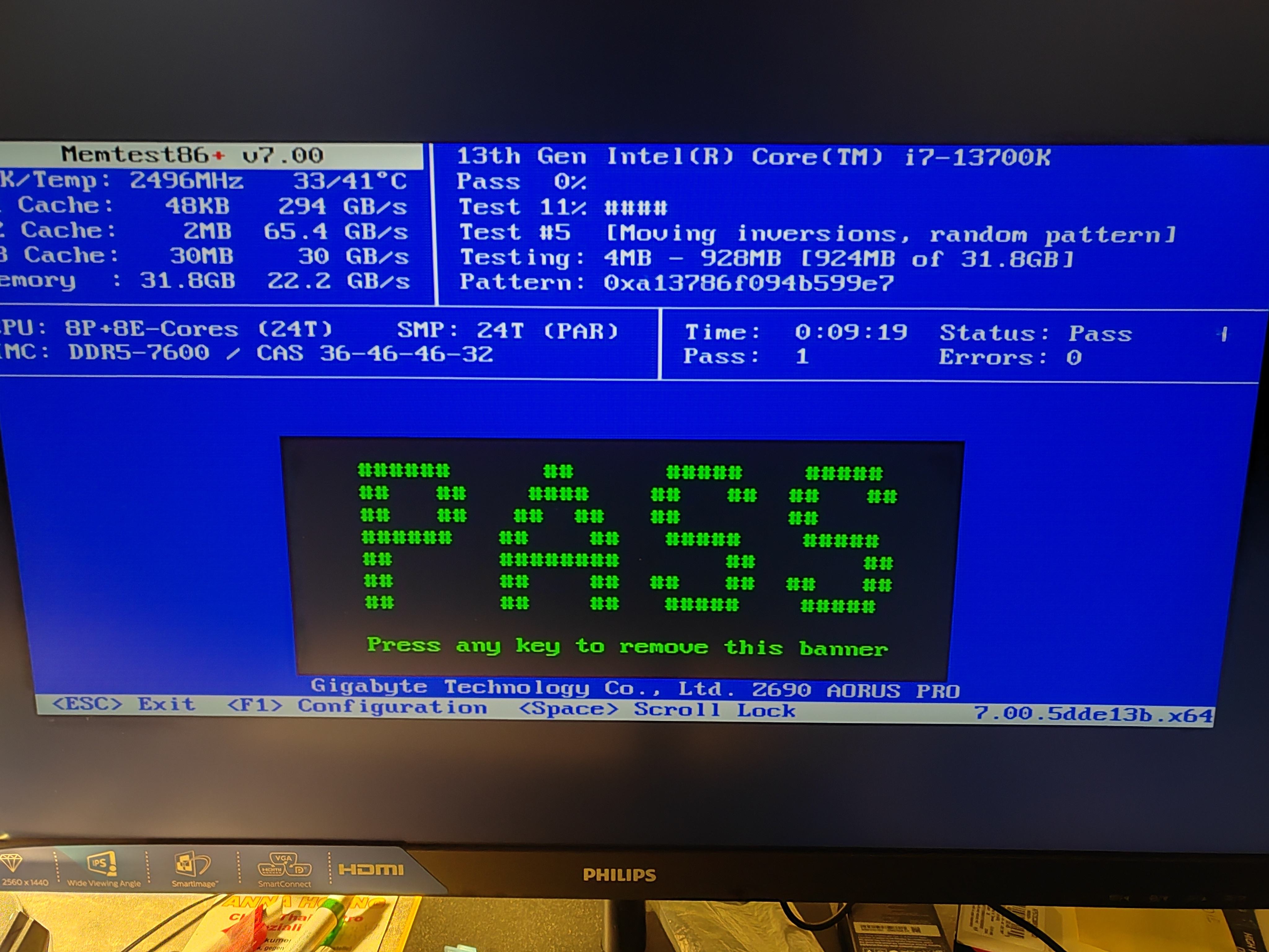

0% size , pass :(
Memtest braucht ~ 8-9h bis es die komplette Größe testet.
Bank 1 / 8192. 0% pass
Gutes tool aber nur über die Nacht hinweg.
hmm... dann wurde ich angeschwindelt! Skandalös!!
Mach mal Karhu und TM5 und schau mal was rum kommt. Mein Setting krieg ich auch durch mem86 mit 7400...das ist kein Test auf Echtzeitstabilität.
Und anschwindeln? Was soll diese Unterstellung?

Jetzt muss ich mich entscheiden zwischen 7200 MT/s (48GB) mit 34-41-41-41-30 oder mit Glück 6600-6800 MT/s (96GB) mit 32-39-39-76. Wozu würdet Ihr tendieren? Ram kann man nie genug haben.
Das habe ich mir schon fast gedacht. Hatte noch ein funken Hoffnung, dass es an meinen skills liegt :)
Für normalen Gebrauch, wie Gaming usw. reichen dir 2x24Gb.
Wenn man sich an @Veii Ausführungen hängt, dann liegt evtl. nochmals 100-200MHZ drinn. Mit den unseren gängigen Skills steht man durchaus dort an, wo du und ich hängen. Ich habe schon viel gelernt durch ihn und so einiges anpassen können, was die Subs und RTLs anbelangt, aber ich hatte noch nicht die Zeit, mich mit mehr MTs zu beschäftigen, da Familie und so nicht mehr zulässt im Moment
unterscheiden sich 2x16gb und 2x24gb im oc groß ? mir kommt es so vor als würde ich mit den 2x24gb mehr probleme haben als mit den 2x16gb modulen. meinte das ab 7600mhz aufwärts.
überlege ob ich doch nen anderes board nehme als das strix-h. muss es umbedingt nen apex sein oder geht auch das hero oder so?
Im Spannungs-Style , ja (VDDQ_CPU ist anders)
RRDL muss auf 12 bei 24gb modulen
WTRL dann auf 24 natürlich
Das wars dann auch schon
RTTs werden von den Boardherstellern getuned und der Rest von dem BoardBios :)
  • TM5_0.12.3_1usmus25-CoolCMD.zip
Medium-High leaky sample.
8200 probably around 1.15 to 8400 around 1.18 SA
8200MT7s probably near 1.39-1.4v VDD2_CPU & 8400 near 1.44-1.46v.
Should be plenty before you reach first wall
Ich geh mal davon aus, dass es sich nicht um Schuhe oder ein Küchengerät handelt. Wenn man jetzt noch annimmt, dass nicht jeder weiß, was jetzt damit gemeint ist, könnte man vielleicht etwas spezifischer sein, was hier gewollt ist.
Mir sind ein paar Benchmarks oder Stabilitätstest geläufig, aber bei manchen von diesen würde mir die Wohnung abbrennen. Ich kenne aber bei Weitem nicht alle dieser Programme.
Hier sei nochmal erwähnt, dass ich mich erst seit vergangenem November, also weniger als vier ganze Monate damit befasse.
Wieder einmal ein schönes Beispiel von eindeutig missverstandenem. Ich habe gesagt, dass ich angeschwindelt wurde und auch nur mich damit gemeint. So wie es da steht.
Ok, das kam der Wortwahl geschuldet etwas direkt rüber. Kein Problem, ist ja jetzt aufgeklärt🤗.
Wegen diesen Stabiltätstestprogramme: TM5 von @Veii runterladen, entpacken und dann mit Adminrechten starten. Wenn Errors, hier melden, er wird dir garantiert sagen können, wo du dann ansetzen könntest. Karhu kostet 10Euro die Lizenz. Ist glaube ich im Startpost verlinkt, soviel ich weiss.
