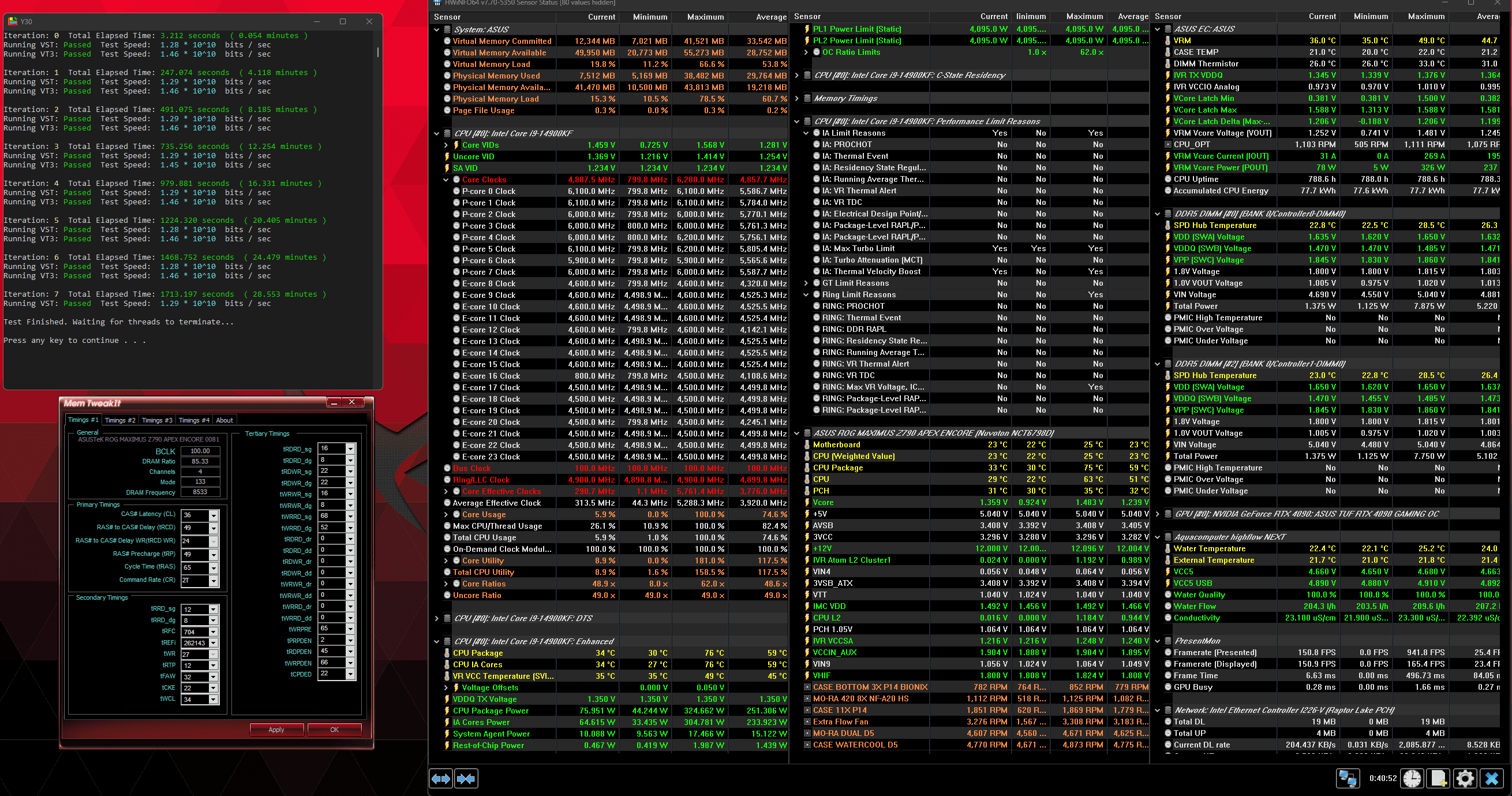

Sorry I did just a small typo - LLC3 while SVID Trained set auto values to AC 0.54, DC 1.1
Here is my V/F:
VDDQ d.h. IVR habe ich 1410mv, 1380mv versucht.
VDD2 d.h. IMC Voltage war auto, war aber 1.35, daher sollte es ja stimmen. Werde es aber fixen.
Was meinst du mit PSU aus? Die Änderungen sind ja ja nicht gross oder was bedeutet gross für dich?
MRC Fastboot ist aus.
Limits habe ich auf 253W gesetzt, zur Sicherheit bei ycruncher. Könnte das der Grund sein?

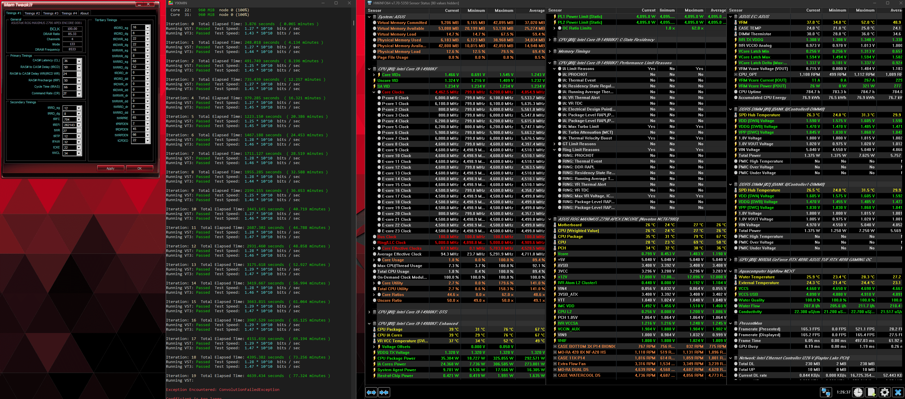

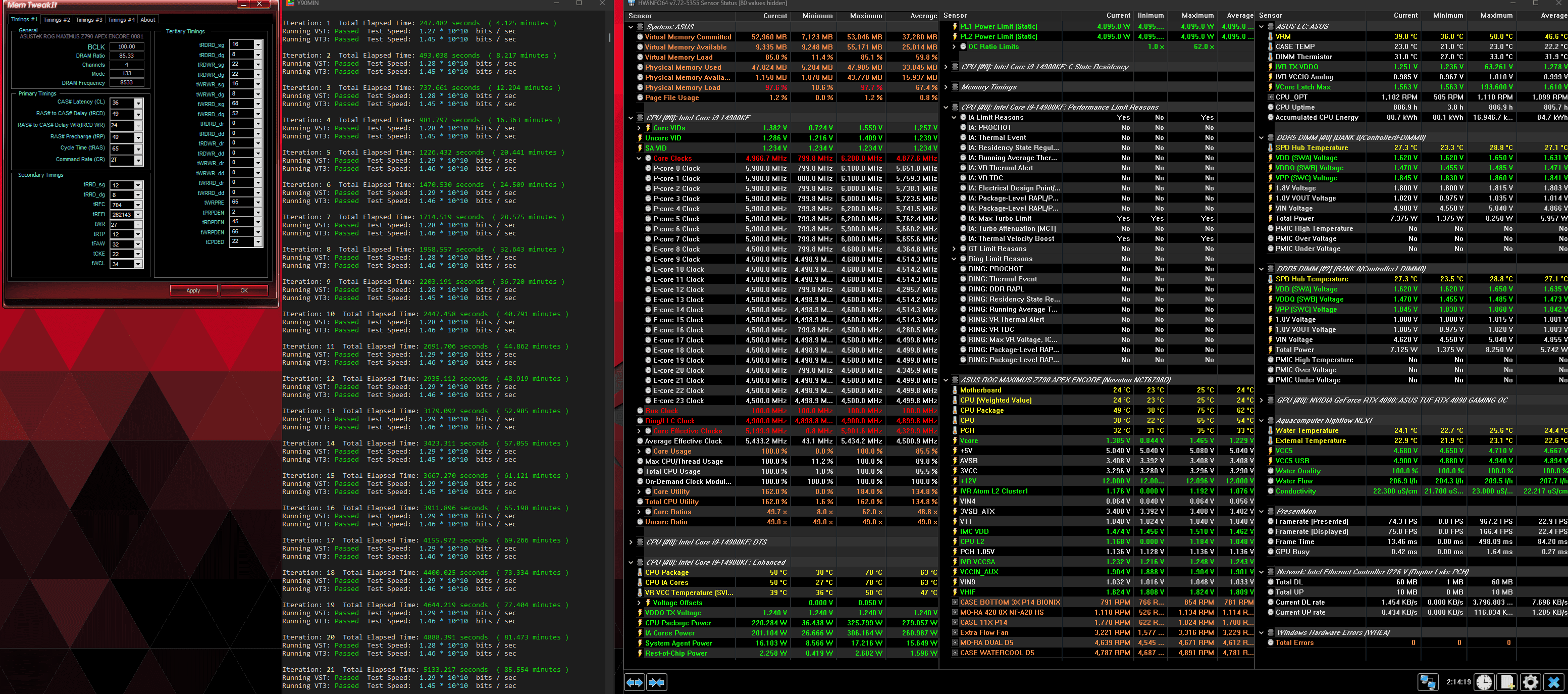

I thought maybe I can make an experiment with a 8533C36 profile and the RON's on 48/48-48/48 what I used for 8600 profile.
Decided to let the water heat up.
Look at the bitrates how they are raised by the time. It errored at 19th iteration but it's still very interesting, as it becomes warmer and warmer the bitrates were growing.
Is the RON's heat based too?
@Veii
Good Morning.:)

Good timezone :)
I think that's pure coincidence and maybe two factors
~ cores V/F was too droopy, higher heat == lower TVB caused better stability
~ VDDQ was a bit too high by 5mV, and bit of heat messed with it. Soo it got more stable
Guardbands ~ thermal or voltage focused do not improve by thermals

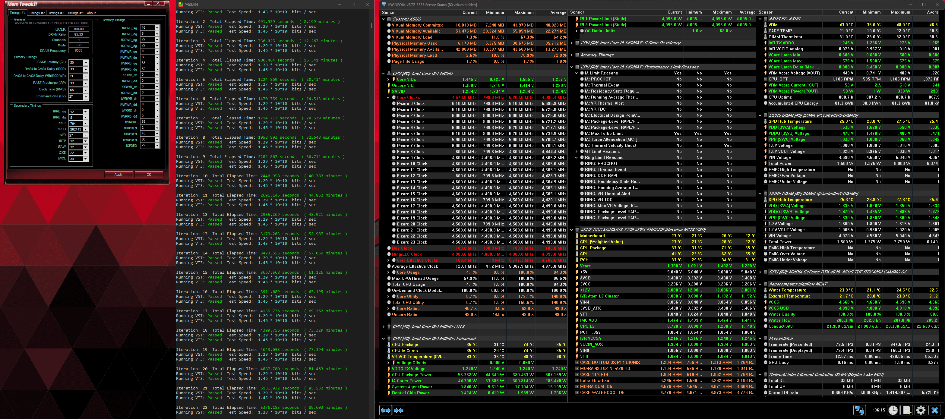

To my eyes this looks like there is still room left to improve on bandwidth and it just happened to get better when losses increased.
You do have quite some throttle on IVR & SA-VID.
Its odd.
Ring hits max voltage, but without biosmod you can not do much.
I still have not gotten an "ok" to share it.
RONs just are wrong by the looks of it
Neither VDDQ nor RONs change by clock.
RONs are just wrong by the looks of it
That's why I thought to try a profile with lower mem speed. To find how it works on this particular config.
So RON and VDDQ's could be constant through all speeds.
I believe my best VDDQ pair is 1.32-1.35V for CPU and 1.47V for RAM. This gave me always the most stable result on each frequency. (On 8400C38 1.435V is enough)
I think I need to revise the voltage set for different RON's.
I don't know how can it be stable with that crazy setting.
But it's not reboot stable.
Now running 48/48-40-40 as you suggested before.
How the CPU_VDDQ should move if I change the RON? Lower resistance need more Voltage on TX side?
Raw delta is what matters.
Training off has playroom of 15mV max. Mostly can fail by 5mV missmatch if you run it at the edge.
CPU Side:
RON = X * VDDQ
DQ_VFREF = X% * VDDQ
CA/CS_VREF = X% * VDDQ
CTL0 DQ VREF = (distance & height) Position of Pull_UP & Pull_Down ~ on build DQ_VREF
CTL0 Rodt?Vodt Vref = Sample Leakage, SA factor, PLL factor ~ build Vref , i think! based on sample resistance.
Mem side:
RTTs for DQ & DQS
Groups for same DQ (CK, CA, CS)
Any case, this stays valid 😊
I would not recommend to start with defined RON, because Board (FW engineer) has to know the correct ones.
It is ok to sample them on already set VDDQ foundation, because of how important VDDQ itself is for everything.
But i would not go this way around. Especially without access to MR10-MR12. The field where VREF is created.
In order to mess with this part, you need to understand all other fields.
I don't recommend, but this sounds selfish.
I recommend trusting the board more now
And trusting your delta more too.
If Board or CPU has one weaker channel (common) its ok to tune
But this is a much later step.
Use a weaker RON for stronger MC channel.
Use a stronger RON for weaker MC channel.
If you remember which of both subchannels on 2nd channel failed. Give it a stronger signal
Pull Up is targeting "common signal", signal foundation.
If signal was too weak for mc channel, either Pull-Down needs to be stronger, or pull Up needs to be weaker (one of both)
This is interesting but for another day.
Likely correct is 48-40 && 34-40 or 40-34.
I remember this worked for Z690 Boards and white apex ~ but they had weak Channel A
Rest was MC (CPU) focused.

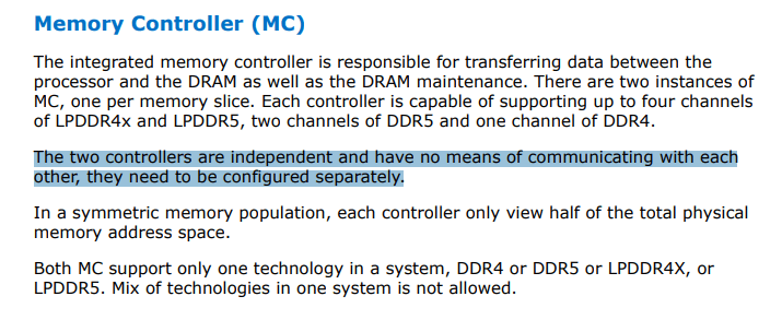

Result to show MC to MC communication was a coincidence. Its been verified with 6 hour runs.
I expect Encore to run 48ohm , because PCB is good. Its not similar to both APEX's.
But it has weaker 2nd Channel (funnily) - many encore by the looks.
Encore also seems to fail on fully automatic mode, but scales good on tuned manual mode.
If user maximizes and targets correct VDDQ then board begins to work. Unfortunately its not how it comes on stock.
Idk RONs for it. No way around testing hours on hours without messing with your found VDDQ.
One should not touch them, unless its MC-Link issue and not whole channel issue.

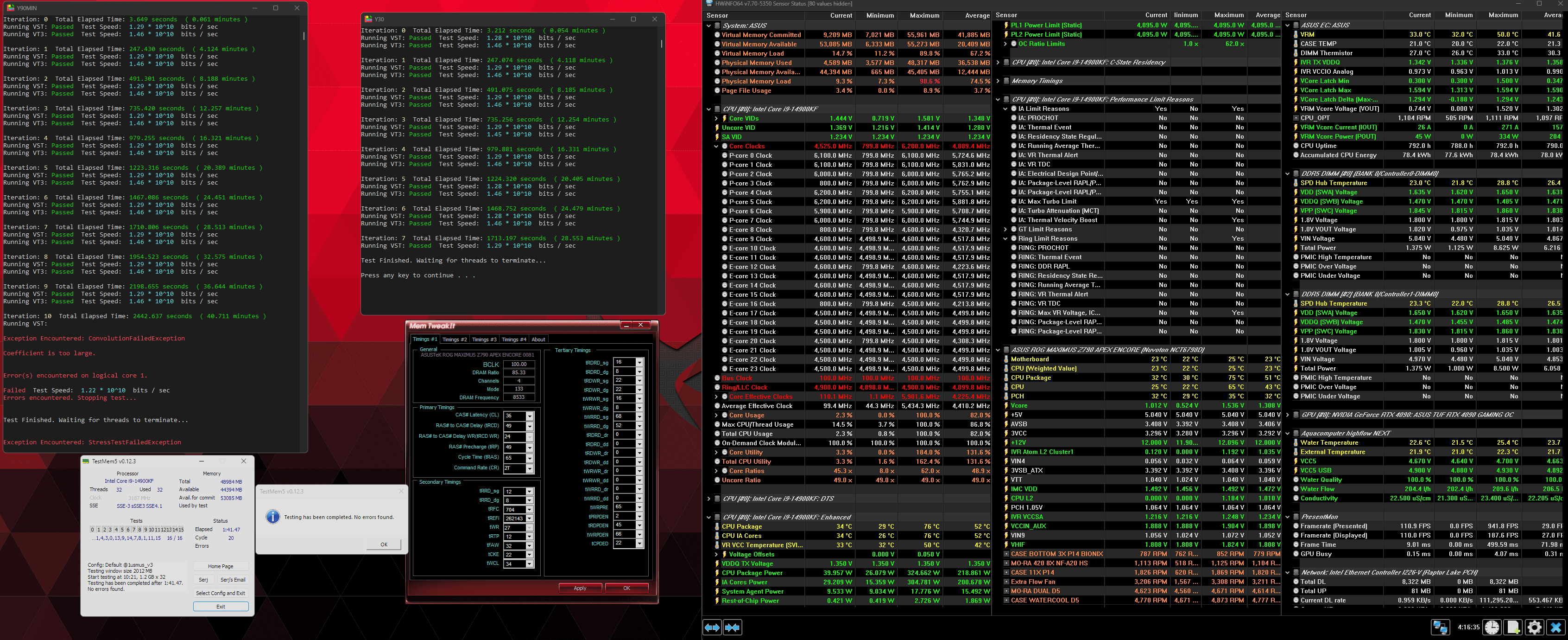

@tibcsi0407 opposite testing
Figure out absolute max delta (not PPT or Thermal limited)
Lower clock and higher clock
User higher clock to figure out one and only RON preset
Later once one and only RON preset is correct, downclock and finetune VDDQ again a bit and SA a bit
Then you can go back to scaling up and things should work. Last variable then is Groups and RTTs per channel.
Don't adapt VDDQ to RON, without knowing which RON is fully fine. And if two values work, then increase clock till one value only is correct.
// see proof-of-concept post #13.256. There is no need to scale VDDQ with clock :)
We can see that RON is fully not fine on 8533 example. Its not VDDQ that needs to change, but RON that needs to change.
Later later you can play with margins of 5mV (out of 15mV) to see which VDDQ really is perfect and only then find good RTTs to allow more margins
Reverse is asking for problems due to confusion.
VDDQ has to be perfect for the rest to work well. Everything builds on it.
Only later later you can target to slim delta. When signal is too noisy on high clock.
But not with soo many things on Auto.

Now running on 48-40 / 34-40, seems promising.
I will post the results. Wanna run a TM5 too because I got freeze again at 47. Minutes.
WIP: (bitrates are high and constant)
For bonus I tightened the primaries a little and upped VDD_MEM. Will see if it is okay.
Thank you! This is so good write up, it's bookmarked.😊

I know, just wanted to pretest before TM5. Started the 90 min test too, hope it will pass.
Then it would be 120 min total. (If pass)
Update.
Second test died in 40 minutes.
I have no idea where to go further. :)
@Veii
Bitrates didn't even drop, not sure if it's the RON, or something else.
Could be the VDDQ too.
What do you think?
SA: 1.23V
VDD2: 1.518V
VDD_MEM: 1.62V
VDDQ_MEM: 1.47V
VDDQ_CPU: 1.35V
Maybe I should change the VDDQ_CPU before touching the RON's again.

We do likely again too many things at once
It is likely the fault of strange slopes on strange multiplier strap.
Two options
You auto RON & RON Training.
And get 150mV delta stable, +/- 5-10mV.
You drop to 8400. Force CTL0 which is based on VDDQ
Let it train
Psu off, then instead 1.33 VDDQ_CPU
You change to 1.32 VDDQ_CPU.
Get that 2-3 hour stable and only then change RON
Psu off again, discharge board, psu on, and 2-3 hours repeat.
If fail the usual, no change on RON
Isolate which channel till error, isolate which subchannel
On those, psu off.
We want full non persistent training
What if I force the 8600 CTL0 on this one?
This profile is badass. Very fast, much faster than a 8600C38. Maybe I could even tighten the tRFC a little.
Or maybe I can try the 8600 with these Voltages and timings. Huge in mem delta, I like it. 😊

Hello @Veii
Progress:
First I kept the 48-40 40-34 setting and tought maybe I should try some huge VDDQ delta.
The bit rates were these: (slow and not constant) Tought maybe it's due to the stronger RON'S with weak MC Voltages.
Then I changed the RON to 40-48 there.
And the results here. (second picture is a PSU off then retrain)
So now I have huge in-mem delta, huge VDDQ delta and works like charm.
I will use this as a base for my 8600.
VDDQ_CPU:1.24V
VDDQ_MEM: 1.47V
VDD_MEM: 1.63V
VDD2: 1.518V
SA: 1.23V
Seems both my MC links are strong. That's why the higher TX caused trouble for me.

Soo we stay at 48-40-40-48 or 48-40-48-40 ?

Couldn't find this out without your help. I played a lot with the TX and started getting better and better as I lowered it under 1.27V.
Then on 1.24V it was stable but slow, that's where I thought you told me about the bitrates and RON's. That made me think to try it again.
It's 48-40-40-48, could be a good base for 8600 too, also the low VDDQ_CPU.
This took me some days to find out, but hey, it seems promising.
One shot from an amateur 🙃
Haha, ya typical "falling to rabbit hole of side issues" ~ issue :d
Soo if its that way then
40-34-34-40 can equally work
but i am a bit uncertain on delta
This is like , a lot ...
16gb "prediction" of before is spot on too (its 165 mV)
But 230mV on 24gb is quite a bit.
Guess its alright
Good to see stability on delta inside mem
but keep that one in mind as variable
Over 105mV you may face RTT issues with unclean power
Up to 300mV is allowed based on PMIC design. Up to 200 is what many kits can do and asus called "default max"

Yes, it surprised me too.
I will retest a few days later as a double check, but seems okay to me.
On 8600 I will have much smaller in mem deLTA, but VDDQ delta probably remain the same.
