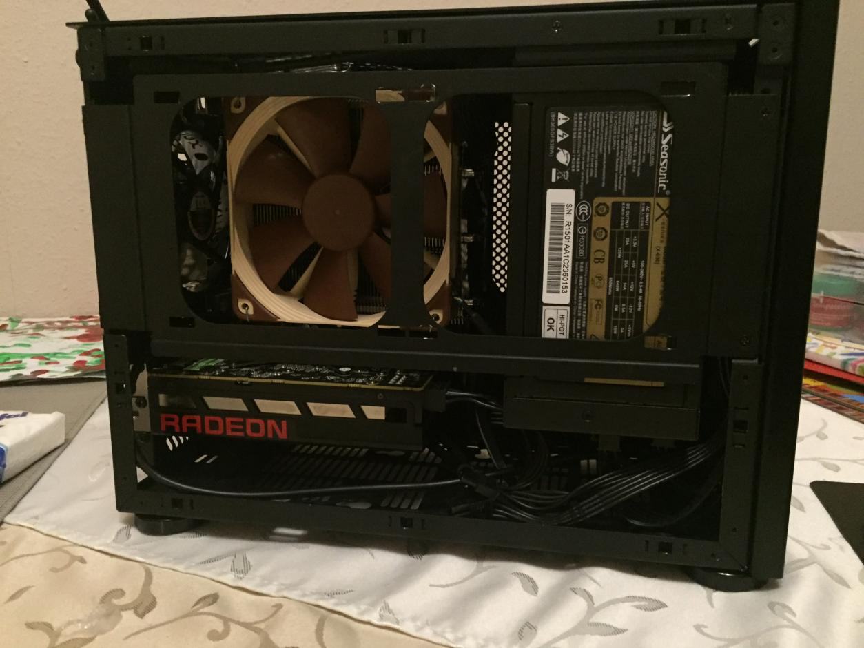

Wie lang darf eine ATX PSU maximal sein, wenn man lange GPUs (980Ti) einsetzen will?
Ok, dachte mal gelesen zu haben, dass kurze ATX auch passen - Danke!
Von der HP:
•ATX PSU support is possible using the included bracket with the following limitations: ◦Cannot be used with GPUs over 195mm long.
◦Cannot be used with the dual 3.5" HDD cage or 240mm radiator mounted to the side bracket (120mm radiator is still possible over the motherboard area)
◦Maximum recommended length: 160mm
◦The AC inlet orientation on some ATX power supplies may prevent the angle plug from fitting, please check carefully. See this image. Note: the included AC cable has been changed from right-angle to left-angle for v2 and later.
D.H. eine max. 160mm lange ATX PSU wäre mit der R9 Nano machbar?
Ist ja nicht wild.
