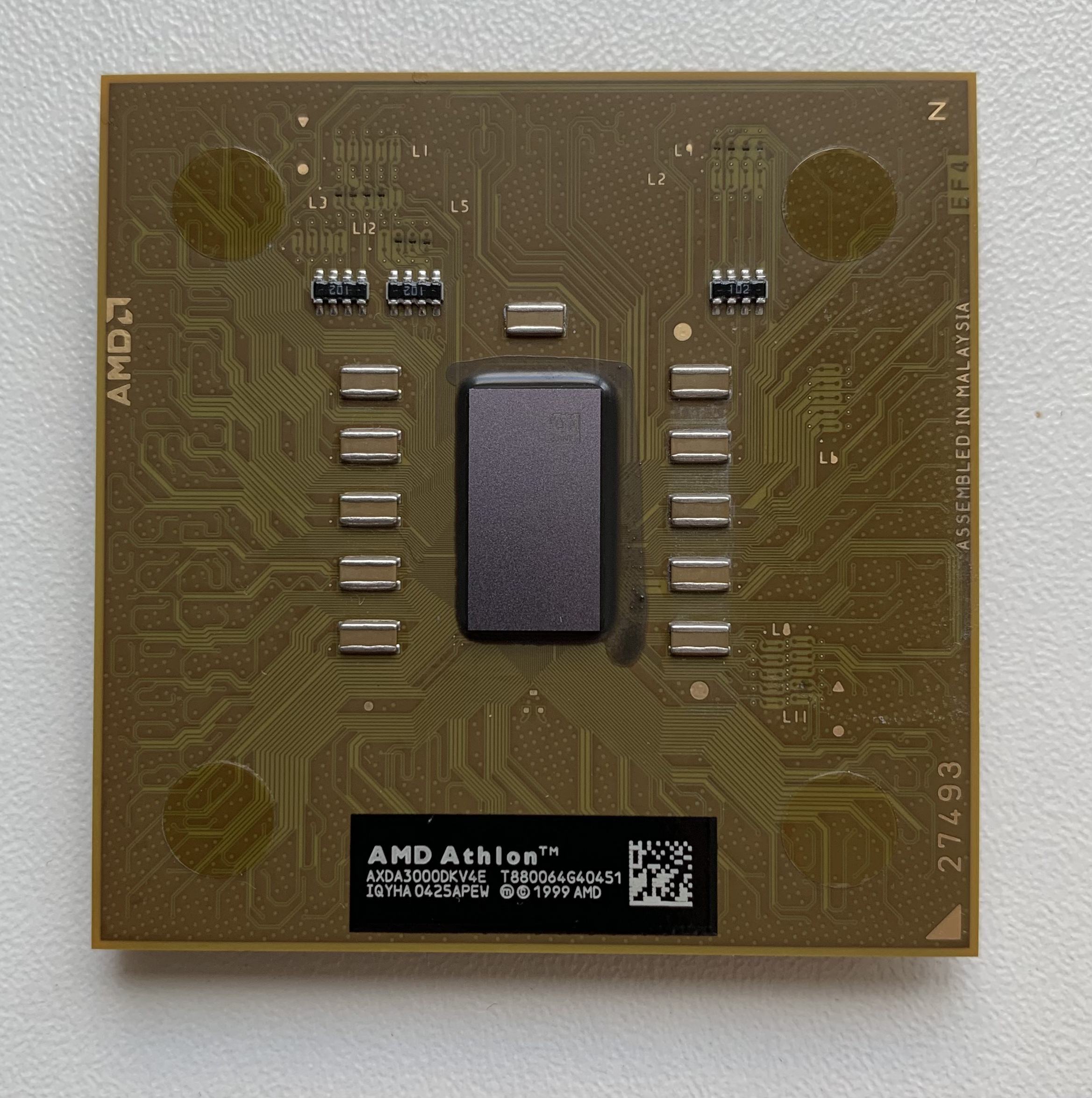

Gestern mal ein paar Desktop XP getestet. Nur weil IQYHA drauf steht, hat das nix zu heißen.
IQYHA 0418MPMW (XP 2600+)
210x11,5 2415 MHz @ 1,63V 1M
215x11,5 2473 MHz @ 1,68V 1M
220x11,5 2530 MHz @ 1,73V instabil
225x11,5 bootet nicht @ 1,85V
IQYHA 0419SPMW (XP 3200+)
237x11 2604 MHz @ 1,69V 1M
250x11 2750 MHz @ 1,90V 1M
IQYHA 0425APEW (XP 3000+)
230x10,5 2415 MHz @ 1,68V 1M
235x10,5 2467 MHz @ 1,73V 1M
240x10,5 bootet nicht @ 1,85V
AQYHA 0437EPMW (XP 3000+)
220x10,5 2310 MHz @ 1,60V 1M
230x10,5 2415 MHz @ 1,63V 1M
235x10,5 2467 MHz @ 1,69V 1M
Es wird wohl schwer einen besseren CPU als den 0419SPMW zu finden.

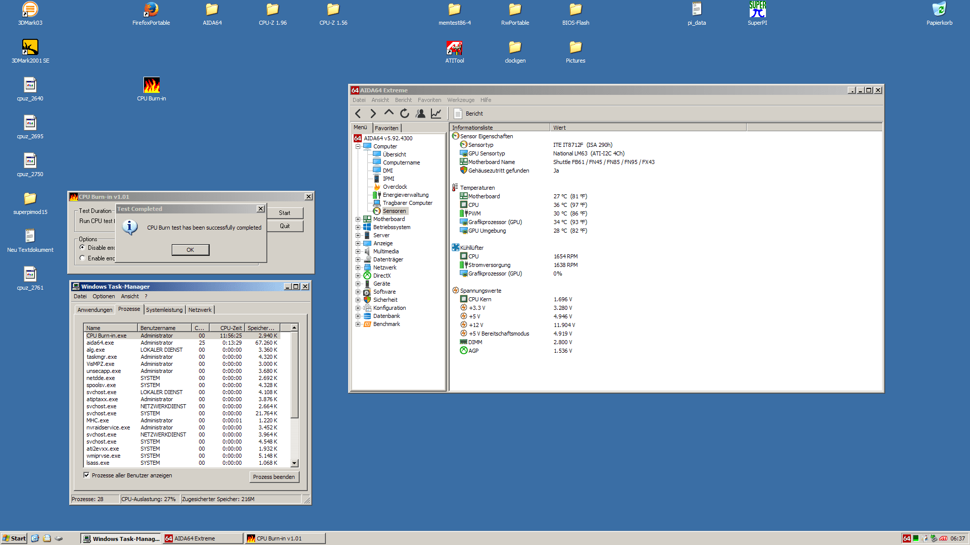

Mach doch nen "burn-in"
Zitat:
"I personally have managed to shave off more than .150 volts off my 2600+ M. It went from 1.825v to 1.775, then later 1.75 at a whopping 2.61ghz. All settings were completely prime95 stable."
Ich stolpere halt immer wieder über solche Beiträge. Getestet habe ich sowas aber nie :popcorn:
hmm kann man mal probieren. :-)
oder doch das? klick
Error Check soll man jedenfalls deaktivieren...
Ausführlicherer Text zum burn-in klick
Es scheint ja wirklich bei einigen funktioniert zu haben. Wenn mir selbst irgendwann wieder nach Sockel A ist, werde ich das auch testen.
This whole burn in is nonsense. Always was. It never did anything for me back then.
My golden cpu from back then was good from day one.
I would find it more logical if the mount was not perfect the first time and it clocks better after a remount or when running 12.5x200 in stead of 10x250.
CPU was running fully loaded for about 12 hrs last night. If this thing is bs i can confirm it in the next days.
I'd rather say this system wasn't at its limit when the cpu first demanded 1.825V...I've never had a cpu which i had to burn-in and which gave better results afterwards. Also going from 1.825V to 1.75V? C'mon.... ;)
He was claiming that his overclock was 260x10 Prime95 stable. Shady imho. But not impossible cause it’s only a 2D torture test. No screenshots though.
But yeah, I also doubt that you will gain more MHz. On the other hand it should not harm the CPU with good cooling since you do it at stock voltage or even less…
