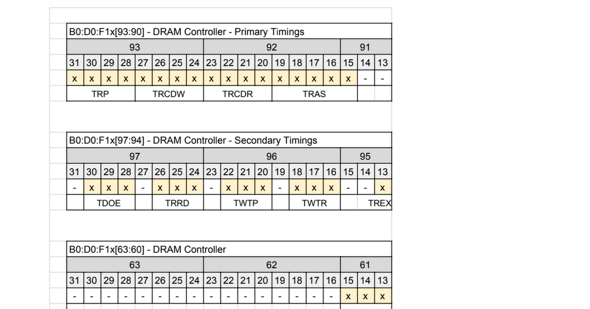

Can you please take a look at the registers document (DS an SR are at the bottom) and confirm these are the right addresses.
PS: Yes, I think it is a bug :/. I believe it was correct in some of the older version, but then I must have moved everything to a common function which doesn't take into an account that DS and SR are "doubled" values.

This register pages looks fine. They seems to be correct. Maybe there is a mistake in the register in the command rate. As far as I know, the command rate should be in b0d0f1 84:87, not 83:80. Am I wrong?
The DS/SR register are also correct.
The tool reads it from 0, 0, 1, 0x84, 29, 1, which means b0d0f1x84 bit 29, which is in the x87 register, so it seems to be just a documentation issue.
But I will double check that, which means it would be the DFI board then...
The tool ist right about the command rate. It's just the registers documentation.

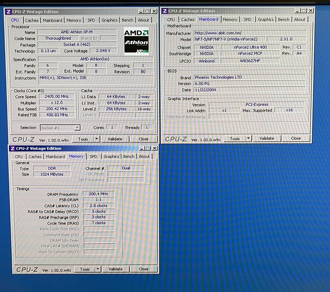

My ASUS and ASRock boards won't start with the NX1500 CPUs. I have to turn the volt-mods on. Then they start without problem on both boards. The low Vid is the cause for the non-starting on regular boards. They're recognized as normal XP-M CPUs with unlocked multi.
My NX1500 CPUs are not that good, see here: #3.026
They have some strange hickups...
I could boot 1800MHz with 1.4v, 2000MHz needs a lot more, 1.525v does not boot 10x200MHz. 1.6v seems to be running better, any lower crashes it.
I only used voltages> 1.60 / 1.80V on the ASUS / ASRock cards (Volt mods only). So far I haven't had any problems. They seem to stay a little cooler than the normal Thoroughbred B cores. Not sure why. I could run almost 2.10 V / 2400 MHz with air cooling.
I think these are Thoroughbred A, that would explain the cpu clocks. Maybe a few are Tb but mine really seems not to be.
The 2GHz boot run was with a stock Alu cooler so it might do 2.2-2.3GHz. But since i needed 0.2v more to go from 1.8 to 2.0GHz I don’t expect much from it.
