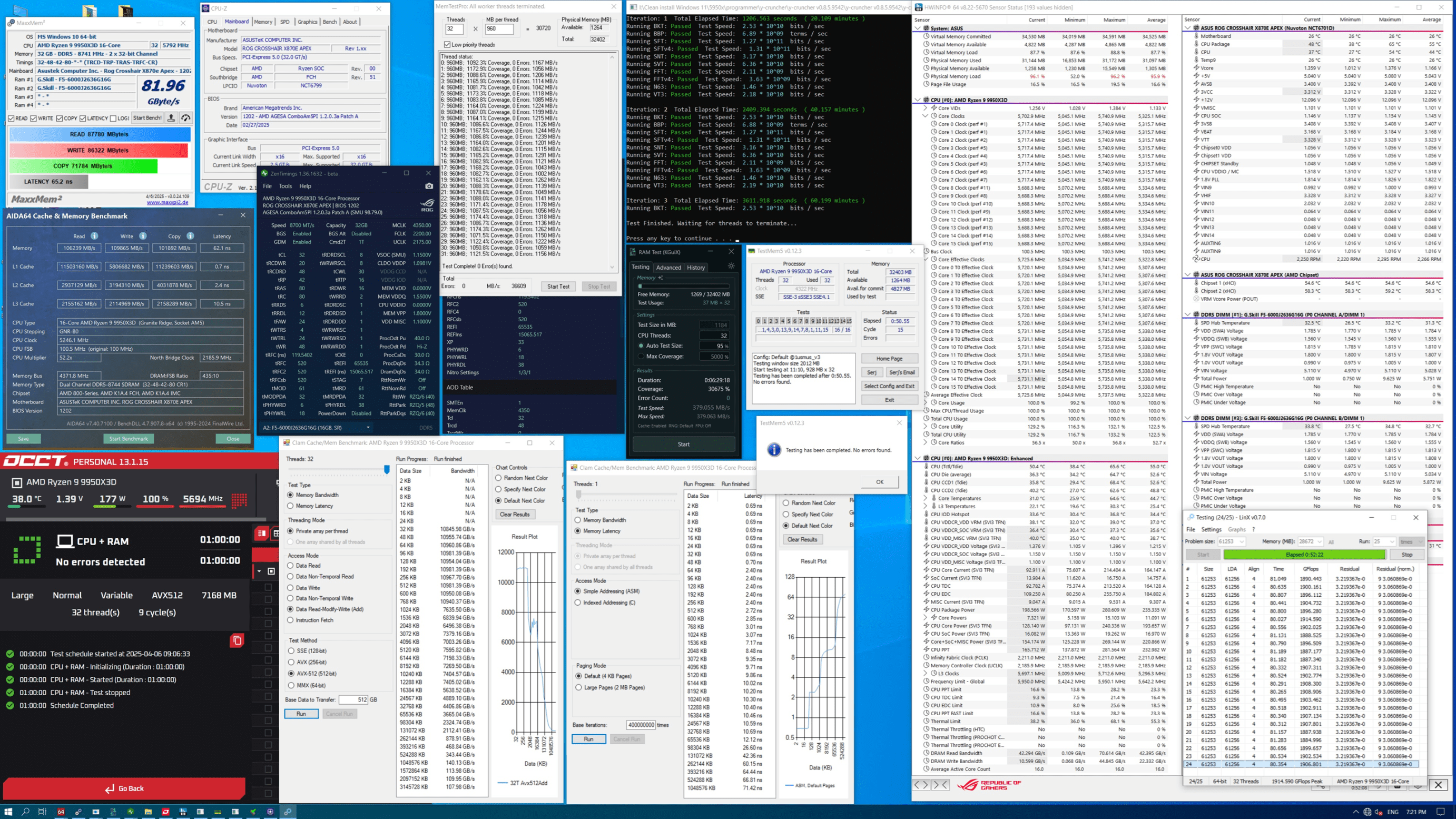

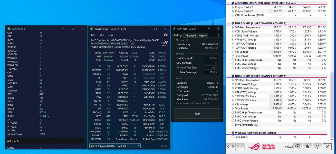

So i have swapped over to my sample #3 9950X3D with the strongest IMC, and for the last week i have been finetuning the settings/voltages and pushing the memory as hard as i could for a fully stable daily memory profile
At the end of my journey i reached a wooping fully stable 8744MT/s CL32 with the APEX and these new G.SKill 6000 CL26 sticks :cool:
  • 9950X3D with core tuning level2 running PBO
  • ROG CROSSHAIR X870E APEX @ baseclock 100.5mhz
  • G.SKILL 6000MT/s CL26 @ 1.78VDD 1.55VDDQ cooled by custom heatsinks + 2x60mm noctua fans
  • FCLK @ 2211mhz / memory @ 8744MT/s CL32 (2200 /8700 multipliers with 100.5mhz baseclock)
  • Nitro 1-3-1 with synced tPHYRDL @ 38/38
  • Large custom watercooling with a mora
Decided to complete all the following stability tests in a single boot to show that i dont cherry pick settings for spesific benchmarks 🤝
6.5hours karhu @ 379mb/s 💪
5.5hours RunMemTestPro @ 36609mb/s
1 hour OCCT Large AVX512
1 hour TestMem5 1usmus cfg
1 hour y-cruncher all tests enabled
1 hour LinX @ ~1900GFLOPS
For a performance comparison picked the following: (was running out of screenspace😅)
AIDA cache and memory benchmark
Clam latency benchmark
Clam bandwidth benchmark
MaxxMem2
I can complete pretty much all benchmark @ golden ratio 8800/2200 CL32 (8844/2211), but karhu will fail it after awhile, so the promised land is still alittle out of reach for fully stable daily settings atm :cry:
Have also updated all my y-cruncher runs for hwbot, but haven't uploaded yet since i need to swap to my 2*24GB m-die sticks before i can finished of with the 10B run for this cpu

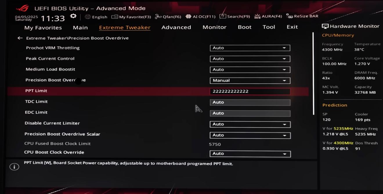

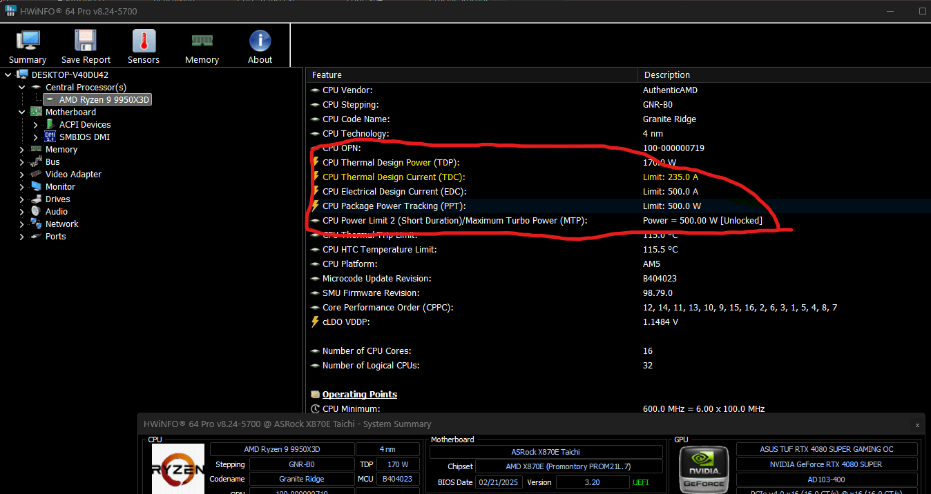

Welche maximalen Werte kann man für PT, TDC und EDC im Bios manuell eintragen für einen 9950xd3?
also wenn ich die Asrock Vorkonfiguration PBO -30mv 85°C lade, dann stellt das Mobo EDC 1000A ; TDC 235 A und 1000W PT ein........was ebenfalls reichen sollte....:fresse:
Oder eben überall min. 6 Ziffern eintragen…
Hatte Roman in seinem Vid gestern gemacht
Einfachste (y)
Anhang anzeigen 1097412 Anhang anzeigen 1097413
Einfachste (y)

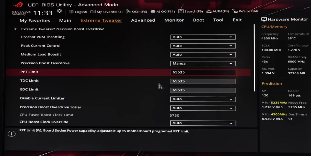

wobei mir gerade einfällt , Roman hat das sicherlich in einem Asus eingetragen (kenne dieses Video nicht) , in meinem Asrock müsste ich da eh in mV und mA eintragen und habe somit dadurch 6 Stellig....
Mach einfach überall mal zb 6 Einser und es wird automatisch das Maximum eingetragen (>65.000)
Komisch habe bei alle Drei Optionen mal 111111 eingetragen, danach ist die CPU bei 600mhz stecken geblieben :fresse:
Habe dann wieder "Motherboard" gewählt, sollte auch nicht limitieren oder?

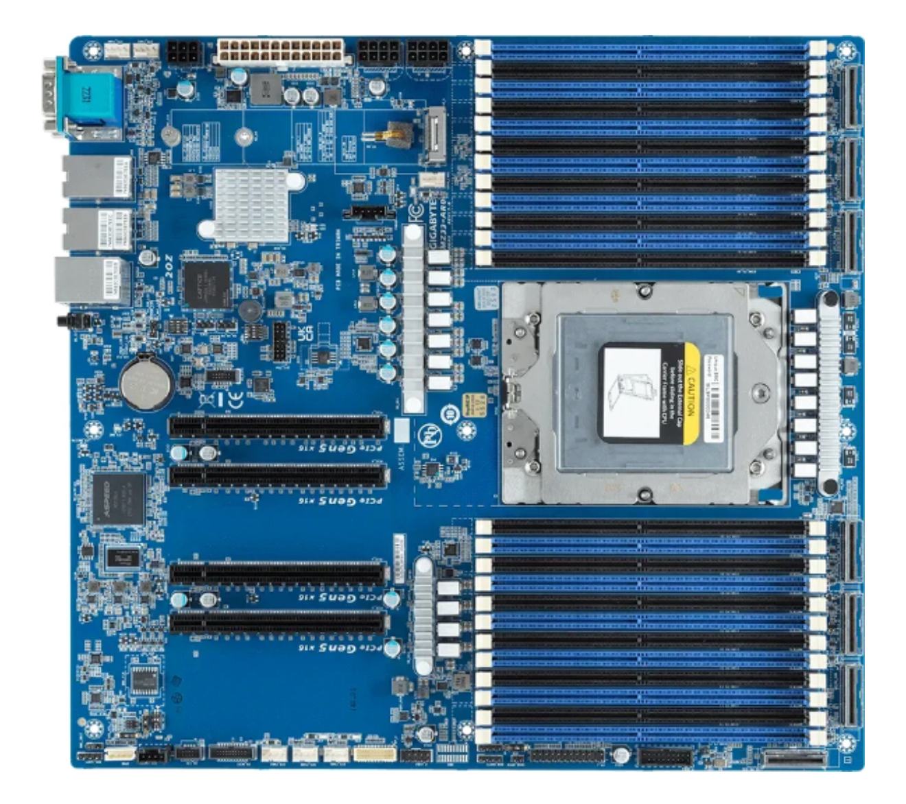

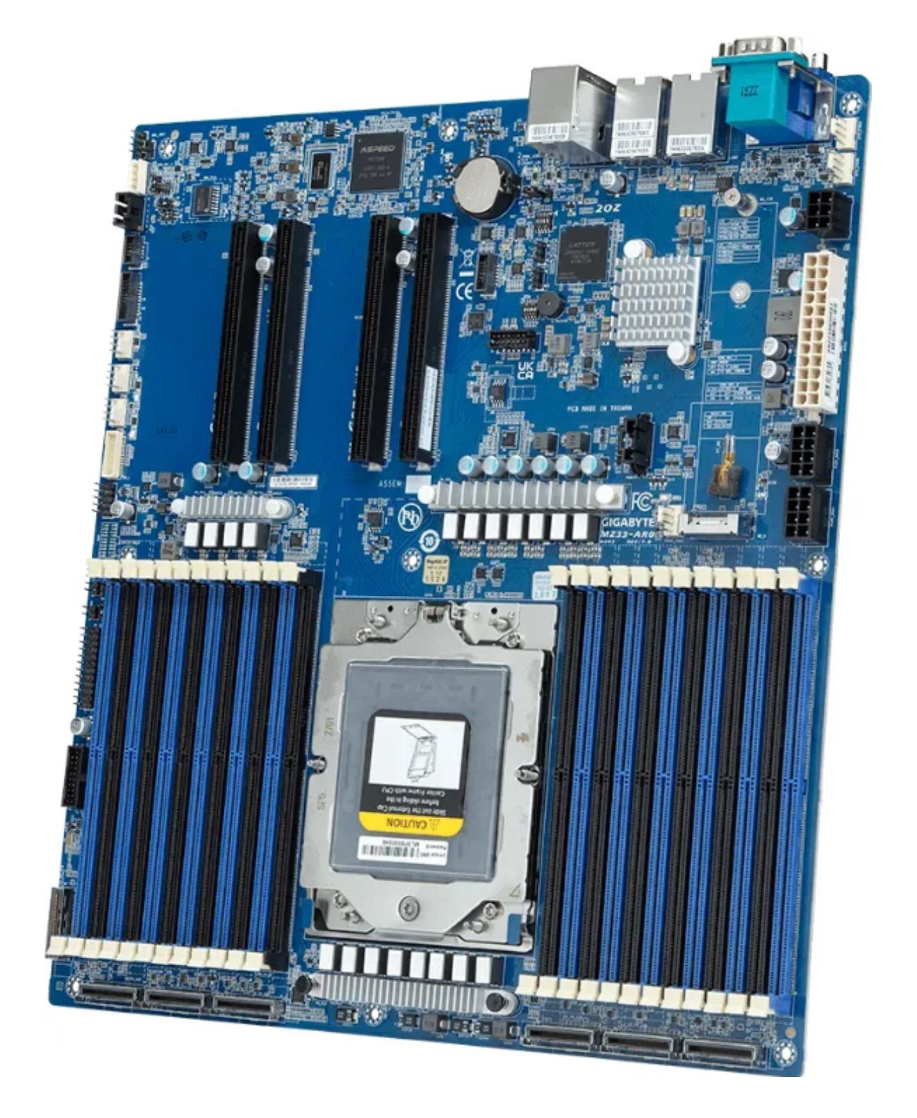

Eigentlich müsste ich mir wieder zwei Setups zulegen…. 🙈
Der Preis pro Core, des „9654P“ und die techn. Daten sind wahnsinnig verlockend 😳
- 32 vs 192 Threads
- Dual-Channel vs 12-Channel (WTF???)
- 24 vs 128 PCIe 5-Lanes
24 RAM-Slots - geisteskrank!!! (Spoiler) :fresse:
Viel „Spaß“ beim Timings ausloten :haha:

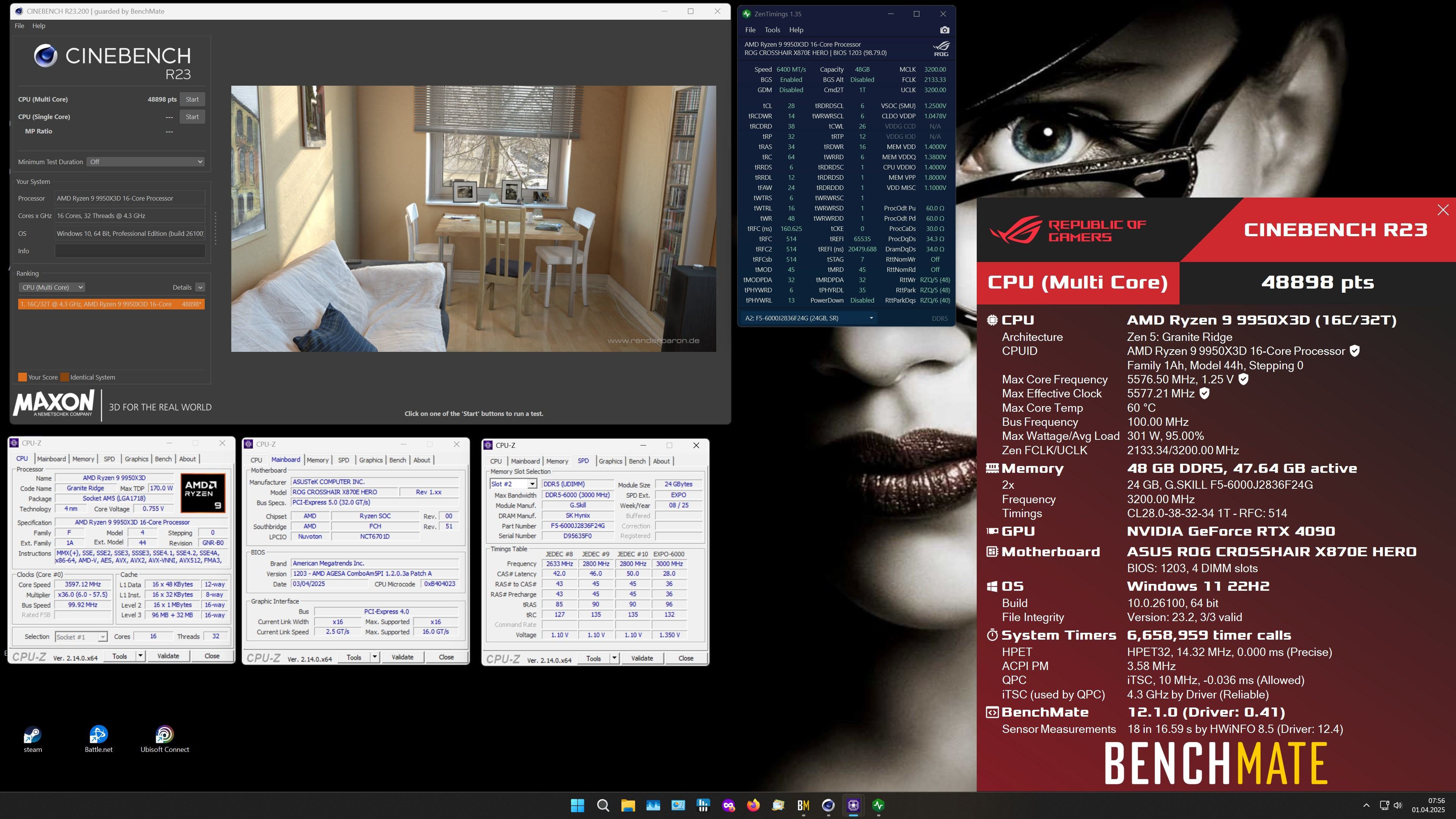

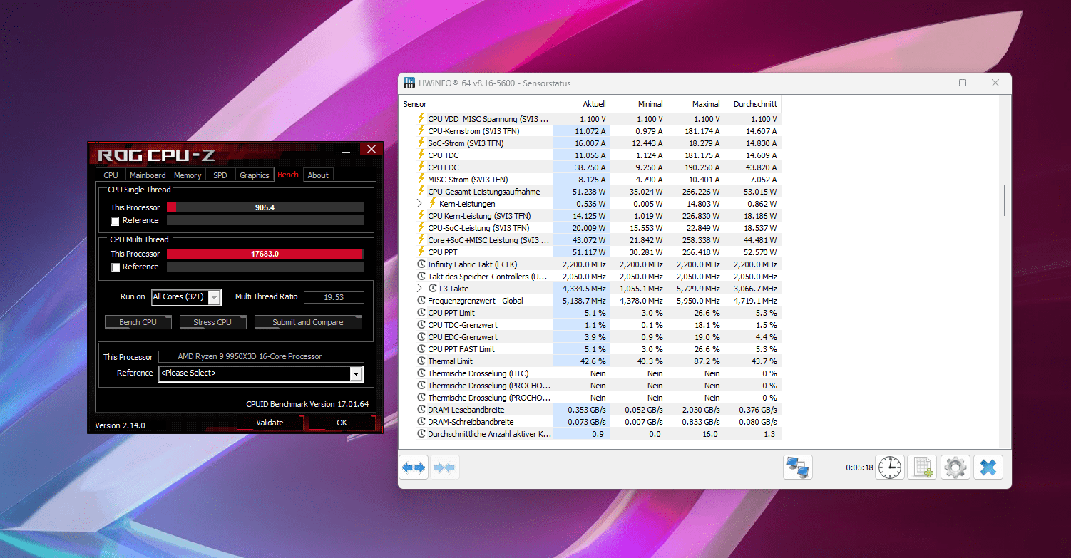

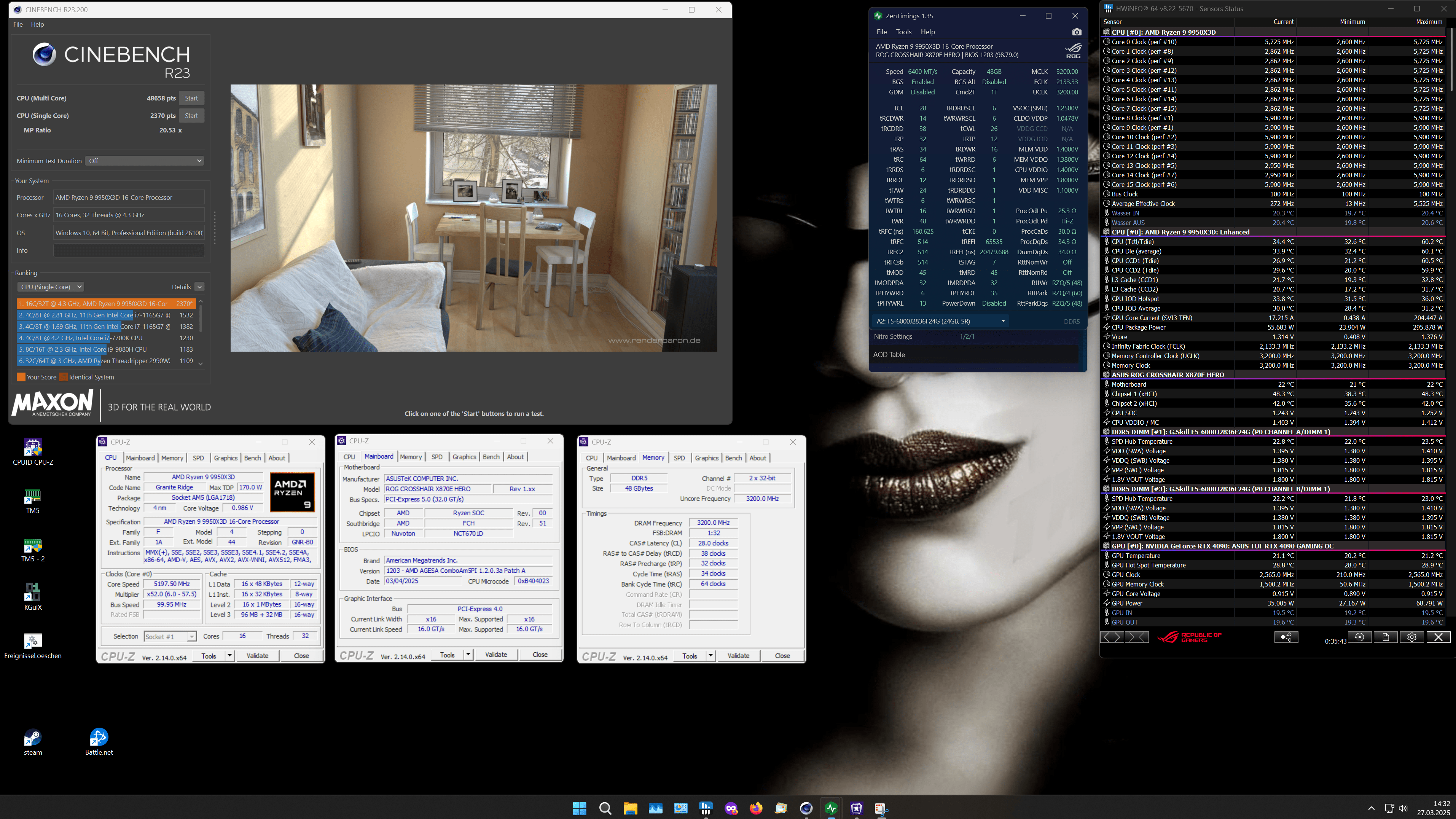

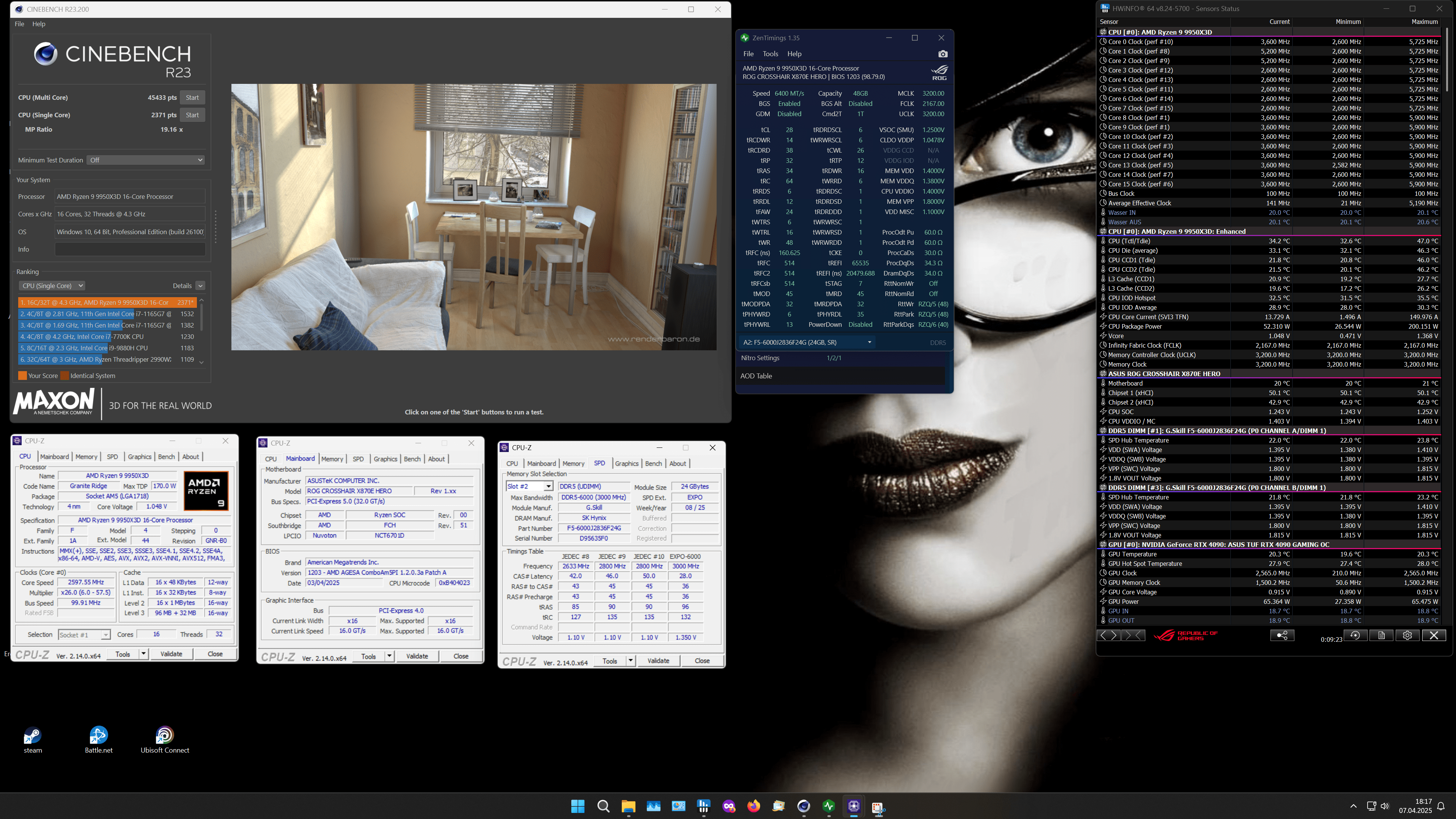

Hallo zusammen, melde mich auch mal wieder zu Wort ..
Der Umbau (ins Hauptsystem) ist jetzt seit 3 Wochen abgeschlossen und das System läuft ohne Probleme.
Alle Limits entfernt:
Mit CPU Limits:
Mit 19 Grad Wassertemperatur:
Ich weiß, das ich das schon mal gesagt habe, aber das ist die erste AMD CPU die wirklich Spaß macht..
Grüße, Wheels

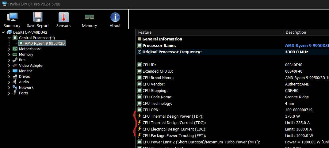

die Grenzen wenn ich PBO "Motherboard" setze ....
..desweiteren @Wheelchair , 48K + in CB23 kriegt man wohl nur wenn man manuellen Takt einstellt zB per CCD , dann fehlt aber der höhere Light/Mid Boost takt, also ich wüsste nicht wie man beides hinbekommt...
Max-Takt @ allcore reicht…
Hatte leider zu wenig Zeit, zu testen, aber nächstes Ziel sind 49k 🙈
Ich müsste mal in HWinfo nachschauen, wie hoch bei mir das PPT-Limit ist. Steht ja auf „auto“ und hatte trotzdem mehr als 300W auf der CPU. Hier wäre DD-Cooling gut gewesen, weil die Temp selbst bei kaltem Wasser arg hoch war
