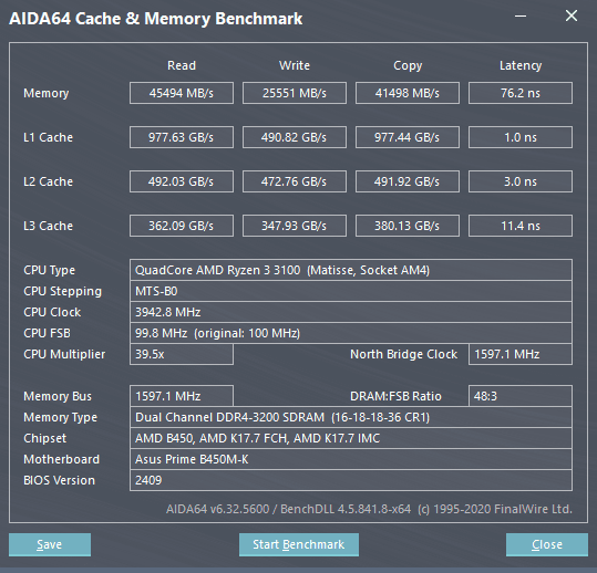

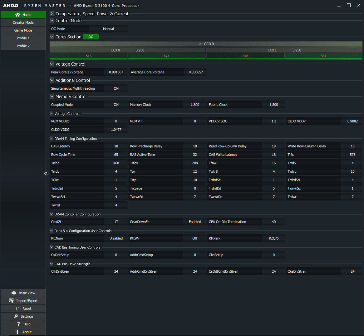

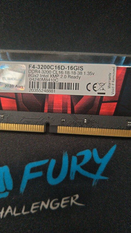

Hello.
I'm working on timings 3 days in a row, i don't have experience in this, but finally i got first stable. Can you guys tell me what improve? rRFC looks locked to 350ns in my case.
VDDR 1.35V but Gigabyte bios and HWinfo reporting 1.38-1.39V

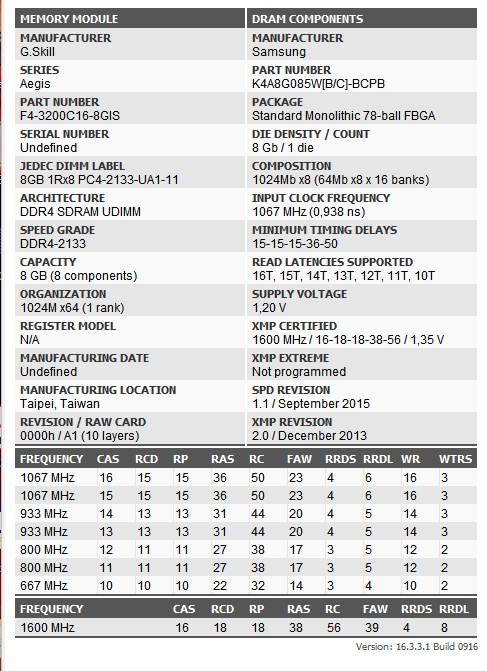

This is 04240m8410c K4A8G045WC-BCRC
F4-3200D16-8GIS also know as
F4-3200C16D-16GIS

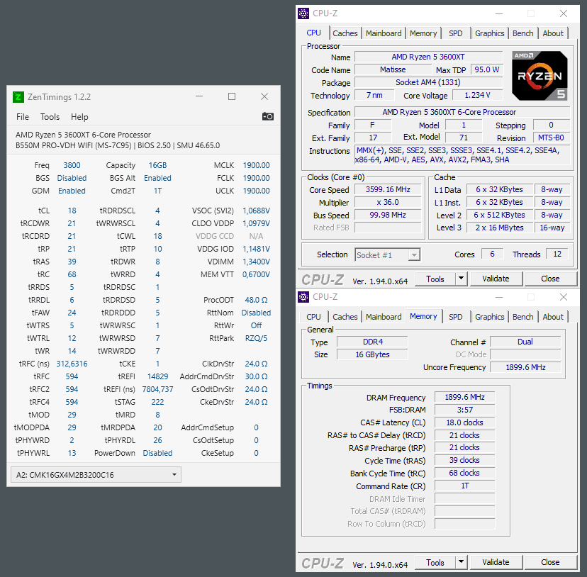

To give a little update on what I have achieved (or rather, failed to achieve), with the latest BIOS for B450 Tomahawk MAX, I gave a shot at 3800 MHz CL18-23-22-22-46 and saw lower latency values than before the BIOS update. Considering most of my timings are on auto MSI might have done some memory QVL updates, or maybe not. Hard to tell really. What matters is my latency overall decreased.
Did a few hours of TM5 extreme on this preset, 1.35v voltage, 0.975 VDDP/VDDG, 1.1 SoC.
Finished TM5 just fine, however during gaming I had the nvlddmkm (Nvidia driver) crash, which suggests my Overclock attempt was not stable, as the ''nvlddmkm has stopped working'' pop up in event viewer is most likely caused by instable memory according to Nvidia.
Reverted back to 3600 MHz CL18-22-22-46, which seems to be a tad slower but at least its been stable for many months. Its going to sound really boring however the overclocking potential with these sticks are just not worth the time invested because of how unstable they are and how they absolutely hate voltage.
Here are the results of my ''almost stable'' 3800 attempt:
Could I somehow stabilize this? Honestly I don't know. Whenever I try for 3800 I boot just fine, I pass tests just fine but I'm always let down by instability that shows itself in either corruption or driver crashing later on which is honestly very demoralizing. Anyways, if you're reading this and just like me you are struggling, I just suggest leaving it at whatever is stable because the effort you will put into overclocking C-die is honestly not worth it.

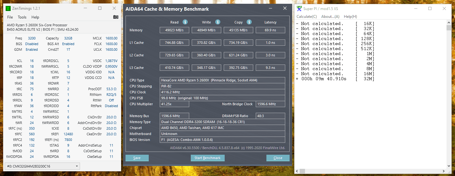

Hi guys, I don't speak german so I'll use english, hope you don't mind.
I had a lot of problems trying to run a 32 GB Corsair Vengeance LPX ver. 4.32 at the advertised speed of 3200 Mhz (of course XMP didn't work), but finally after three days of almost non stop tweaking I managed to get it working at 1.34 V. I wanted to thank you all 'cause this forum helped me a lot (I had 0 OC knowledge), and to post my settings in case they could help others having the same problems (I saw a guy in this thread with the same issue that ended up buying another brand).
My MoBo is a Gigabyte B450 Aorus Elite v2, and my CPU a Ryzen 2600X. For stability testing I used TM5 with anta777 extreme's profile, and when everything was good I did three passes of Memtest86+. I didn't try to tighten the timings, just wanted to make it work at that speed, so probably there's room for improvement. So far it's been running fine for almost a week.
Note that the image shows a VSOC of 1.0875 V, but I have it at 1.1 in the MoBo. Also, when leaving AddrCmdSetup on Auto the value it showed was 11, so I set them all to 11 and it seemed to provide some stability.
The most problematic settings were procODT, RTT and CAD. I had to tweak them a lot to avoid BSOD or BIOS not posting while trying different voltages. Then I had to tweak them even more because the tests usually failed around the first two minutes. On top of that I had to make some timing adjustements too. If I remember correctly, I had to fidle mostly with tRC, tFAW, TRDWR + tWRRD and tRFC (adjusting it for 350 ns seemed to give the best results).
All in all it was an interesting journey, although a bit frustrating, keeping in mind that supposedly it should have worked just activating the XMP or adjusting some simple stuff.
Now I have some questions that maybe somebody can answer:
  • When I first managed to get it working at 1.34 V, after saving the BIOS profile I couldn't restart (black screen, fans blowing, no BIOS logo), so I thought maybe the RAM was overheated and began trying lower voltages. Eventually I tried again at 1.34, and just after the test finished OK, I restarted three times in a row with no issues. Then, when I saved the profile, I couldn't restart anymore, so that seemed to be the problem. I could restart again by unplugging the PSU, and since then it's working fine, does that make any sense to you? Should I be concerned?
  • At some point I tried loosening the primary timings, and it was weird 'cause it all went worse. BOSD, POST issues, tests failing seconds after starting... how is that possible? Supposedly it should work better, right?
  • Are the benchmarks OK? Do you think I should try to tighten the timings, or even increase the frequency? Will it be worthwhile or the gainings will be minimum?
  • Is there anything I should try to adjust to avoid any possible long term damage or problem?
If you board have VSOC option called VSOC VID set it up to 47, in my case it was problem.

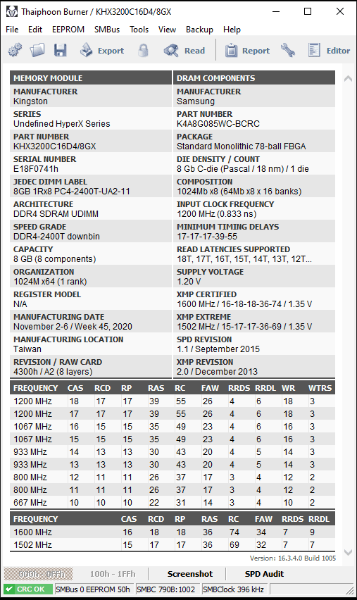

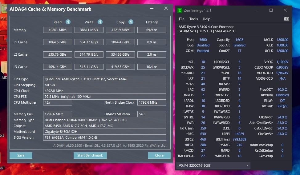

Hallo All : fresse2:, Just got 2x8 kingston hyperX samsung c-die. i really wish i got other die that can use with ryzen dram calculator cus im noob at manually oc ram, now im stuck with this kit running xmp 32000mhz cl16, maybe you all can help me manually oc this ram to 3600 or more max with tight timing, just give me the number to start with ,i put it in my bios then we see how far it goes, already create bios/cmos reset switch to start with, if you need more info about my setup i will post late
Tq kormath, bro do you know how to calculate trfc2 trfc4? After find something here:coffee: i manage to get 3600 now on the way to make to 3800, pc keep do random shutdown at 3800,
I think that it, run at 36000 now check ram with tm5 @anta777 config cya!

Tq kormath, bro do you know how to calculate trfc2 trfc4? After find something here:coffee: i manage to get 3600 now on the way to make to 3800, pc keep do random shutdown at 3800, maybe i should increase some soc vol or ?
Well I'm no expert but as far as I know you should leave trfc2 and trfc4 on auto. Also make sure to do some research and find out if your CPU/Mobo supports 3800 (not just checking the specs, 'cause probably you can go higher than that, but in forums and such).
yeah i must check my specs first and go more futher later, if this speed stable, then im gonna torture my cpu next..

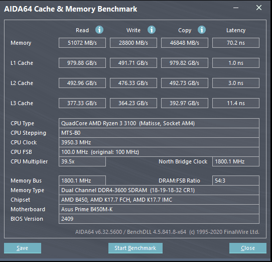

Hallo, bitte ich brauche Hilfe... danke sehr!

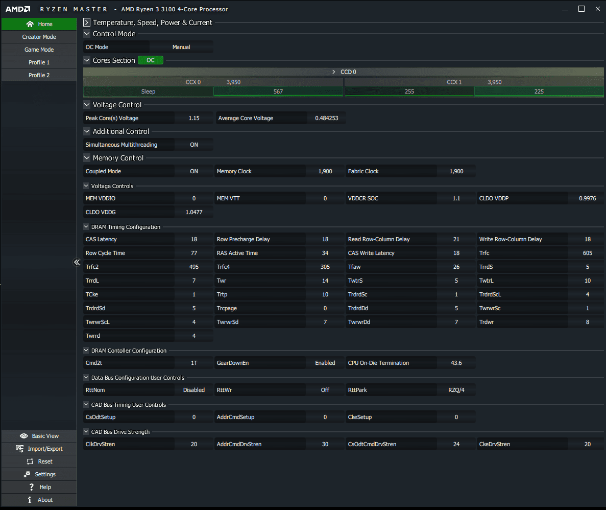

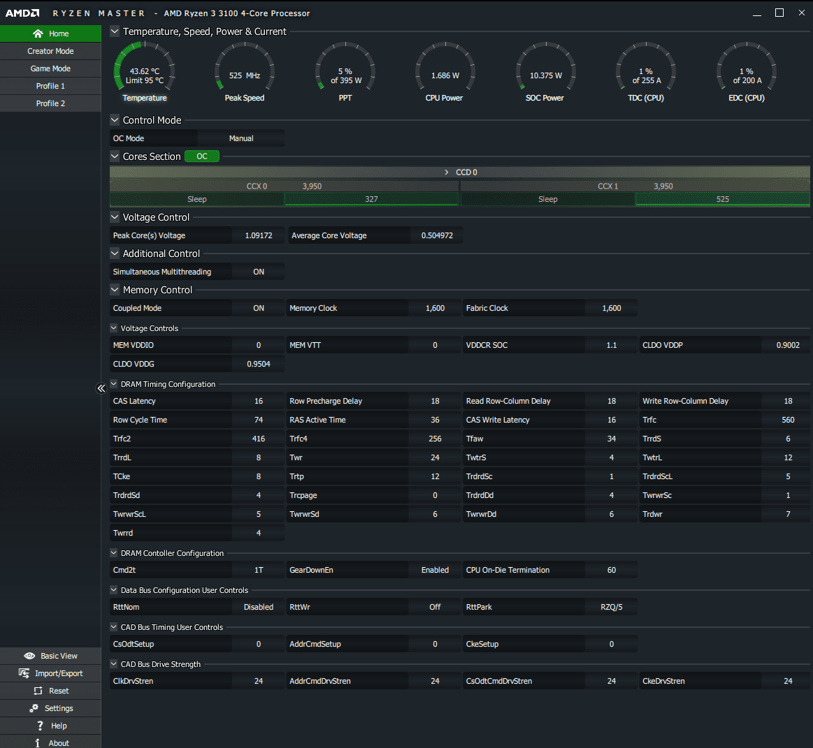

Basically i'm not sure what's the best for daily use in gaming between cl 14 2933 vs cl16 3066 on some SAMSUNG C-DIE OEM 32GB. GDM PM OFF.
i can run both settings at the very same settings stated in the picture but with higher ( tCWL 16 and TRFC 536 for cl6 3066 ) to be noted anything lower than what i already have gives errors or BSOD and i have to CLEAR CMOS.
with GDM and PM disabled not even 3200 cl 16-20-20-20-40 works and enabled i can do 3200 16-17-17-34 but with some more subtimings loosen so thank you but no thanks.
Again to be noted..again, i did more tests for stability than what it can be seen on both settings.

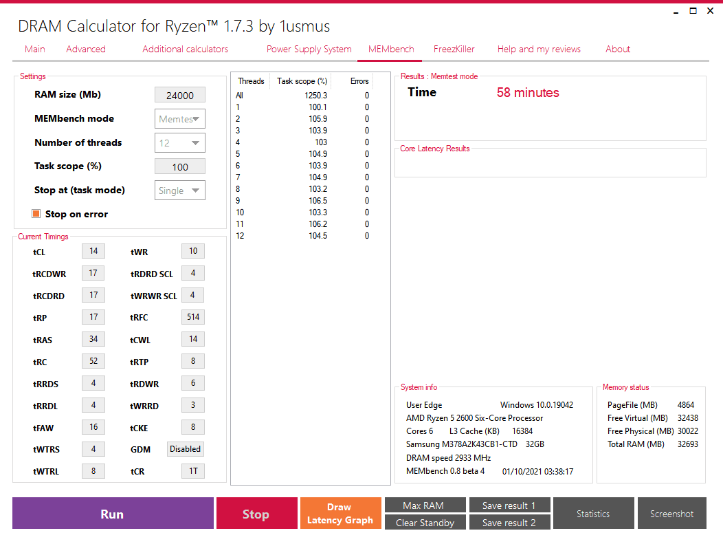

Nach etwas Verwirrung und Zeitverschwendung mit dem DRAM Calculator (Thaiphoon reportet B-die, entsprechende Probleme beim OC...) habe ich meine Corsair 3200-CL16 v4.32 RAMs nun manuell übertaktet.
Als Grundlage dafür dienten die 3800 Mhz OCs der User Reous und alxns (aus dem Community OC Spoiler im ersten Beitrag), danke schonmal dafür!
Einige Fragen dazu:
  1. OC getestet mit MEMbench (im DRAM Calculator), Memtest mode mit Max RAM, 12 Threads und Stop at: Single. Mehrmals ohne Fehler durchlaufen lassen. Reicht das als "Stabilitätsnachweis" oder braucht es dazu weitere Tools/Tests? Falls ja, welche: AIDA64 system test RAM only? TM5 mit v3 config? MemTest in mehreren Instanzen? Was ist "nötig" und/oder empfehlenswert?
  2. Ich hab gesehen, dass einige User in diesem Thread ohne GDM, also mit echtem 1T, auf stabilen 3600 (oder sogar mehr) mit vernünftigen Timings übertakten. Gibt es Erfahrungswerte was für Gaming Performance (CPU-bound, z.B. CSGO/Valorant) besser ist: GDM mit besserem Takt/Timings, oder echtes 1T schlechteren Takt/Timings?
  3. Bezüglich meinem OC: fällt einem der erfahrenen RAM OCer hier der ein oder andere Wert auf, den man noch unbedenklich etwas optimieren kann ohne (vermutlich) instabil zu werden? Oder sind ggf. einige Settings dabei die wenig Sinn machen und die ich ändern sollte?
OC ist wie folgt:
Besten Dank!
edit: OC Werte nochmal leicht angepasst, so dass tRAS >= tCL + tRCD(RD) und tRC = tRAS + tRP + 8, außerdem einige subtimings tighter gemacht (tRRDS, tRRDL, tFAW). Nach wie vor stabil unter MEMbench Memtest Stop at: Single.
