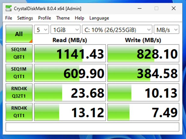

In einer Windows-VM au dem Server bekomme ich das hier hin, ist für mich echt ok:

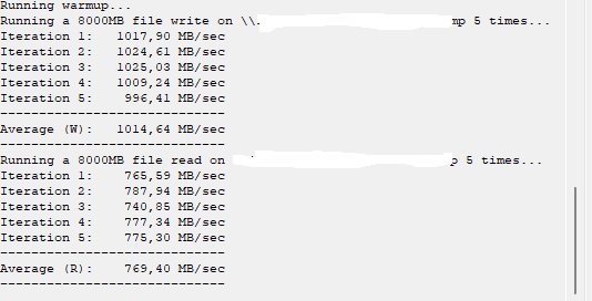

warum ist mein schreiben so "langsam" !?
NAS performance tester 1.7 http://www.808.dk/?nastester Running warmup... Running a 8000MB file write on H: 5 times... Iteration 1: 794,15 MB/sec Iteration 2: 945,24 MB/sec Iteration 3: 819,86 MB/sec Iteration 4: 814,42 MB/sec Iteration 5: 661,29 MB/sec ----------------------------- Average (W): 806,99 MB/sec ----------------------------- Running a 8000MB file read on H: 5 times... Iteration 1: 1108,92 MB/sec Iteration 2: 1086,06 MB/sec Iteration 3: 1114,02 MB/sec Iteration 4: 1155,83 MB/sec Iteration 5: 1123,71 MB/sec ----------------------------- Average (R): 1117,71 MB/sec -----------------------------
