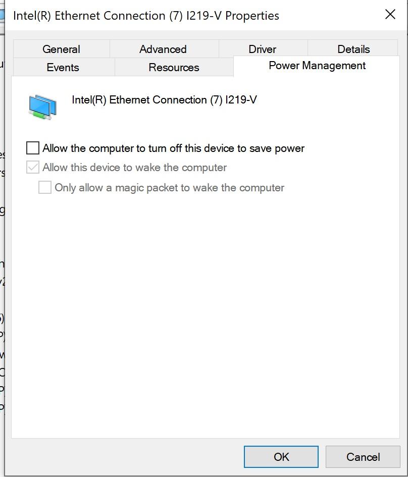

why is my internet disconecting and reconecting after every 5-10 minutes ? this was also happening with strixx-f board and now with Hero board also.warum ?
@kayawish24
Due to the fact both boards disconnecting that way, I would assume it is not board related. I guess drivers were updated, so check other devices connected to your router, also your wlan, even change the wire and the socket. You have to isolate the problem on your own, eventually ask your provider. How could we know why it is disconnecting?
@kayawish24
after disabling ethernet power safe i did not get disconecting problem till now.
@kayawish24
Safing power at all costs. How stupid is that. Thx for posting your solution.
@kayawish24
nope , just again network got disconected.Router is working fine because Wifi on my laptop is not disconecting.i found out that shity intel 1219V eithernet adapter has problems on many new mainboards...this is bullshit.
