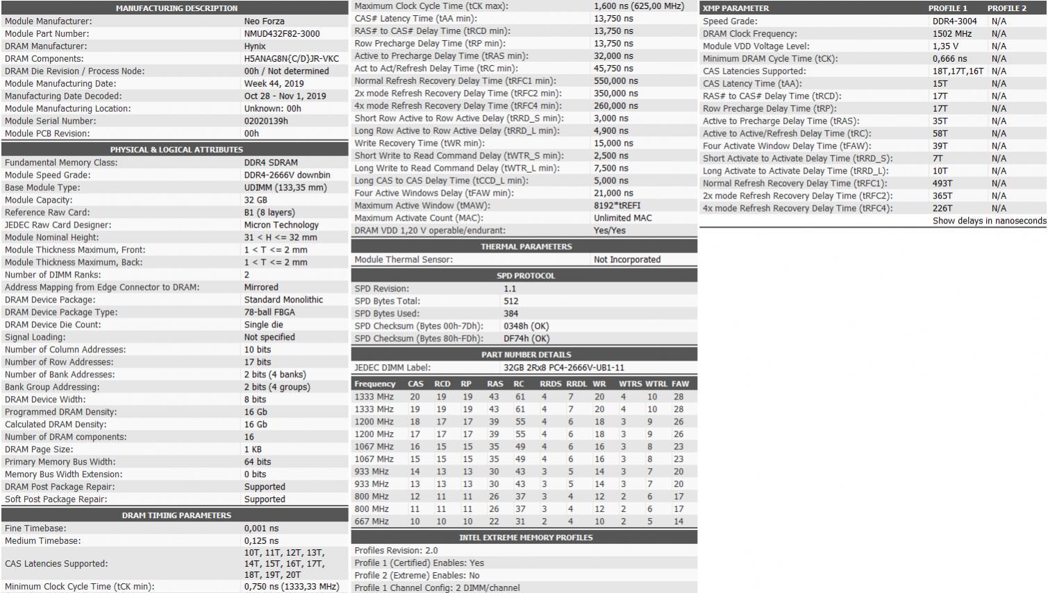

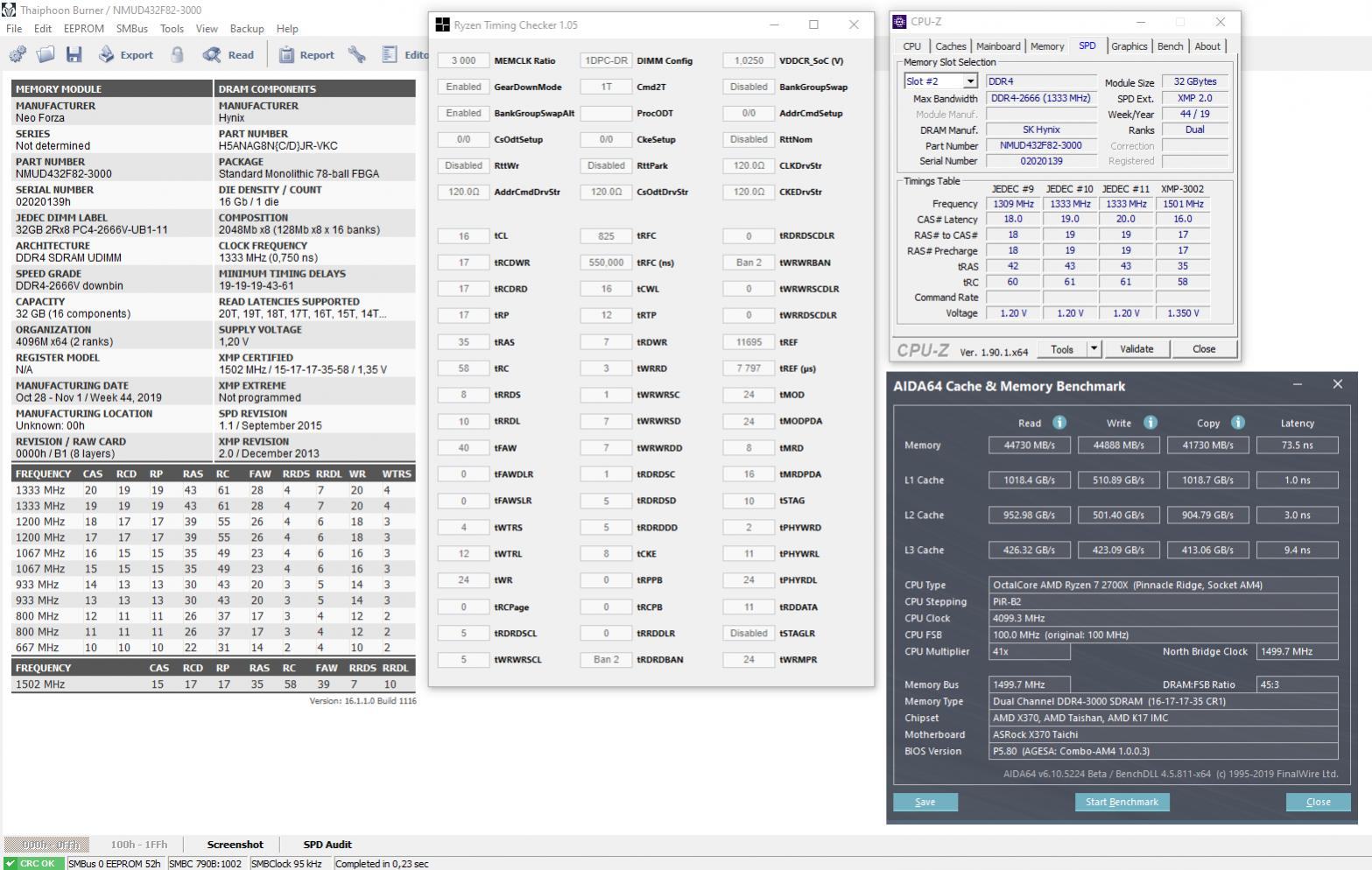

Hi guys i bought 2x32gb kit Neo Forza ENCKE [NMUD432E82-3000DC20] but Thaiphoon Burner defines them as H5ANAG8N{C/D}JR-VKC, it's C-die or D-die? (Module Manufacturing Date: Week 44, 2019)
on my x370+2700x can't boot with xmp, but when change trfc to auto (825) all boot fine.
Memtest86 8.2, 2 passes 6 hours with trfc 560.
Hey DemonAk,
can you please check what your lowest bootable trfc with DDR4-3000 is? If it is something between 375 and 390 it should be CJR. If you can boot lower like something between 345 and 360 it is probably DJR.
Hey DemonAk,
ok, i'll try again, but xmp def trfc set 493 and can't boot, only when i set trfc 560 i can boot windows and pass memtest.
so, i've tested trfc 375-390 and 345-360 it won't boot, sadly. So chips AFR or MFR? or maybe something new and not good
My fault. I didn't notice that this are 16Gbit ICs. So this could be Hynix CMR. The high trfc looks normal on this ICs. I also have one kit and can only boot with 350ns.

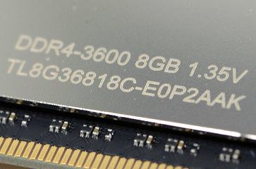

V Color mixes 2 ICs in the same model!
V-Color PRISM II RGB
TL8G36818C-E0P2AAK
Full of surprises...
No doubt it is CJR
G.SKILL RIPJAWS 4
F4-3600C19D-16GRKB
Fetures Code is 21D
DRDT is a Code of DJR
