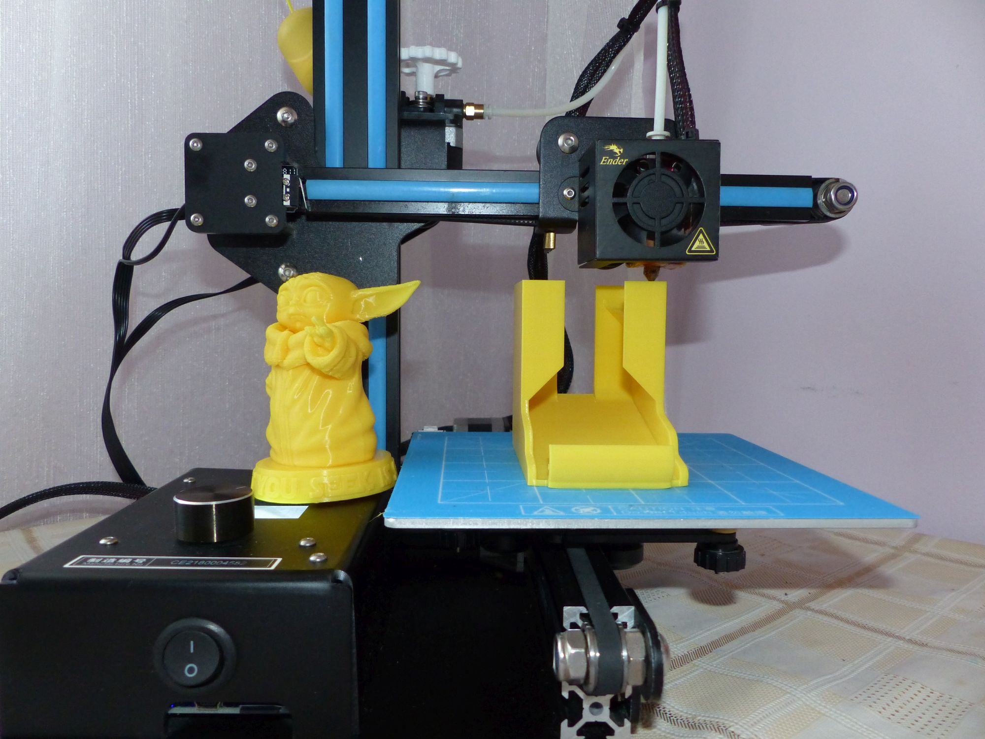

New prints, after a long time. Now she will work continuously, to make up for lost time :-)
