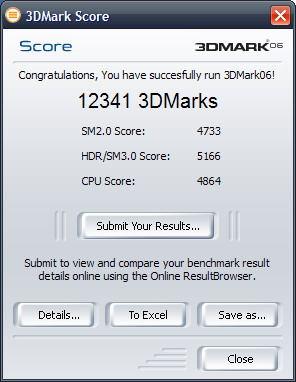

Ok yesterday I reached 12054 points at 3Dmarks06
FSB = 294Mhz
Multiplier = 11
RAM = 2 - 3 - 3 - 6
In Bios I've activated Spread Spectrum or 3Dmarks06 crash
Enhalt ...........
Virtualization ..............
All the rest in the same screen disabled
I also overclock my 3850 to 802/1002
I think I can get a little more, any suggestion?
Guys new record 12341!!! by overclocking a little more my HIS, WOW :banana:
I had to repeat the test to grab also the details and ...........

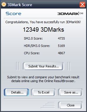

Same config.
x11 Multiplier
294Mhz FSB
His 3850Agp @824/1035
12349 points!!!! New Record :banana:

Quote:
Originally Posted by HarlockP4 View Post
12349 points!!!!
Cool, very nice result for AGP and DDR1.
ablev
You should be able to do the same, you have my same stuff, what Bios do you use on Conroe865PE? And what for HIS?
Oh no, our systems are different.
My ram is not so good like yours and you have a qx6700 with free multiplier.
I have a q6700 and my multi is fixed to 10.
I can only oc with fsb.
When i set CPU:Ram to 3:2, i can oc to 280 FSB, but not stable.
I don´t understand your question about my HIS.
It´s the same like yours.
My Conroe bios is also like yours. 1.71
Edit: The HIS bios is original.
