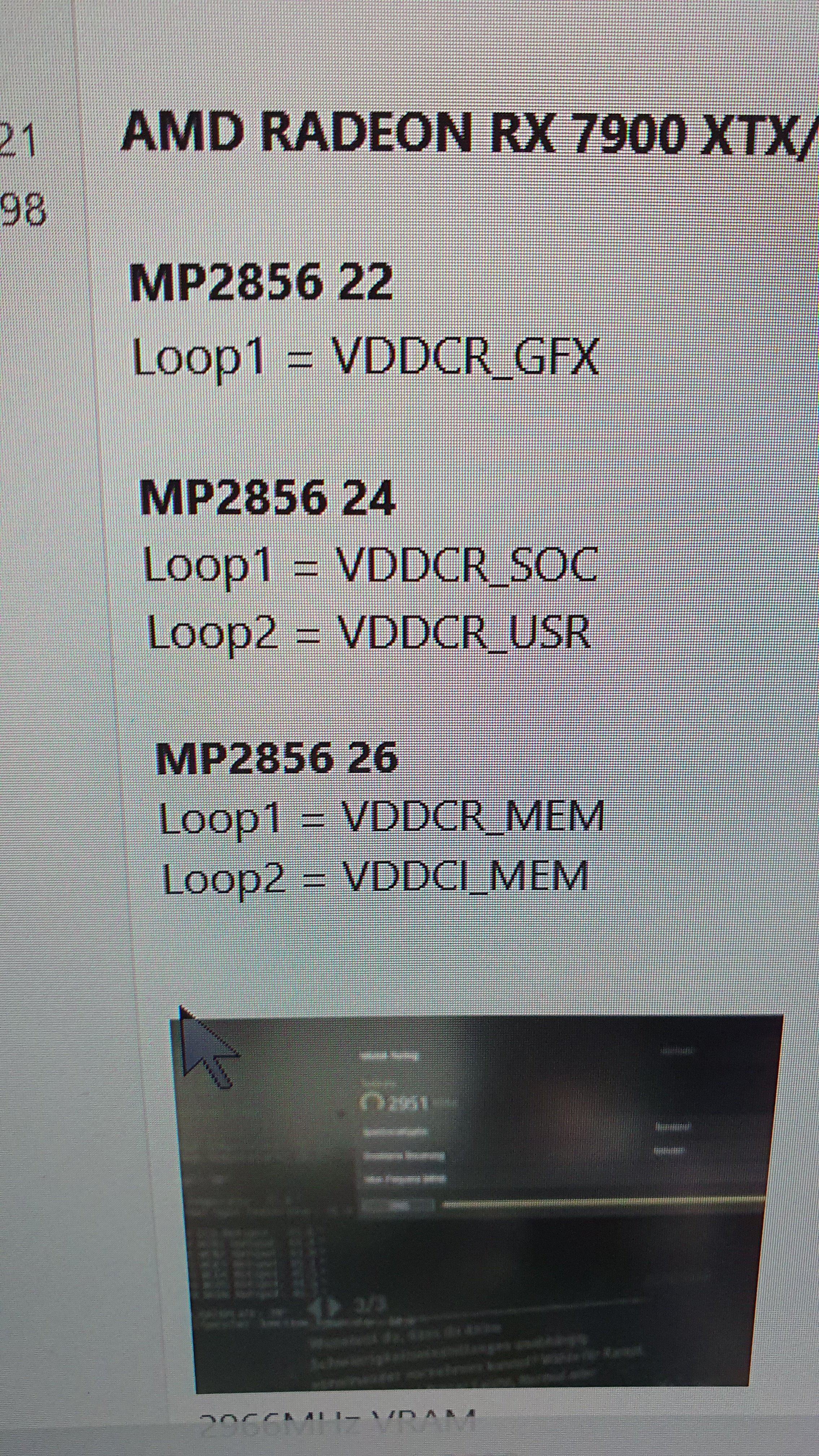

Can I see your evc data?
Basically, you lower Iout gain for power limit and add offset for more volts..
Guess you know already?

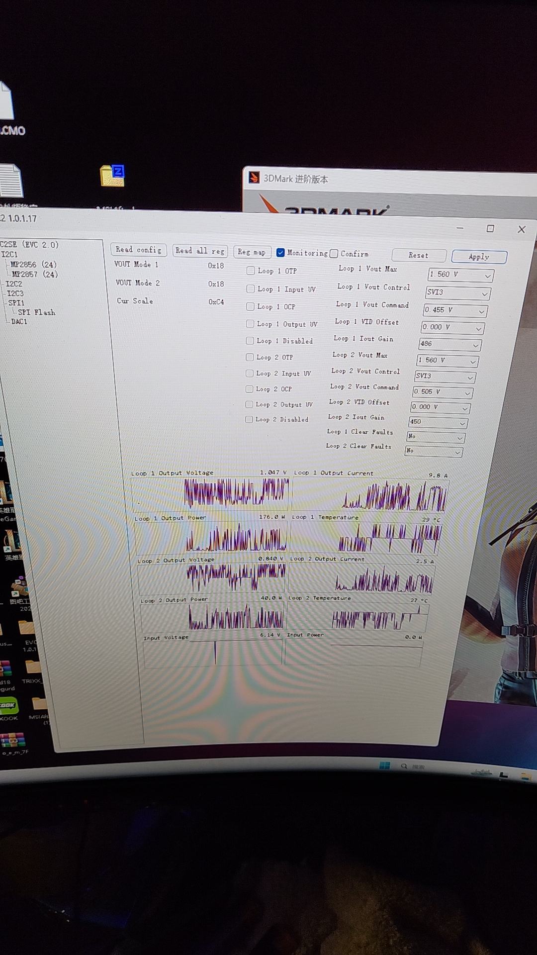

I still can't successfully use evc because I only reduce the output current gain, but it doesn't give me any higher power consumption
You dont see it. Measure watts at the outlet and you will see if it works.
Normally if you set Iout gain of loop 1 address 22 to 100 you dont have PL anymore..
Is my chip added wrong? It reduces the current output gain and still cannot take effect
Sapphire 7900XTX super platinum also common this configuration? Thank you for your help
As far as I know all 7900XTX have same addresses.
If you press scan butten on I2C menu in EVC it will list the addresses.
You can look which addresses are listed there.
It should usually list 22, 24, 26.
The addresses are right 22, 24, 26. I just don't know how to add those chips
That can't be difficult. :d
I already wrote in the previous post which are the corresponding chips to these addresses.
You need to select them manually from the list and select the correct address and then press add.🤷‍♂️
You need to do that manualy after every reboot.
Ok, thank you. I will study hard

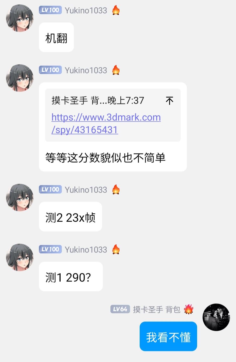

After my friend's evc connection, the core overclocking Settings cannot take effect, but the video memory overclocking Settings can take effect. If the core frequency is changed, loop1 vid, iout gain, the core frequency changes cannot take effect
My friend who runs 45,000 points said that your scoring data is very powerful, and he ran 45,000 by bug
So that's how he achieved 45k. Through a bug. :d
Nice bug run for him. :rofl:
I know there are many bug runs in the top 10 of 4090 because with GPU and Memory frequency less than mine people have higher scores. :lol:
I will tell you the method of his card bug: the general card bug is to use unstable high-frequency video memory to test 1 when the video memory unstable picture loading is not completely out of the high frame, look at the frame number curve can be clearly seen, which section of the frame number is particularly high is the bug
