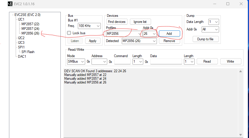

I thought he is getting error messages and doesn't see the three controllers. :-)

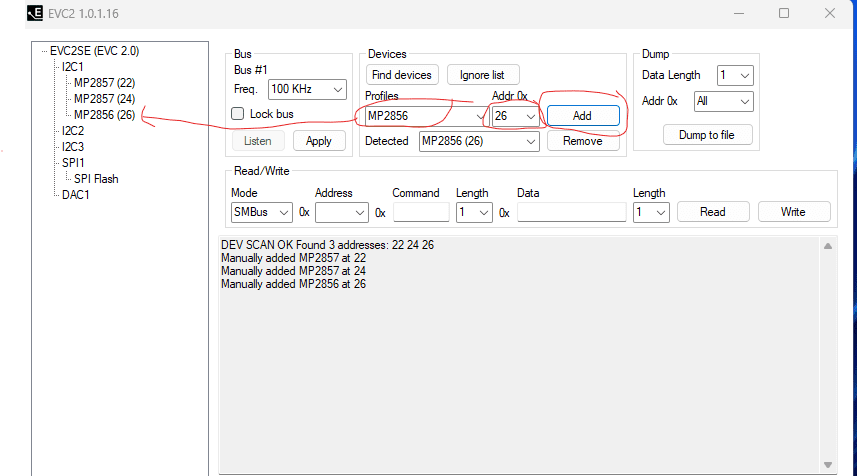

@Jthellfire911 If you see 22, 24, 26 in the list when you run the Find devices then yes as @oese said you need to add these manually.
See below how this is done:
Yes these three are needed.
MP 2857 (22) --> GPU
Mp 2857 (24) --> SoC
Mp 2856 (26) --> VRAM
Be careful when playing around things in EVC. You could kill your GPU with wrong settings. :fresse:

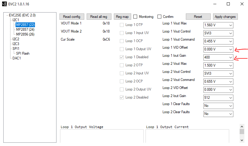

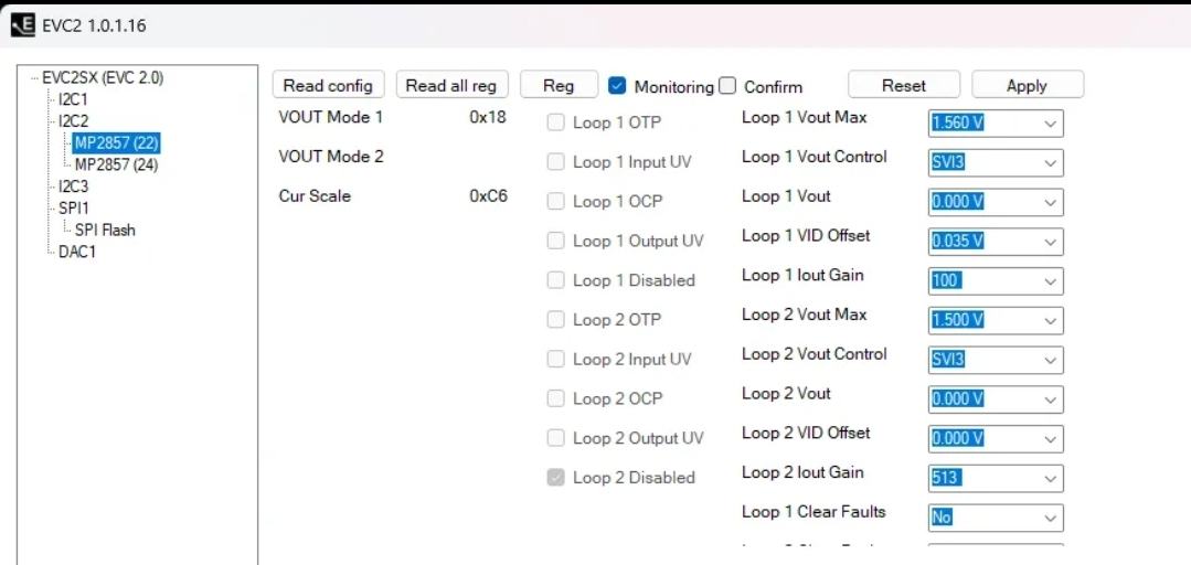

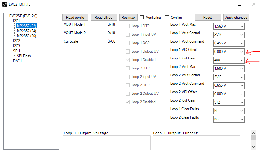

Do you still have screen shots of your settings for those 3?
The main things to play around are these two for GPU MP2857 (22); Iout Gain and VID offset.
In the beginning maybe just paly around with Iout Gain.
You can go down lower than 400 to something like 100 or even less but your GPU will burn power like hell. :rofl:
If you dare you can do it and get very high score. I went to below 10 last time. :LOL:
You will need nice cooling as well as strong power supply ask @oese about his 850W power supply. :asthanos:
For very high frequencies like going above 3500MHz, most likely then you will need to change the VID Offset as well.
I have to do it for my GPU.

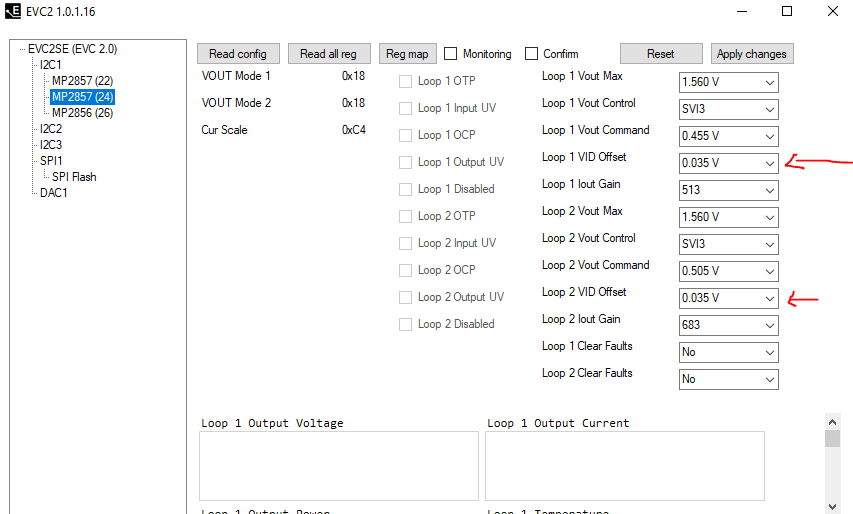

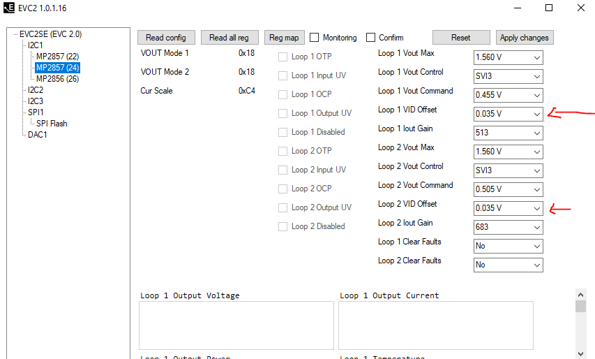

On the SoC tab, I mainly only change the VID offset to 0.035 as otherwise my VRAM is unstable above 2800MHz in Time Spy.
For Memory Controller MP2856 (26), for me it didn't do anything when I changed there Iout Gain or VID offset, so I don't set anything there anymore.

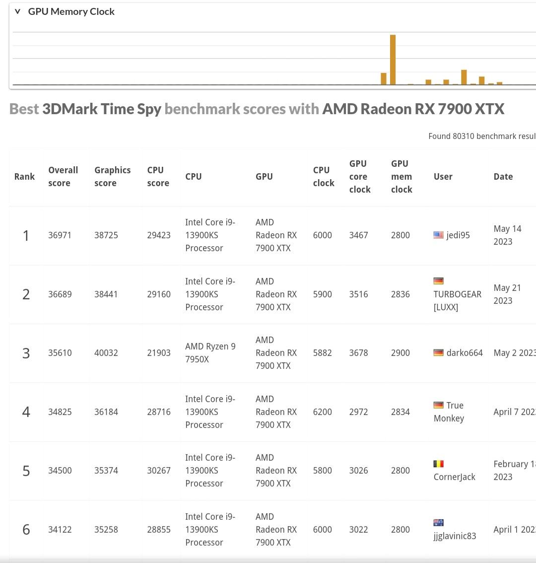

This is the last result I got today.
The CPU is now running much better but I couldn't run my old GPU setting that brought me highest score last time.
My GPU has it's own mind. :stupid:

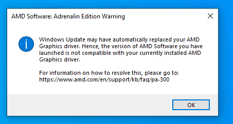

I was trying to run the old settings and I crashed my Radeon Driver and now it's not working even after multiple DDUs and reinstallation of the driver. :rofl:
I made a backup of Win 10 after I installed it yesterday so that saves me. I just need to bring back the windows from backup. :fresse2:

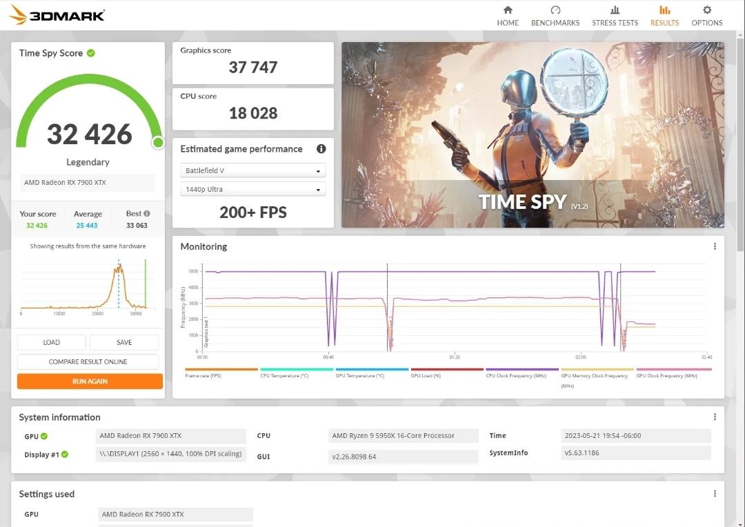

I'm seeing 100+c hot spot temps, but my max gpu temps are 35c. The gpu gcd hotspot is the main culprit for high temps. I'm also on liquid metal for the gpu
Also, why is it that my cpu score gas dropped dramatically vs without the evc2?
This so far is the best I could muster tonight. I've gotta figure out why my hotspot temps are so high, and do some waterproofing of the gpu waterblock.
I'm pretty happy with the outcome so far though! Thank you all for the help!

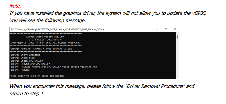

Ok, so I ordered the bios chip programmer, is there a specific video I can watch to learn how to use it?
Also can that wonder bios from the aqua be flashed onto my 7900xtx red devil?
I use Asprogrammer software for programming the bios.
You will find YouTube videos explaining how to use that.
It probably won't work with the Asrock Windows Flasher. You probably have to flash the normal Asrock Aqua Bios to the Powercolor with the Biosprogrammer first. It works, I did it too. On Overclock.net someone uploaded the new biosfiles for the pogrammer.
So I was thinking of using the silent bios chip to do the programming, since you have a red devil as well, can you tell me or show me where that chip is?
Also where is the best place to get the bios for the asrock aqua ?
Also what's the best software to use for the bios programmer?

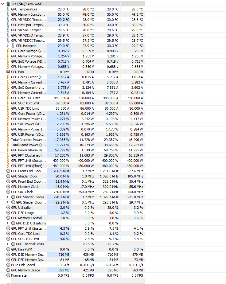

Ja wie erwartet bei neu bios alle limits sind erhöht.
Extreme Bios:
Original bios:
Jetzt muss ich alles testen zu sehen wie die karte reagiert mit neu bios.
Die schreiben da das man sollte vorher neu Treiber 23.5.1 installiert haben aber vor man bios updaten kann muss man AMDCleanupUtility laufen lassen weil wenn Treiber installiert ist dann bios update utility sagt das man sollte erst Treiber entfernen. :haha: :stupid:
